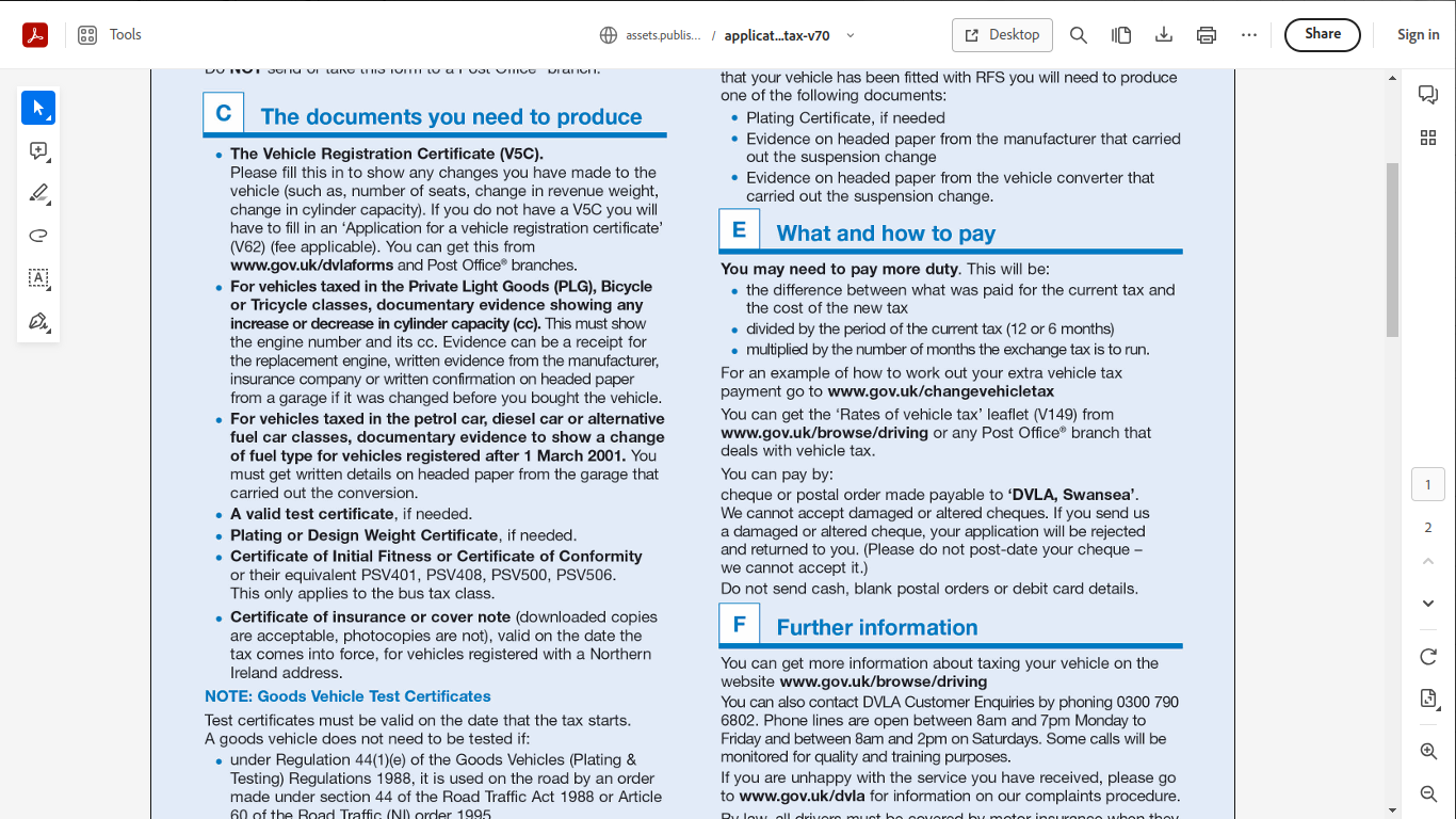

Re: DVLA Changes on conversion
On the topic of the V70, has anyone any advice for how to fill it in?
Section C seems to imply that for a Diesel car built after 2001 I need written details on headed paper from the garage that did the conversion.
That's going to be difficult as I did it myself.
Is it possible all we need to do is fill in the changes on the V5 and send it in. Since we cannot change the tax class the V70 form is not really the correct form anyway.
So I spoke to the DVLA and the advice I got was utter nonsense.
He started out saying I need to fill in a V10 to re-tax it then backtracked on this when he realised it doesn't need to be taxed.
He said I need a letter from the manufacturer of the engine (motor) and chassis number with the details of it then said nothing when I pointed out this wasn't possible as Nissan were never going to supply this.
A letter from a garage on headed notepaper confirming the new engine details but didn't mention if they had to have done the conversion or not.
So all in all I'm no wiser except that sending in a V70 is probably not necessary and I probably need a letter from a garage

I had none of those thingsAlibro wrote: ↑Tue Nov 14, 2023 3:51 pm So I spoke to the DVLA and the advice I got was utter nonsense.
So all in all I'm no wiser except that sending in a V70 is probably not necessary and I probably need a letter from a garage![]()
since we know they will not change fuel type on a post 2001, inform them of the change of fuel type and change saying that you are aware fuel type cant be changed for a post 2001 car (just quote dvla std response) inform them of engine number change and move on (well till march 2024 when the dvla argument that fuel type cant be changed as it is tied to co2 for post 2001 cars expires).Alibro wrote: ↑Tue Nov 14, 2023 3:51 pm So I spoke to the DVLA and the advice I got was utter nonsense.
just remember 1 thing death and taxes we cant cheat
