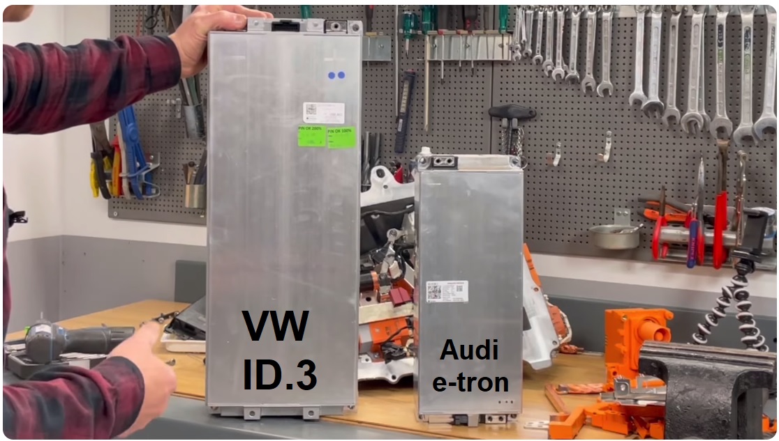

mandatory stare and compare
Volkswagen ID.3 battery module compared to the Audi e-tron
Posts: 3795
Been thanked: 411 times
Re: Audi e-tron 55 95 kWh complete teardown and a deeper look in to all the components.
Gregski wrote: Thu Nov 16, 2023 5:02 pm mandatory stare and compare
Not nothing to compare. ID3 is 12S module and E-tron is 3S but is 4P3S so the energy is a lot...
