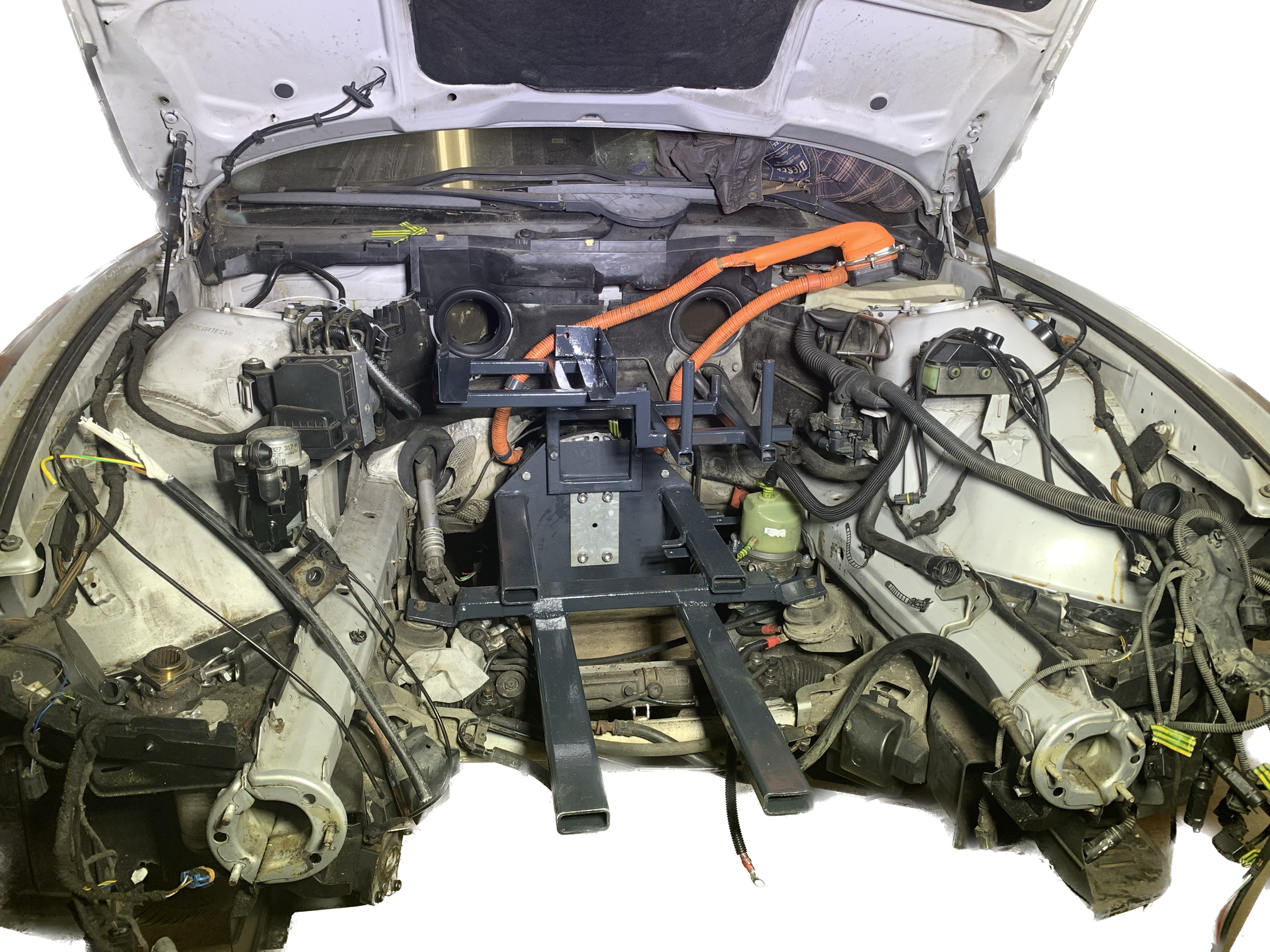

Hello All,
I first came across this forum about two years ago and after reading through multiple EV projects and watching some of your videos, I got hooked.

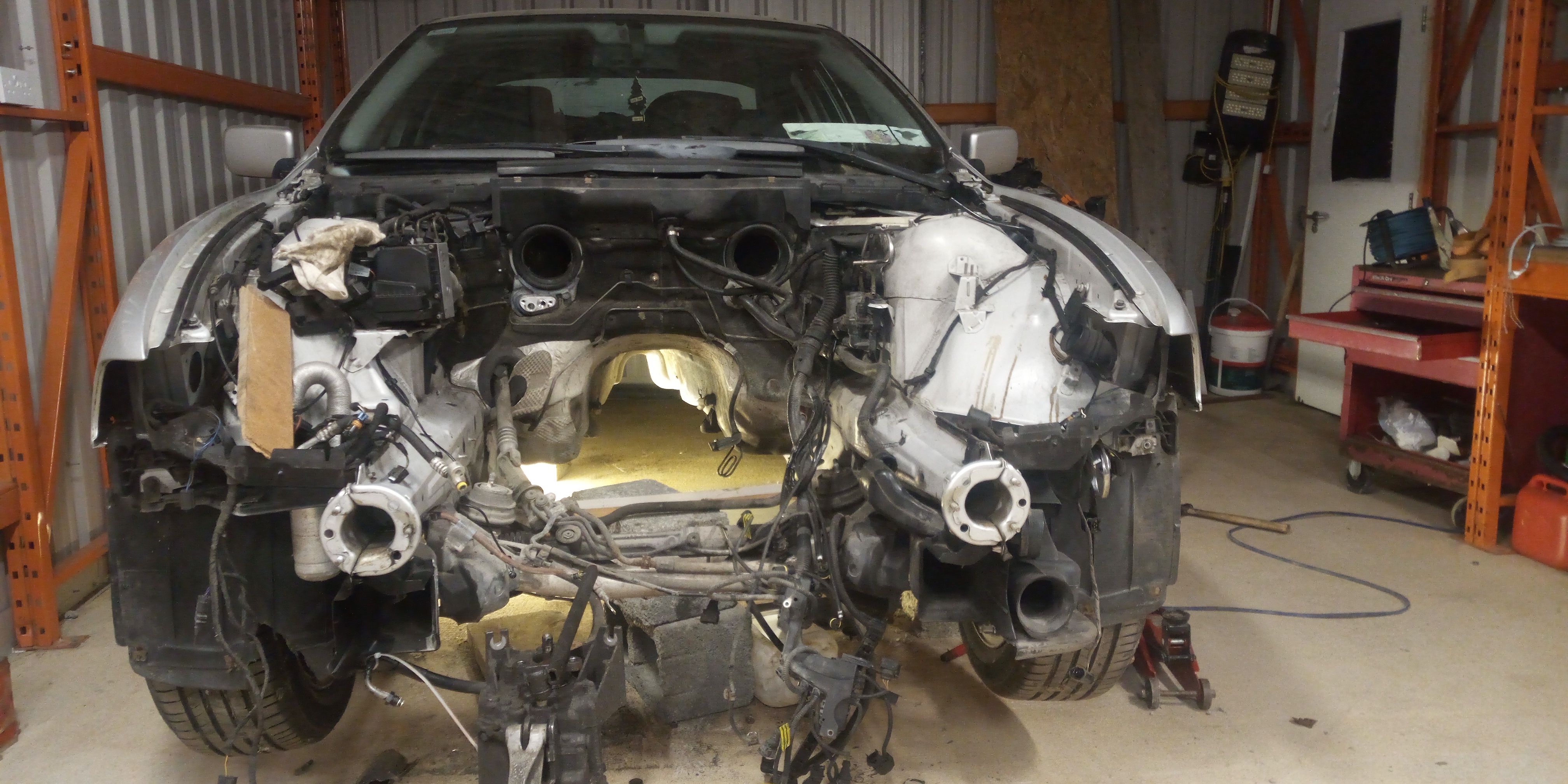

After picking up a clean bmw e39 520i and getting a GS450h from a breakers yard in Monaghan, I was ready to make a start. Then I realised I didn't want to start this project without a workshop, this took me another 12 months to build.
Over the Christmas break I got cracking on this project and removed the engine, gearbox and diff. I'm currently working on transmission brackets and adapting a BMW auto selector. Hoping to have wheels spinning in the next few months.
I still have a few parts to source: Batteries, Charger, BMS, Zombie VCU, ISA shunt, Vacuum Pump, Power steering, Charging plugs and Sockets.
I have a bit done and a lot more to do.

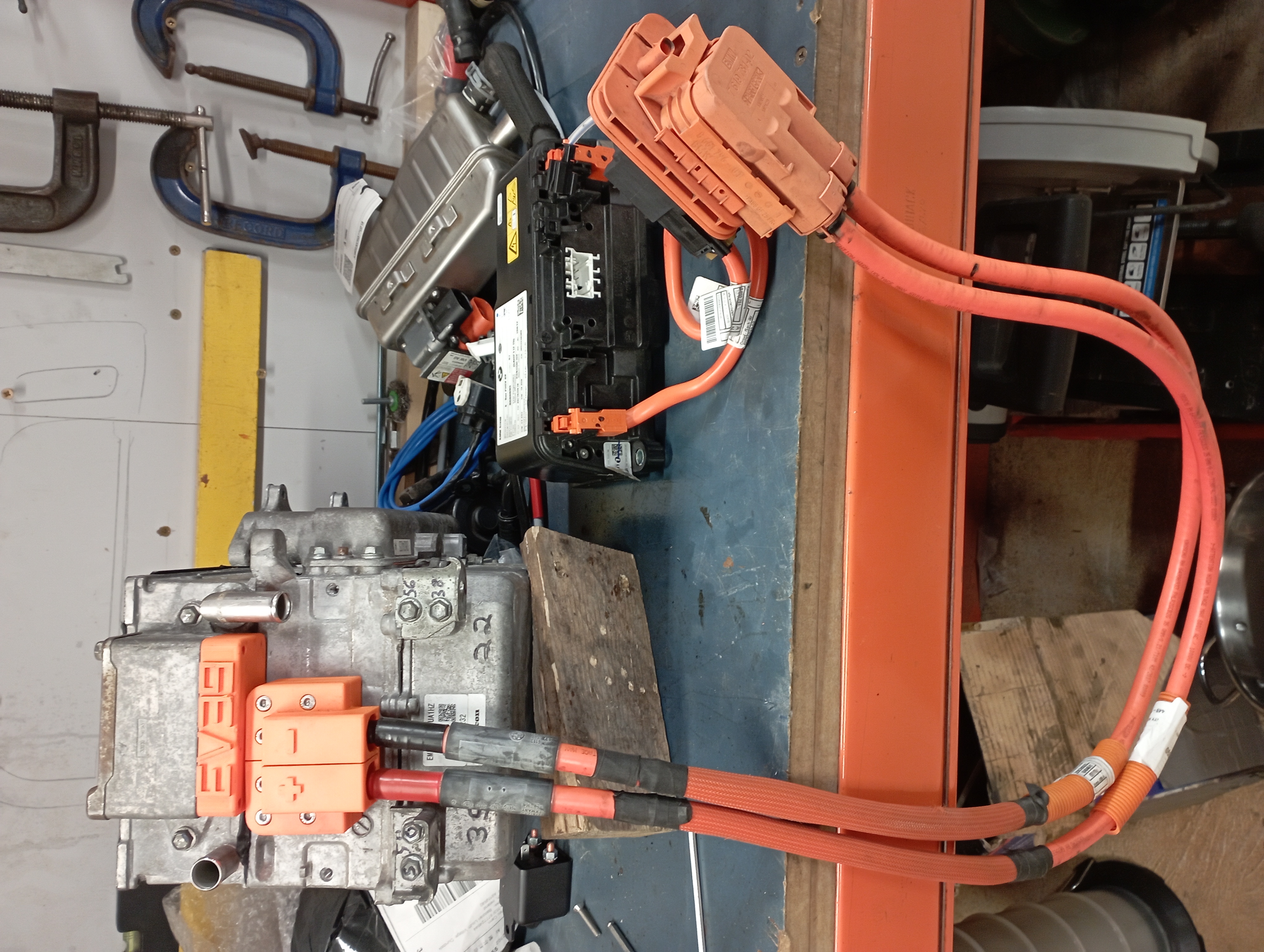

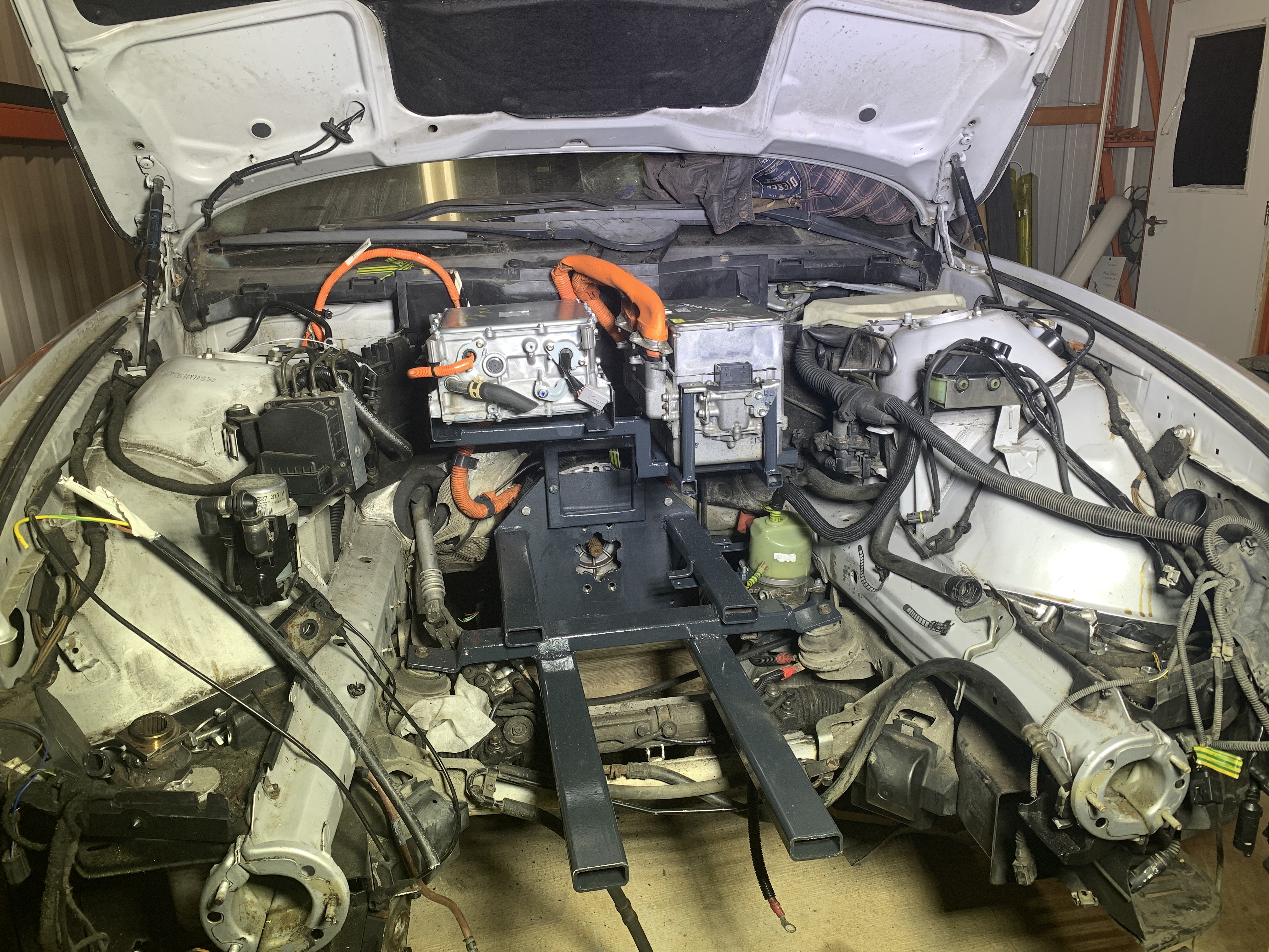

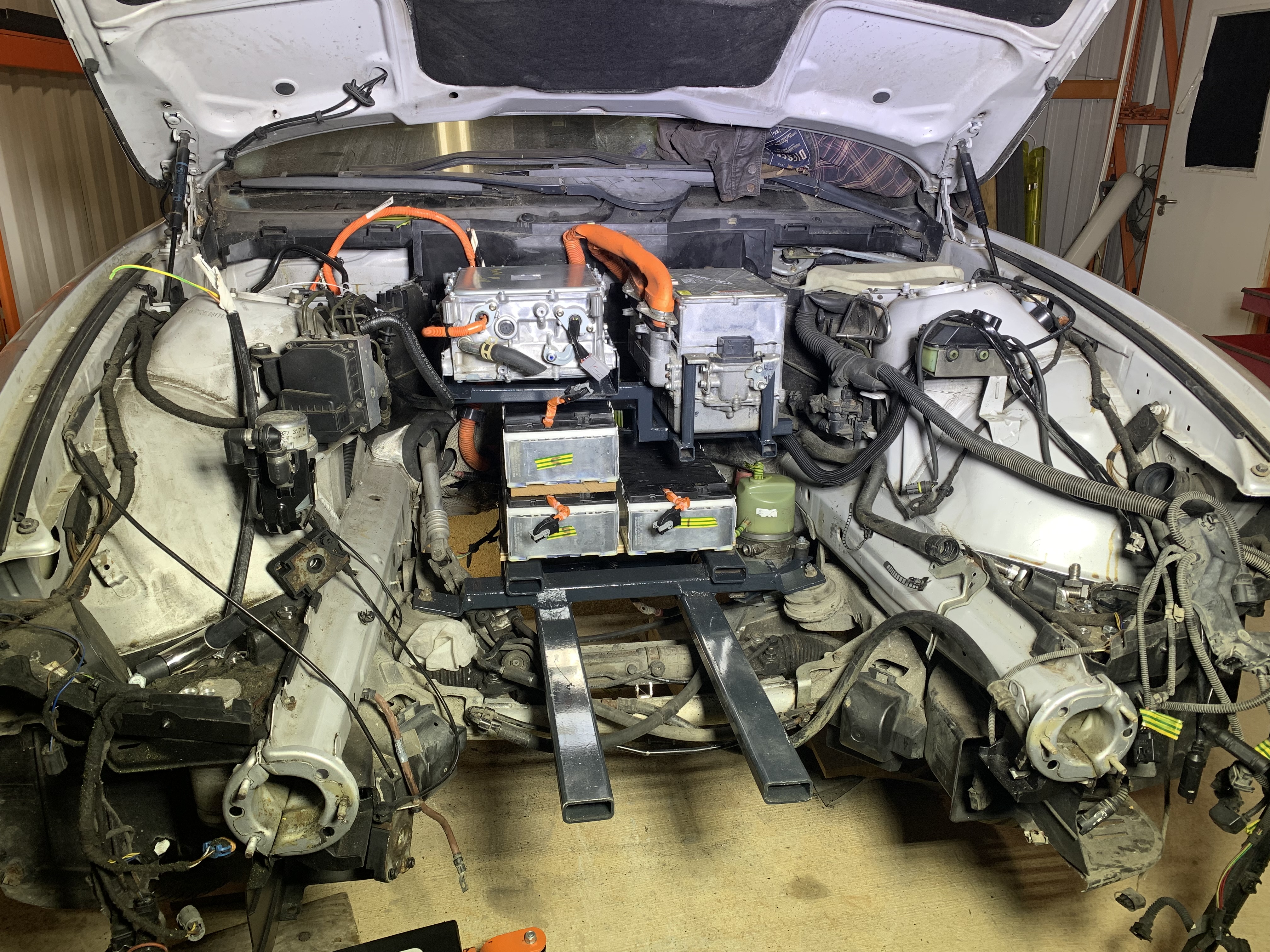

MG1 Locking plate removed
inverter and outlander charger in position

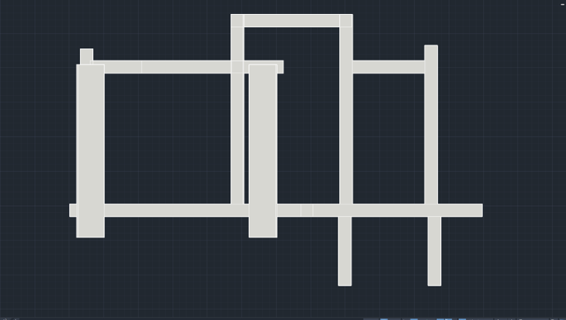

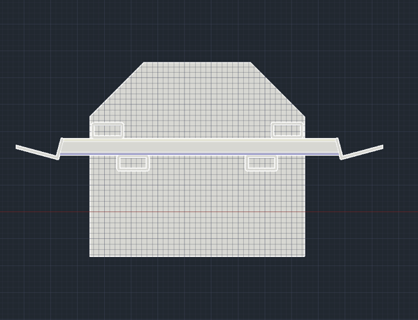

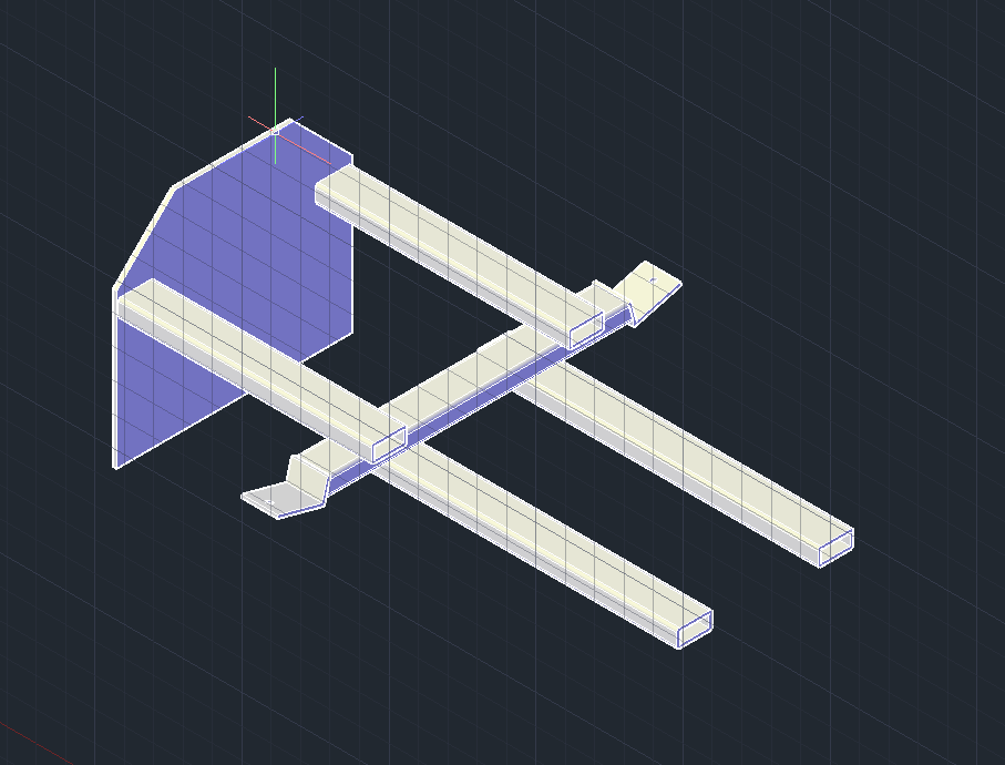

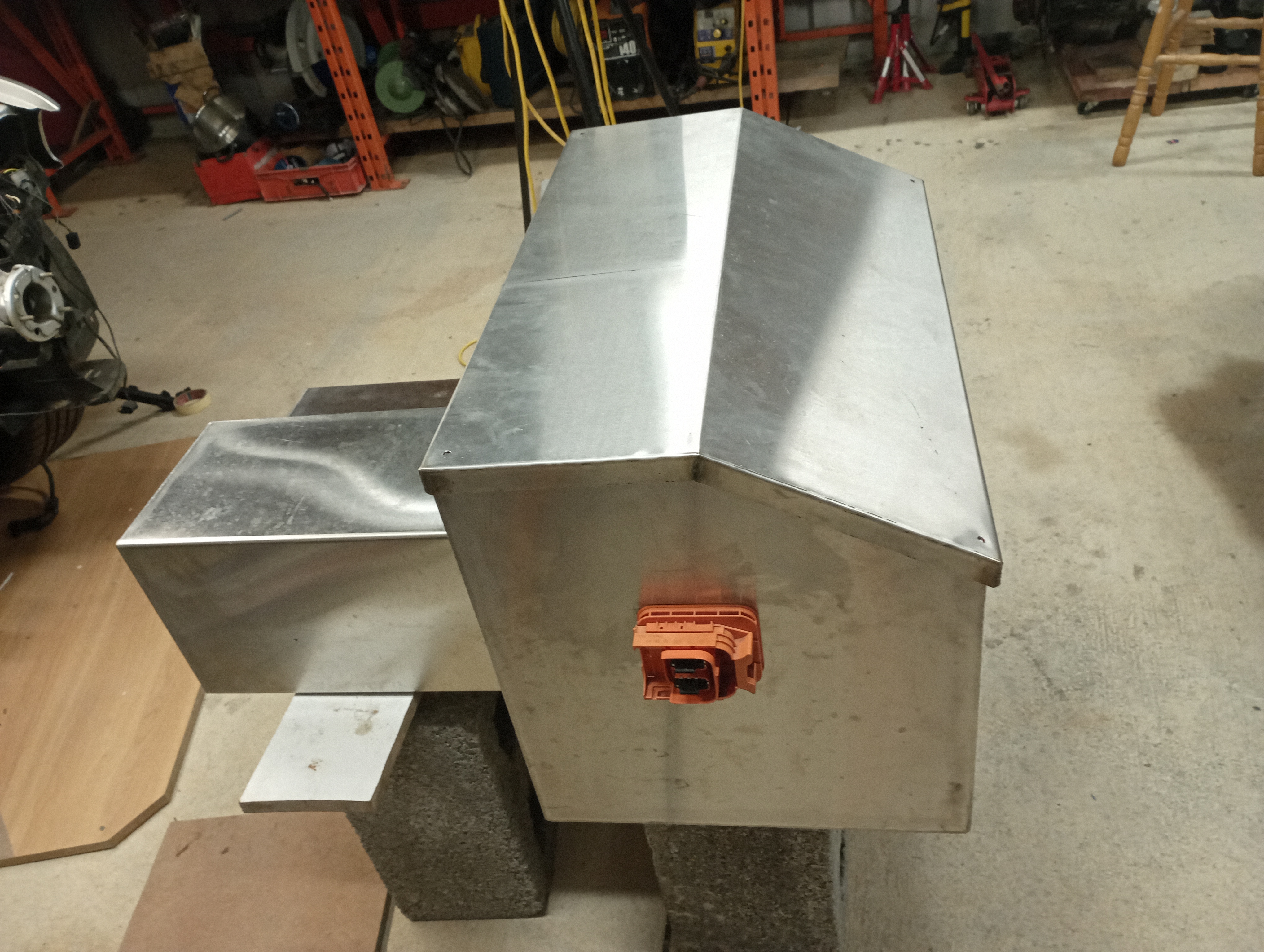

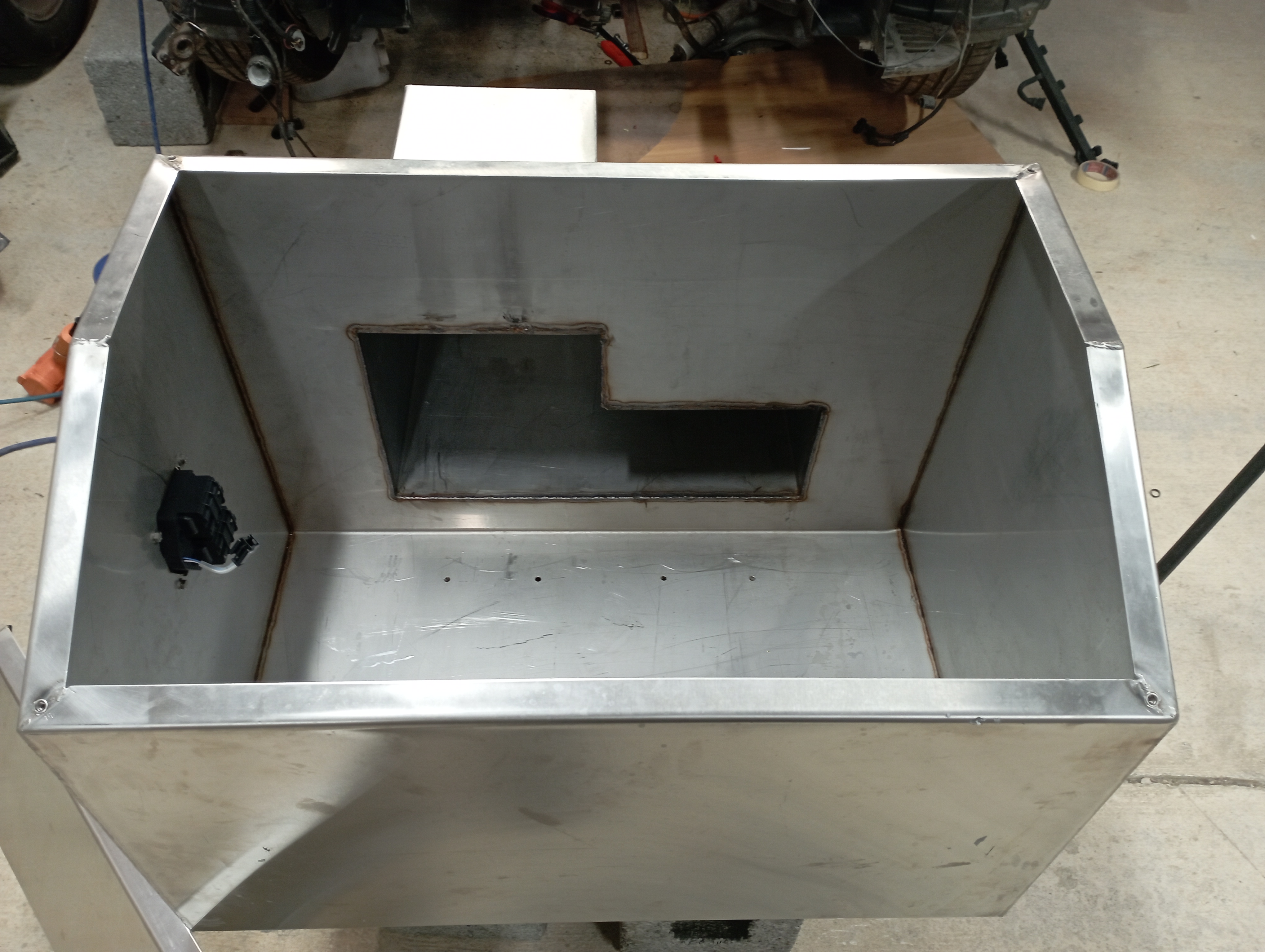

I am in the process of building a battery box to hold 12 BMW Phev batteries . Three under inverter and charger and then three stacks of three to the front.

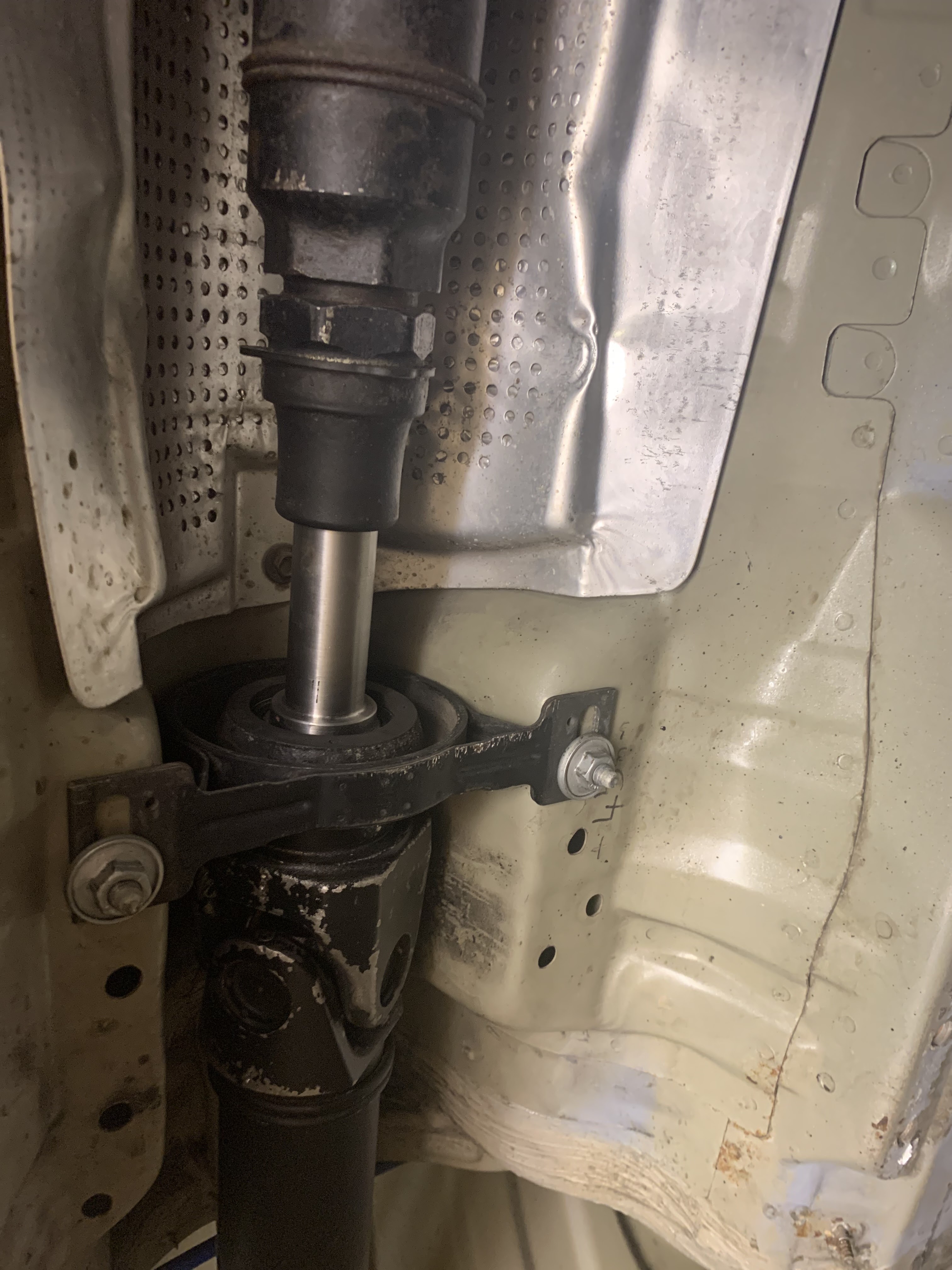

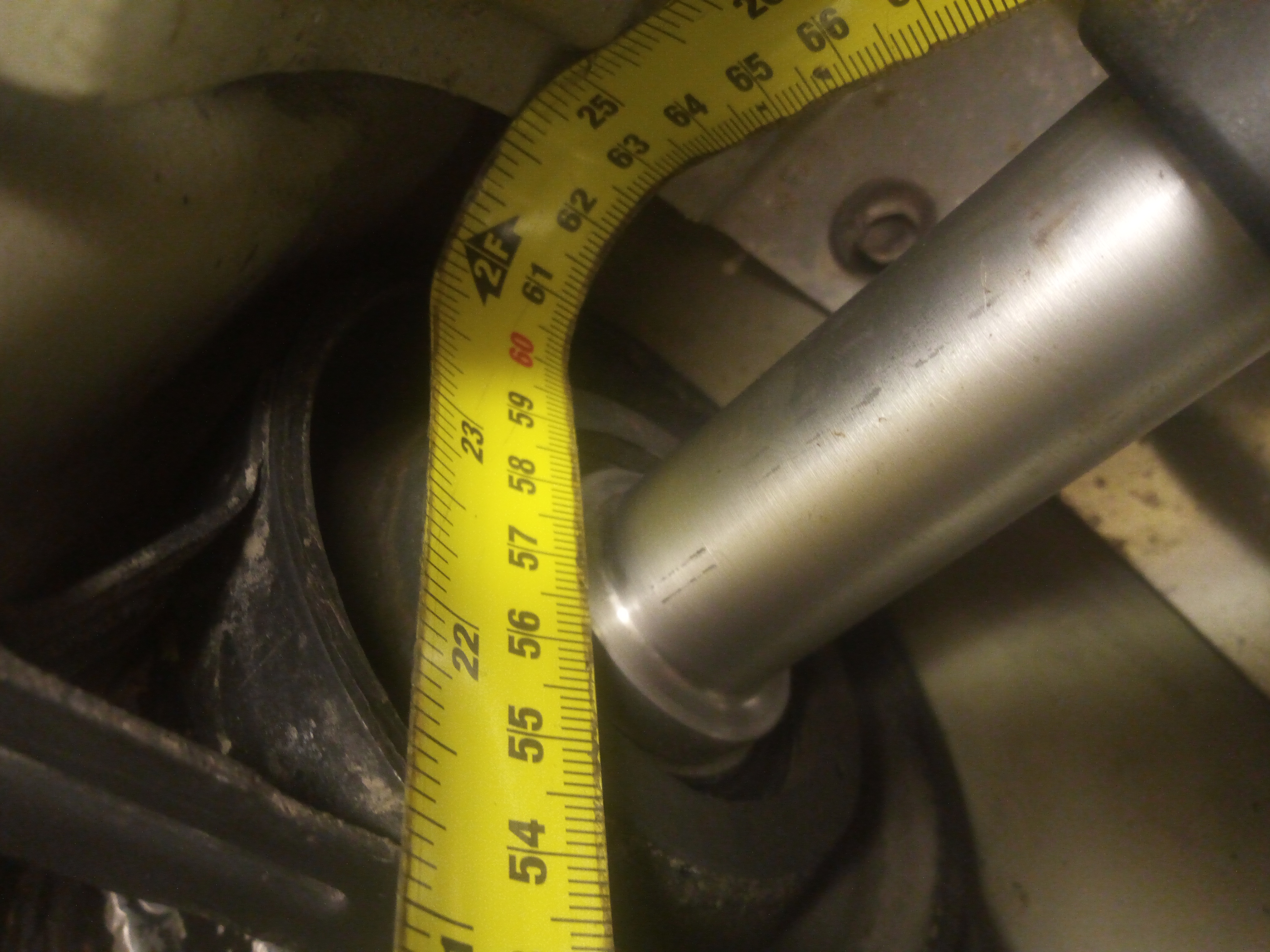

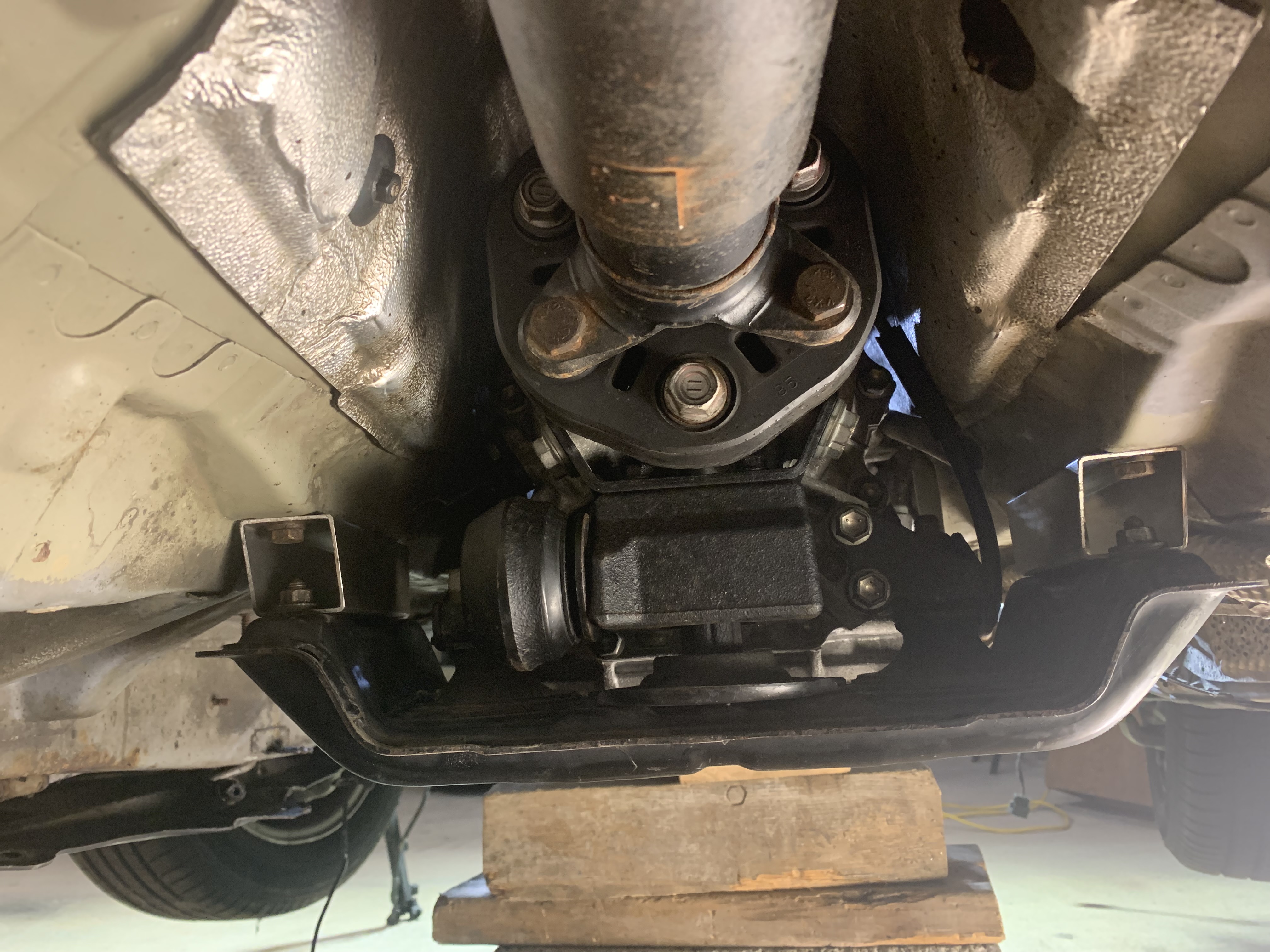

Wish my transmission came with the mounting bracket, currently trying to source one or fabricate something.
How did you go about aligning the output shaft flange?
kev39
- Posts: 17
- Joined: Tue Mar 16, 2021 10:04 am
- Location: Dundalk
- Has thanked: 36 times
- Been thanked: 12 times
Re: [ WIP ]Bmw e39 + GS450h
The car is up on blocks and is reasonably level, the floor is in good shape. So I measured from ground to the centre of the Propshaft beside the bearing to get my target centre point and I also made sure that the transmission was level using the bell housing vertical front surface and a spirit level. It took three attempts with the brackets, the first ones were 28mm, then 50mm and finally decided on 40mm

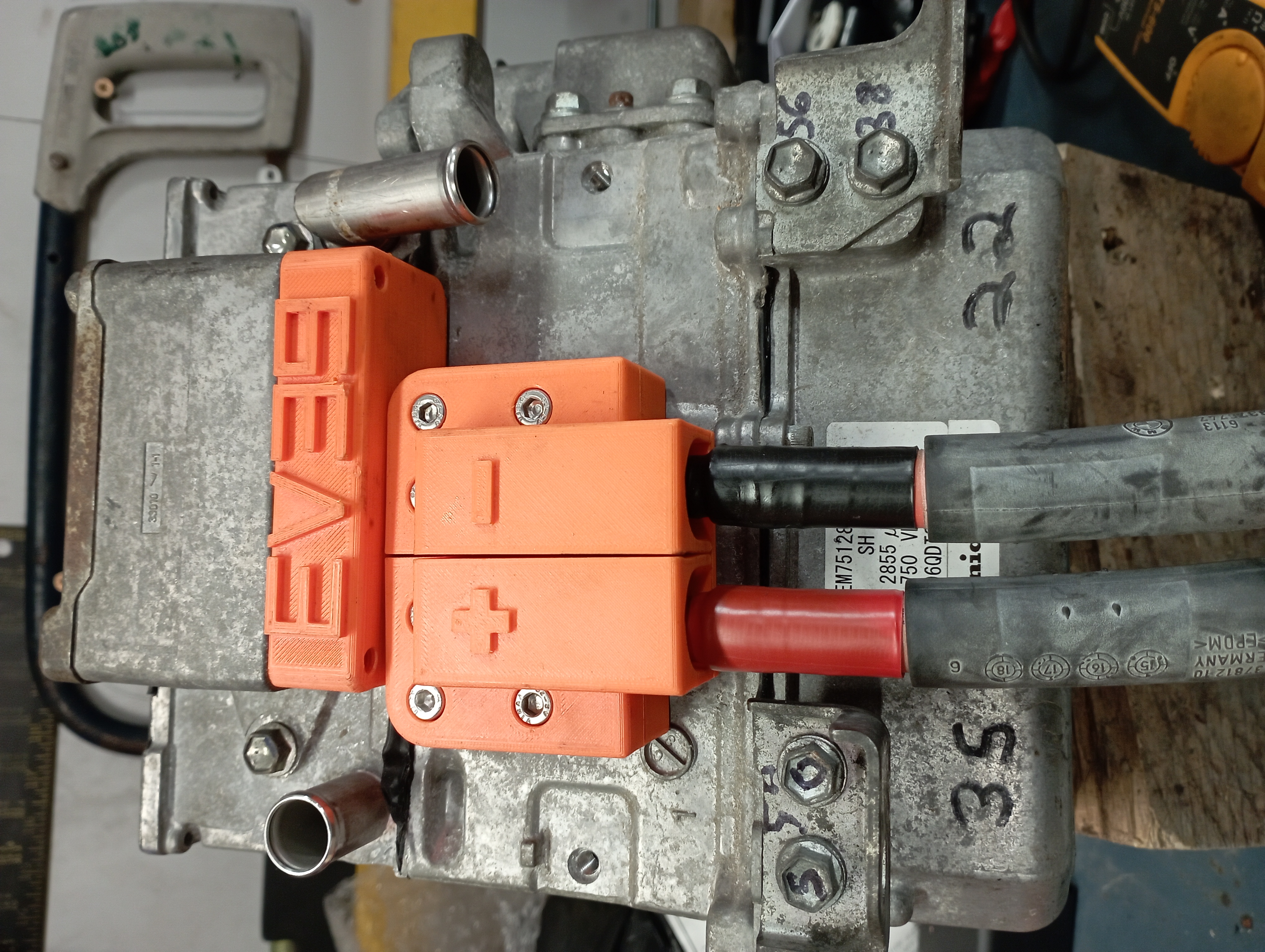

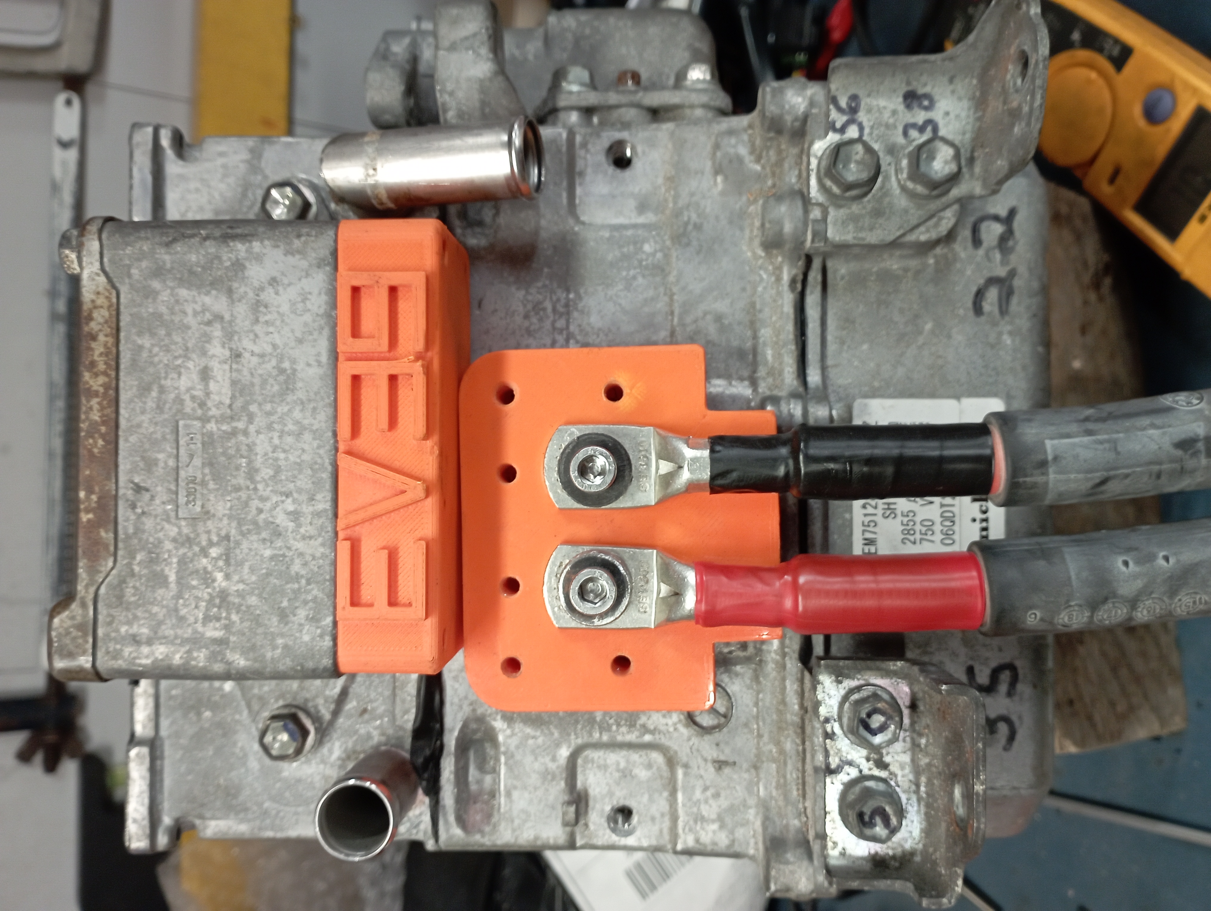

Making slow progress, got the HV cables for the sbox, inverter & battery box sorted, happy them them. Just having issues getting the zombie and sbox to communicate.
Still haven't got to experience the motor first spin
Can anyone advise what parameters will run the Zombie without a shunt or sbox when manually switching pre charge and main HV
Would it be udcsw ,udcmin & UDC lim at zero
I have attached the STL files for the inverter plugs.

The STLs for those parts available? I like the needing of bolts to get to the HV

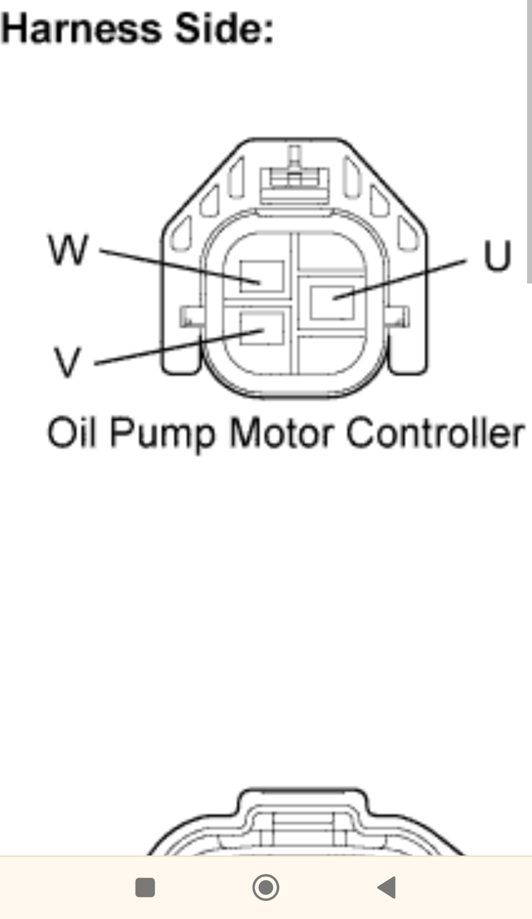

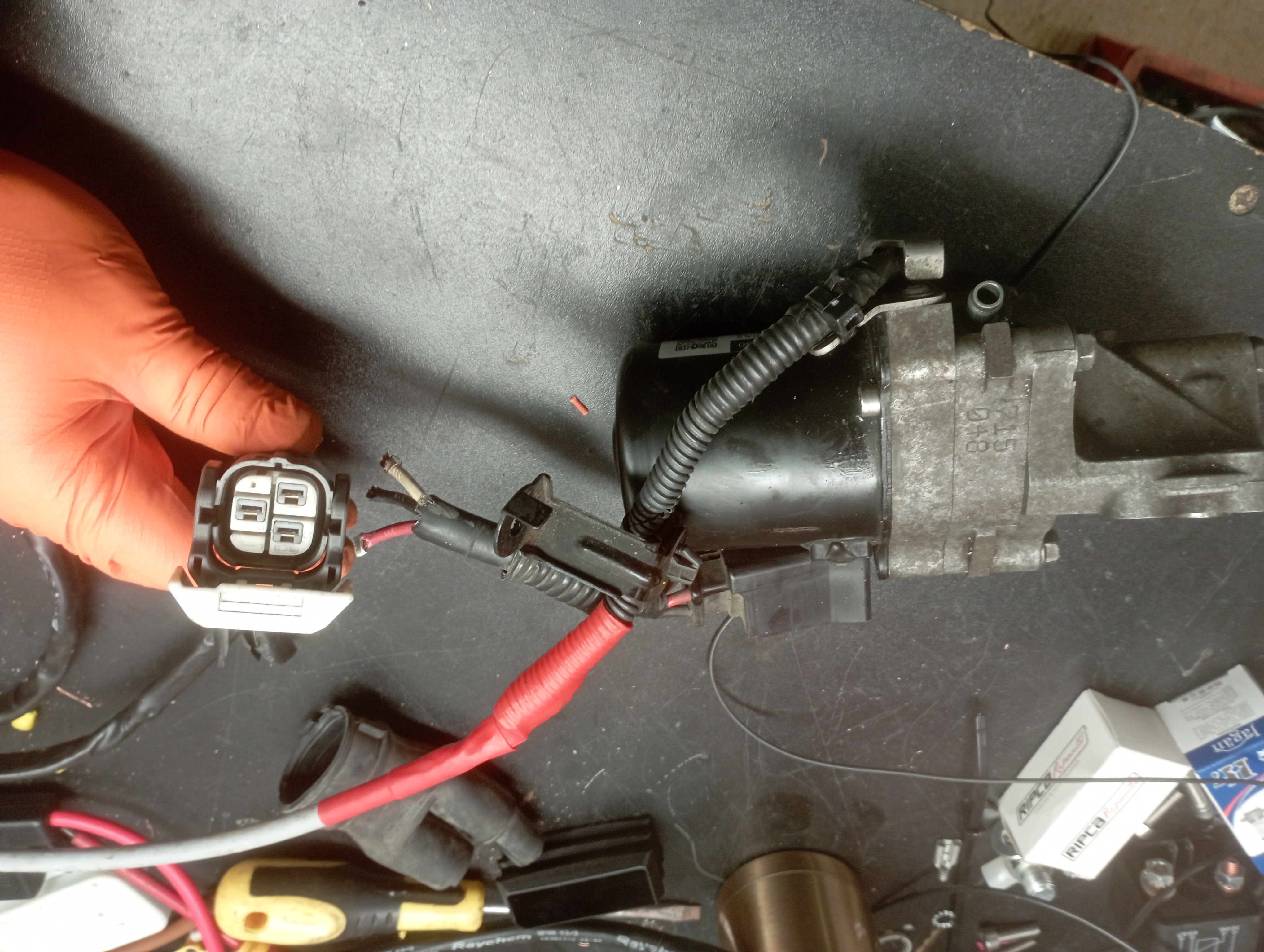

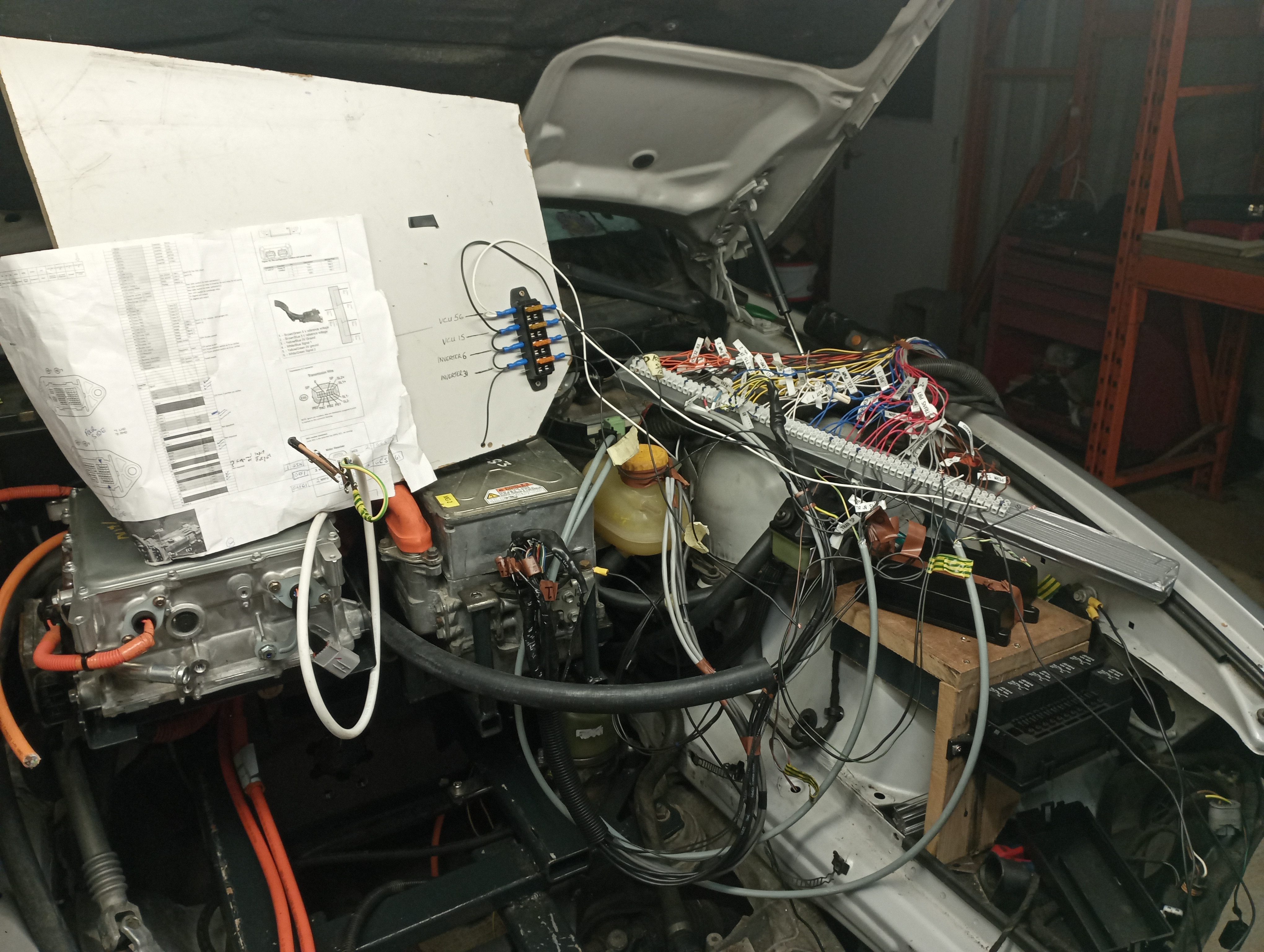

My zombie and the Sbox are happily communicating and the wheels are now spinning. So the project is moving the right direction. The next challenge that I am facing is with the oil pump. It's not running correctly , one second run then it stops for twoseconds then it runs again for about one second
I have changed the bearings, no change
Then I bought a second pump controller, no change.
Battery at fully charged at 13 volts.
I am now thinking maybe my wiring harness which I made up is wrong and I have the three wires Red, White & Black wires hopefully in the wrong positions.
Does anyone know what the correct positions for these wires should be.
W
V
U
All suggestions welcome
W
V
U
Jacobsmess
- Posts: 836
- Location: Uk
- Has thanked: 480 times
- Been thanked: 137 times
Red to W, white to V black to U.
Do you have the controller wired correctly also?
1 blue
2 green
3 yellow
4 red
5 black
Then the big connector on the controller needs the black PWM wire to the zombie and 12V with the controller body being grounded.
1 blue
2 green
3 yellow
4 red
5 black
kev39
- Posts: 17
- Location: Dundalk
Thanks for the help with the oil pump wiring.
The problem was that the ground wire was to small.

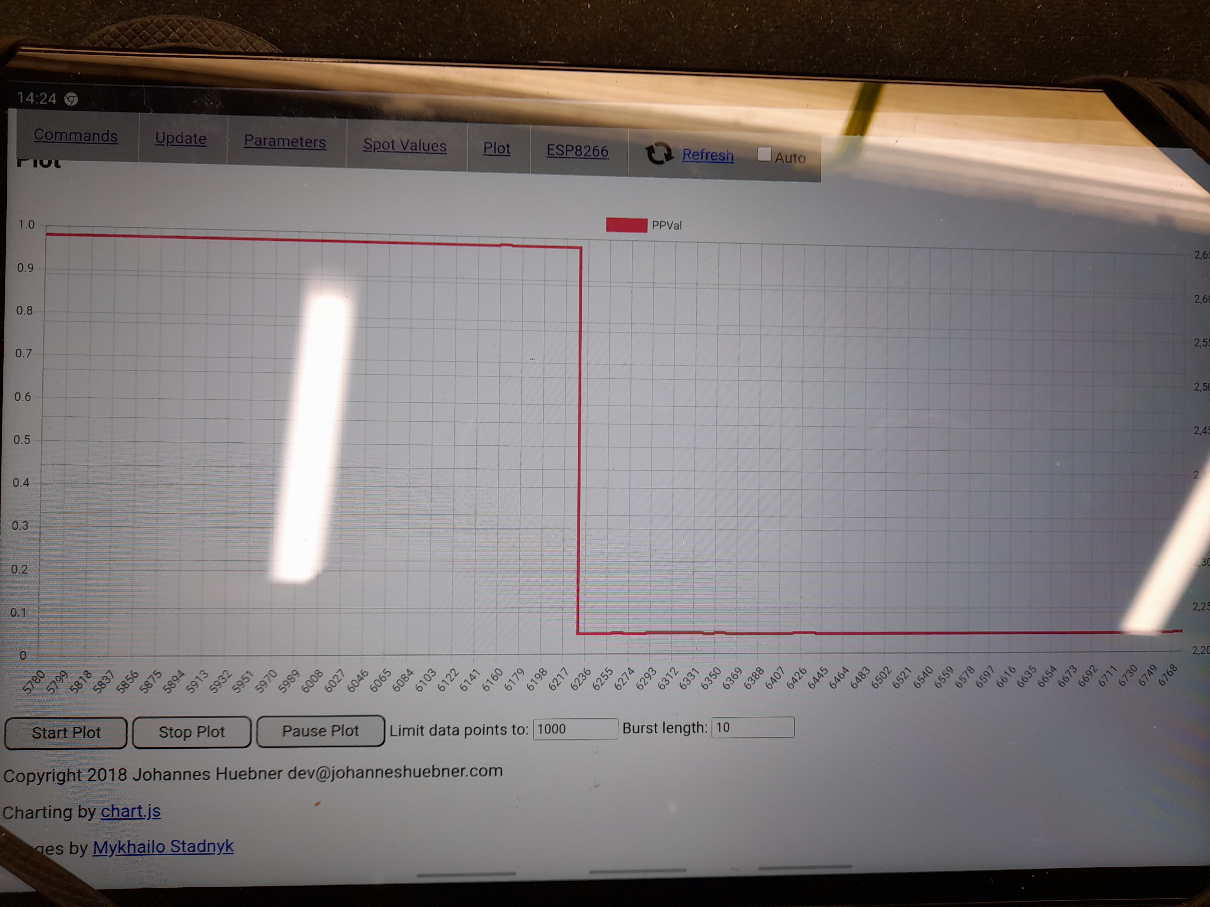

I have been trying to get my Mitsubishi charger set up with the phev batteries and sbox.
I have the Type 2 port and the Zombie is seeing the charging Cable but haven't been able to get the zombie to go into charge mode.
If this is working successfully in a project I would really appreciate if the zombie parameters required be shared or sent to me by PM.
I have been playing with this for weeks and have ran out out of ideas

The CPC is the only device connected to the charge port. It needs to be setup to the user manual: https://docs.google.com/document/d/1fxL ... ue&sd=true
The Zombie will go into charge mode when commanded via CAN by the CPC.
Do not have anything else set to charge related inputs. Possibly the Outlander charger currently does not work as it should, the up coming release will fix alot of compatibility problems.
