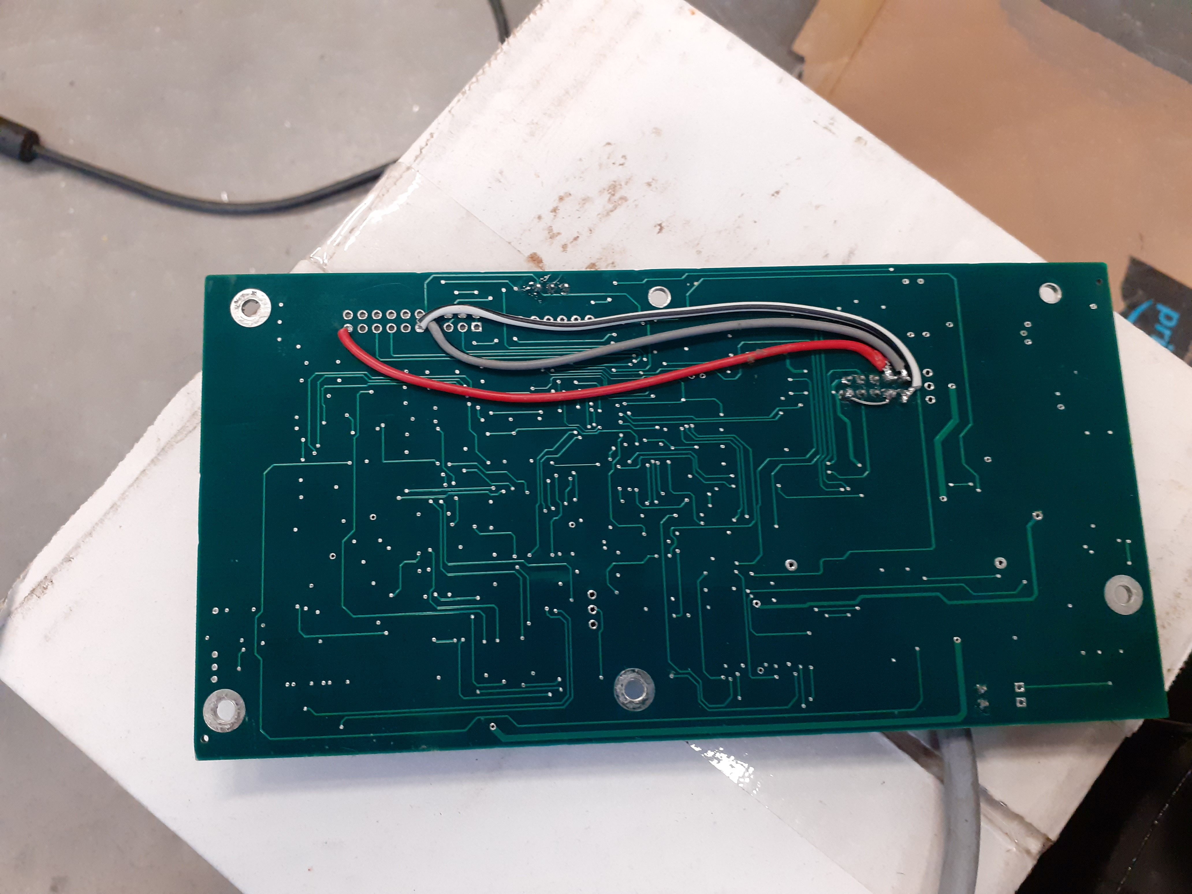

After my coolant problems I decided to get new board from shop. I soldered the legs and they seemed to be fine. Not touching and connected to board. But yesterday, when new motor was installed and everything was good to go, the first problem was OVERVOLTAGE. OI webinterface showed 550V even though battery was at 270V. So I adjusted udcgain, and ended up setting it to all the way to 11.5. Which seems very high, considering the default is 6. That cleared the OVERVOLTAGE error.
Pressed the accelerator, wheels barely moved and motor made bad clunking sounds. I remember having that when I first tested LDU and my encoder pins were reversed or in wrong pins, or not connected. So I thought maybe the encode pins need to be swapped. So swapped those, but same thing. Then tried to disconnect the whole encoder connector with exact same results. Same clunking sound and wheel barely move.
I had the latest release v5.32.R and remembered that there was some issues with rotation direction etc. I decided to downgrade back to v5.27.R if that would help. But no, still same results. Even tried with another encoder (speed sensor), still stuttering.
So the last thing to do, was to pull out the motor again, and put the old card back in. After about an hour, we were at the same situation with old card. Power on, and wheels turn normally! Phew! Drove the car home and all good.
But the question remains, what can cause this? I copied all the settings manually from old board and I could not spot any parameter differences. Tried different boosts, fweaks, ampmin etc, no change.
Maybe it's related to that Voltage/udcgain issue? CAN-bus worked, and so did everything else. Can the board itself have an issue? Is this common? It's a board with separate wifi-module. Ordered it about 1,5 month ago.
Any ideas, what can cause this?

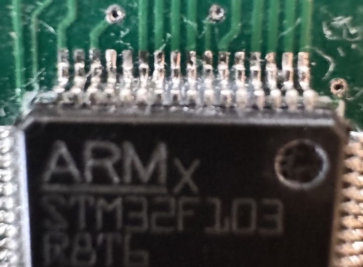

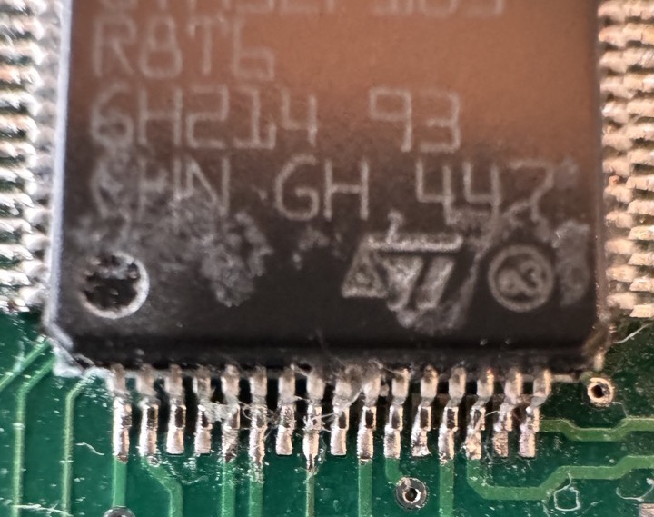

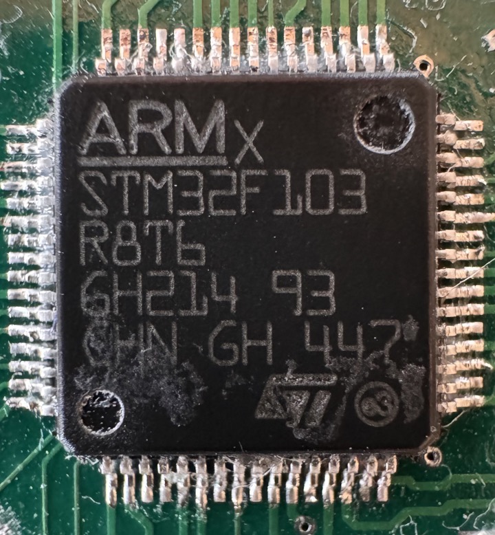

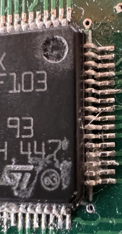

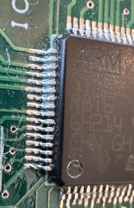

Can you post a close-up of the processor region. I have a suspicion.

Close up pictures from CPU. I think there is some flux residue between the cpu legs, could that be an issue or can you see something else?

Oh no, that is one of the chip crisis boards that came without stm32 and I fitted it myself. Tested all the digital and some analog signals but not all.
Which order number was this? If it's not easily fixable I'll send out a new one.

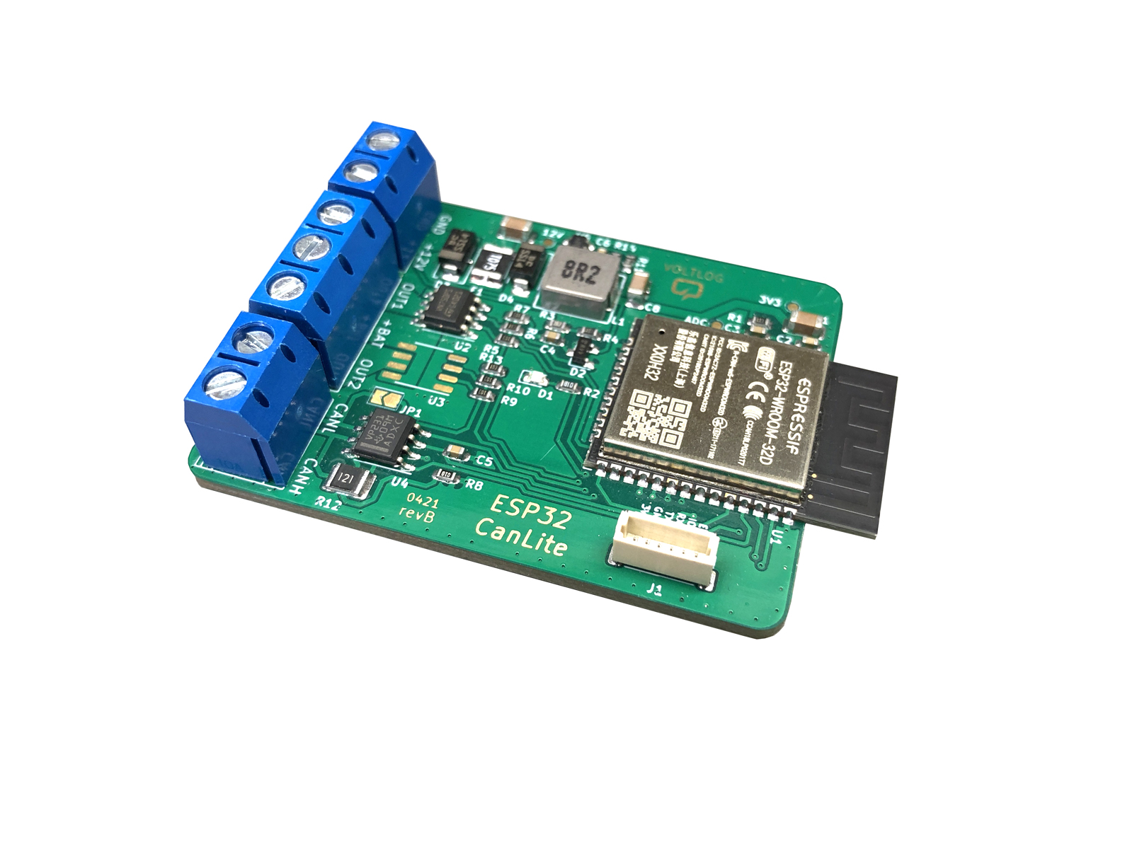

A CAN wifi bridge will be in the shop soon. It's based on the CanLite but has an SD card slot instead of the high side drivers.
Some info on the software here:
