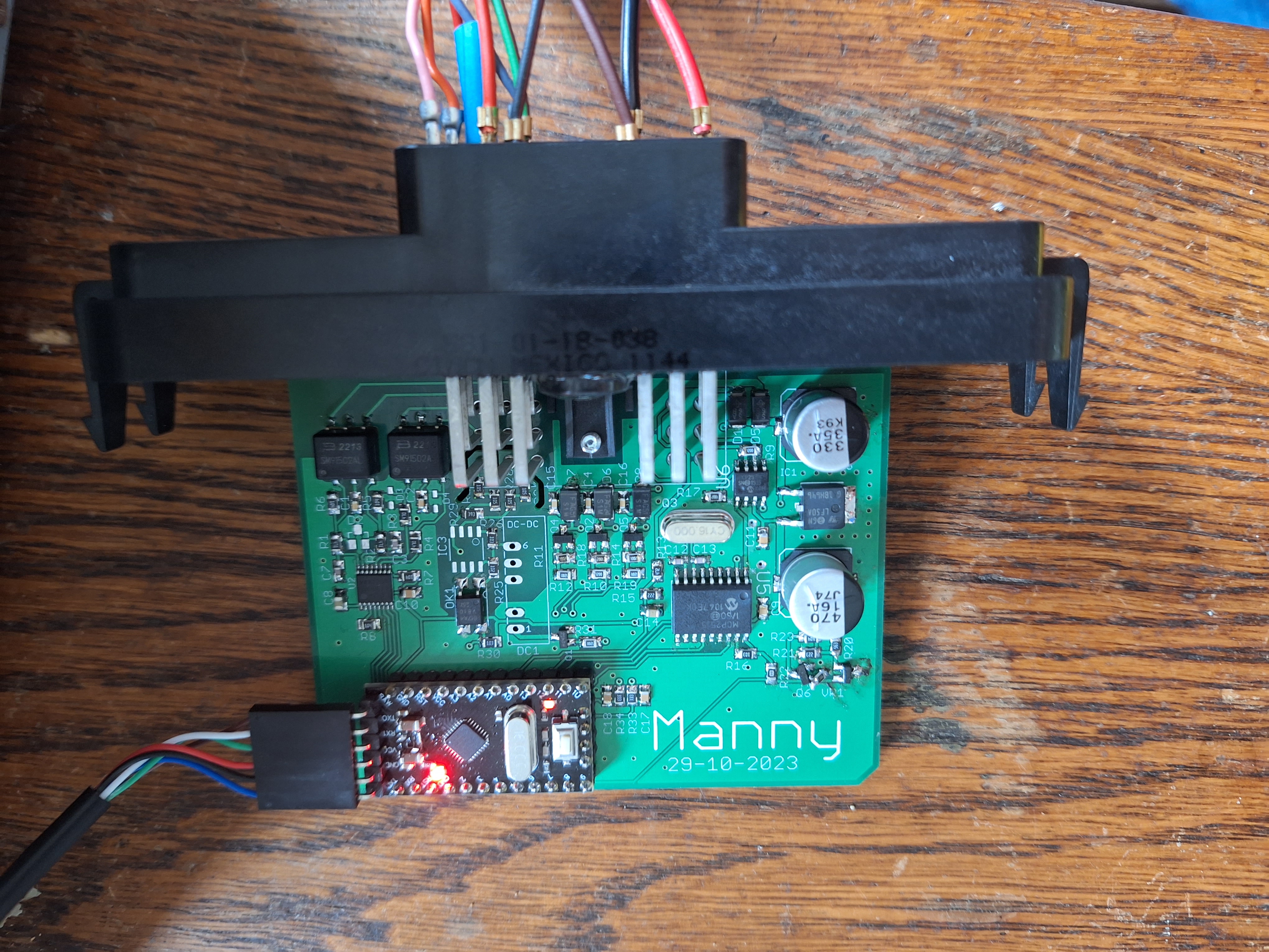

Success! i can see the voltages on some cells but then it seems to crash soon after.
There is a cell reading zero in the middle so i assume that as this is also sometimes used as a 72 cell bms in other models the one they didnt use was the middle cell?
good to see some data starting to come through
Attached log
Edit: got the crashing under control, was a just a hardware issue with the int pin, seems to read consistently and updates.

I think the cells are connected in the same manner as the PHEV-bms, i.e. pos 1-4 and 6-9 and not pos 1-8 for each chip.
That means you need to roll back some of the early changes.

I tested the BMS using Torque and an ELM Bluetooth adaptor before i began and it showed all cells and they were all 3.6 range,
I just checked the individual cells on the input connector with a meter and they all seem fine end each module is outputting 58v on the bus bar.
If it was a fault in the CMU would that not be one whole horizontal row not the end cut of each one?
Could it be that the top cell is being read by something higher than 9? it does have 12 channels on each chip
The only thing i don't have per your schematic is the SHDN pin connected to the atmega and is just pulled high.

That was the same as before so i went looking to find where the measurement was failing, after pouring over the datasheet I set mesureeen to 0x11FF and i got this:

Yes, that is also what I discovered and changed in the last SW I posted but with all chanels enabled.bigmotherwhale wrote: ↑Thu Nov 02, 2023 2:36 pm That was the same as before so i went looking to find where the measurement was failing, after pouring over the datasheet I set mesureeen to 0x11FF and i got this:

I would suggest:
writeAllSlaves(0x12, 0x00FF, true); // Set MEASUREEN, Enable cell voltages 1-8
and
writeAllSlaves(0x1E, 0x0008, true); // Set TOPCELL, Top cell for measurement is 8
Turning of aux1 (you stated previously you don't have any external temperature sensors, correct?)
Also turning of cell9 as it is not used, to avoid it to falsely trigger fault bits, as per maxim recommendations.

"writeAllSlaves(0x1E, 0x0008, true); // Set TOPCELL, Top cell for measurement is 8"
Yes i also changed this already to get it working.
I dont have any temp sensors, will have a look at disabling them. how do i change the bits D12 and D13 in the mesureen value? I dont understand how to do this.
How would i turn off cell 9? wont the topcell number do this?

Looking at register 0x12 (MEASUREEN). If you want to set just bit D12, that corresponds to 0x1000 or translated to binary 0b 0001 0000 0000 0000. Every digit in hex coresponds to 4 bits in binary. D0 is the first digit, right most digit. D15 is the left most digit.
If you want to set cell 1-8 enabled and then also enabled D12 and D13, in binary 0b 0011 0000 1111 1111, in hex 0x30FF. Using the "calculator" (in windows or linux) in programming mode let's you visualize this in a good way and also translate from binary to hex or decimal for that matter.

First of all great work on this code!
Very happy I can reuse the bms slave modules
I have a complete e208 pack. So i needed to change the code.
The e208 pack consists of 18 modules with 6 cells each.
Got the original code and the latest code posted. I used notepad++ to make a diff. To be able to find all the changes made.
To make the code less hard coded I adding a couple of variables
Not sure that i got all the hard coded bits.
The split in cell layout in the original code is hard to code for, so I removed it
Also made a board to fit in a waterproof housing
The DC DC converter and attiny are missing but on their way.

tidy setup, do you have contactor control on that board? I think this will need to be changed to reflect the number of modules and whether they are series / parallel
