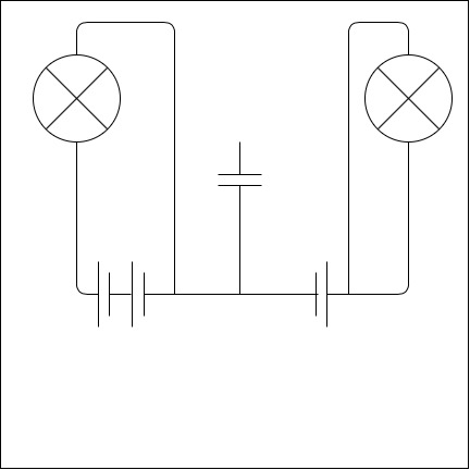

This is something I think is rare to see documented, perhaps because it's a "loose ends" type of thing which only happens when people get their drivelines built and batteries installed. And then once the car is running, "nothing is as permanent as a temporary solution that works well enough". Or, perhaps, just lack of motivation to return to forums and document things. I've been scratching my head about this kind of stuff lately too, good to see some discussion on it.
I'm not overly familiar with diagramming standards, but, it looks to me like in your "complete" diagram, you're forced to use the radiator, no? Shouldn't the loop feed back into the inverter, rather than the radiator? Else how does the system add hot fluid to the secondary loop with the cabin heater?

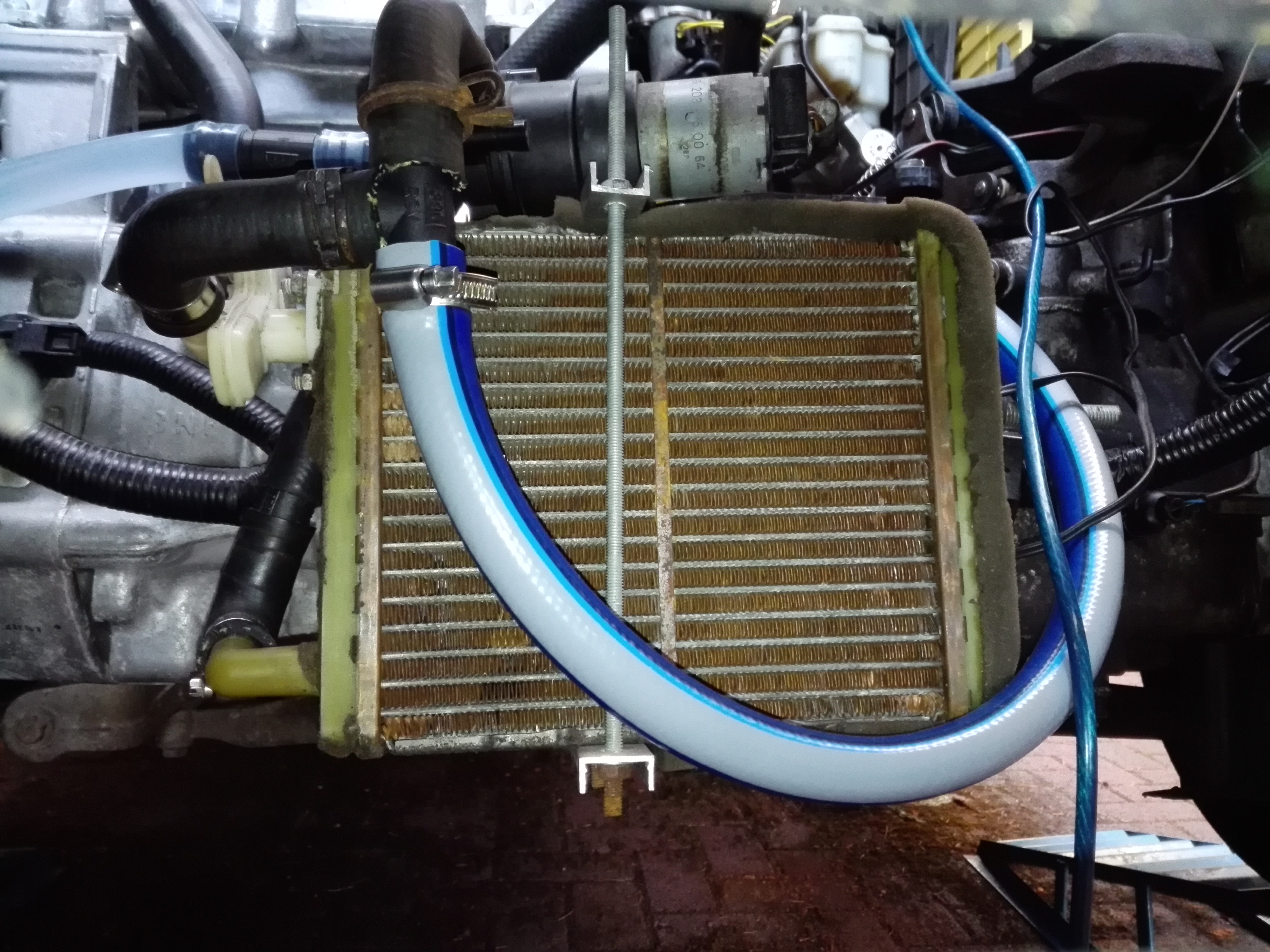

rikohm
Posts: 29
Joined: Tue Feb 26, 2019 8:08 pm
Location: Piteå, Sweden
Re: Series/Parallel cooling loops
Post by rikohm »

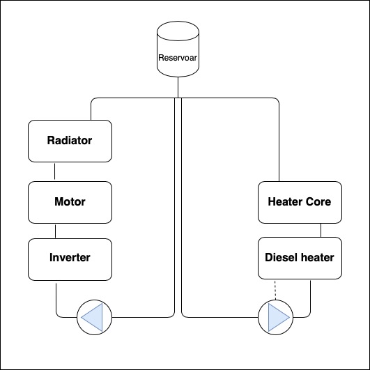

Substation 1 has one tank and two systems for now...
I had it in series first but didn't get enough heat from motor and inverter to make a (positiv) difference on cabin heating, they more likely acted as radiators and made the heater work harder...

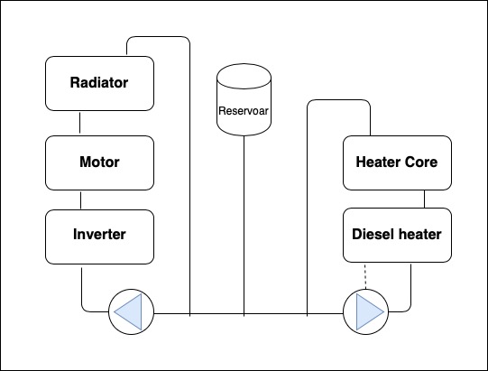

I am interested in your reservoir setup, there are a few things which confuse me.
How do you bleed the system without water actively passing through the reservoir? How do you release trapped air?
There is a bleed vent on the top connection of the heater core, but yea, I have had to bleed it a couple of times before I got rid of the air. Inverter circuit bleeded itself.
What happens when both pumps are running? Is there a transfer of fluid between the two systems?
Only from thermal expansion.
I can't imagine that this system, which is two loops that share a tank, would function properly unless there were valves of some kind to prevent unwanted flow of fluids.
It's only a schematic view, maybe easier if redrawn?
There is a difference between the schematics and the car, I removed the radiator to have room for the diesel tank for the heater... Have to fix that before summer..
