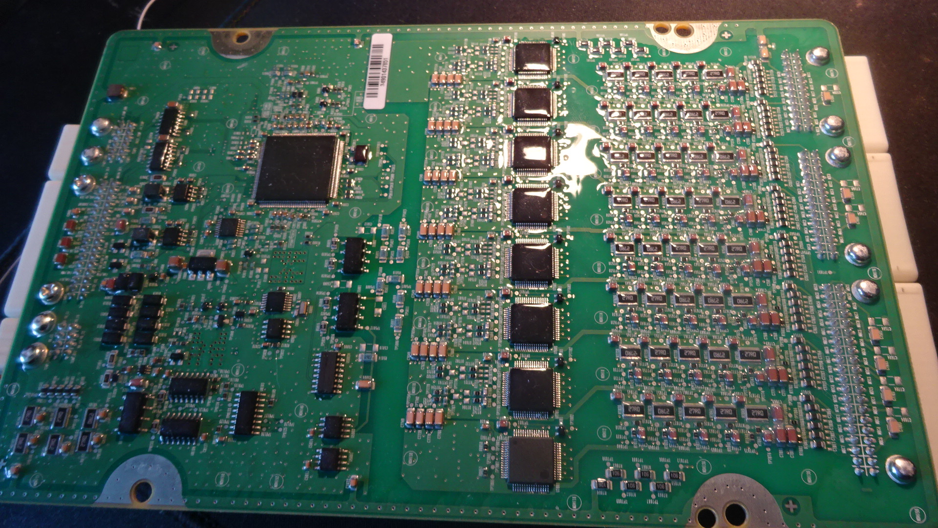

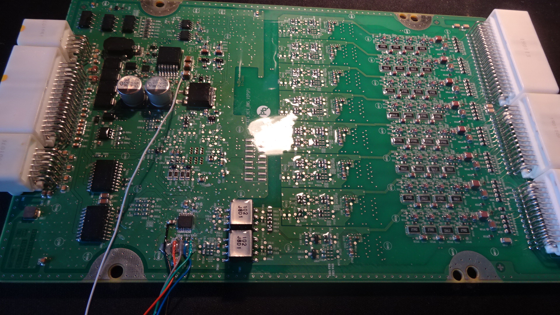

Hello, im trying to use your code and an Arduino to patch into a HEV BMS from a niro as i have been unable to find the CAN commands for the contactors, I have connected to the spi and i think im getting them to talk but the board design is different to that of the CMUs, It has 8X max17845 chips onboard.
I tried playing with the code but i dont know what im doing, and I keep getting "error byte cleared" in serial.
Is it possible to get this to work? could i get some help.
Thank you
Thank you
- bexander
- Posts: 897
- Has thanked: 78 times
- Been thanked: 102 times
Re: Kia Niro BMS
Yes, this seem to be a integrated BMS, interesting.
So you have connected via SPI to the onborad MAX17841, correct?
My SW is hard coded to 12 slaves with 4+4 cells connected at pos 1-4 and 6-9. This will have to be changed to 8 slaves with 9 cells connected.
The number of slaves also determines the value of check byte so this have to match.
Please provide a serial print out of your results so far, helps a lot for me to determine your progress.
