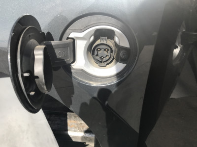

So it appears that the Proximity Pilot signal was meant for untethered charging stations, meaning ones with no charge cords hard wired to them. All the charge stations I have seen in the States have the cables attached so no wonder this concept was a bit foreign to me.
PP (Proximity Pilot) – For Detachable Cable Assemblies
When a tethered cable is attached, the maximum current advertised by the EVSE should naturally not exceed the maximum capability of the charging cable. In this case, the maximum current is hardcoded, and the PP line is normally not connected back to the EVSE electronics.
However, when an EVSE accepts detachable cables, it must first determine the maximum current carrying capacity of the cable. This is done via a resistor mounted in the plug between PP and PE of the detachable cable.

Inversly PP is also the pin FIRST unplugged when removing the charging handle from the EVSE socket. This provides enough time for EVSE relays to disconnect power so it will stop charging safely.
In the USA you use J1772 standard which has a resistor divider built in. You need to press the button and insert the plug into the car socket. This then will signal the car to innitiate charging. See the divider in "EVSE connector" side of the schematic.
If you press the button (unplug 330R resistance) charging will stop. However there is a step built into the J1772 vehicle socket which will push on the latch when inserting the plug - helping you activate EVSE.

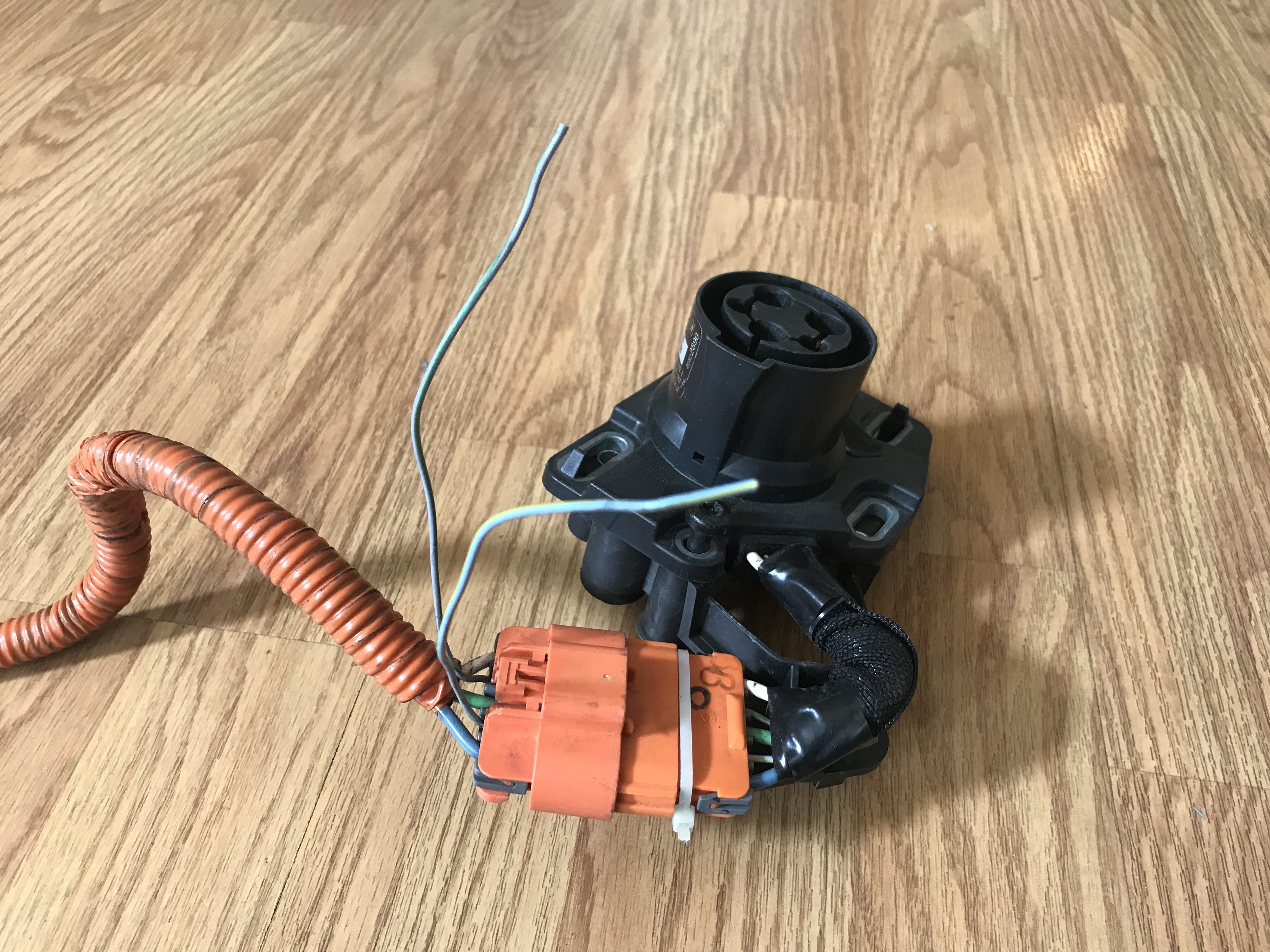

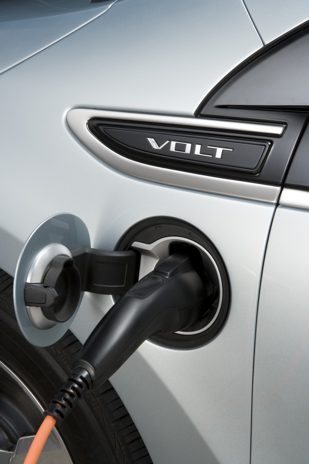

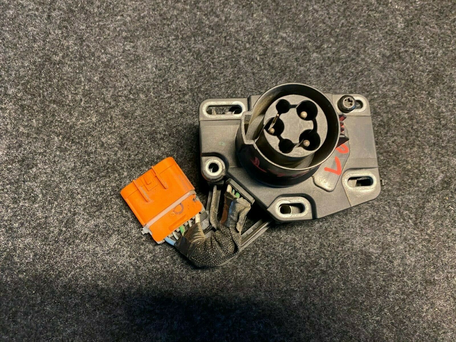

Well this just keeps getting more and more interesting. I went out and bought the J1772 Active Vehicle Control Module AVC2 - For Public Charge Stations from EV West
and the first thing they tell you to do is to "Measure the resistance from the PROX pin to the GND pin on the inlet connector before it is connected. If it measures 2740 ohms you have the resistor already ... "
Wait what? Are you telling me the 1st Gen Chevy Volt charge port already has a built in Proximity signal resistor?

It is inside the socket moulding. I use one J1772 socket in my Mazda and when i wanted to use PP signal in EU style control i couldnt use the plug button to stop the charge. Finally i had to add one pullup resistor which was just high enough to keep the signal over 0.8V detection threshold when i would connect the plug and use the button.

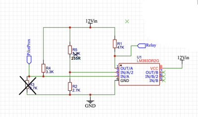

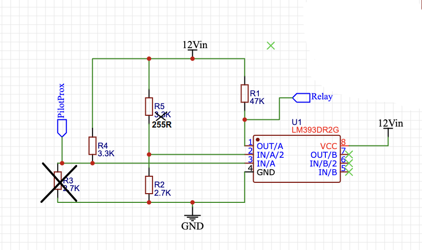

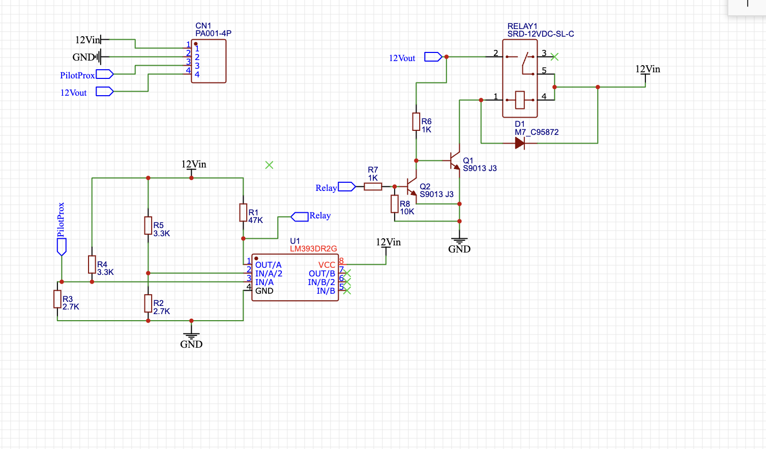

So thanks to Jamie Jones who heard the cries for help on Facebook a comparator LM393P is winging it's way here so with any luck we'll have a working setup sometime next week.
This is/these are the circuits he sent me but it should be easy to find more on t'Internet if I struggle.
Also I ordered 5 JIC.
Alibro
- Posts: 1112
- Location: Northern Ireland
- Has thanked: 504 times
- Been thanked: 322 times
Re: Newb Asks: Why Do We Need A Proximity Pilot Signal For Our EV Conversions?

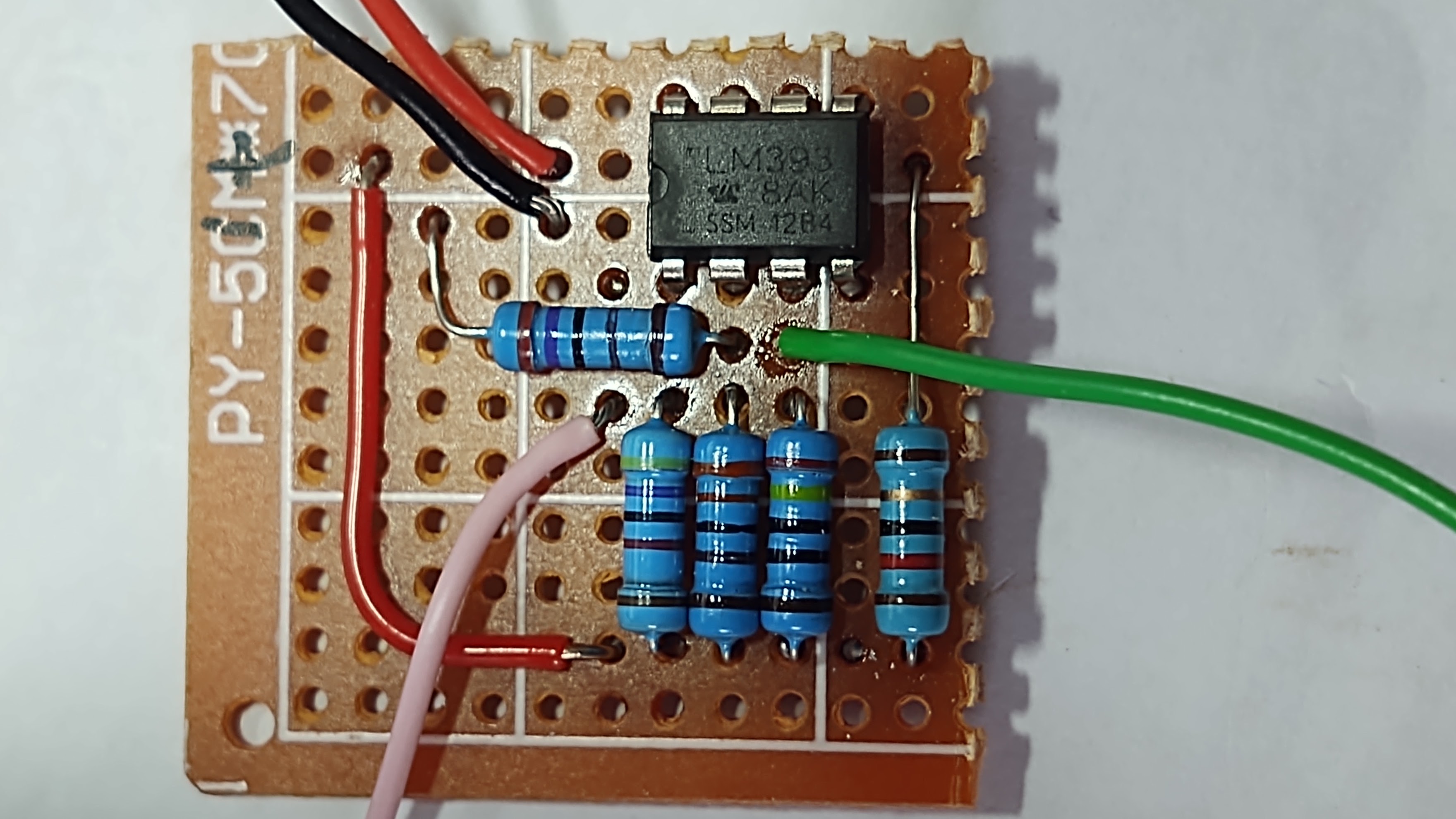

So after a bit of messing about I came up with a circuit that works well enough to turn on the relays when the charger plug is inserted and turn off the relays when the catch is pressed on the J1772 handle so that I can't pull the handle out with the current still flowing.
In my case the J1772 socket already has a 2.7k resistor going to ground built into it so I took that out of the circuit.
I also found that with 3.3k resistor in the voltage divider circuit from 12V to pin 2 the relays were on all the time even without the cable plugged in. I tried changing the 2.7k resistor but couldn't get the circuit to trigger when the catch was pressed so changed the 3.3k resistor instead. I used a POT fo figure out what the ideal resistance was and it ended up being 255R. I didn't have a 255R resistor have so used a 240R and 13R in series which was close enough.
The relay module I'm using is a 12V 8 way block that can be set to trigger on a neg or pos signal.
https://amzn.to/4hroiOX
This is it on some strip board and so far it's working so now I need to work out how to implement it.

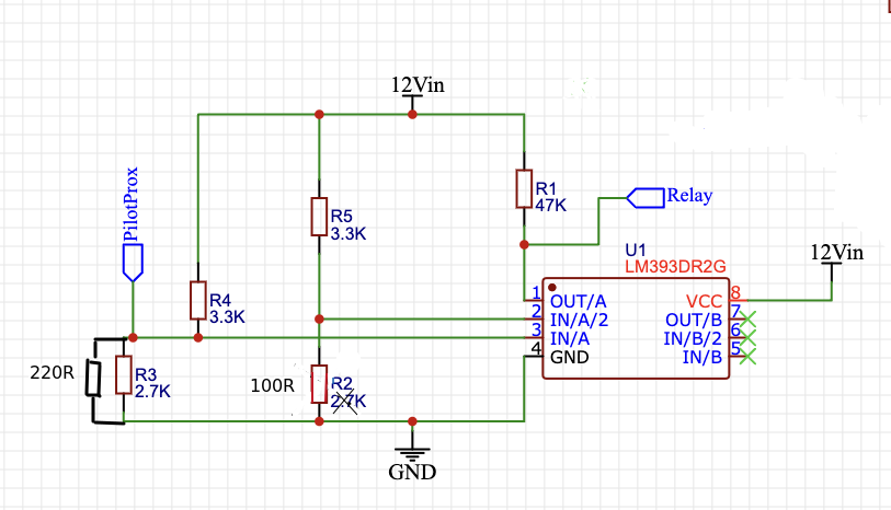

Finally after weeks of procrastinating and quite a few hours testing I managed to get this working at a public charger.
I had to change a couple of things but this is the circuit I came up with.
It's basically the same as Jamies original except R2 is replaced with a 100 ohm resistor and a 220 ohm resistor is connecting PP to chassis ground.
The voltage divider now triggers when the J1772 plug is pushed all the way home and the handle switch closes.
The resistor R3 is already in my J1772 socket so I didn't need to solder it in.
I've tested the timer by setting it to charge overnight and all is working well.
The Arduino code is here
https://github.com/Alibro53/Uno-R4-Charge-Controller
I also wrote out a detailed description of the sequence required to start charging
