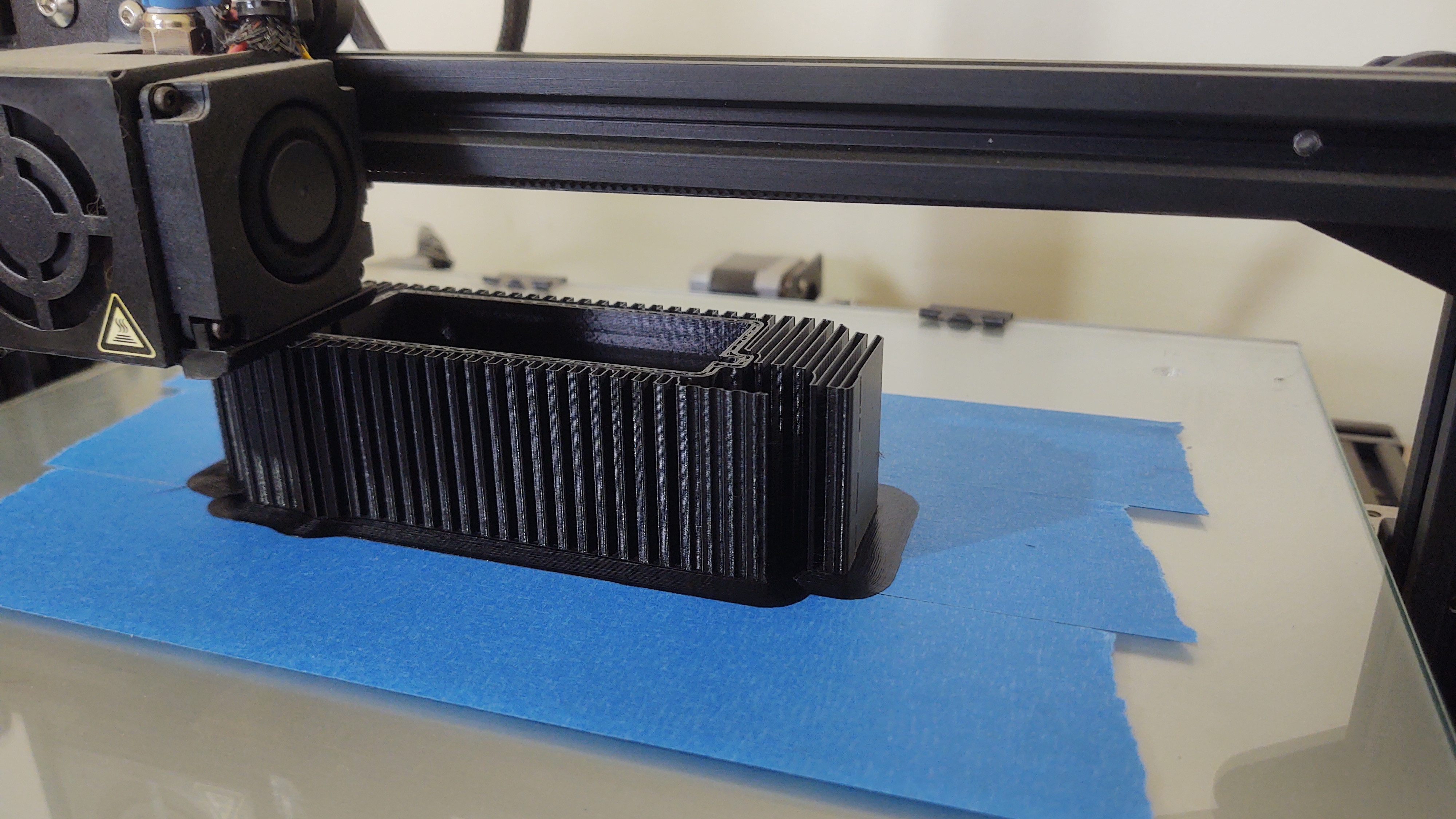

So a massive thanks to Bratitude for posting the STL file for this case. I printed it out over a couple of days and this is the result.
The last photo shows it after I removed all the supports but if you look carefully you can see a line half way up where I had to turn off the printer over night. I have a Creality CR10S which can restart a print after power off but it is not perfect and so restarted slightly off line but it's not a big problem as the VCU still fits fine.
I could have tried printing without support which would have been much quicker but didn't fancy waiting 10 hours or more to see if it would be OK.

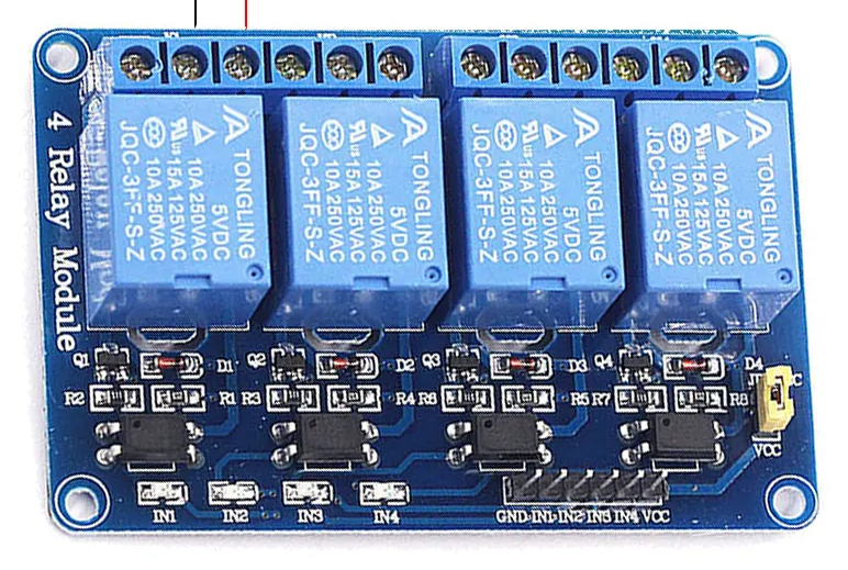

Once I got the cable issues sorted I concentrated on getting the timing right for turning on the inverter. For a while I struggled to get it to work reliably if turned off and on again but I think I've resolved this by using Output3 from the VCU to power the Inverter.
When I get it documented I'll post the sequence but I wanted to ask how others are using the VCU outputs to control startup.
I found the VCU threw a wobbly if I tried driving any kind of relay direct so instead used these little timer modules and this seems to work fine.
The VCU switches the negative on Outputs 1, 2 and 3 so I guess it didn't appreciate me shoving 12V Pos into it through the relay coil
I'm not using the timing function as they are all turned right back rather just as a way to use the negative output from the VCU. I guess one of the Arduino relay boards like the one below would do the same job and might be a bit neater.
Is this the kind of thing others are using?

I tried a relay module similar to the one above but for 12V rather than the arduino controlled one in the photo.
It works OK but for some reason the timer modules work more reliably.
What I mean by that is with the timer modules the inverter turns on correctly every time I turn the ignition on without fail. With the relay module sometimes it goes through the sequence OK but the inverter doesn't enable drive. Maybe there is a small delay even with the timers turned all the way back but whatever the reason I'm going back to them.

Alibro wrote: Fri Oct 06, 2023 7:50 pm I tried a relay module similar to the one above but for 12V rather than the arduino controlled one in the photo.
So the timing issues I mentioned above were not because of the relay module but are related to the dc to dc charger :?
I'm not sure why but if I mess about with timing of the charger startup, it effects the reliability of the inverter startup. I now have the car turning on and working every time I turn the key. :D I also have most of the startup driven by the VCU through an 8 way relay block similar to the one above. This means the VCU is controlling all parts of the HV system.

Alibro wrote: Tue Oct 03, 2023 10:38 am Once I got the cable issues sorted I concentrated on getting the timing right for turning on the inverter. For a while I struggled to get it to work reliably if turned off and on again but I think I've resolved this by using Output3 from the VCU to power the Inverter.
