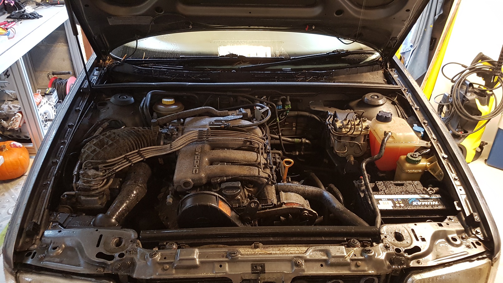

Hi all
After many a year talking about it, I have finally got the wheels turning on my first EV conversion. Following the diyelectriccar forum and evbmw intrepid adventures in the land of reverse engineering for a number of years, choice of machine to convert and decisions on how to power it were pondered. The plans got cranked up a notch after meeting Kevin and Damien over in Fully Charged Live 2019 and not long after, parts begin to be purchased in the shape of a Gen 1 Leaf motor, inverter, charge ports, plus all HV wiring I could strip. Soon after that, after months of looking both sides of the Irish sea, the right candidate in the shape of a 2.0l 16v '93 Audi 80 Avant came up. The right money, the right condition and the right colour What moved the project to go mode was the chance to enrol and take part on the inaugural EV conversion course at New Electric Irelands HQ back in September. It was around this time Damien started working on the Leaf powered E46 and that just looked like the perfect way to go. To see it in the metal and getting hands-on with it was gold. Within a couple of weeks I got hold of a 2015 24kWh LEaf pack from a donor with only 20km on the clock. State of charge as yet unknown but I have a Wolftronics Packsniffer 2 on the way to tell me its secrets. SO in a nutshell:
Gen 1 Leaf motor and inverter
24kWh Leaf pack
evbmw Leaf brain board
TRW PS pump
VAG UP28 aux brake assist servo pump
Tesla Gen 2 Charger with evbmw brain
Lots of other bits and bobs yet to be decided on - powerwatcher, cooling, building the main hv junction box, cabin heating, etc.
I kicked things off two weeks ago and rolled the reluctant patient into the theatre. The start was sort of enforced as I had put the 2.0l 16v up for sale... and it sold within 24hours so had to have it out quick smart. After starting under her own stream for weeks, it decided it did not want to and needed a helping jump and in she rolled. Two days later the lump was out The finished article? A big hole with the gearbox still in place. Couldn't help myself... just had to offer the motor up One thing I did notice that may make things a tad tricky is the subframe as the gbox sits about 30mm below the main crossbeam. It may mean standing the motor forward from the gearbox by 200mm to miss the main beam somehow. A lot of tricky fabrication, in essence, extending the bell housing which is an idea am not really entertaining just yet. Alternatively, there may be a chance that the Leaf gearbox may work here, some fabrication on the gearbox end of the half shafts. Will just have to offer it all up when I get hold of a gearbox I have been promised to see if there is enough room as the motor will sit in a transverse arrangement. I really do like this plan as it makes the drive system so much simpler... 'click' Forward... 'click' Reverse. We'll see in the next week or so.
Moving around to the back, I whipped off the towbar, exhaust and fuel tank. Some promising measurements from the vacated fuel tank cavity is that closely resembles the rearmost module set in the Leaf pack and may fit in one piece within a fabricated battery box that can be lifted or dropped when needed. The very deep spare wheel well may also be a good location for rear hv contactor box and safety's That's it for now. Sorry there isn't a lot of technical detail just yet but.... it's the beginning of a journey. Hope to fill in the gaps for you guys as I go and will also be calling on the vast experience here on the forum.
Fiachra

Re: The Audi 8e - Powered by Leaf
Hi Fiachra, outstanding work! The car looks great and you have really progressed quickly. I was on Damien and Kevin’s second course in October and would love to follow in your footsteps! I’m converting a 1991 Nissan Figaro, planning to use a Nissan Leaf with Damien’s VCU aboard in the same way (project Fig-Leaf coming soon to the openinverter forum).
If you’d ever like to meet up I’ll happily make the journey as it would be great to hear about what went well, what you’d do different and what issues you’re facing moving forward.
