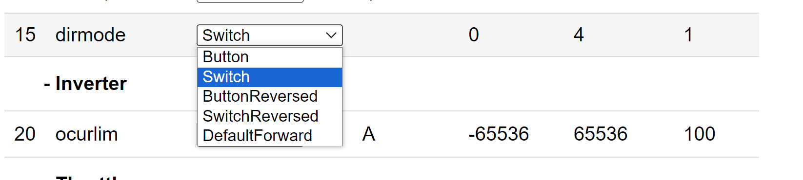

johu wrote: Thu Sep 14, 2023 4:33 pm Please test this, especially people who use the forward/reverse input. That topic should be settled for good.
Loaded this firmware to SDU V6. My direction is set by switches: dirmode:Switches. Forward and reverse are swapped i.e when seldir=Forward; motor spins in reverse and rotordir=Reverse and vice versa.
Has the option to swap signals in the UI been removed?
Edit: ok. I found that there's a signal swap option in the UI. Gonna test it tomorrow.

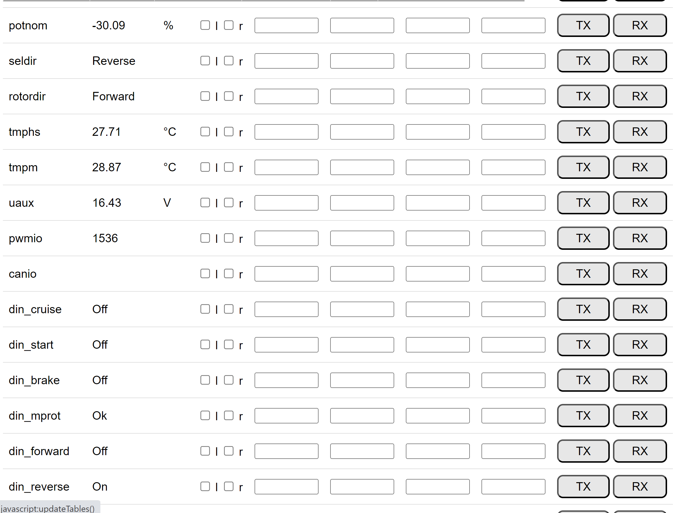

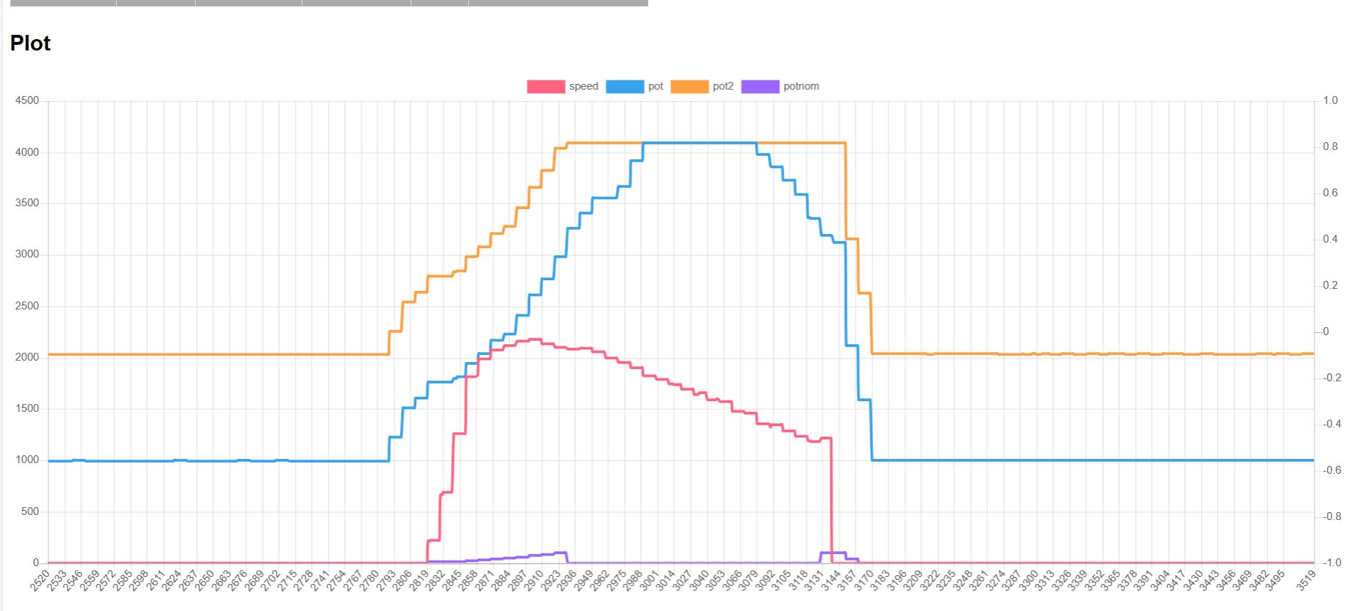

alexbeatle wrote: Sun Oct 15, 2023 2:58 am Loaded this firmware to SDU V6. My direction is set by switches: dirmode:Switches. Forward and reverse are swapped i.e when seldir=Forward; motor spins in reverse and rotordir=Reverse and vice versa.
Here you are. When dirmode:Switches, it spins in the opposite direction of the direction selection. Selected reverse, but spins forward in the below.
Posts: 5843
Has thanked: 164 times
Been thanked: 1063 times
Re: Inverter Firmware 5.32.R
Oh, that's funky. Could it be related to the reversed phase order that catphish had found?
I'm guessing this issue isn't new but now through revealing rotor direction it becomes visible.
It might not happen with FOC, will check later.
What would be the proposed fix? Correct phase order? Or introduce pinswap to sine firmware allowing to swap PWM channels 1 and 2?

Likely something else. Maybe throttle going out of range. Post your parameters here and perhaps a plot of potnom & speed
resocorp
Posts: 6
Joined: Fri May 01, 2020 8:41 pm
Location: Nigeria
Has thanked: 8 times
Post by resocorp »
Here it is.
  "iqkp": 32,
  "idkp": 32,
  "curki": 20000,
  "vlimflt": 10,
  "vlimmargin": 2500,
  "fwcurmax": 0,
  "syncofs": 32000,
  "lqminusld": 2,
  "fluxlinkage": 90,
  "syncadv": 10,
  "polepairs": 4,
  "respolepairs": 2,
  "sincosofs": 2048,
  "encmode": 4,
  "fmax": 200,
  "numimp": 60,
  "dirchrpm": 100,
  "dirmode": 1,
  "snsm": 23,
  "pwmfrq": 2,
  "il1gain": 3.18,
  "il2gain": 3.18,
  "udcgain": 3.78,
  "udcofs": 310,
  "udclim": 540,
  "snshs": 0,
  "pinswap": 15,
  "modmax": 37836,
  "potmin": 1000,
  "potmax": 3000,
  "pot2min": 1000,
  "pot2max": 3000,
  "potmode": 0,
  "throtramp": 100,
  "throtramprpm": 20000,
  "throtcur": 1,
  "brakeregen": -50,
  "regenramp": 100,
  "regentravel": 30,
  "offthrotregen": 0,
  "cruiseregen": -30,
  "regenrampstr": 10,
  "brklightout": -50,
  "bmslimhigh": 60,
  "bmslimlow": -1,
  "udcmin": 0,
  "udcmax": 400,
  "idcmax": 326,
  "idcmin": 0,
  "idckp": 2,
  "idcflt": 9,
  "tmphsmax": 150,
  "tmpmmax": 300,
  "throtmax": 100,
  "throtmin": -100,
  "accelmax": 100,
  "accelflt": 3,
  "chargemode": 3,
  "chargecur": 0,
  "chargekp": 50,
  "chargeki": 10,
  "chargeflt": 3,
  "chargepwmin": 10,
  "chargepwmax": 90,
  "idlespeed": -100,
  "idlethrotlim": 100,
  "idlemode": 3,
  "holdkp": -0.25,
  "speedkp": 0.25,
  "speedflt": 5,
  "cruisemode": 0,
  "cruisethrotlim": 50,
  "udcsw": 168,
  "udcswbuck": 224,
  "tripmode": 1,
  "bootprec": 0,
  "pwmfunc": 0,
  "pwmgain": 0,
  "pwmofs": 5000,
  "canspeed": 1,
  "canperiod": 0,
  "nodeid": 1,
  "controlid": 63,
  "controlcheck": 1,
  "manualstart": 0,
  "manualiq": 0,
  "manualid": 0
Posts: 5843
Yes, throttle goes out of range. You have set potmax=3000 where in reality it reaches 4095. Same with pot2.
