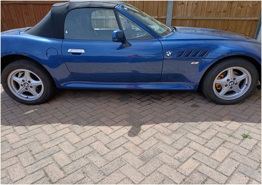

This is somewhat overdue but I started posting this project on the Z Roadster forum and it's very time consuming posting on several sites but now that the project is mostly done I thought I'd do a bit of cut n pasting and post a cut down version here
I've been a petrol head forever and this is my first EV conversion but in the past I've done lots of engine conversions and general modification including
Rover V8 into Ford Capri, Turbo 2l Capri, Fiat X19 turbo conversion, Individual throttle bodies, rearmount turbo and Air ride on my Nissan 350Z any way you get the idea
so this is my car a BMW Z3 99 2.0l manual in topaz blue
