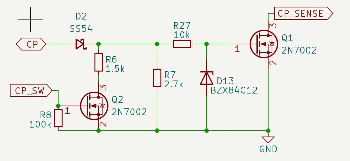

These are my updated (hopefully much safer) designs for 12V general purpose input, and CP input/output.

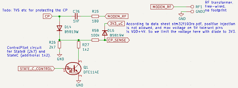

This looks good. I use an other way, hopefully also safe:

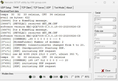

I have codico red carrier board. I have used stm32f4 to communicate with qca chip. I have used https://github.com/uhi22/ccs32clara. Can I make a ccs charge controller with this code. I know that I have to implement cp duty cycle and pp reading. How can I test stm32f4 and red carrier board as a pev side.
Also I have white carrier board EI. I have ran Seventax FreeV2G code. I have connected CP and PP pins to red carrier board. But I havent set connection between these modules. I have raspberry pi, 3 red carrier board, white carrier board EI. CAn you help me about testing ccs charge controller with these board? How can I test these boards
SLAC matching succesfull. Im using white carrierd board EI with freeV2G as evse side. stm32 and red carrier board as pev side.
/* our link-local IPv6 address. Todo: do we need to calculate this from the MAC? Or just use a "random"? /
/ For the moment, just use the address from the Win10 notebook, and change the last byte from 0x0e to 0x1e.
You wrote these comments in code (ipv6.c). Idont understand here. Can you explain
Also after slac matching succesfull. [SDP] initiating SDP request. I dont pass the [SDP] initiating SDP request. How can I do sdp
thanks

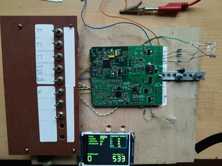

uhi22 wrote: ↑Sat Jul 08, 2023 11:32 pm I never did this before, and was quite insecure whether I have a chance to do this. But after watching some videos I understood it is easier then expected, when knowing the tricks. Flux is the key. And pre-heating the board to 100°C. And then hot air, and the part will float by itself to the correct position. Really amazing to watch. Ok, my first attempt went wrong, but nothing broken, just again flux, preheating, hot air, tip from the side, and it exactly jumped in the correct position. The next time will be faster I guess.
Ahh, and the 7005 is no real QFN, it is QFN with "wettable edges", this means we can inspect the solder connections. The real QFN is harder I guess, because you see nothing.
Yes, exactly. The SPI, the interrupt pin (which maybe is not necessary) and the reset, and some test points to be able to program the Flash.

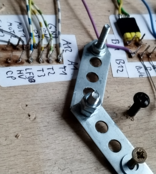

Something is wrong with this ugly board: No smoke up to now. It just talks to the ccs32berta. This went a little bit too smooth.

This is the plan. At the moment, the clara is heavy work in progress. The communication on PLC, some basic CAN communication and contactor driver is working, but other things like status LEDs, connector lock is still to be developed.xvyDFatih wrote: ↑Thu Sep 14, 2023 7:15 am I have used https://github.com/uhi22/ccs32clara. Can I make a ccs charge controller with this code.
I recommend to use pyPLC as EVSE to test the PEV side. This makes it possible to record pcap files of the ethernet communication, which are a big help to debug potential issues.
Sorry, I do not any experience with these boards.
I think you can ignore this comment. The question was, whether the IP address of the PEV needs to be calculated with a certain formula out ofxvyDFatih wrote: ↑Thu Sep 14, 2023 7:15 am /* our link-local IPv6 address. Todo: do we need to calculate this from the MAC? Or just use a "random"? /
the MAC address. My current understanding is: No, it does not matter. So I just took the IP address which my notebook uses, and changed one byte. The only necessary thing is, that the IP addresses of the PEV and EVSE should be different. Theres a high chance, that this is fulfilled.
The clara software sends SDP requests. The EVSE should respond to these requests. If this does not work, it would be helpful to have a log file of each side, and in best case a ethernet trace to see which side is sending which data, to understand, where the flow stops.

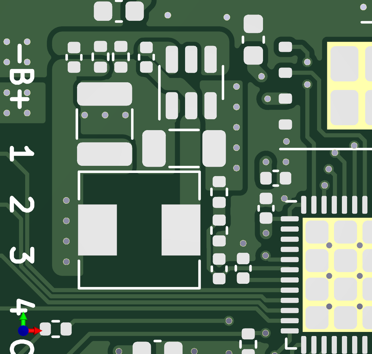

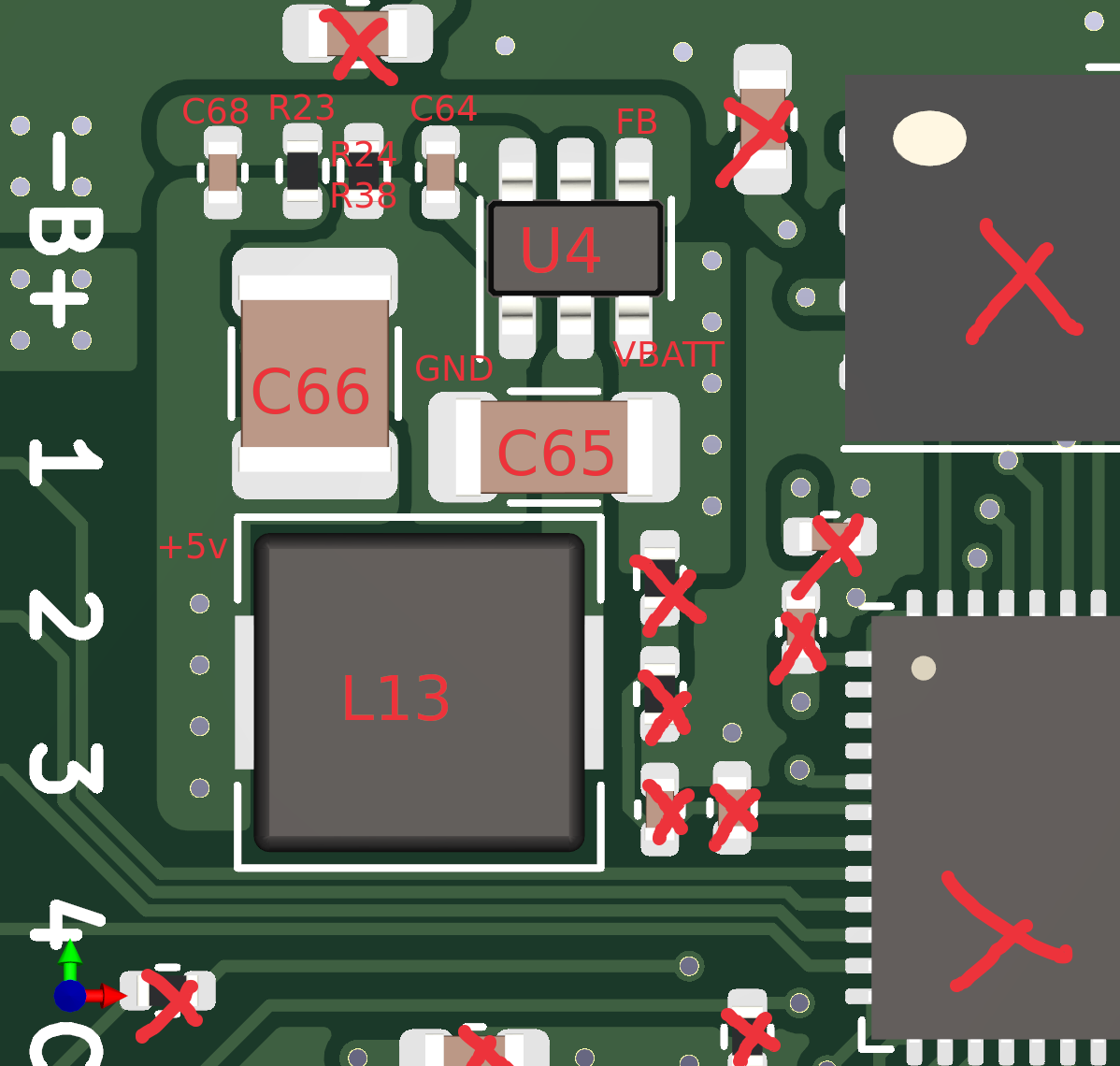

I've just had a look at the FOCCCI board (actually mostly just the buck regulator), and I would strongly recommend making some layout improvements here for the next revision of the board. In particular, the current paths for the input and output capacitors are much too long.
1) The input capacitor (C65) should be as close as possible to the TPS54302 (U4).
2) The output loop U4->L13->C66->U4 should be as short as possible.
3) There should be no copper under the inductor L13.
Please see attached my layout of this SMPS as an example. Feel free to copy it, or if you prefer, I can do a pull request for this. It would likely be easier to use the smaller inductor I suggested.
Apologies for the criticism, and clearly it works, and I'm sure more tidying up is planned anyway, but I definitely think it's worth improving upon this.

I appreciate this constructive feedback very much. Yes, would be great if you create a pull request. And yes, many details I did in a hurry, and are not optimal. There is definitety room for improvements. Currently I'm concentrating to finish a small batch of the V3 version, the boards run, software will grow.
