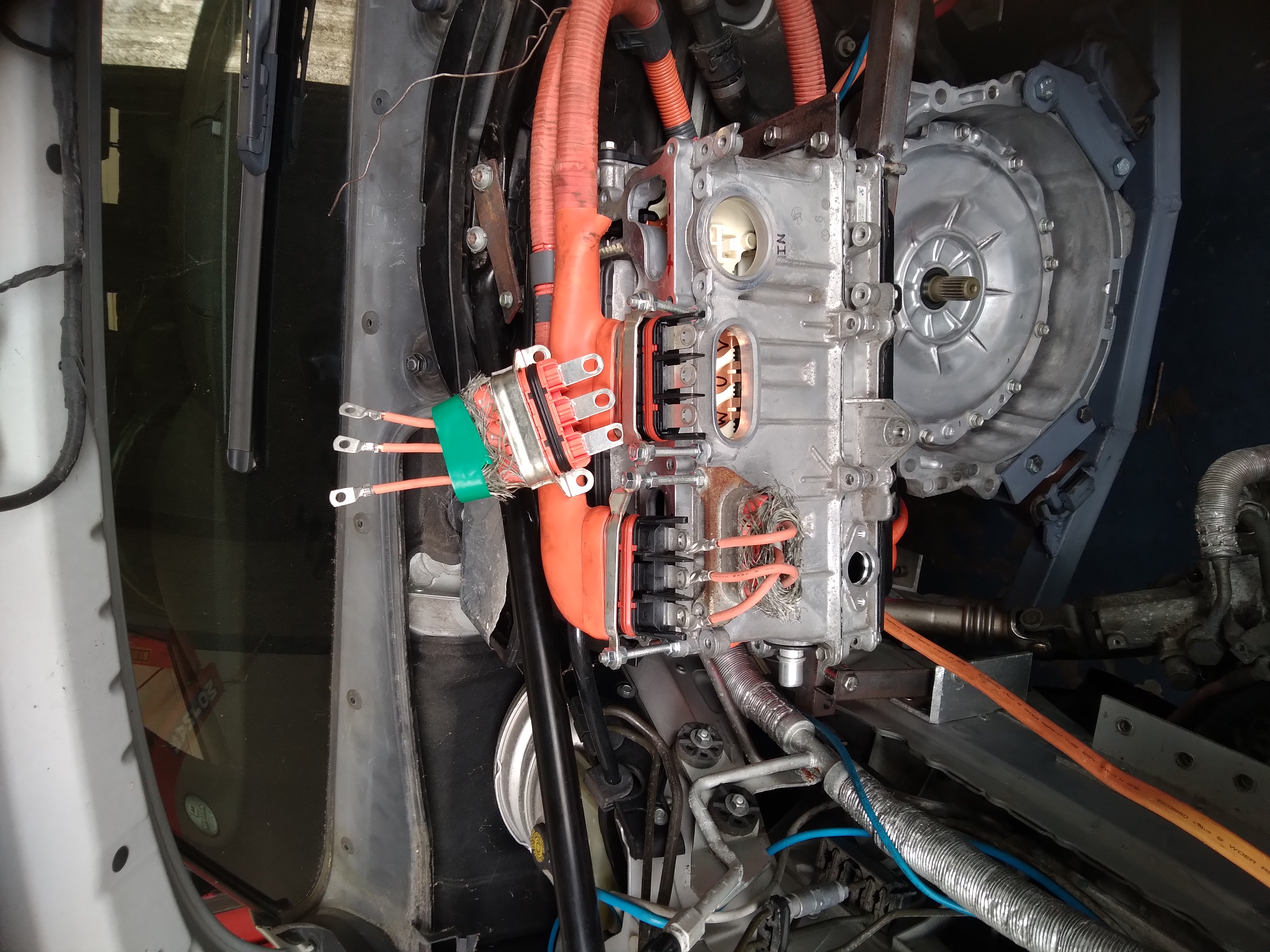

I'm using the is300h inverter with a GS450h transmission and a Zombieverter. I've driven it about 120km. But I am having issues.
It feels like a rev limiter. It stutters like the power is cut to zero and then comes back again.
When using MG1 and MG2 it won't go faster than about 65km/h - around 3000rpm
When using only MG2 it won't go faster than 85km/h - around 4000rpm
In addition it is pretty low on power. I only get 125Amp on MG2.
Timestamp udc2 idc speed torque pot pot2

Not much help but it does seem the IS300H inverter is lower power than the GS450H according to official Lexus documents although not as low as that.

Does it not sorta make sense, in a way?
The inverter parameters are tuned for the respective motors, in crossing them over like this its entirely possible its close enough to spin, but out by enough that the inverter realises something isnt right and gives a sort of "limp mode"...
I'm sure i read of someone using a Prius inverter with a GS450h recently and also had super low current limits?

Possibly which is why I mentioned it, I think Chrsky managed to get the IS300H transmission to run with a Prius gen 3 inverter.
I wonder if limiting the current values in zombieverter/OI to what the IS300H is capable of might help...

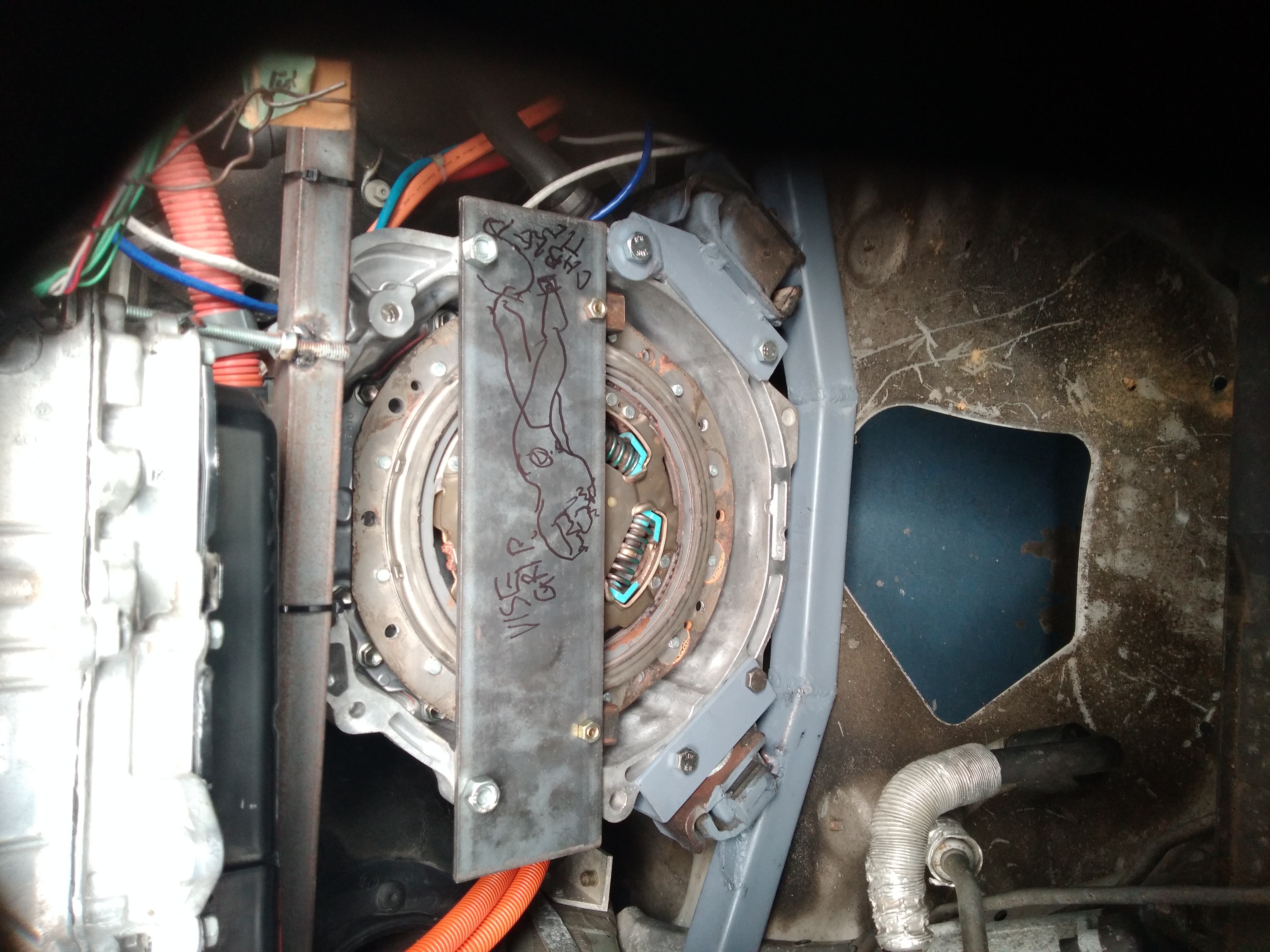

The test rig at present is using MG2 only, and until yesterday had not locked the IC input shaft, so effectively MG1, which has resolver connected, but no UVW, was not rotating, as the input spline was free to turn.
Am using a Prius ZVW30 inverter, with sync serial communication. I had thought it was this set up that was limiting to 45A bus current, and also a speed cap of 53kph, I guess at maybe 2000rpm MG2 speed, I will get a display and confirm this.
Some brief runs, before rain set in, and some fiddling of HTM stream, and managed marginally better, but more testing to confirm this when weather permits.

It does seem that operation is in something like constrained to EV mode, but as there is no IC to kick in, feels like a rev limiter or power limiter.
Hope to try some varying HMT data 76, and 78, I think for the Zvw30 inverter.. Will be different numbers on the 300h inverter, and different again on 450h, which the code I am using was derived from. Unfortunately my learned friend and code expert is down with covid at this time.
The task continues.
Locking plate in place,
couldn't find a real pair of Vise grips and a cable tie,

Some positive progress. Have checked direction, and function of Mg1 by itself....felt like much less torque than mg2 alone...
Now both connected, with a torque request of mg1 = mg2
as the next step, and have observed a good increase in battery current from around 45A now up to 75A at 280v.
Traffic on the roads is too heavy to go road testing, which is to see if the speed cap of 52.9kph GPS measurement has changed.
