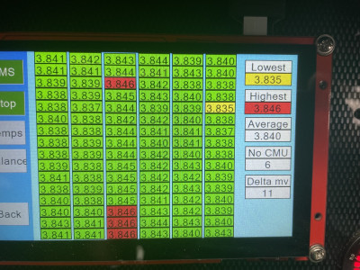

Re: BMW Touring + prius + phev
My delta is pretty large at the moment. 121mV. Most cells are around 3.87, I've got 1 full module of around 3.93V and 1 module in my second pack where the first 7 cells around 3.81 and the rest at 3.87. The delta at around 50% SoC drops to around 40mV.

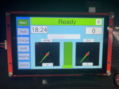

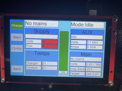

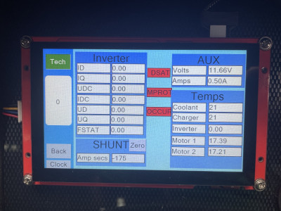

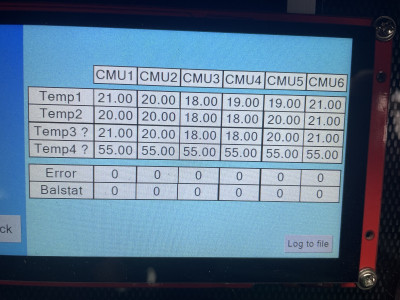

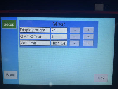

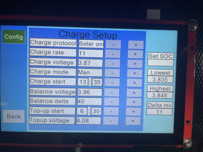

Just spending a little time refining the dash and charging etc. A few screen shots from my Arduino+nextion.
E46 touring
BMW 9kwh & 12kwh packs
So first official run today to work, now fully taxed insured etc.
42 mile round trip - top up (free) at work and all good. Only thing that didn't work was the radio !
Log file attached for anyone that is interested on outward leg of some 18 miles. Most columns are sensible but a few are WIP.
Charging regime of 90% charge then top up 1 hour before leaving works well.
All in all a right result - very happy with the outcome
Thank you to all who helped me get this far, couldn't have done it without your support.
My params are posted in the database for any similar setups.

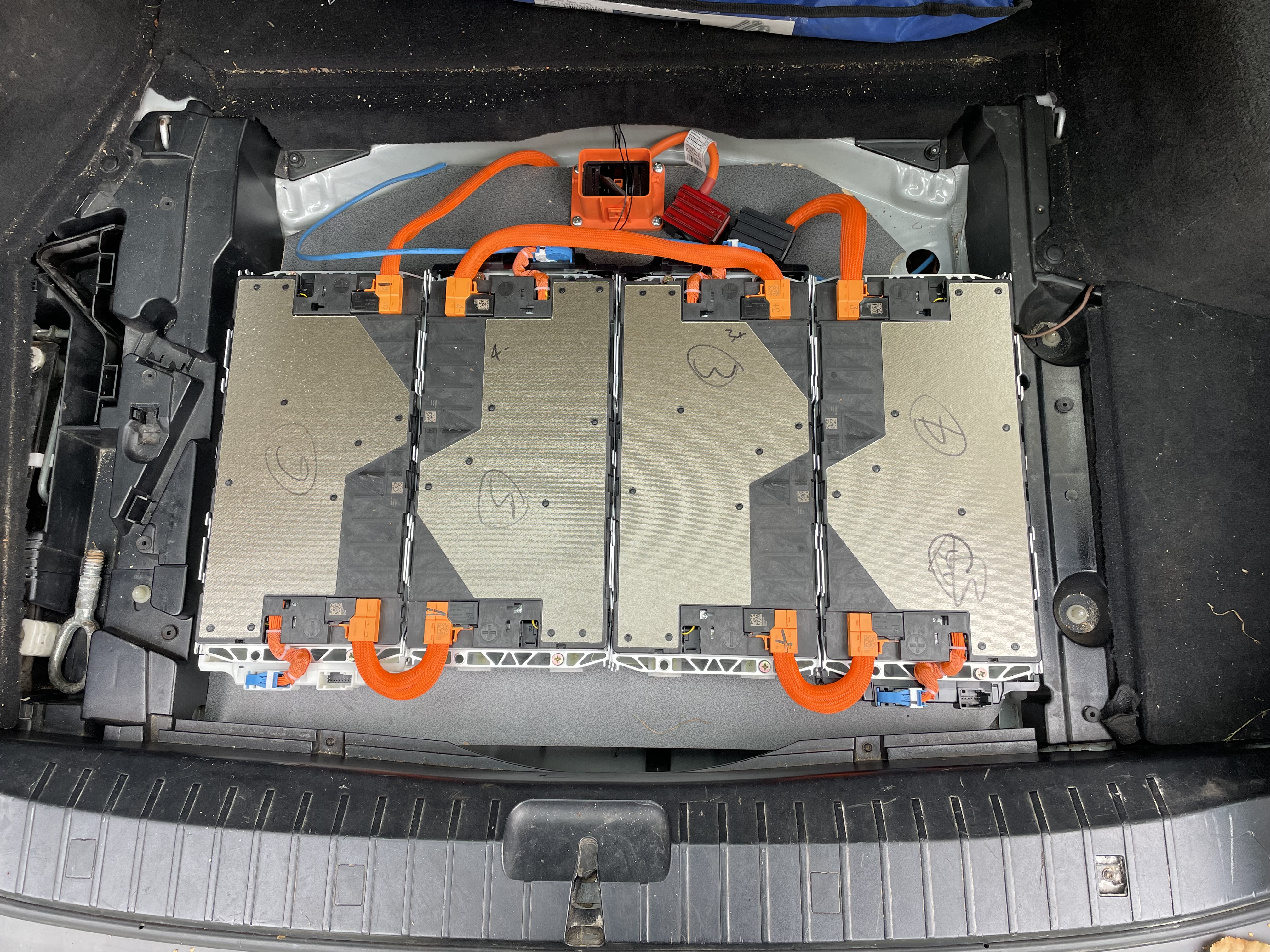

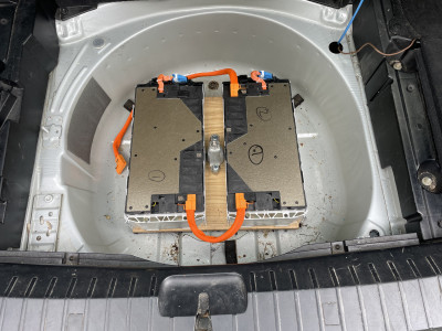

Re: [DRIVING] BMW Touring + prius + phev
i'll grab some pictures of the rear install this weekend as i have some more work to do n on that, but suffice to say, in the rear i have 2 x BMW 60v packs in the wheel well and 4 more above, which raise the boot floor 35mm.
I'll take some pictures of the front shortly as i have to have it all out to change the wiring and contactor setup for the 2nd pack install. But to say i have a 'ply' would platform just above the front ARB using the ARB mounts. On thet platform is 2 x 60v packs and the phev charger. Above that on a ply platform secured to the ledge formed by the monocoque are 4 x 60v packs, and over that on stilts is a light platform with the contactors and (at the moment) my arduino. Weather proofing at the moment is provide by a still but flexible plastic liner going round the front and 2 sides of the pack and ensures any water drains outside the pack area. The E46 drip tray the pollen filter sits in has the drain apertures extended to drain water below the motor.
when i say 'ply' i mean a type of laminated ply that is used in caravan construction. It is very strong, light and moisture resistant, and best of all doesn't conduct electricity. I get that it might be frowned upon, as i have seen some lovely metal work battery boxes but i think it is adequate and all batteries are within the crash structure, not underneath or outside any strong points.
I'll add some pictures over the next few days.
Thanks for the description. Looking forward to the pics.
My whole battery is on a thick sheet of plywood in the back of my touring, so nothing wrong with some carpentry
The rear install just awaiting hv cable to run to front.
So the second pack got wired in, including BMS. I then charged each pack so they were within 10mv of each other and paralelled them together, and they've been like that for a week. With the new contactor box there is a only 12v drain when the charger is plugged in or i'm driving.
Have not range tested yet but feels like 60-70 miles from the now 21kwh pack. When i have time i will fully charge and do a long drive and get the numbers off the shunt. At the moment the SOC is guessed from the cell voltage after charging. There is much less voltage sag with the two packs as one would expect.
This weekend the cabin heater goes in

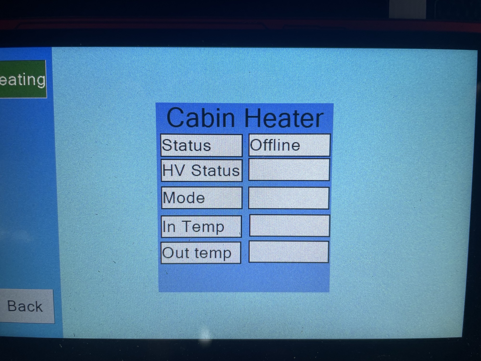

Yep outlander heater and small pump with small expansion bottle.
Have programmed in a preheat mode so i can warm the car (which saves the battery when it's plugged in), but that requires i cut into the heater fan wires so i can run that in charge mode regardless of setting in the cabin, so that'll be next weekends job most likely. It's easy access from the bonnet on an e46.
