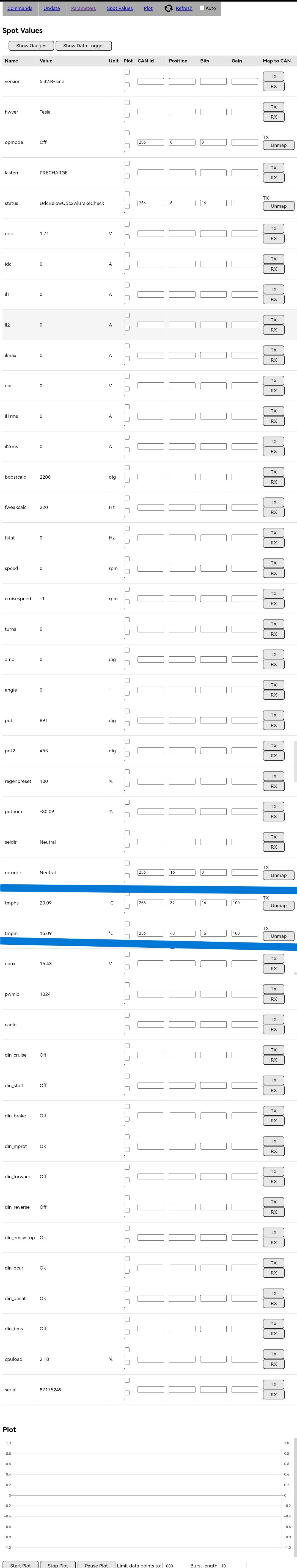

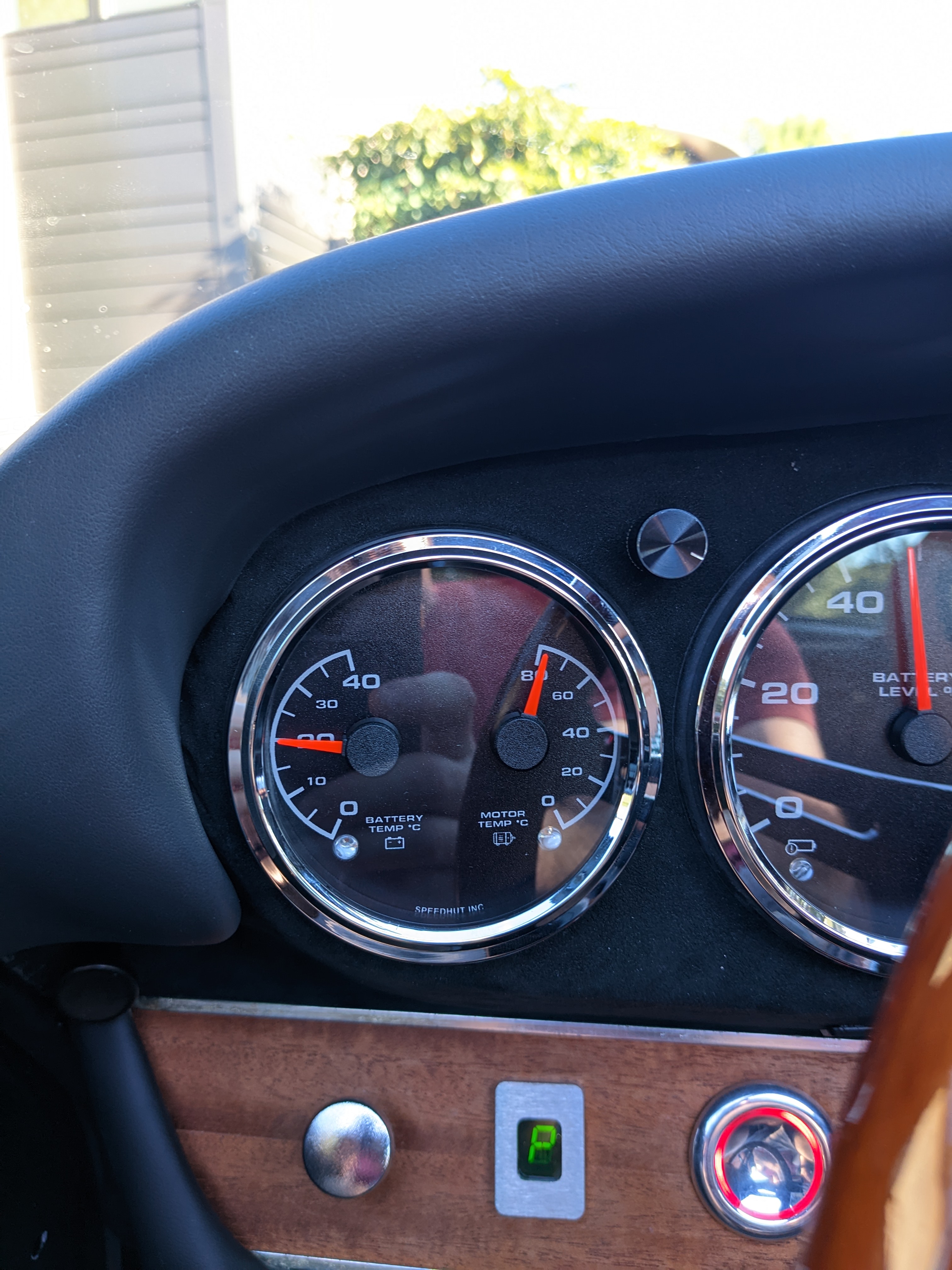

Hello,
Thanks for all the help this forum has provided. The electric Fiero has achieved about 800 miles with the SDU, OI board, charger interface board and Orion BMS. Only a few pesky kinks, one of which is CAN messaging from OI board.
I have Speedhut CAN Gauges and all but the motor temperature are working. Granted, all the working ones are getting their messages from the Orion.
Can anyone offer suggestions on what I may be missing? Based on BMS screenshot, I'm feeling like no CAN traffic is coming from the inverter. Do I need to manually insert a line for this rather than the CAN mapping already done?
Thanks, in advance, for any help here.

Re: Sending Custom CAN messages from SDU openinverter board
May sound silly but have you selected the correct CAN speed?
Are you aware that all numbers are decimal, not hex?
If possible you could monitor the CAN bus to check if your messages are generated
I have confirmed CAN speed at 500K. Attaching JSON for any other suggestions.
I must access CAN wiring from under car with weather shield removed (yes, design feature we won't repeat) so I haven't gotten there yet (with CAN sniffer, that is).
While looking at JSON, if there are any settings you'd suggest changing to improve the startup jitter, I'm all ears. I've smoked IGBTs on the tuning process a few months back and still having PTSD due to it.
I've got Speedhut gauges and it took a bit to get things working from my LDU. One thing to note: you need something else on the bus other than just the drive unit and the gauges. I think since their EV CAN gauges are based on their OBD2 gauges, they don't acknowledge the messages (so that they don't freak an OEM car out, they just silently observe), so the drive unit doesn't keep sending. It sounds like you do have the Orion on the bus, so that's likely not the issue.timbradley wrote: ↑Wed Sep 06, 2023 2:11 pm I have Speedhut CAN Gauges and all but the motor temperature are working. Granted, all the working ones are getting their messages from the Orion.
To the best of my knowledge, they don't have separate Inverter and Motor temp gauges. The Inverter message looks correct, based on the attached table, but I'm not sure what you're sending the motor temp to.
Thanks for your note. I have deleted all CAN mapping and tried for just the sole inverter temp and get nothing. Both by a direct entry in the table, and as a command. You're right, that is the only gauge I'm running for temperature around the motor.
Time to get it up on the rack and dig into the CAN wires to see if anything is coming out.
If there are any other ideas out there, I'm all ears!

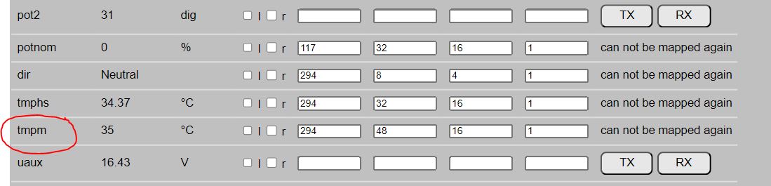

Hello.
Could somebody please give me a hint where am I going wrong here?
In the attached screenshot WebUI reads motor temp = 15.09C and heatsink temp 20.09C, but on the receiving end of the CAN bus, I'm reading motor temp = 12.80C, heatsink temp = 20.21C. Both SDU and my teensy talk at 500k.
This is my code on the receiving end:
Drive_HtSnkTemp=(uint16_t)((incoming.buf[5] << 8) | (incoming.buf[6])); // scale 1/100
Drive_MotorTemp=(uint16_t)((incoming.buf[7] << 8) | (incoming.buf[8])); // scale 1/100
- Been thanked: 1913 times
You're indexes are off by one and you're decoding big endian. Try this
Drive_HtSnkTemp=(uint16_t)((incoming.buf[5] << 8) | (incoming.buf[4])); // scale 1/100
Drive_MotorTemp=(uint16_t)((incoming.buf[7] << 8) | (incoming.buf[6])); // scale 1/100

Position - 4
Bits - 4
Gain - 1
Do you see anything wrong here?

Just wanted to note that the ID on the web interface is in dexcimal, not hexidecimal, so if you want it to output as 0x220, you need to input 544 in the web interface.
I use this converter https://www.rapidtables.com/convert/num ... cimal.html
Do you have anything else on the bus along with the SDU? I had issues when my LDU and Speedhut gauges were the only thing on the bus, the gauges weren't acknowledging the messages so the LDU stopped sending. It worked once I put them on the same bus as other components that were transmitting (ISA shunt, charge controller, etc).tensa wrote: ↑Sun Sep 28, 2025 8:49 am Thanks,
I measured and I got 60ohms as stated above. I also confirmed that I have the 2x120 ohms.
