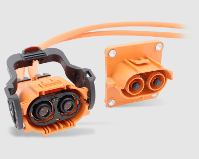

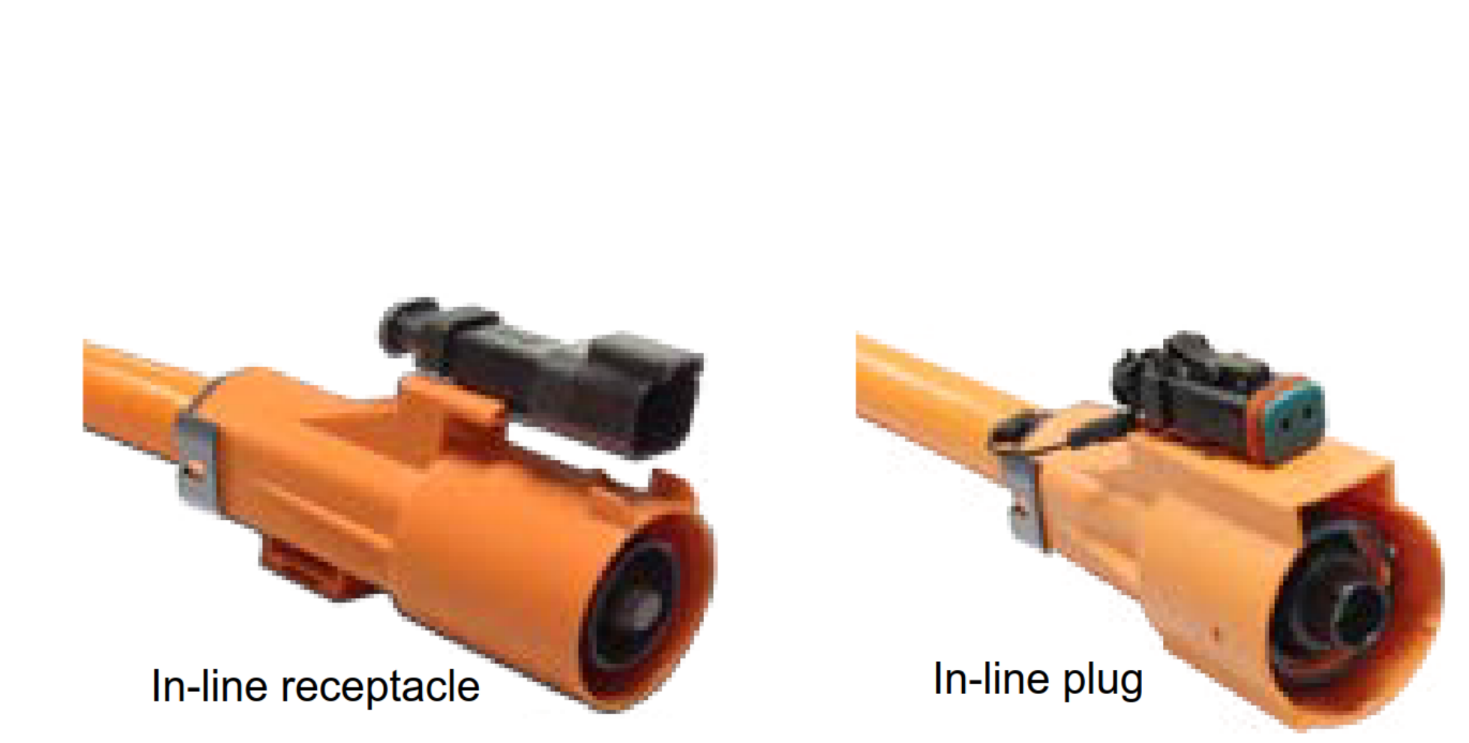

This type of HV connection is ubiquitous and many manufacturers offer a variation on it:
However, once cable size reaches 10mm² or 25mm², the male portion of these connectors is only available as a panel-mount, never for a sealed wire connection.
I have a need to connect two 50mm²leads in a detachable way (ie not spliced) on the exterior of the vehicle (ie needs to be IP67+), and I am not finding a product that meets those criteria. Bonus if the connector can handle EMC shielded cabling, but that's not a requirement for my app.
I've spent around two days full-time looking for this without success, so I'm throwing the question out there for you.

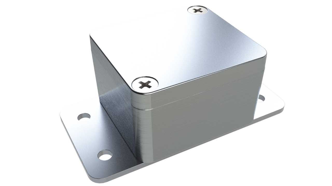

Edit... Oh I did forget about the enclosure...if you find one that is just big enough to hold the socket you can drill the opposite side and fit glands, you might want some bent bussbar just to make bolting cables a little easier....if your rear tyre is not too deep there should be space where you can fix it or make some sort of bracket.

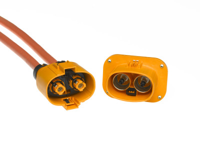

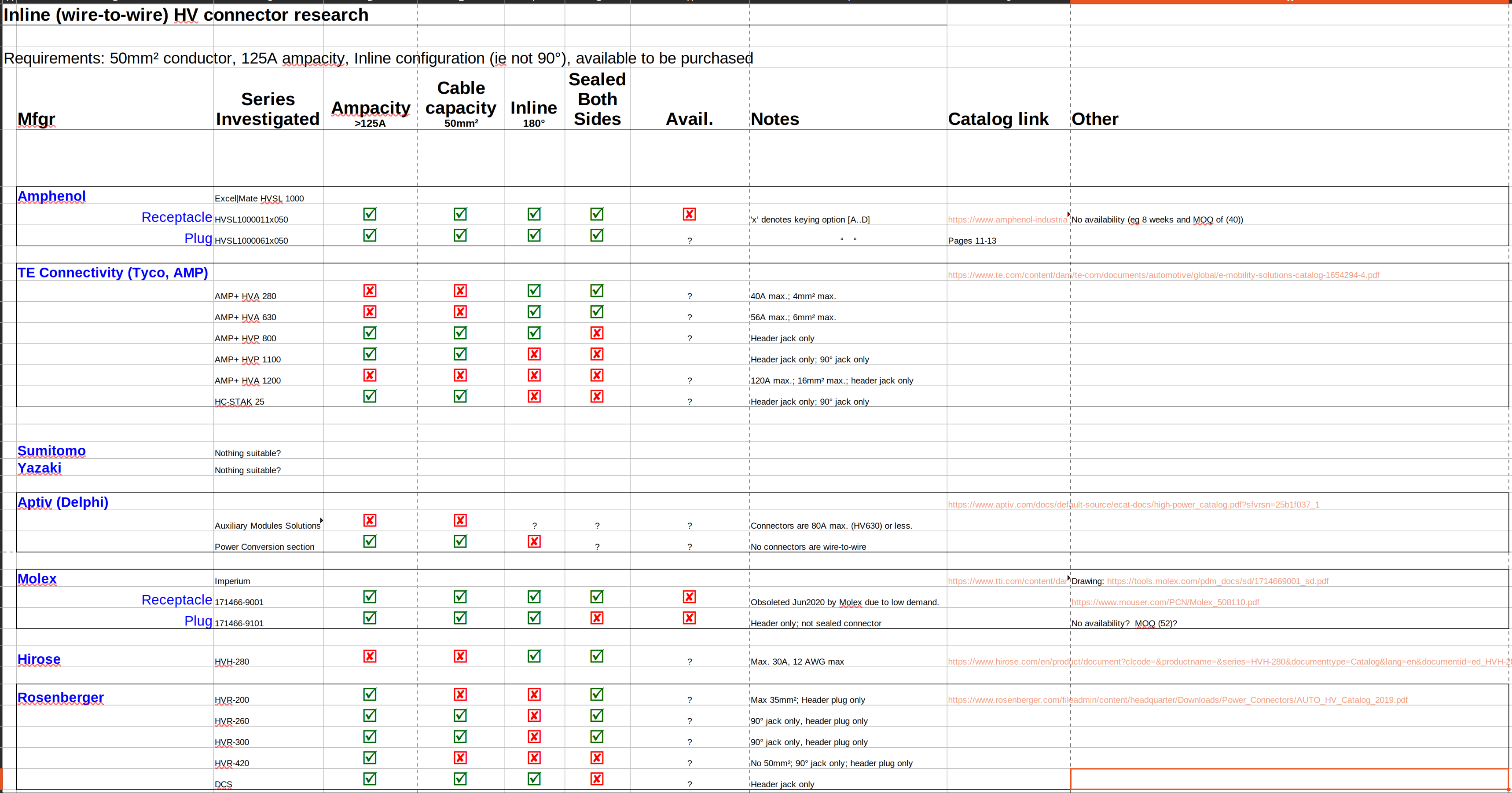

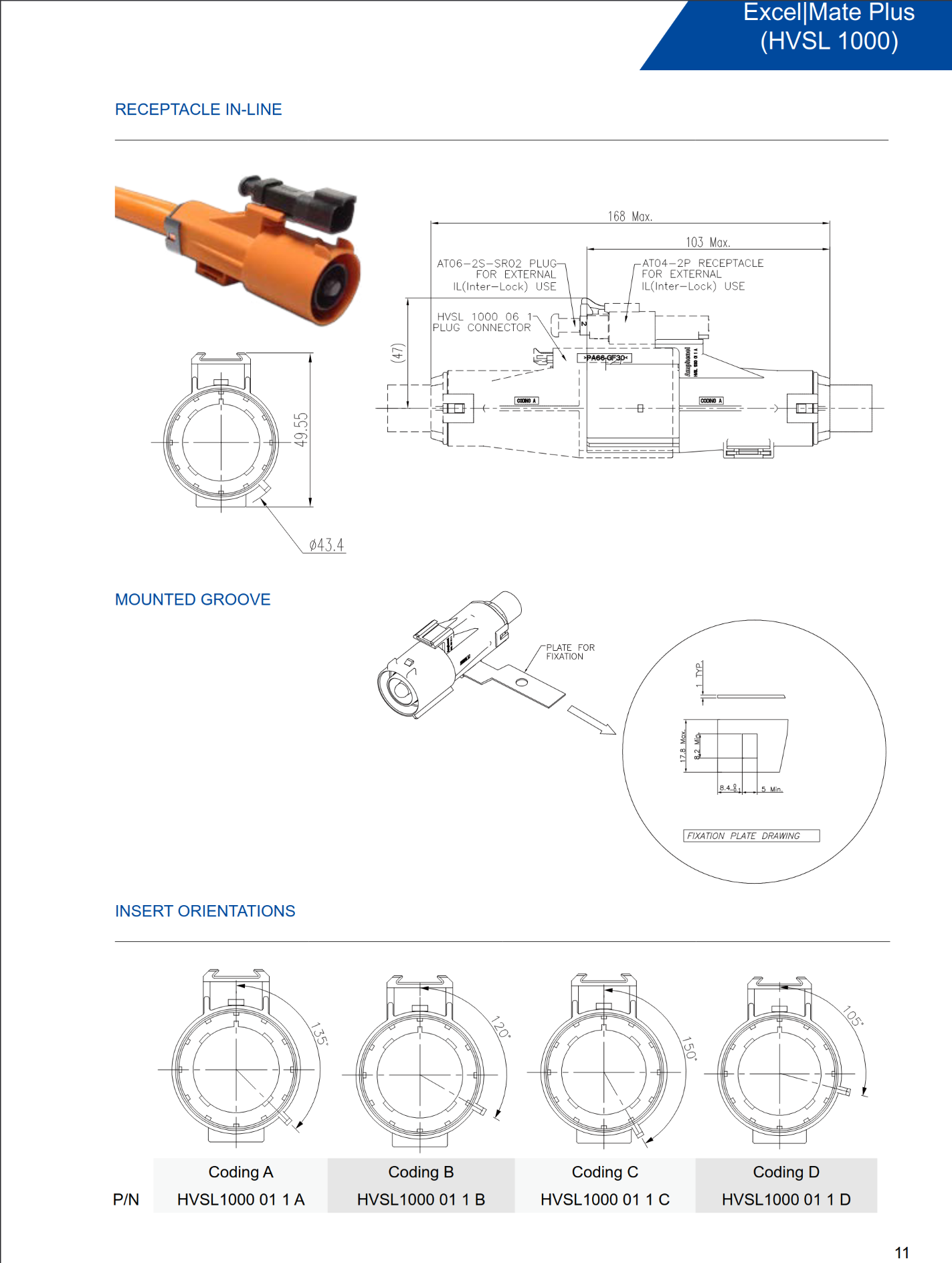

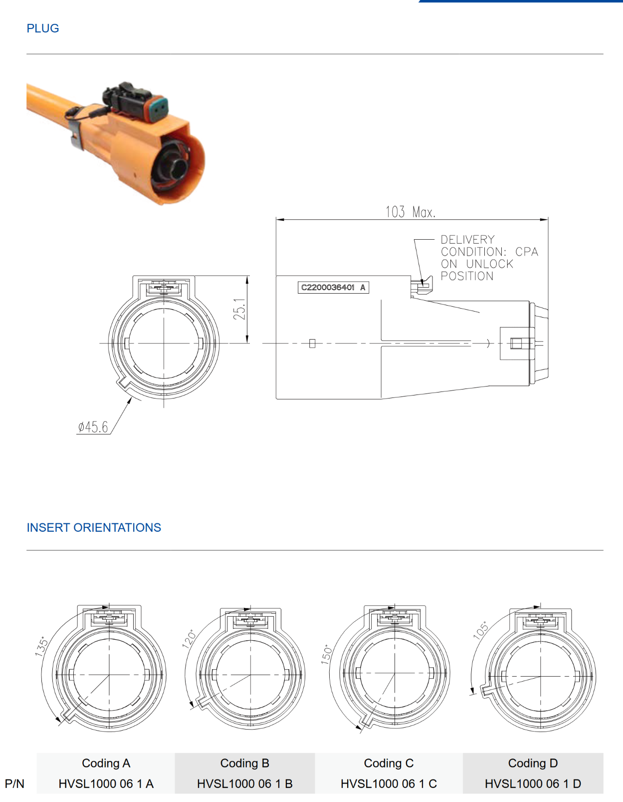

Tom, while I knew that the HSVL line has 1-pole connectors, I had missed that -- buried in the catalog -- that the 1-pole connectors is their ONLY offering with an inline receptacle:
Their How to Order chart also lists 25-70mm² as options. That looks to be exactly what I'm looking for, and I thank you for the second look at that catalog. I spent many hours peering at datasheets and catalogs and missed it -- which is kind of what I figured I must have done.

Unfortunately, not stocked anywhere. I looked extensively for the receptacle (HVSL1000011x050), and the two places that would factory order it quote 8 weeks (OK) and MOQ of (40) (not OK).
I didn't look as hard for the inline plug, HVSL1000061x050.
(x denotes keying = [a,b,c,d])

I've struck out on eight connectors manufacturers:
Links to mfgrs' catalogs (where available):

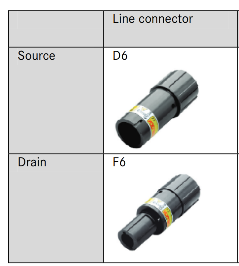

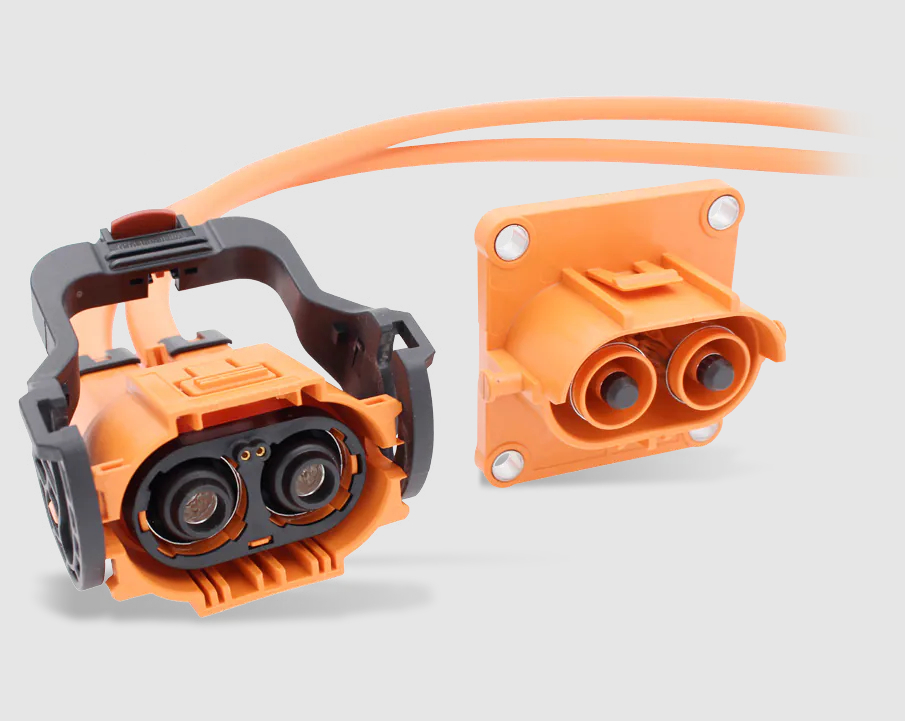

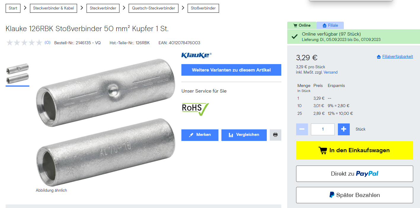

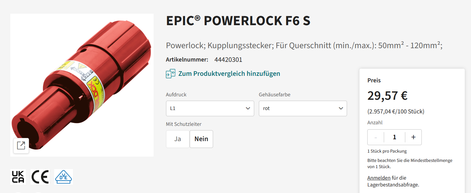

Maybe that's suitable. Cable 50mm² to 120mm². At least easy to get here in Germany. In different colors and codings, also in red and black for direct current.
EPIC.pdf
- (340.73 KiB) Downloaded 127 times

If only the cables are to be extended, I could imagine a combination of a threaded sleeve, connector and two cable glands. Inside it could be isolated with shrink tubing and/or casting resin. The shield would also go through. Definitely the cheaper option.

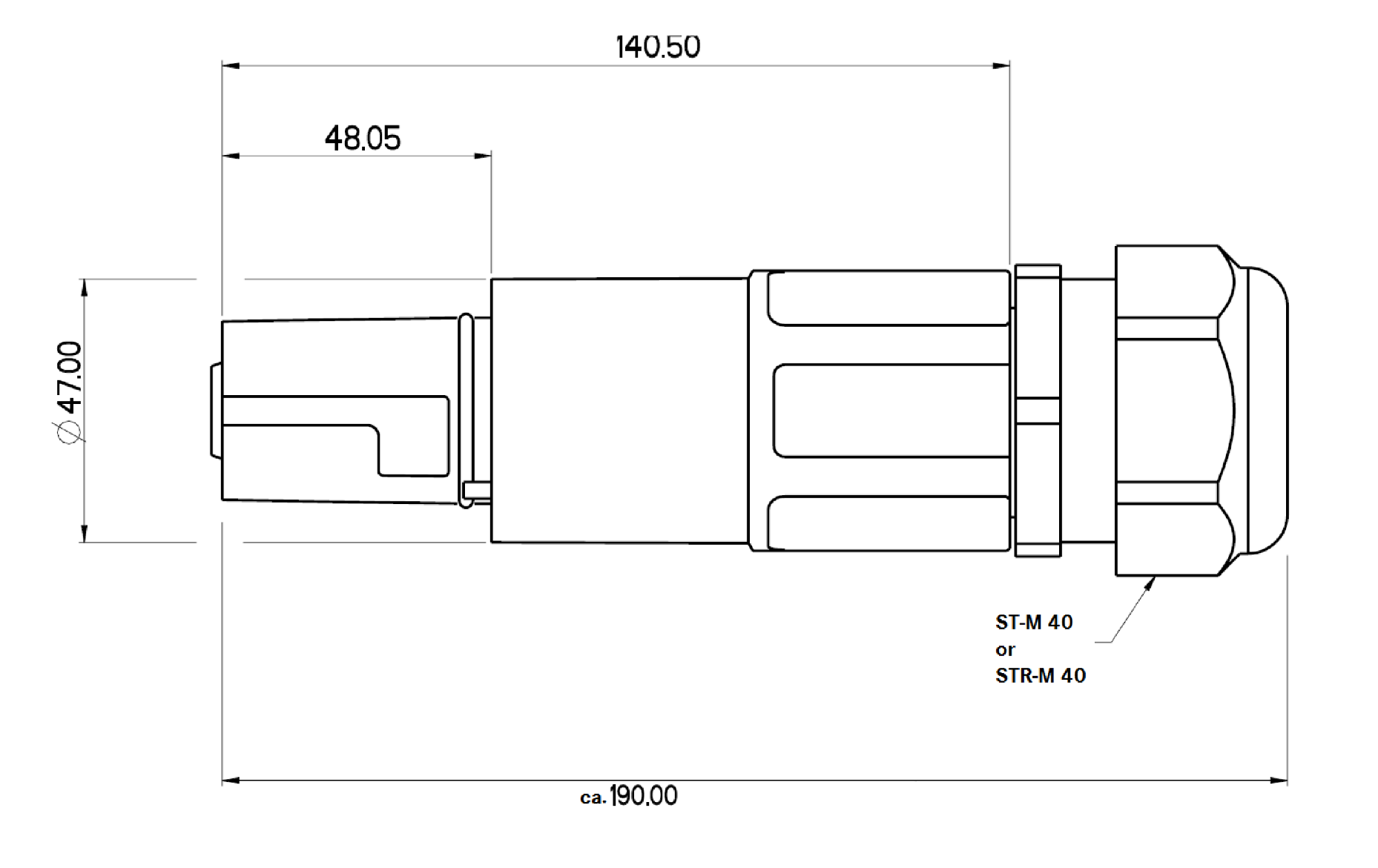

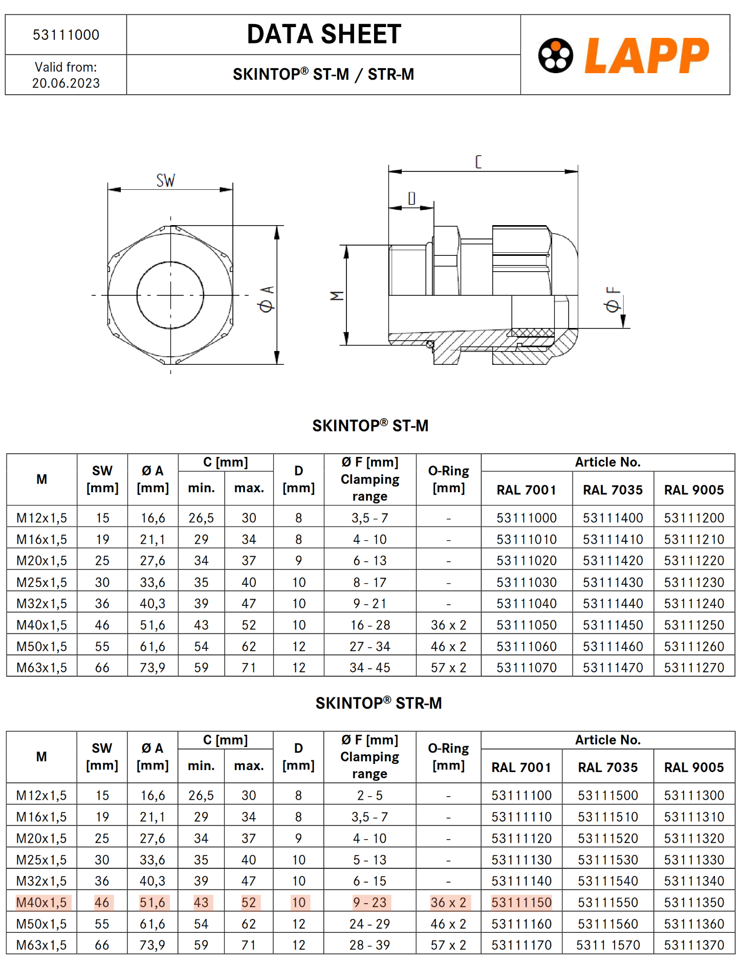

Thanks for suggesting the Lapp Epic F6/D6 connector. They do meet the criteria I stated above: 50mm², >125A, IP67, available*, and inline.
Without the glands on either end, assembled together these come to ~180mm (~7.25") in length.
Cable glands' length are in addition to that. The recommended Skintop STR-M 53111450 (M40, cable range 9-23mm) is 43-52mm long (2"). Each. That brings each assembly to almost a foot long. I'm hoping for something a bit shorter, to fit at the top of a wheel well arch.
To un-mate them, ~50mm (~2") of linear cable movement is required. Not bad.
Those M40 cable glands are 56mm Ø (2.25" dia). Bulky.

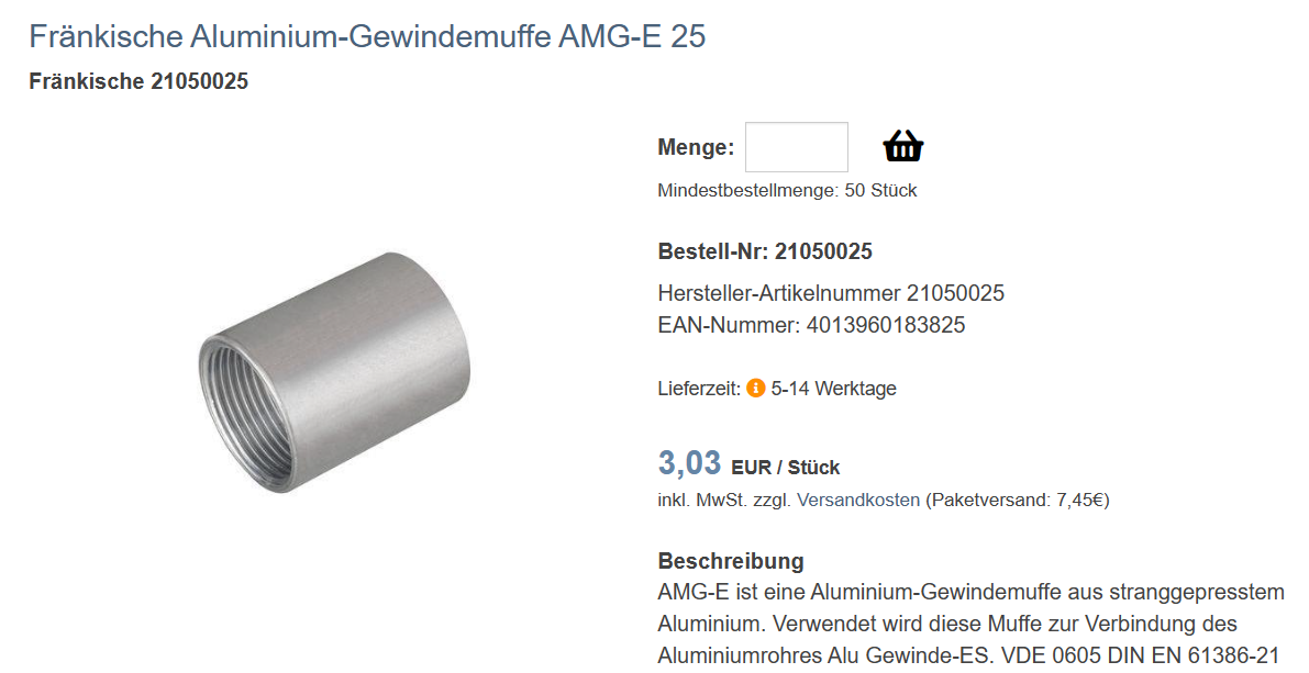

However, I can't buy an M25 (G25) conduit coupler like the Fränkische 21050025 . https://en.elektrotools.de/Product/Coup ... m-21050025 quotes >€150 shipping to US for two €4 parts.
I can find many galvanised steel ones, but galv is not desireable. Electrix/Rexel and SS is reasonably priced (UKG25, for example) but again, no distributors will ship it to US unless I use a commercial account.
I can buy 300mm of 1.5" Ø T304 SS and an M25x1.5 tap and make two myself for half the cost, though it will not be fun on my equipment. Perhaps I'll do that.

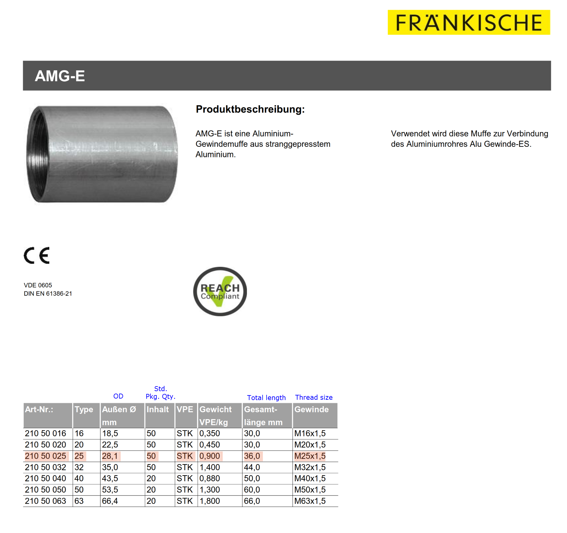

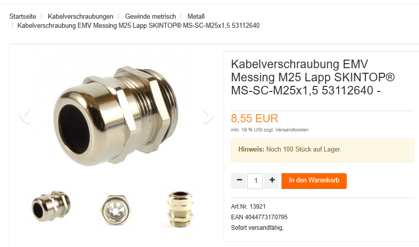

The Fränkische 21050025 has an overall length of 36mm.

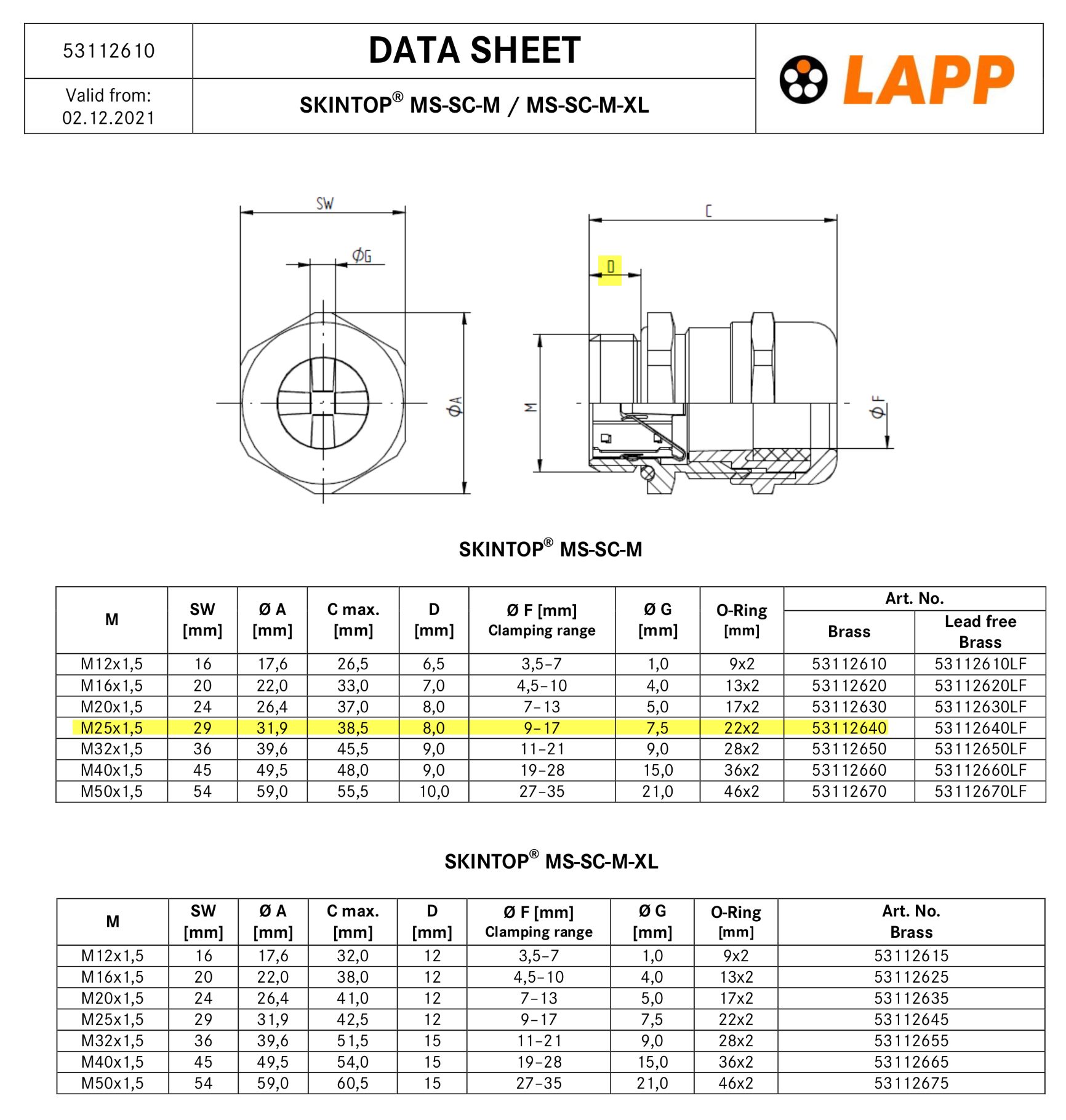

Tentatively, I've settled on Lapp Skintop 53112640 (M25, plated brass) for cable glands. Allowing for o-ring compression and tolerance error, each gland will consume ~10mm of threads from the coupler when installed.
That leaves ~16mm axial space in the coupler for a connection
The Klauke 126R/BK 50mm² butt splice you mentioned are 56mm in length.
The Molex 19215-0047 1/0 AWG butt splice that I stock are ~37mm in length.
It looks like I'll be making my own, longer coupling, perhaps ~75mm OAL -- around twice as long at the Fränkische unit.

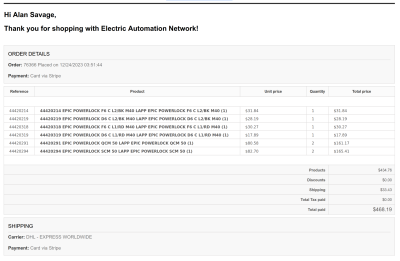

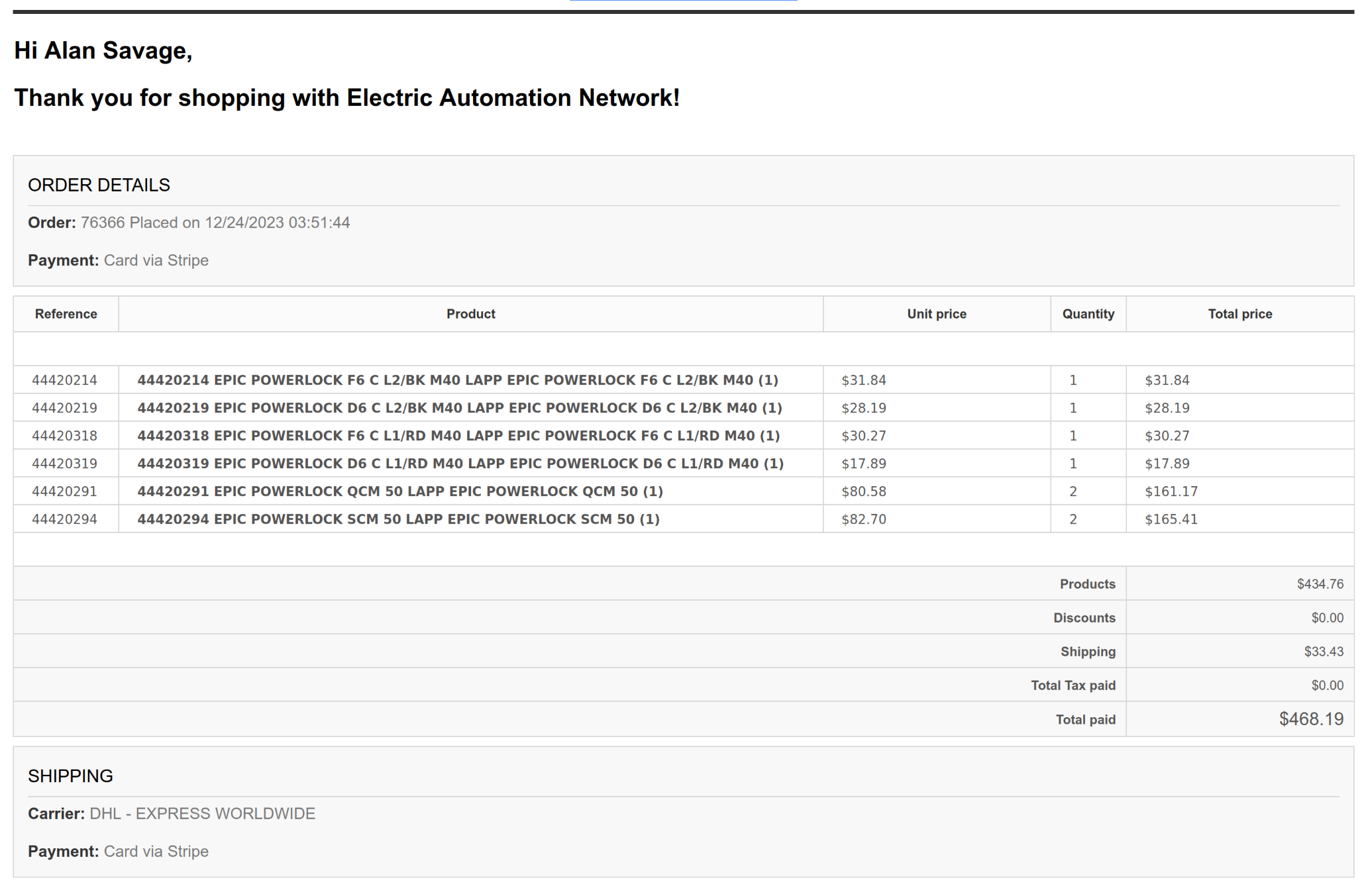

After much futzing about, I've ordered the Lapp connectors; the housings are inexpensive, but the crimp contacts are ~USD$80 each, x4, so the total is quite high. But I was not able to find suitable alternatives that didn't involve something even bulkier, and I do not have the room.
- Receptacle Housing, LAPP Epic Powerlock F6 C, Black “L2”, M40, 44420214
https://www.electricautomationnetwork.c ... stribution - Plug Housing, LAPP Epic Powerlock D6 C, Black “L2”, M40, 44420219
https://www.electricautomationnetwork.c ... stribution - Receptacle Housing, LAPP Epic Powerlock F6 C, Red “L1”, M40, 44420318
https://www.electricautomationnetwork.c ... stribution - Plug Housing, LAPP Epic Powerlock D6 C, Red “L1”, M40, 44420319
https://www.electricautomationnetwork.c ... stribution - Crimp Contact “Source” (male?), LAPP Epic Powerlock QCM 50 (50mm²), 44420291
https://www.electricautomationnetwork.c ... p-to-240mm - Crimp Contact “Drain” (female?), LAPP Epic Powerlock SCM 50 (50mm²), 44420294
