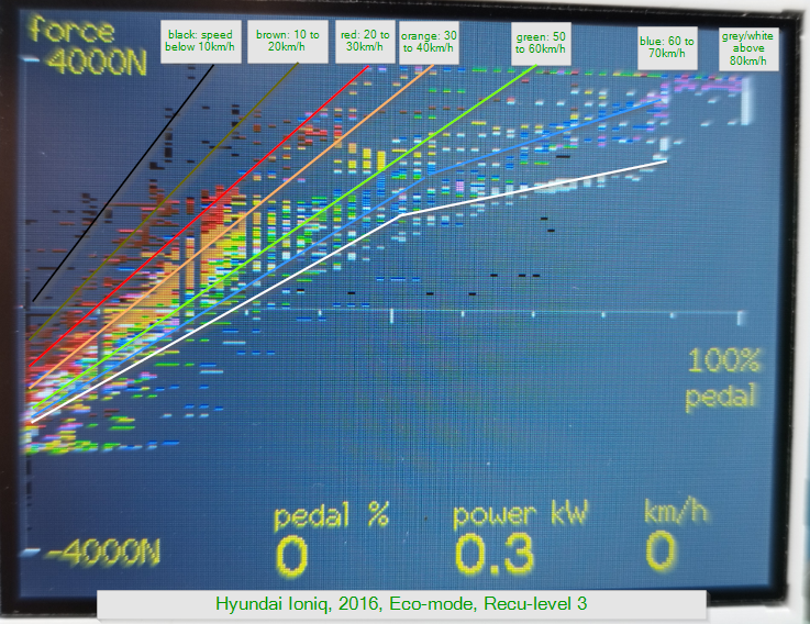

Some measurements on the Ioniq:
Each color is a certain speed range. The samples are coming each 100ms from the CAN. The force axis shows only the range to 4000N, to see better the details. Actually the force can go higher (around 8000N).
Conclusions:
- They prevent the dead zone by making the regen force at zero pedal dependent of the speed. Between 0 and 40km/h, the force increases from 0 to ~1500N, and at higher speeds it is more stable in range ~1500N to 2500N.
- There is a smooth change between acceleration and regeneration, no knee at the zero-force.
- At higher torques and speeds, they use some non-linearity, it looks like they want to increase the comfort, so that a small change in the pedal position does not lead to a big reaction.
- When changing from the shown "eco mode" to "sport", the curves are much steeper, but the strategies look the same.
Edit: How this diagram was created? By listening on the CAN bus, using an STM32 "blue pill", and a cheap TFT driven via SPI. The software is here: https://github.com/uhi22/TFT-with-CAN

How to read that graph? From top to bottom, each line? For example white line, you lifted the pedal slowly from 60-70 km/h speed, or completely at once? How can the pedal percentage be about 90% when driving only 60-70? Below the pedal-line is negative force / regen? I'm at loss :)
uhi22
Posts: 1244
Location: Ingolstadt/Germany
Has thanked: 245 times
Been thanked: 684 times
Re: Accelerator pedal dead zone
Post by uhi22 »
How to read that graph? No, there is not certain direction or time-dependency in this graph. It shows the static transfer function, torque = function_of(pedalposition, currentspeed). "Static" means, it does not care for the time.
Of course, in reality there are time-dependencies, and they are visible in the diagram, as "noise". When you press the pedal, it takes some hundred milliseconds, until the filtering is done and the torque is really on the motor, especially in the used "eco mode". That's why, starting from a certain point in the diagram, we get often 3 "strange" samples on the right side (means: pedal was pressed more, but no increase of torque for 3*100ms), and afterwards the new setpoint is found (means: next sample is up on the target line again).
The "beautiful straight lines" are just for illustration, to have a better summary. They are NOT calculated by from the measurements. Only the dots are measured.
I did some minutes of driving for the diagram, with different speeds and different accelerations and recuperations. So to say a multiple zigzag through the whole diagram. The course of the zigzag does not matter, only the pattern, which is the result. E.g. the brown dots are forming a certain line, no matter, whether they are recorded at the beginning or at the end of the trip.
How can the pedal percentage be about 90% when driving only 70? Well, just imagine you are parking and then push the pedal to 90%. Then there will be in the diagram a black dot at (lets say) 90% pedal with 8000N, and then a brown on the same place (because speed increases), and so on, until the power is not sufficient anymore to keep the torque at high speed, and so in the diagram the higher colors will be below the (brown, red, orange, yellow) dot. We see such a case in the top right corner. Will full throttle, the speed was increasing (but the color is the same for everything above 90km/h), and the torque is decreasing because we are in the power-limit range (88kW rated power).
Below the pedal-line is negative force / regen? Yes, exactly. For example at 20% pedal, we may have strong acceleration (lets say 2000N at 15km/h) or moderate regen (lets say -800N at 100km/h).
And, regarding maximum and minimum force in the diagram: The diagram cuts at +4000N, because showing the complete range would hide the interesting details. Of course, the higher forces are also interesting, but not shown here. And the negative force limit is given by the software of the car. It is the maximum regeneration which we can achive by releasing the pedal. But, if using the brake, the regen further increases (up to 88kW). I did not go so far, but a little bit it is visible on the left lower edge: The black dots (means: speed below 10km/h) at zero pedal goes down to -3500N when pushing the brakes stronger.

muehlpower wrote: Mon Aug 07, 2023 7:56 pm I find the positive values ​​interesting. You say they go up to 8000N. If I extend the straight lines upwards, it means that I reach 8000N with a pedal force of about 50% at 10km/h. So you don't have to pedal all the way to the maximum torque
Yes, I find this also very surprising. And this is eco mode, the normal and sport are much more aggressive. Somehow it fits to the daily experience: Need to be careful with the pedal at lower speed, otherwise we lost a lot of rubber on the street (front driven car, accu in the back, not able to bring the torque on the street). But: Maybe the linear extrapolation is not really correct, need to make some more measurements with the full-scale torque ;-)

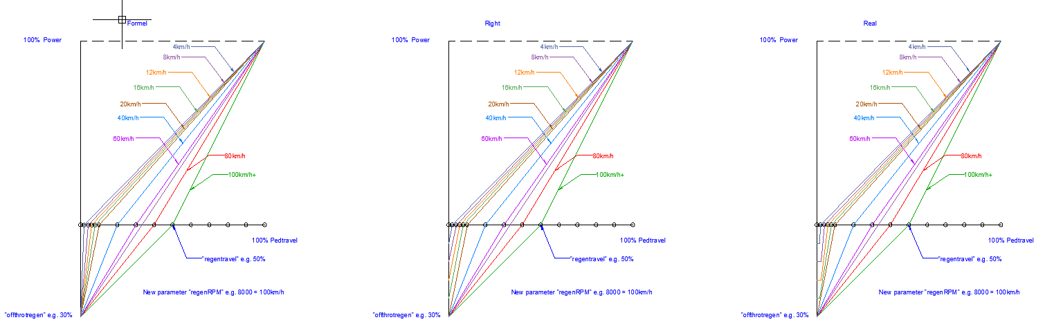

My suggestion looks like this. With a flat curve for acceleration at low speeds. Useful for high power configurations. Strong regeneration also possible at lower speeds => less use of the brake pedal. A new parameter needed, if it is set to 0 everything is as before. And of course no dead zone!

Post by uhi22 »
And on the left side, between 0 and 20km/h?
muehlpower
Posts: 807
Has thanked: 18 times
Been thanked: 186 times
Post by muehlpower »
uhi22 wrote: Tue Aug 08, 2023 11:15 am And on the left side, between 0 and 20km/h?
The formula continues in the same way (left). It would be correct as shown in the middle. You need more parameters for that. In reality it will be like the picture on the right, since near zero the braking torque possible due to regeneration decreases. I don't think the slight difference is worth the effort.
If "offthrotregen" is already a percentage value of the currently possible braking torque, the behavior in the middle picture appears anyway.
