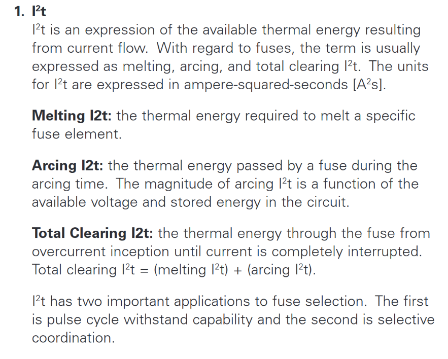

I, too, don't find a time/current graph, but they do furnish the raw I²T numbers for melting amps and total clearing amps (ref.):
Interpreting this is well outside my wheelhouse, and I'm certain someone will jump in shortly to bring context to those numbers; meanwhile, LittleFuse has more to say about I²T (ref.):

I2T is a way to describe absorbing capabilities. Like a bucket; when its full it trips. But the bucket has a hole so if the fuse gets time to rest the bucket will empty; is it being over used during T time it will trip.
That's what I2T means and does.
So basically it gives an idea what the above nominal accepted performance is. A "slow" fuse has a big bucket, a "fast" fuse a small one. Often the bucket is drawn in a graph where current and time are plotted.
