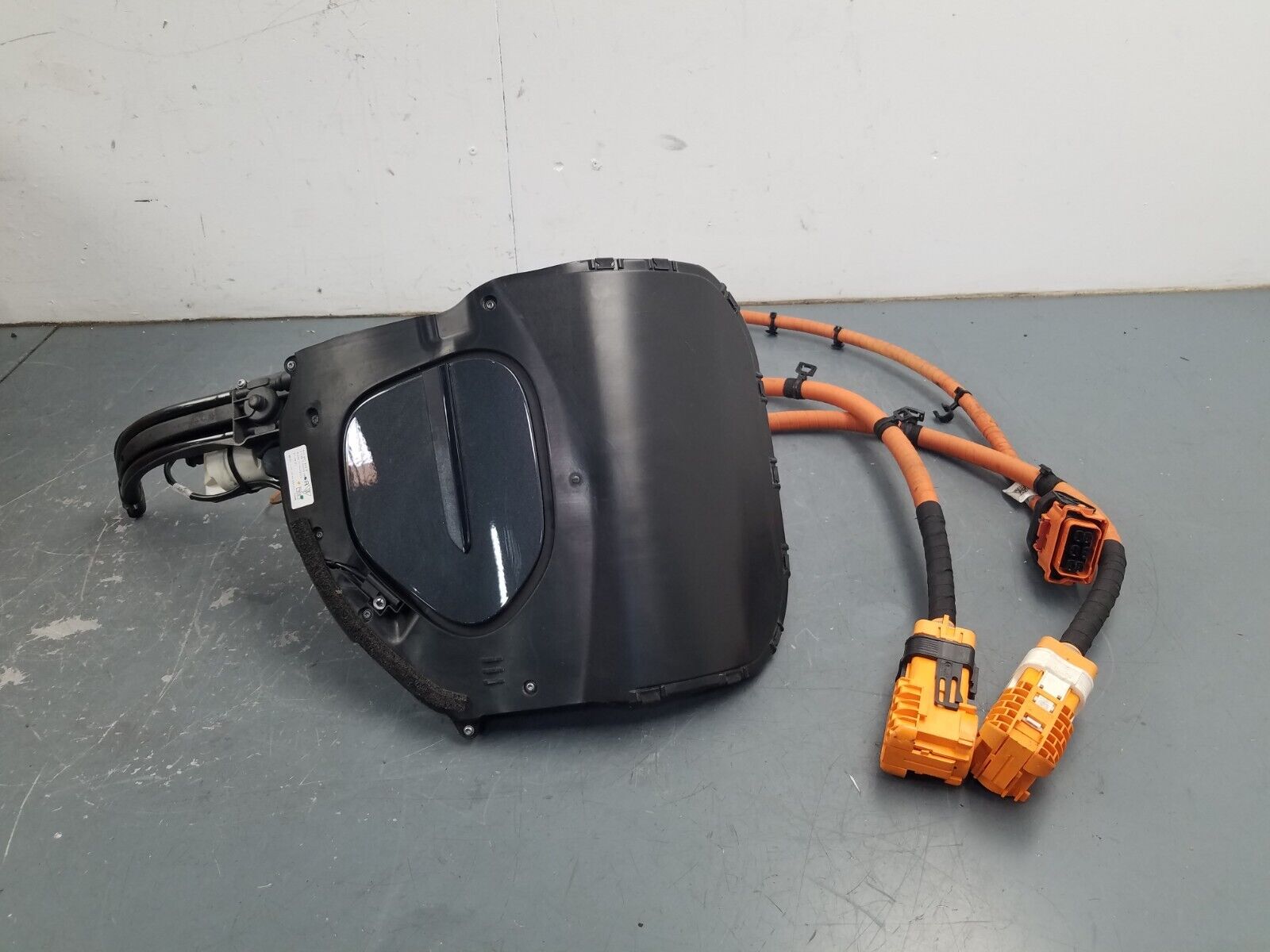

asavage wrote: Tue Jul 18, 2023 8:31 pm One issue I see -- which is also an issue with other CCS inlet ports -- is that the rated current for the AC pins is only 32A; as you know, we can draw up to almost 40A.
I just purchased a 2021 Porsche Taycan right charge inlet port via eBay; it is CCS1 and also AC 48A capable (base models charge(s) @ 11kw). On the Taycan, there are two charge ports, but only the right one does CCS; the left one is L2 only -- though 48A L2!
For any reasonable price I could only find Aliexpress CCS1 ports that supposedly can handle 40A+ AC, and I don't trust any of the sellers I saw; so many of the written specs are contradictory. Porsche parts I can reasonably expect to pass muster.

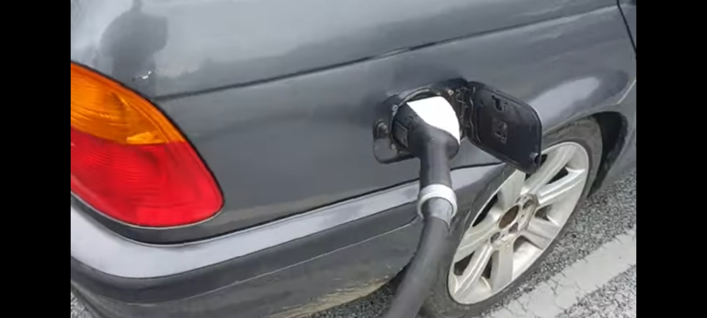

Post by Shockazulu1 »
Asavage,
If you still choose to add the CCS1 plugin at the original j1772 location....
This photo attached, shows screenshot from Damien's YouTube video.
His gas port looks like it's the same size as the RAV4 opening.
For now I still plan to use the front Toyota logo as my plug location.
