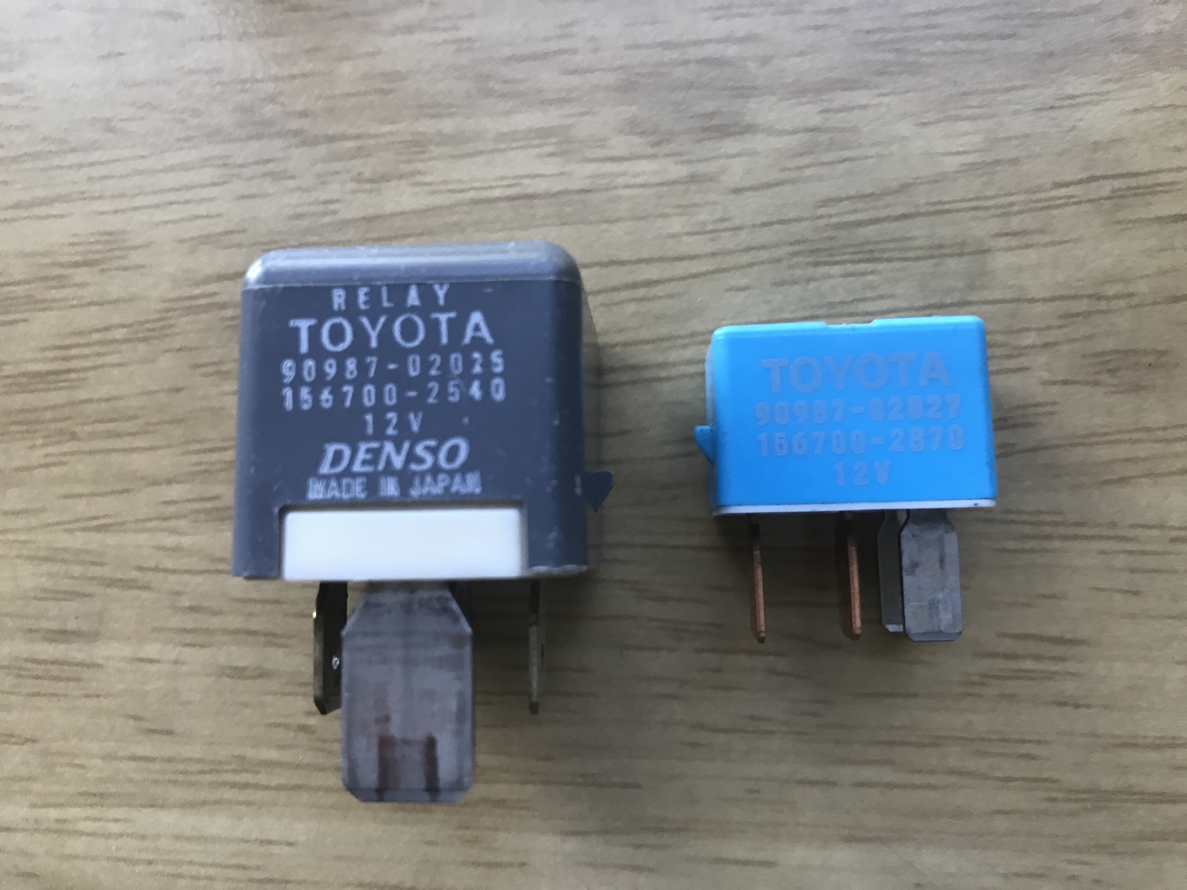

Radar here would like to know if any of you super resource ninjas would be willing to help The Greg source these types of TOYOTA/Lexus OEM ATM aka mini fuse terminals, please and thank you
apologies for the slightly out of focus pics, my steam powered iPhone still struggles with macro photography and you can forget about micro
- Posts: 596
- Has thanked: 215 times
- Been thanked: 174 times
Looks like a timer style connector.
https://www.digikey.com/en/products/fil ... YQFs8gtlKA
Might have to get down to datasheets & a vernier to find the right one.

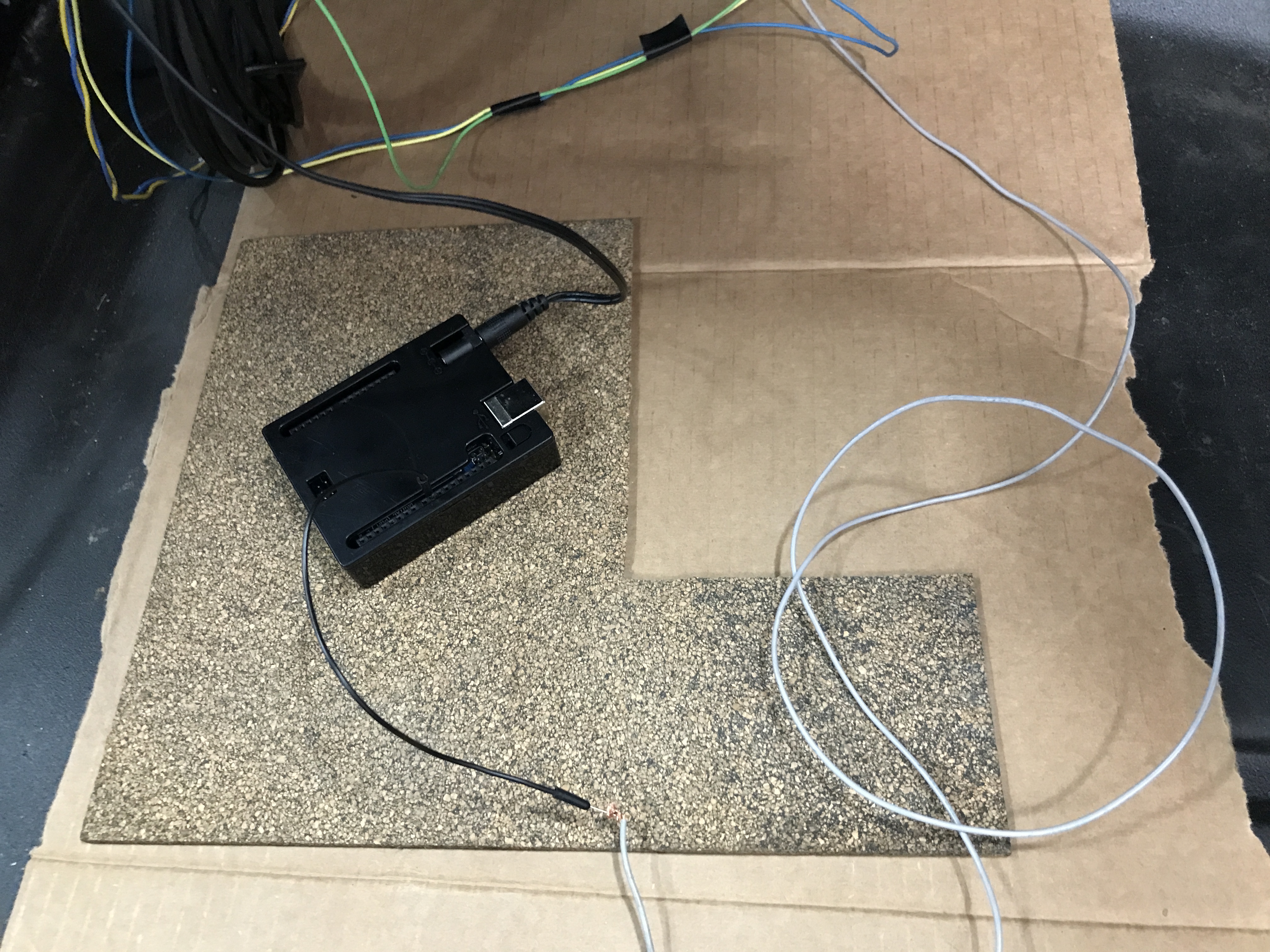

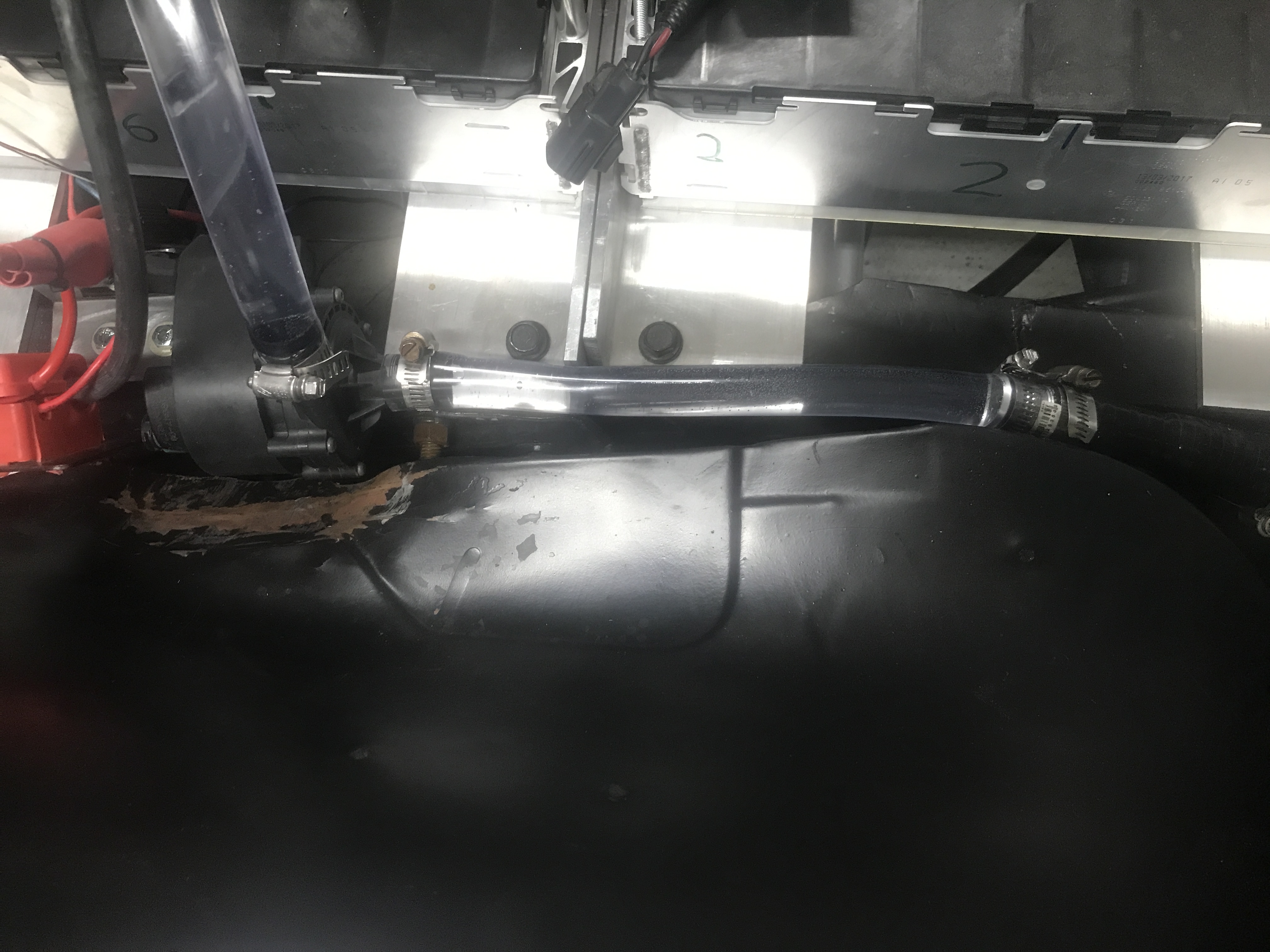

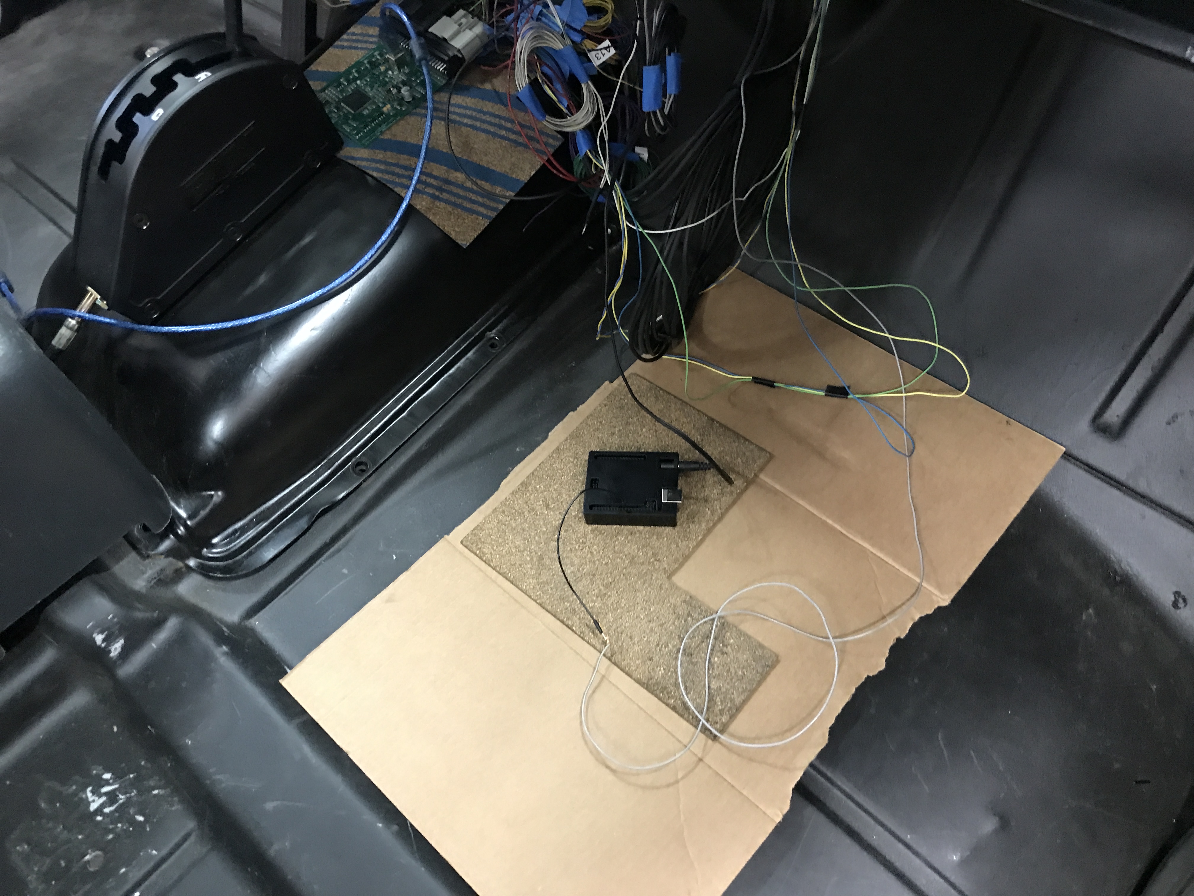

Progress Report
Today was all about the Tesla Model S water pump, first I made a bracket to lower it, then I implemented some stolen PWM code to make sure she knows it's a Marathon not a sprint.
1. VCU - working
2. Safety Box - working
3. Neutral Safety Switch- working
4. Water Pump - working
5. Electric Power Steering, EPAS - working
6. Inverter - today would not turn on
7. DC-DC Converter - currently sitting on the work bench
8. Arduino UNO for PWM for the water pump - working
9. Idiot Light - working
* Oil Pump is fused and relayed in the motor compartment not in the cockpit
I'm considering getting a narrower radiator, and plumbing on the inside of the frame rail
1. VCU - working
