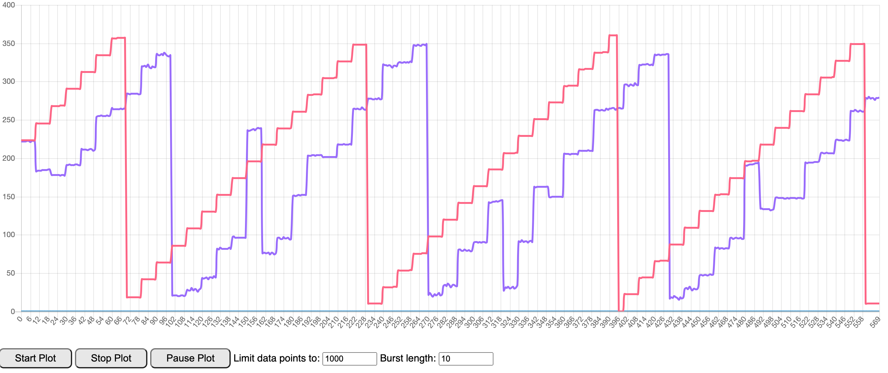

Re: IPM Motor - Auto-setup
Seems to plot now, suspiciously the angle and test angle seem to be the same regardless of syncoffs value
One step forward ......
Doesn't look right, fairly sure both are showing the resolver angle but no idea why, had another look through the code and it seems to be ok. Does a resolver check now read the angle correctly?
Could you try grabbing a plot with both the plot size and burst length set to 1000 to see what it looks like then?
Long shot but might be worth doing a full chip erase and reloading the code. Bit suspicious that going back from 5.27 to earlier versions leaves something in flash that the parameter store doesn't like, if so an erase and reload might help??

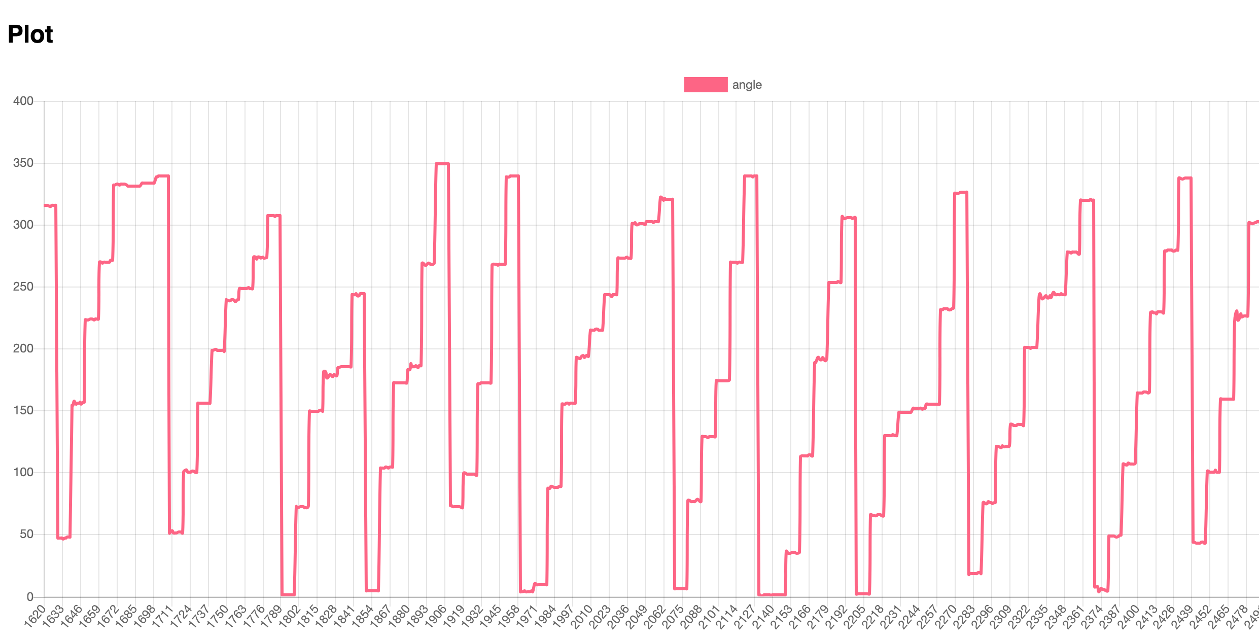

The angle plot looks ok in resolver test mode.

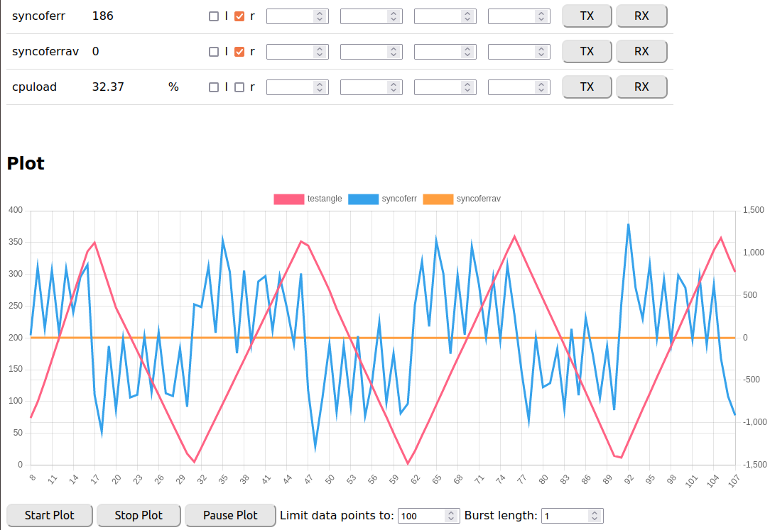

Averaging now working. Added an extra parameter syncofferrav (need a better name!) which is updated once per motor cycle and contains the error, on my setup it is surprisingly clean and gives an offset repeatable to within around 10 units!
This is the result with syncofs set to 0: after it's run for a few motor cycles the value of syncoferrav is the value that should be written to syncofs (as long as syncofs was previously 0), in this case 5681.
If the test is then rerun you get this: error of 0 now reported.
Worth noting that syncoferr is always reported as a signed number (to stop errors around 0 causing the plot range to go from 0 to 65535) while syncoferrav is always reported as an unsigned number so that it is easy to use it to set syncofs. Not quite intuitive (especially if syncoferr is negative) but it seems to be the best compromise.

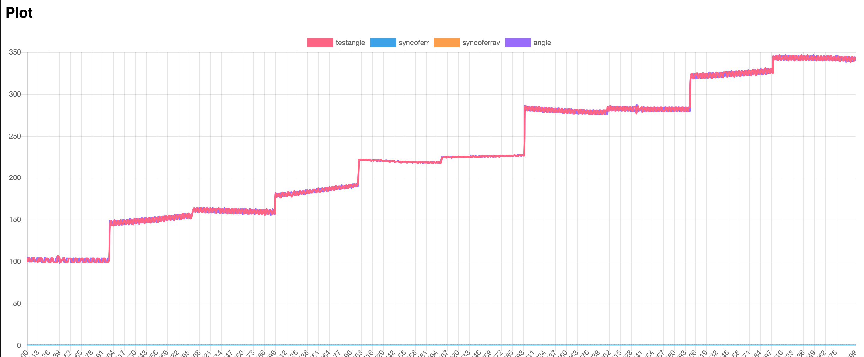

Still the same for me, nothing jumps out from the code, but I'm not an expert
Values are exactly the same

I was hoping it was just a problem reading the parameter (and so the new code would still work) but it looks like it is something actually in the test code. I'll have another look
No idea! Had another look through the code and I just can't see how they can be the same.
If you plot both in resolver check mode do they still track (testangle shouldn't be updated at all in that mode)?
Assume the value of syncofs still has no effect on them in test spin modes?
syncofs still has no effect. I've been trying to follow the code as best I can and can't see anything.
Test angle stays at 0 in resolver check EDIT
is this macro the issue
should it be?
#define DIGIT_TO_DEGREE(a) FP_FROMINT(angle) / (65536 / 360)
#define DIGIT_TO_DEGREE(a) FP_FROMINT(a) / (65536 / 360)

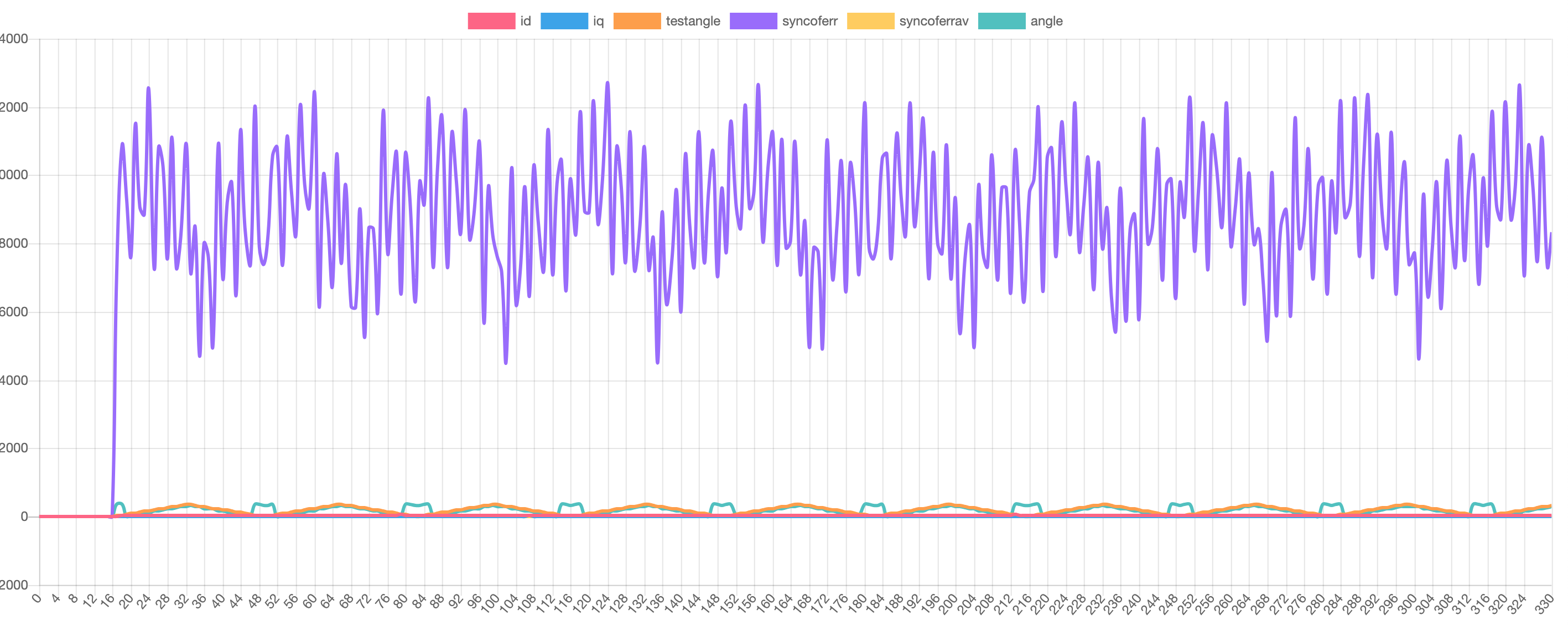

I'm using same values for those that I use in the car.
I let it run a minute and it resulted in an average error of 11778.
I put this in syncofs and run another minute
average error was 0 after this.
I then though I'd try normal running and the motor started spinning up and accelerating without any throttle input. Still progress
Looking good although it realy should be following the field better than that, those errors seem very large. What Id are you running at the moment?
What syncofs value did you get using the iq null method?
Edit - which motor is this?
Edit2 - something also doesn't look right on the second plot, there is no way the syncoferr trace averages to 0, there must be a lot of other stuff going on that isn't being captured by the plot??
