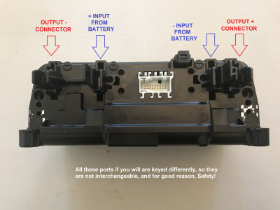

first apologies I don't know where to post this question, as I feel it is brand specific (aka BMW Safety Box) but I am using a first gen Chevy Volt battery charger, so here is my question, I am a minimalist, obsessed with repurposing OEM hardware (though I aint skierd to roll my own) the goal here is to use as little components as possible to SAFELY use the same safety box (if possible) to supply power to the [Lexus GS450h] Inverter as well as allowing the charger to interface with the battery but only when charging. I believe these events need to be mutually exclusive, please put me in the right place if I am mistaken. I hope to use Damien's VCU ver 2 (pre ZombieVerter) to control all three components with an Arduino sketch if possible: the Inverter, the Safety Box, and the Charger.
  • Can we connect the charger directly to the same safety box?
  • If so how can we connect the charger to the safety box?
    • more specifically which contactors do we use and what side of them do we tap into?
  • do we have to use both contactors, can we use only one and do some tricky VooDoo stuff that connects the charger to the pack but does not turn on the Inverer
I do not plan on using a Level 2 J1772 chord thingie at first, just a standard 120v 15a wall plug, so aside from not driving off with the charger still plugged in to the wall socket:
  • can we damage the charger if we inadvertently power up the Inverter?
  • and more importantly can we damage the Inverter if we accidentally turn on the charger?
I blow up the BMW Safety Box into smithereens here: I went after the Safety Box next it was before I had the ballz to post something on this forum, and knew better, mea culpa
forgive me for picture overlap and redundancy with some of my other posts I do not intend to clutter the forum I just like for each thread to stand on it's own

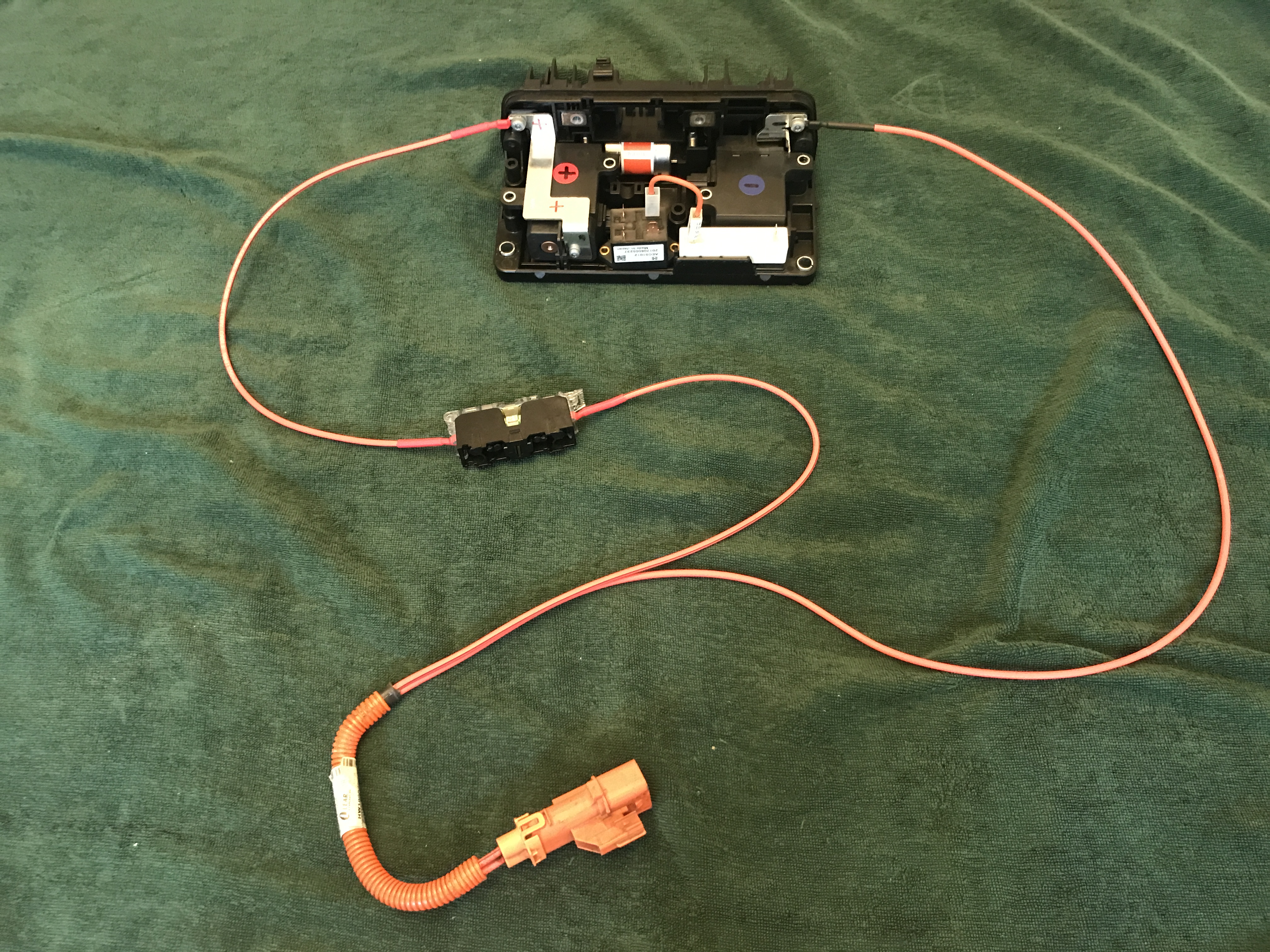

so just connect it directly to the Safety Box just like what I did below for the DC-DC convert with the onboard charger:
(that safety box is stripped just for demonstration purposes, the actual one is loaded with all sorts of OEM gizmotron goodies)

The Nissan Leaf must be a different animal, since as it turns out (having welded stuck 4 contactors, lol) this may not work with the Lexus GS450h inverter due to what we think is an internal discharge circuit, let me explain
In what I call Charge Mode, I am supposed to turn on the VCU, the BMW Safety Box, and the Charger automatically (also the Tesla water pump and an Arduino UNO to PWM it) the Inverter stays OFF
so the Arduino sketch aka the VCU program straight away closes the Negative contactor and the Pre Charge relay in the BMW Safety Box, then it waits for the Output voltage to exceed my pre set voltage (say 270 volts) well this never happens because with the Inverter OFF the voltage is bleed off and I have watched the S-Box output voltage only go up by 1 volt like every 30 seconds so that would take 9 minutes before the VCU would command the Positive contactor to close in the S-Box for the charging to begin
