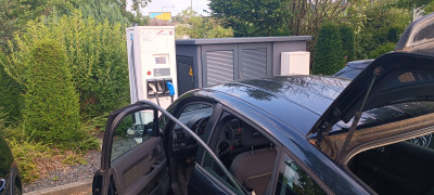

I have now removed the negative port relay and applied your patch. Result: most ABB chargers work, some don't The ones that don't probably pick up the isolation fault caused by the non-existant port relay.
I also went to the Porsche charger again and it just suddenly stops sending messages and goes red. Same behaviour with and without second relay.
Ionity Tritium chargers didn't change behaviour with one relay.
EDIT: added some pictures of my "charging window"

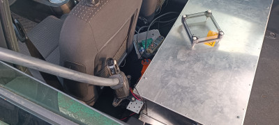

Slowly slowly, moving along. My RPI now has Can Bus to the rest of the car to read off the battery voltage and SoC. Will also take limits from BMS.
Not sure why it cannot find my modem any more, but I should have a CCS socket shortly so I can head round to station and see if they talk, once fixed the missing modem.

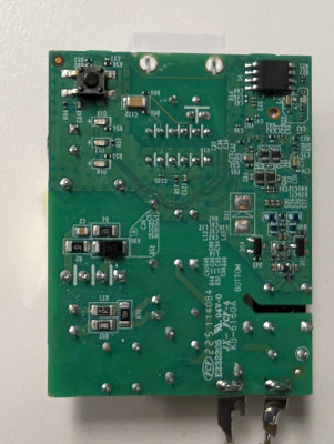

Hi all - you guys have been doing some fantastic work on this.
I have a used Chevy Bolt 2018 and am trying to use your codebase and pointers to emulate the EVSE component of the pyPLC project (have ordered the TPLink GreenPHY modem TL-PA4010 KIT from Ebay). I am trying to get the complete picture on what components are needed to get this setup h/w side built - my use-case is to put the pyPLC in EVSE mode and emulate the charger side and perform some of these use-cases:
1. close contactors on EV side
2. read SoC
3. put the EV in charge state
4. put the EV in (dis)charge state (more like discharge state and ability to draw power V2H type)
5. Implement a sniffer to capture the protocol messages from the EV side.
I understand the interface at protocol level but not sure how this needs to work with the rest of the elements like Arduino for PWM/CP type work and how that fits with the RPi and TPlink/QCA GreenPHY modem. I am going over the posts but there are many evolutions and schemes but I would like to go with an approach that would work without too many changes. Get the connectivity going and then focus on s/w from Pi perspective.
Also my expertise is more on s/w side - I opened up the modem housing but the board/placement of the components doesn't look similar to what is seen in some prior posts from other users. I am attaching the pics from my modem if someone could provide any guidance on how to proceed. To begin I would like to use the pyPLC processes on 2 sides (2 RPi connected to EVSE/PEV emulated sides) and get them to communicate. Once that works move to the next step with the Arduino/PWM and getting the charger to states A, B, C to keep the EV side happy (I wil more questions but first need to get started).
I have built my 2 RPi setups but waiting on completing the h/w mods as well as flashing the EVSE/PEV side of the PIB and/or f/w (if needed) to get the modems to implement the correct protocol stack at L2/LLC side.
Any help and/or pointers to get me started would be appreciated. TIA.

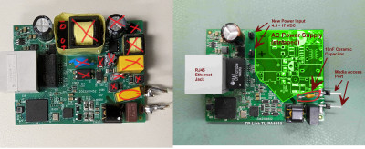

Looks like you grabbed a single board variant, i.e. power supply and logic on the same board. Just find the various rails, usually 12V and 3.3V. Inject 12V and see if that fires up the 3.3V as well.
- Posts: 1597
- Has thanked: 75 times
- Been thanked: 306 times
Check the cap pins when it's powered up, that's a good starting point to find 12V I found. Obvs taking safety considerations when probing.

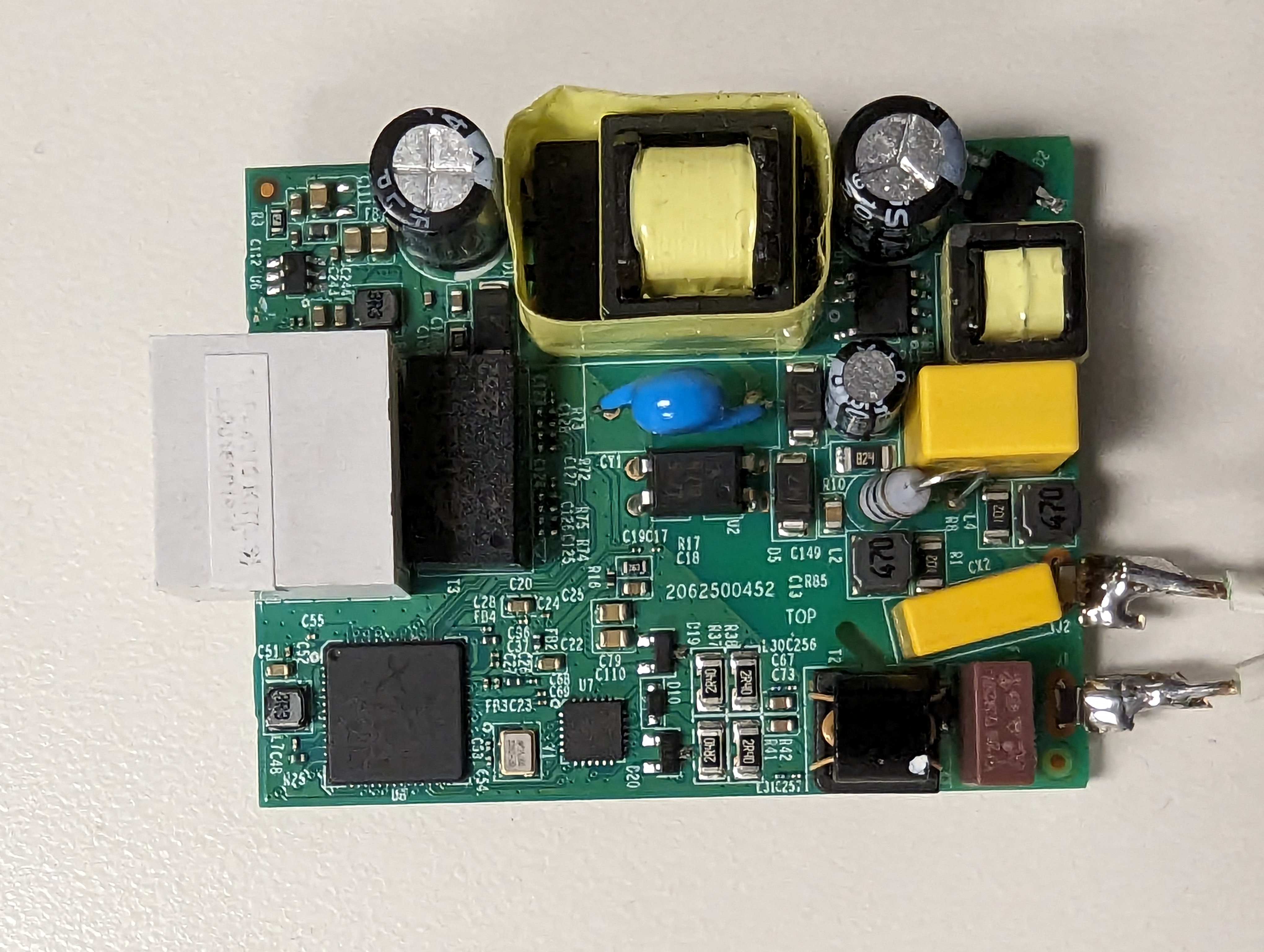

Oh, goody, another variant.
It looks more-or-less like catphish's and one of mine:
I think you can figure out the 1:1 correspondences for much of that, just visually. The bottom side, maybe not so much. Once the big stuff is removed (esp. the transformer), it likely doesn't matter if some small bits are left behind, the circuit won't be dragged down.

Thx @johu, @asavage, and @bigpie for your prompt responses. Yes, this is the non-passthrough version I found on eBay. It's a newer version 3.x v/s the 1.x when I closely looked at from pervious pictures you folks had posted.
I will do the recommended and validate the voltage at the capacitor pins. That seems like a good starting point. Then will start eliminating the transformers next. Just to be on the safe side I also ordered a set of older variants today from eBay to be closer to the ones you folks have working (in case I bust these).

I went back some posts and one of the posts had this link http://www.helicopting.de/
So I compared my board with this and seems they're very similar...
So I'll work to eliminate the AC PS side of things and see if it works. One question for the media access ports - which one is CP and which one is PE (lower right side)
Hopefully this will also help others with a newer revision of the TP 4010 modems. Any insights/advice appreciated.
