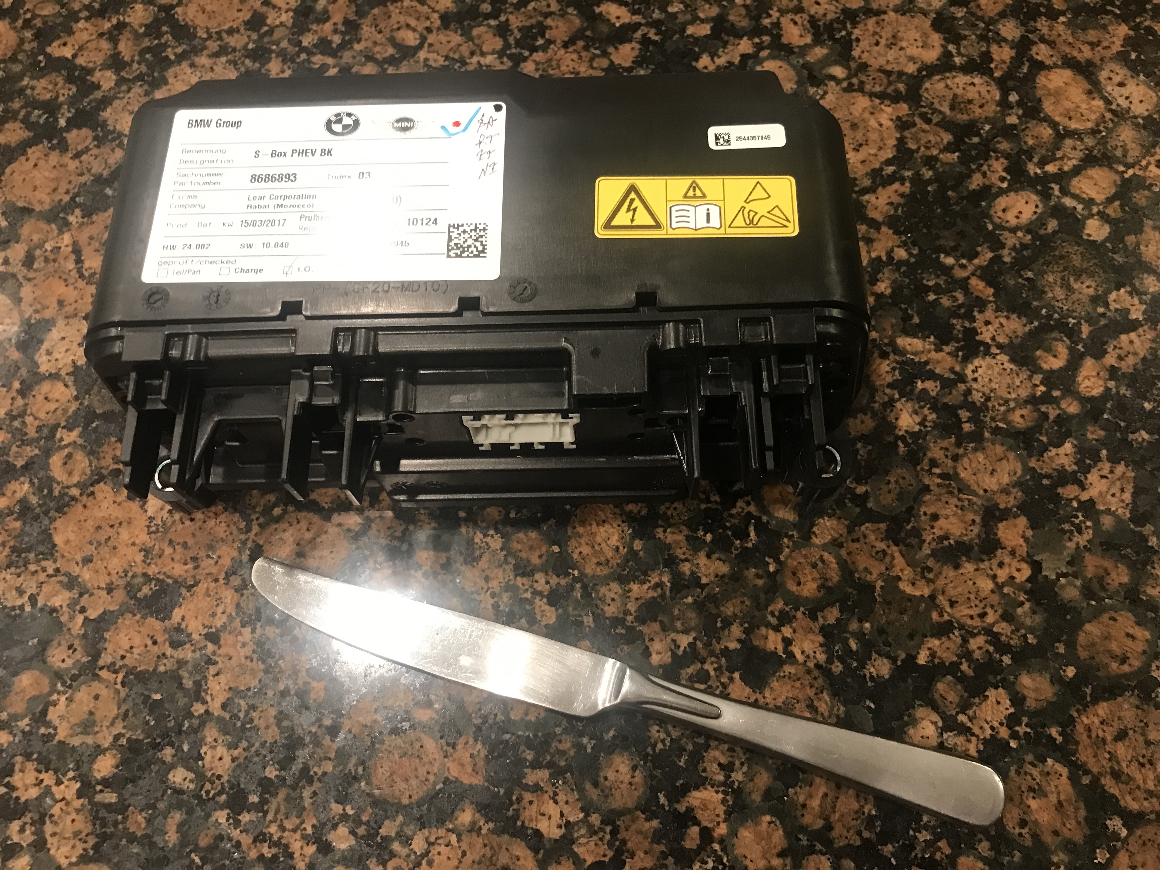

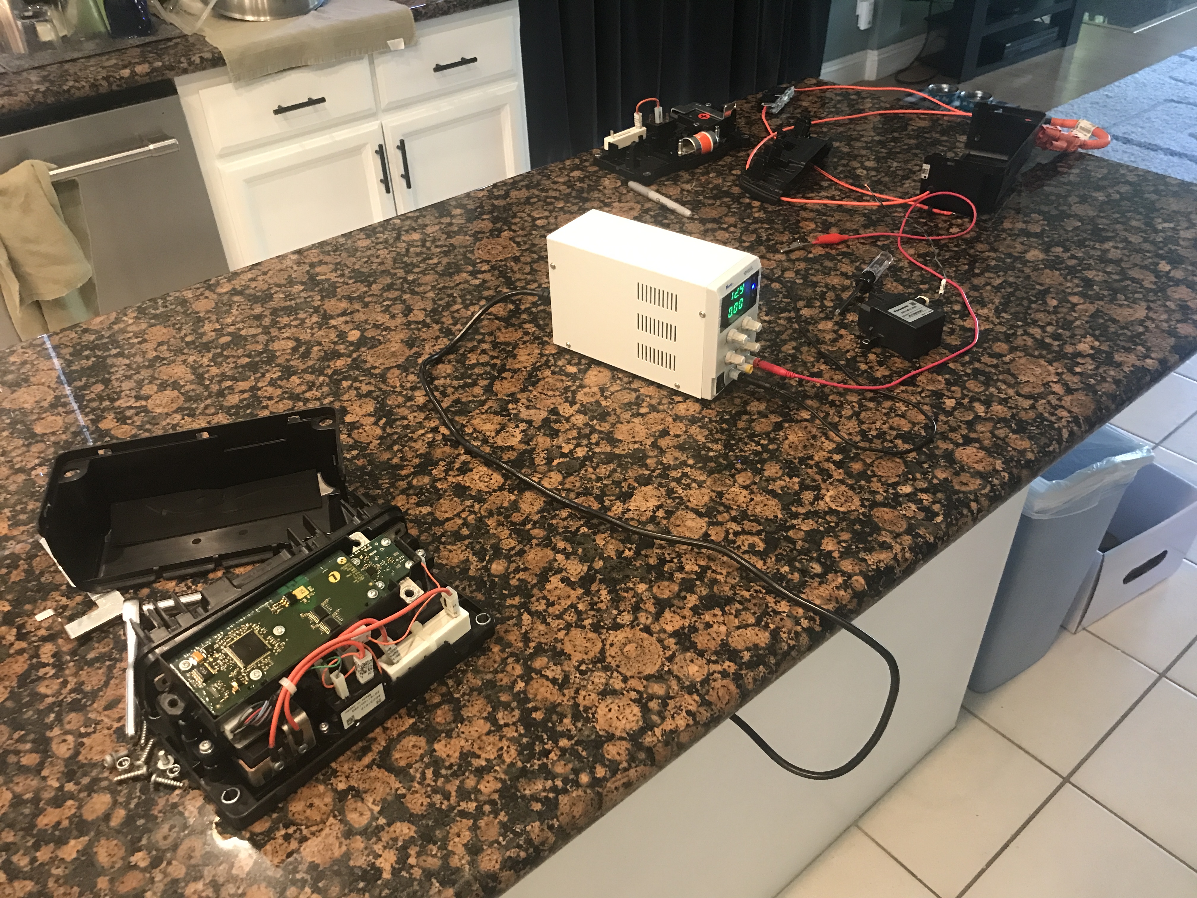

so can I fix it? will you help me? if I was a Diode on this logic board, what would I look like? and where would I live?
please and thank you

You don't really need more than a multimeter with a diode check function to check the polarity of any HV power component.
If you get a diode voltage between 0.3V and 1.0V, that's a diode - no matter whether it's a real diode or just looks like one, it acts like one - don't connect your HV this way, there will be infinite current through the diode. In reality the "diode" is the reverse diodes inside the transistors that form a half bridge. In order to know more, type that into Google image search (not sponsored).
Then you switch your probes, and will see the diode check voltage rise from 0.0 to 1.0V and once it goes above, the multimeter will generally show its "open circuit" display. This means the multimeter just charged the capacitor inside the component to above its diode check voltage range and it's also possible to charge it more without issues.
The probe colors are now showing you the way you should connect the HV.
If the measurement does not act in this exact way, then you need to find another way, maybe a more high power one. There might be a bleed down resistor inside the component, or something weird going on.
And you of course should do this at the end you're about to connect to the battery, so that you notice any wiring errors (or have two errors that cancel themselves out... and 2 errors = 0 errors, obviously. Just be wrong enough, right?)

Post pictures we might get an idea. Fixing car stuff is not always easy since sometimes parts are not clearly marked etc...

thank you, did couple threads aboveEV_Builder wrote: ↑Wed May 18, 2022 4:05 pmPost pictures we might get an idea. Fixing car stuff is not always easy since sometimes parts are not clearly marked etc...

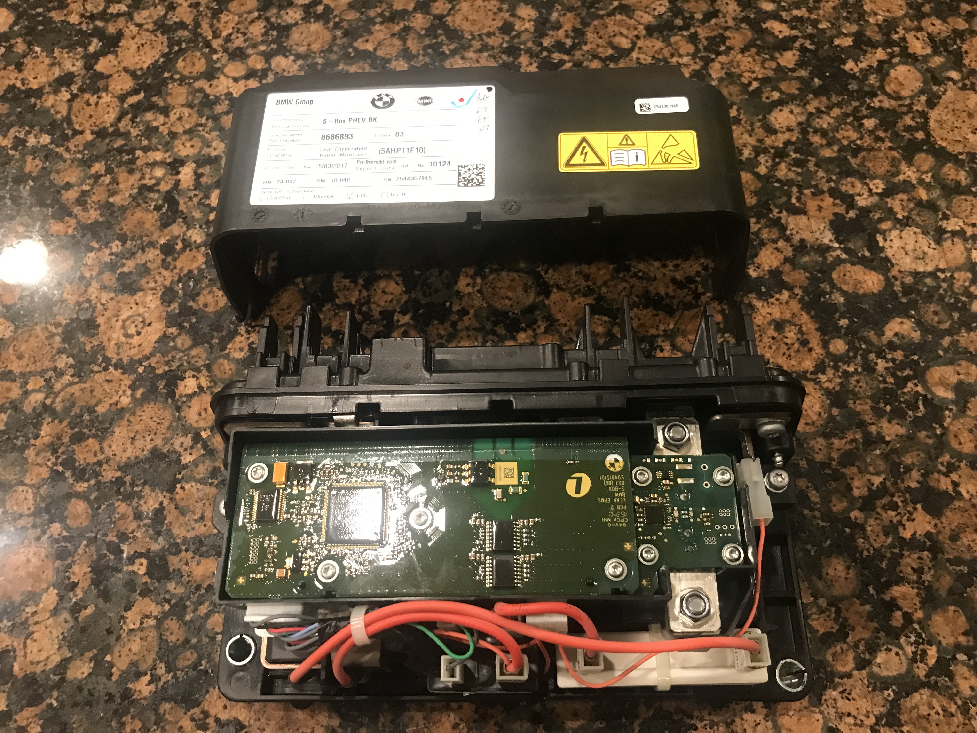

Check the 3 partnumbers with the 3 legged back to two. (one is looks cut).
Those could be diodes. In one of your pictures I also see 12volts on the HV side? That's not to bad I would guess..

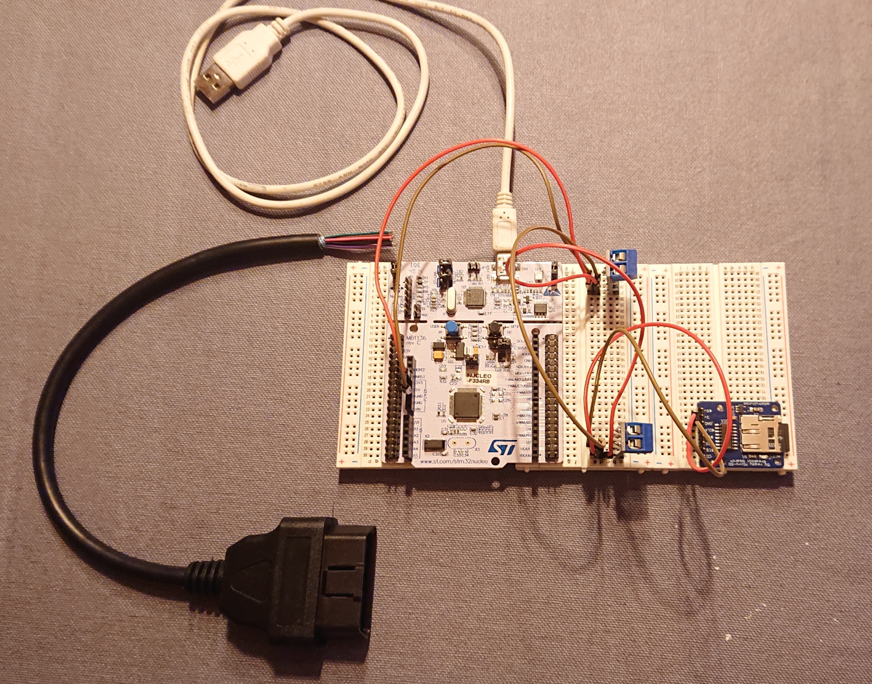

well it's been forever and a day since I played with this stuff, but I am finally ready to hook up the DC DC converter on my truck and was wondering if anyone has gotten it to work with a Teensy in a real world example, and since so much time has passed did they ever come out with a Teensy with a built in CAN Bus transceiver on it for compactability
and I know I have been out of the Teesnyduino game for a minute, but tell me this is wrong and they just forgot a decimal

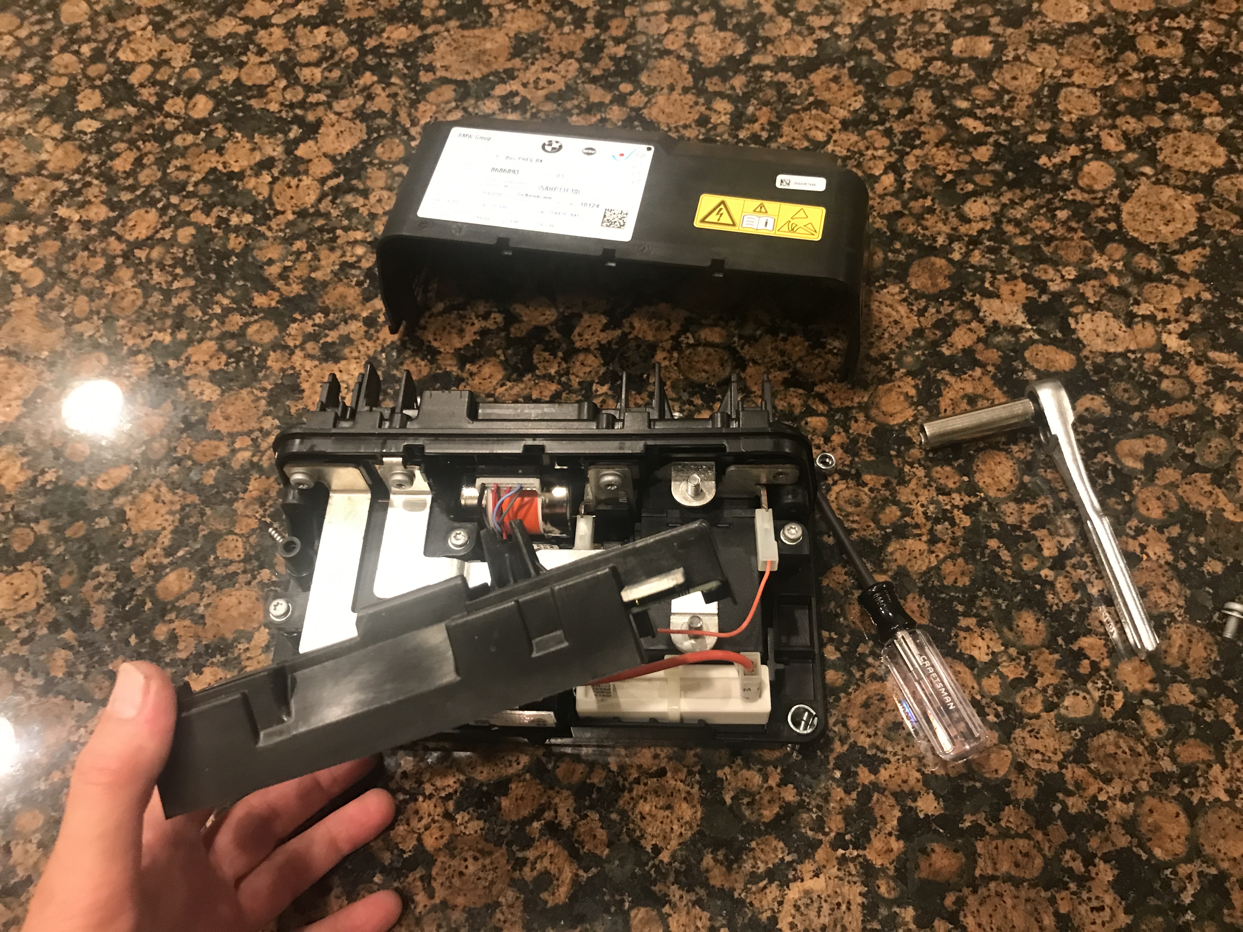

well it's been a while but I think I'm ready to get back on this horse, and troubleshooting the BMW Safety Box (aka contactor box) the other day, yes another CAN Bus speaking animal, with my friend who programs robotic arms and such, he asked how come we are sending CAN commands over and over again, I said what do you mean, and he said: "that's not how CAN works" implying he would only send a command once, cause that's all you have to do, so I am ready to start a thumb wrestling battle over this if you are

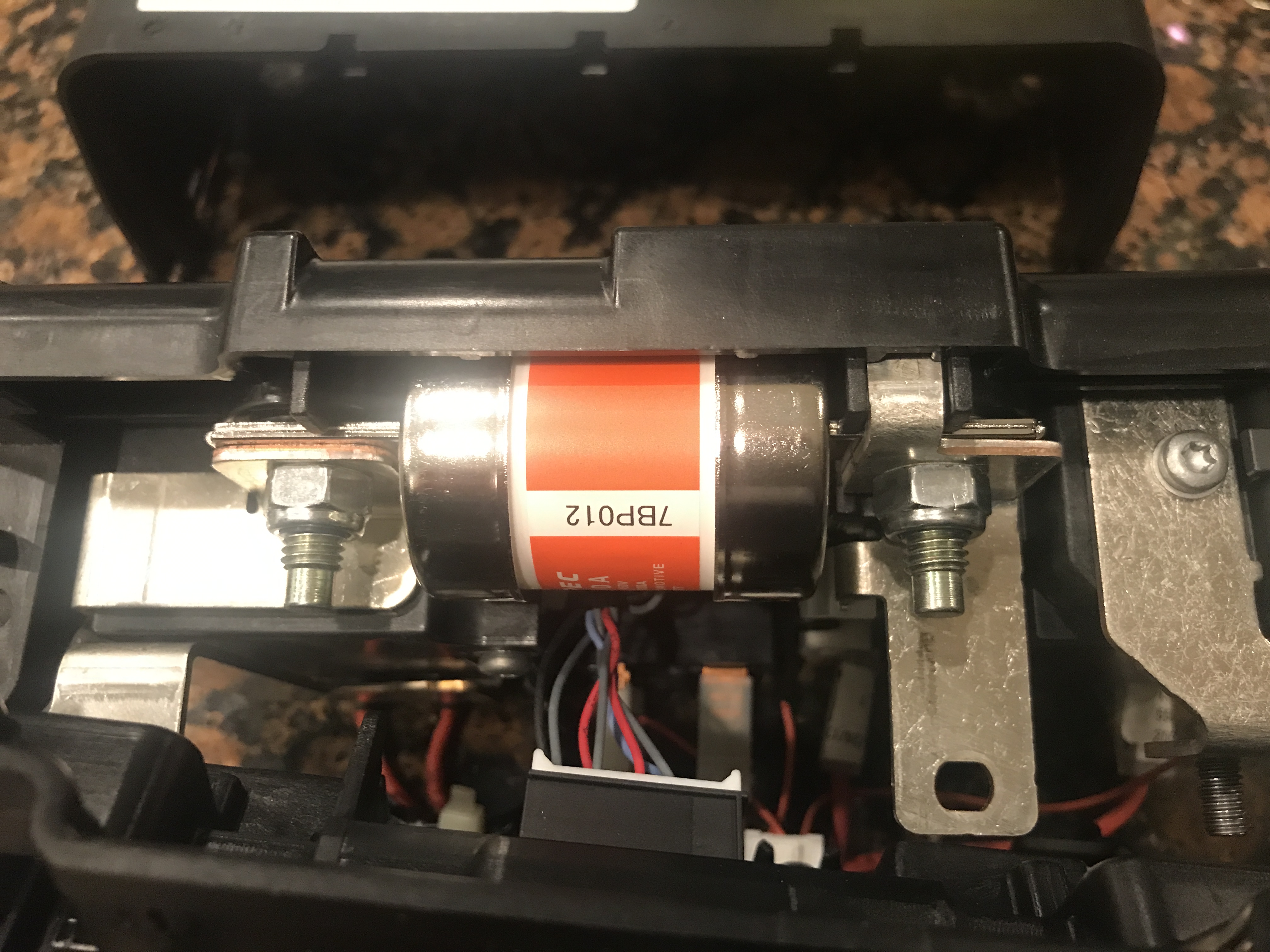

so i checked the B.A.F. for beepness and it beeped, so that's a good fuse
then I checked the capacitors for zeroness and they showed close to nothing aka 0.1 so that's good as well
