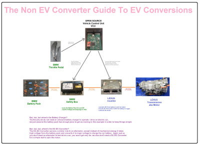

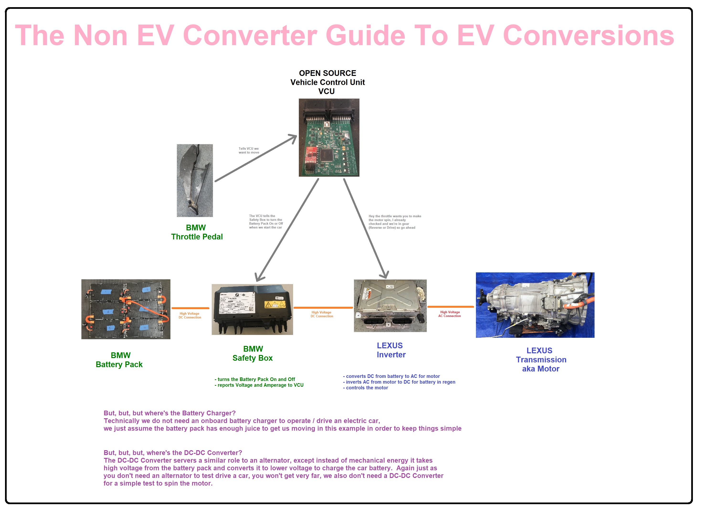

I grew tired of trying to convince my petrol heads that electric cars have less moving components than gas guzzlers so I whipped this out:

Nice, but even this is a bit over complicated or rather very brand specific.
controller -battery-inverter-motor -charger -hvjb

I agree, but it shows a real example with actual photos of real equipment instead of even generic drawings like some diagrams would, by the way what's your input, ... will power ? jk
and I was toying with the idea of doing an HTML based page where you hover over say Inverter and it gives you a choice, Prius, Lexus, Leaf, and then based on that choice when you go to select a motor it shows you the compatible motor, etc.... but you know, I'm lazy
