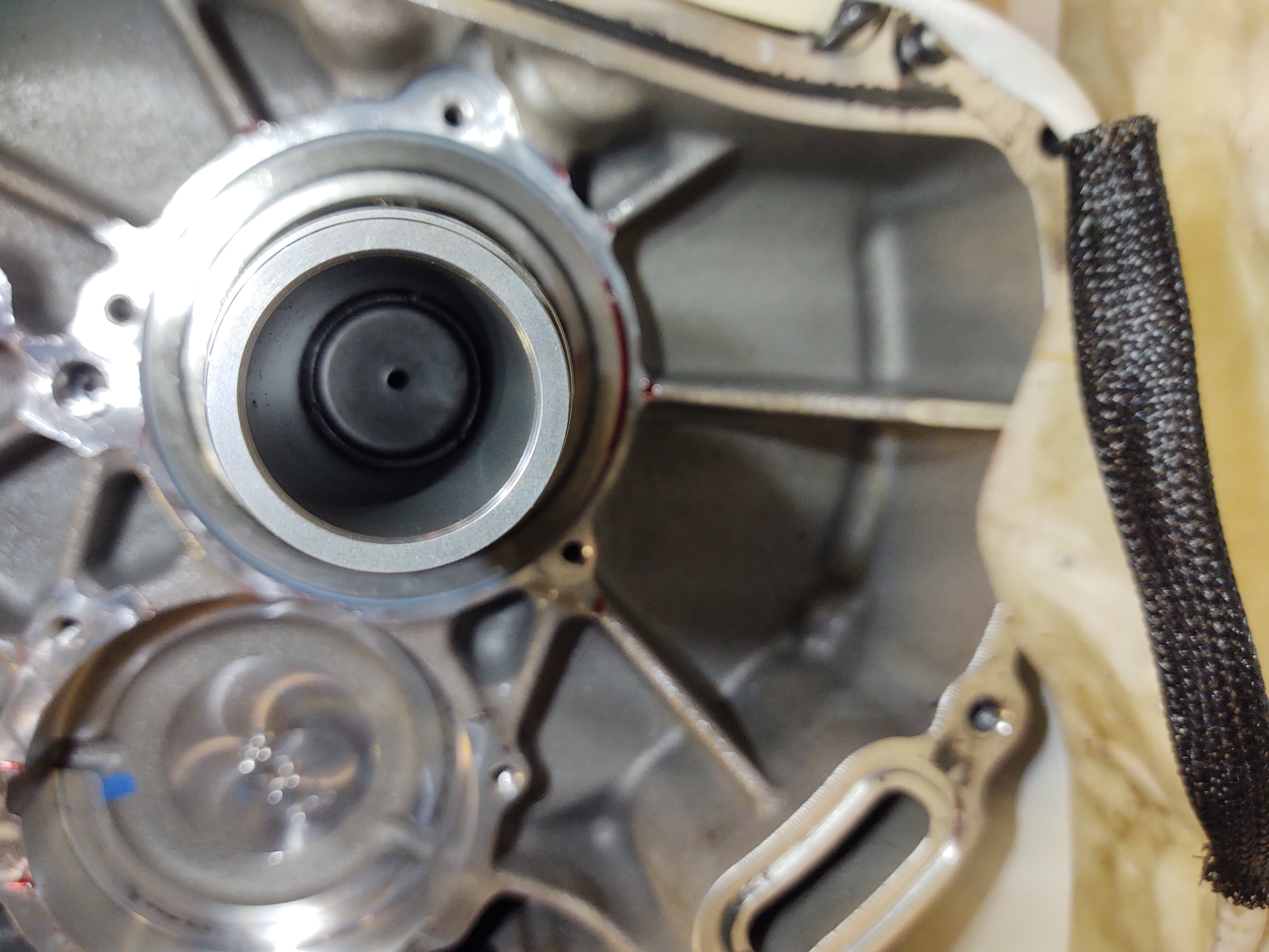

~4k mile update on Ceimin seal
@2k update (2/8/23) showed couple spots of hard film that required scraping off if speed sensor viewtopic.php?p=52682#p52682
@~4k update (7/3/23) show a dried brownish streak on speed sensor. Obviously spun by reluctor wheel. So question is... what is it?
1/2 streak was slightly wiped off by finger in the pic. Reluctor chamber drain tube shows dried brownish residue as well. Nothing on the ground from drain tube.
ATF still full so likely no ATF leak into motor. Loosened ATF drain plug slightly and oil (and not water) oozed out so no water in the gearbox.
I guess possibilities are
On the idea of running oil coolant + heat exchanger with coolant. QC Charge seems to be prototyping now

- Slight seal leak while driving and reluctor wheel spun it onto the speed sensor creating the streak. But drain port doesn't allow pooling and constant spray onto the speed sensor
- Condensation from the drain port opening. Live in Pacific Northwest, car parked in garage. Only drove once for 45min in light drizzle rain since LDU rebuild (avoiding driving in rain (or even wash the car) in general due to poor moisture seal in front battery pack and high DC. voltage connections)
- Coolant leak in rotor/stator chamber. Only source is 1 coolant passage channel at bottom of end plate to stator housing (sealed by o-ring and RTV). Coolant passages within stator housing or rotor leaking... Can't check any of this without pulling the LDU.

A tablespoon of oil will make an enormous mess on the floor or distributed by moving air over external components, but won't show up on a level check. That said, the color of your streak/stain alone makes one think of rust, not ATF.
Yes. Also dried and not oily so rust rather than ATF
Not sure where can rust in reluctor chamber. Maybe between the triple seal lips. No idea. Anyhow probably pull the LDU / coolant manifold for inspection in few month for first annual checkup haha.

We cut a weep hole in the lowest spot in the seal chamber. Position sensor hole is higher than this but any accumulated liquid here would just run down to the lowest spot. Here is a pic of the weep hole and speed sensor mounting location for reference.

That looks great.Weep hole

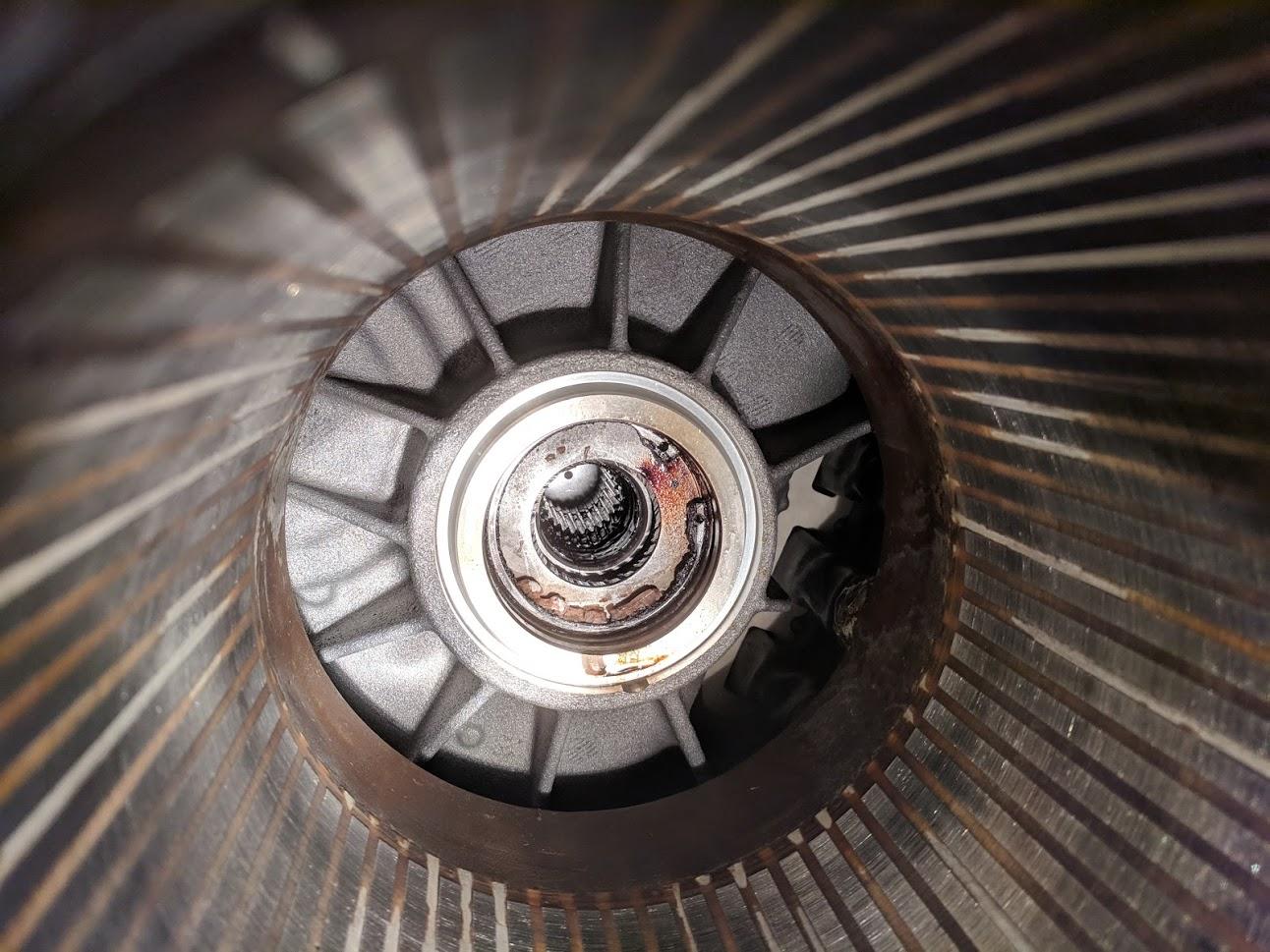

Hello, I've been watching this thread for a couple weeks since my 2012 S with 180,000 miles threw some error codes and shut down. There was coolant leaking into the motor causing an isolation fault. This P85 large drive unit was last replaced in about 2017 and has about 80,000 miles on it. Using the information from this site I pulled the motor and split the case. All your posts were very helpful! The rotor spins freely and has no lateral play but will not budge when I try to remove it. I've seen what happens to bearing mating surfaces when they are pounded on with sledgehammers in other applications so I decided not to go that route. I built a horizontal press to push the rotor out in a controlled manner. It uses a 12 ton bottle jack for the force. I fabricated a pusher nut that fits over the roller bearing contact surface of the rotor shaft and bears on the flange behind it so I won't damage the shaft. The other end of the press has a hole large enough for the bearing on that end of the rotor shaft to fit through so there will be no binding. Here is my problem: With at least 10 tons of force from the bottle jack there is no movement in the rotor. I tried tapping parts of the jack, press frame and push nut with a 3 lb hammer while it was under pressure to no avail. It has been under full pressure for hours with no changes. I fully expected the ceramic bearing to break apart. I have a new set coming from Ukraine so I'm not worried about destroying the bearing. I have more coolant seals coming from China to the Chicago area as well. Does anyone here have suggestions or comments on what I may have missed? My other 2013 S 85 has a bad bearing in the drive unit so that one will be next. I wonder what Electrified Garage and Tesla do to remove the rotor shaft. Gruber said in mid July 2023 that they won't take the job because they can't get parts. I'd rather do it myself for the $6000 US id have to pay someone else. Thanks for your help. Attached are some pictures of the press I made specifically for this job.

Without a top view, and not having a lot of in-person experience with the LDU at this stage (other than visiting Howard a couple of times during his journey), I can't tell if there's clearance between the end of the rotor and your end frame in this picture.
Regardless, you are not pushing on the rotor, but on the pinion gear. I believe you're pushing on the back of this:
You are pushing against the pinion gear/shaft, which abuts a retaining ring in the case:
[later: forgive me: this is a pic of a RAV4 EV pinion, which is why it has that "extra" externally-toothed doo-dad on the end, for the Toyota-mandated park pawl that Tesla made just for this vehicle and the MB B250e. It's the picture I have handy, though . . . ]
Lemme go find a vid (no, not Idiots at Work, something less combative . . . I'm well into "wine time" tonight) . . .
. . . found it:
Worth it to see the vertical alternative, but now that I've reviewed that vid again, it doesn't mention the important part . . . I think.
I'm guessing that you want to use a drift and press through the pinon to the end of the rotor.

You'll want to press on the end of the rotor, which looks like this when it's got rusty bits around the rotor's bearing, to the inside of the pinion shaft/gear:

After pouring WD40 in it last night and sleeping with this on my mind I came out this morning to find exactly what you described. I'm pushing on the pinion shaft. I will now attempt to remove the collar inside the pinion shaft so I can get to the end of the rotor shaft. I'll probably use a slide hammer with a course thread on the end to grasp the collar. The flared end of the collar is inset 2.320" (59mm) from the end of the pinion shaft. A brass mandrel should be soft enough to not damage the splines as I push the rotor out. I should make a video of this process but I don't have the necessary equipment. As a side note, this 2012 Model S has 182,000 miles on it and the motor has been out at least twice for bearing noise repairs. The tag does not specify REMAN so it might have been a new revision R motor when it was installed by Tesla under warranty. I'll check the exact mileage and dates shortly. Updates to come...

They're pressing on something. IDK what, but it stands to reason that pushing on the pinion shaft/gear won't work.

@2oldteslas
Really not sure how you got the rotor out. There is no way to push on the primary shaft as the 6208 bearing is blocking the way when pushing on it to get rotor out. Thats why when you press on the primary shaft, it didn't give. It will never give. Primary shaft with the 6208 bearing must be removed to press/hammer the rotor free IF the rotor is stuck.
Rotor's inner ceramic bearing's outer race is either rusted or locked in the bore with retaining compound. I took the primary shaft off and sledge hammer it out.
Anyhow, not really sure what you did to get it out. Your pic also shows the inner ceramic bearing was in the bore with the rotor out while cleaning the stator. So not sure what happened there, did your rotor come out without the inner ceramic bearing? If so, I heard from Alex @ QCC (San Diego LDU rebuilder) when that happens (rarely) need a tool to pull the ceramic bearing out from the inner race.
Not sure where you got this pic but I think its for pressing in the 2x ceramic bearings. Rotor slips in vertically into the round hole cutout. The 2 vertical stands below the cylindrical opening act are stops against the end of the copper rotor.

I had the gear case split apart. Inside the pinion shaft there is a steel collar that looks to be a grease stop for the rotor splines. It has a small hole in the middle so I screwed a self tapping screw into it connected to a slide hammer I made to pull the cap out. Then the rotor splines are visible through the pinion shaft. I used a brass slug and a steel bar to push the rotor out with the press I made. The inner ceramic bearing stayed in place when I pressed the rotor out. I took the grease seal off with the tools I got from the machinist and redistributed the grease without removing the bearing. The outer one was much easier to access since it came out with the rotor. The entire assembly is back together and waiting for the coolant seals I ordered. I'll probably use the 2 lip seal first, I think 3 lip is overkill and I've read that it doesn't fit properly.

Now that I'm looking inside the stator with a magnifying glass these metal shavings "hairs" sticking up look more like fibers from the insulating casing around the windings. They don't appear to be metal at all. It sucks getting old, haha.
