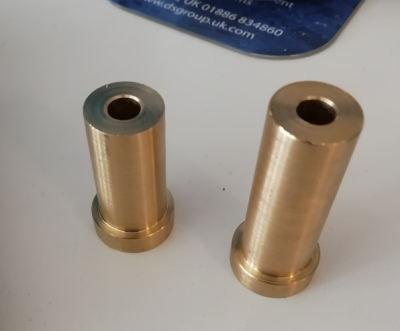

crasbe wrote: Fri Jun 30, 2023 11:50 am Yes, I had the wrong factor when changing from mm to µm.
Doesn't really change the conclusion though.
Gentlemen/Ladies we are talking about a piece of material 1" in length aka the spacer, I am no expert but will it make any different what it's made of and how much it expands? honest question really
crasbe
Posts: 330
Location: Germany
Has thanked: 58 times
Been thanked: 180 times
Post by crasbe »
Simple guideline to spacers:
- Buy/make/steal a spacer in your desired length made from brass or copper.
- Use a galvanized, metric grade 8.8 bolt (not the cheaper, lower grade 4.8) and Loctite medium strength (or your preferred other brand).
- Torque the bolt till you feel confident it will neither snap nor be excessively loose.
- Done and be happy. :)
(Being happy includes not worrying about expansion. It's not that relevant.)

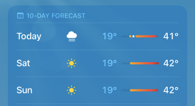

Me: gonna get a lot done in the garage this weekend
The Weather Forecast:

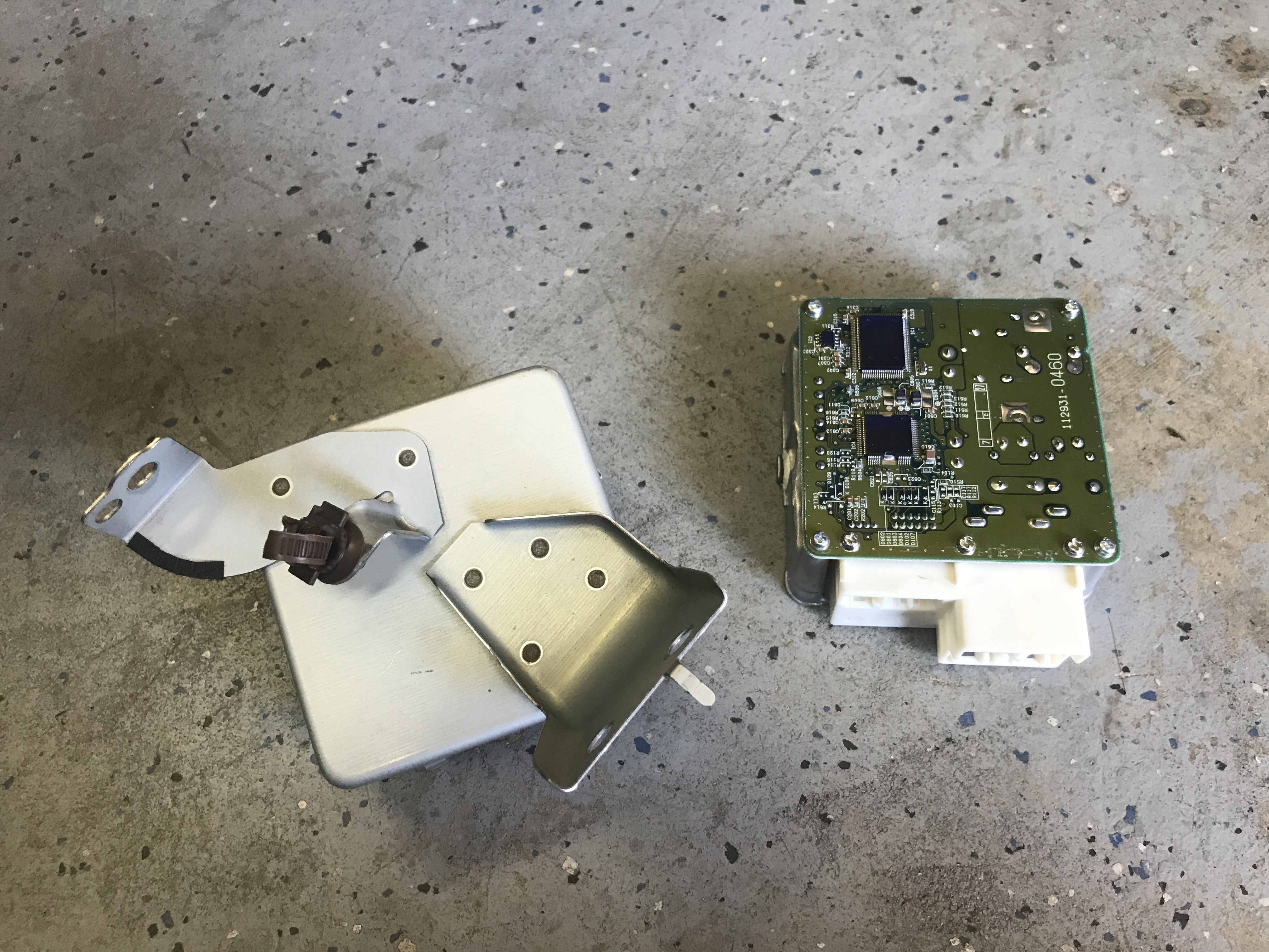

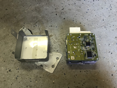

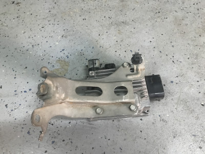

Post by Gregski »

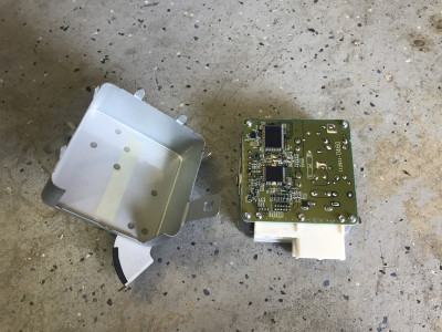

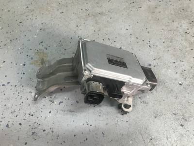

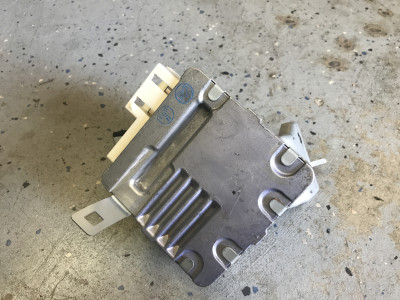

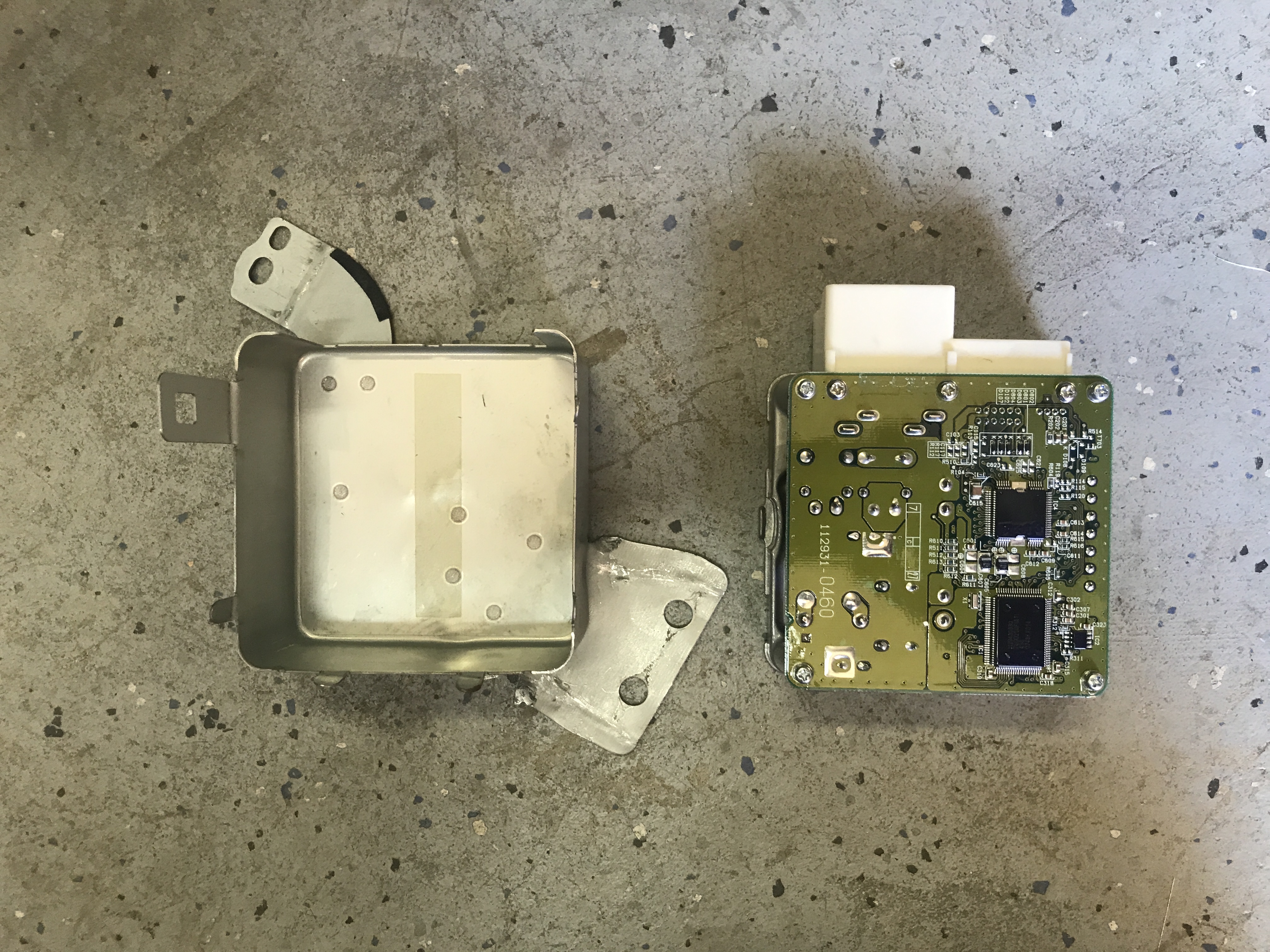

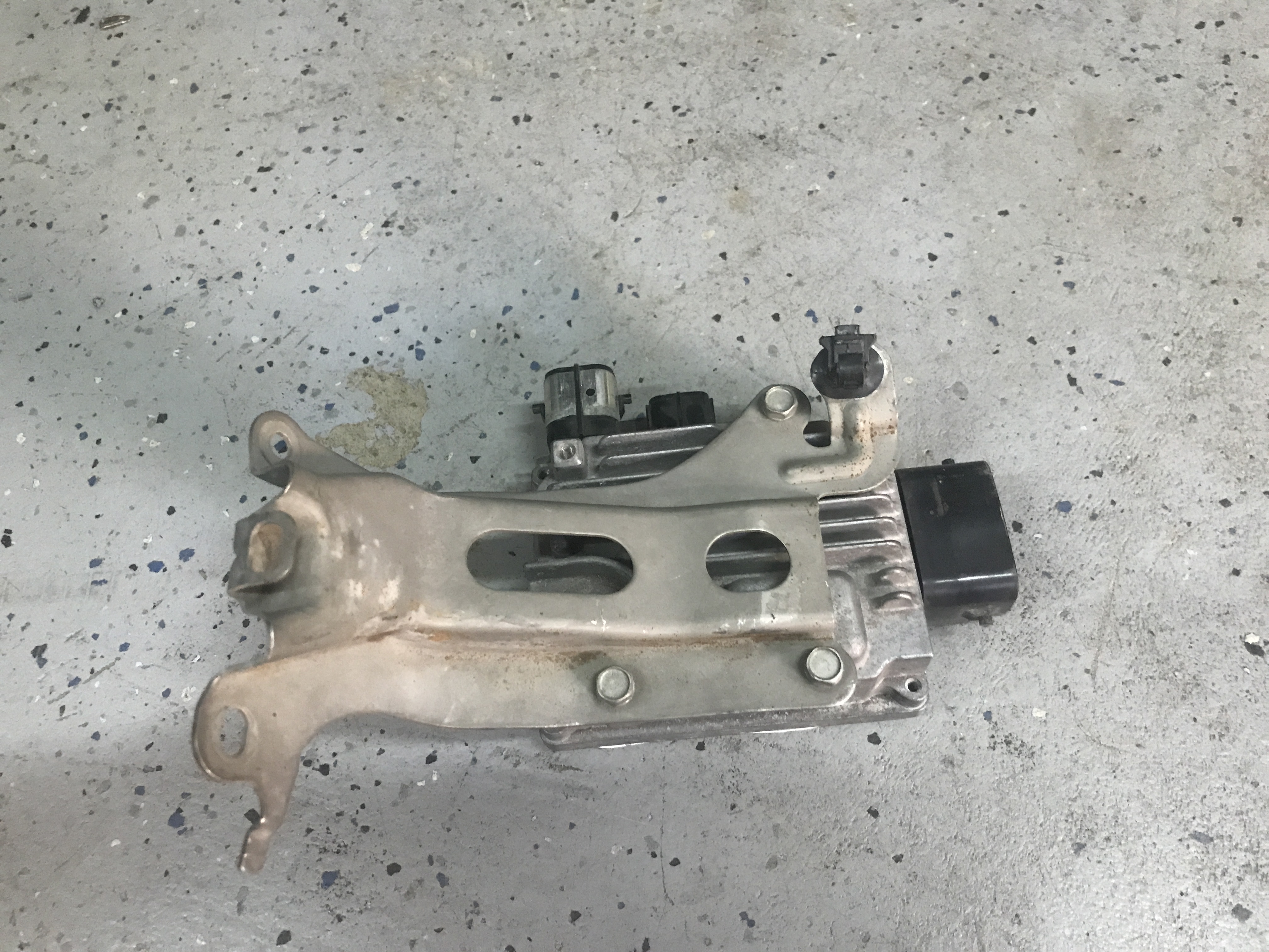

and then it was time to mount the second gen Toyota Prius electronic power assist steering brain module thingie
well the first thing I learned is that the lid comes off
what kinda alian space ship mounting bracket is that ?

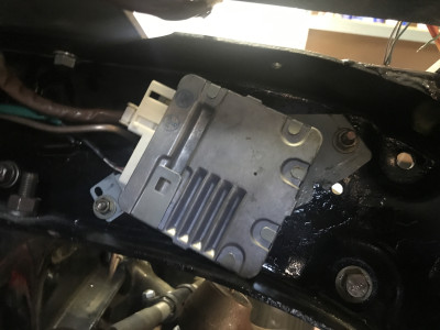

Post by Gregski »

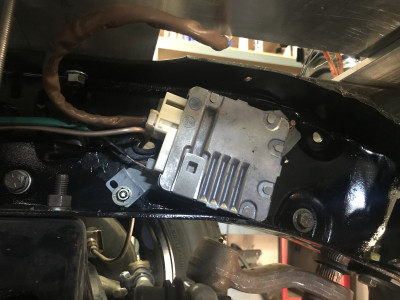

I must admit I was very surprised how nicely this Toyota part bolted up to the Chevy truck, only one extra hole had to be drilled in the truck frame
Note: this module originally lived inside the cab of the Prius so it is not weather proof or tightly sealed at all !

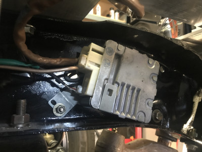

Post by Gregski »

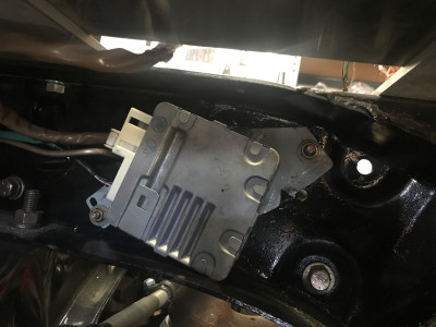

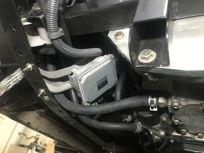

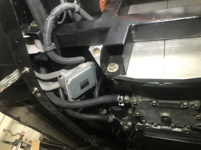

so I snuck out and mounted the Lexus transmission oil pump controller to the '69 Chevy frame this morning (for what I hope is the last and final time) before it got to 80°F at 8:00 am
yup, yet another OEM bracket that looks like it just fell off of the USS Enterprise, but what do I know I'm not a Star Wars fan
dang it I just realized I fed those frame bolts in the wrong way, that will never pass tech, don't let Johannes see that!

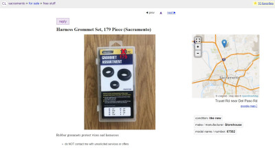

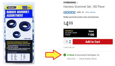

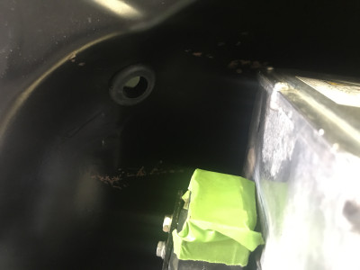

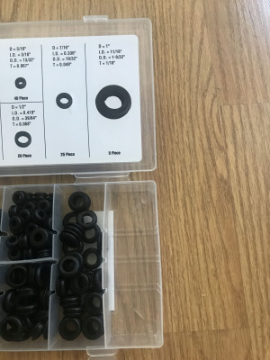

Post by Gregski »

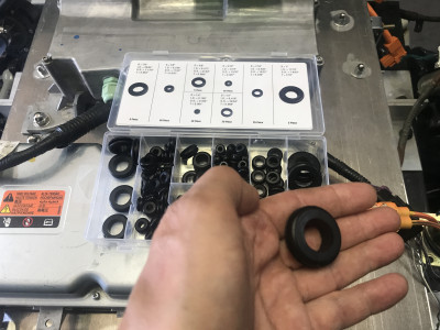

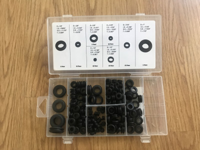

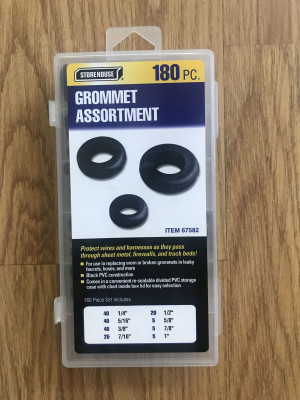

can you guess which grommet I needed ?
here's a hint
Gregski
Posts: 3164
Has thanked: 635 times
Been thanked: 1610 times
Post by Gregski »
you can't make this sh!et up folks
Gregski
Posts: 3164
Post by Gregski »
five stores later...
Gregski
Posts: 3164
Post by Gregski »

Post by Uppertown »
I got two Brass spacers to Damien's design from one of those people on eBay that advertises spacers to your design for the equivalent of about $30 delivered.
Mhs
Posts: 65
Joined: Fri Jul 26, 2019 8:06 pm
Location: Bahrain
Has thanked: 311 times
Been thanked: 13 times
Post by Mhs »
Uppertown wrote: Mon Jul 03, 2023 10:17 am I got two Brass spacers to Damien's design from one of those people on eBay that advertises spacers to your design for the equivalent of about $30 delivered.
Hello, do you mind sharing the ebay user and link?
Zombieverter
Uppertown
Posts: 73
Location: North East England
Has thanked: 175 times
Been thanked: 36 times
Post by Uppertown »
Mhs wrote: Mon Jul 03, 2023 10:27 am Hello, do you mind sharing the ebay user and link?
https://www.ebay.co.uk/itm/324569607798
I've no idea if they will ship to Bahrain but Damien does offer the spacers direct via his webshop.

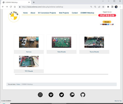

Gregski
Posts: 3164
Post by Gregski »
Uppertown wrote: Mon Jul 03, 2023 10:38 am https://www.ebay.co.uk/itm/324569607798

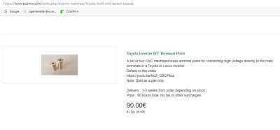

I did recall seeing them on Damien's EVBMW Webshop a while ago, but I no longer see them, unless I don't know where to look, also I think the Services offering is new?
Uppertown
Posts: 73
Post by Uppertown »
Under Toyota boards;
Gregski
Posts: 3164
Post by Gregski »
Uppertown wrote: Mon Jul 03, 2023 1:21 pm Under Toyota boards;
thank you, I swear I looked there before posting

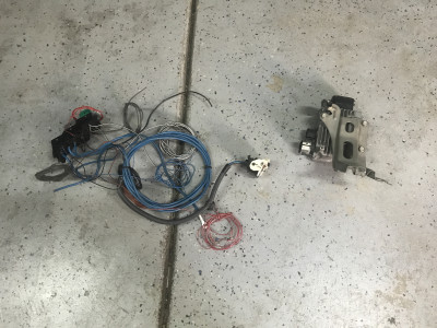

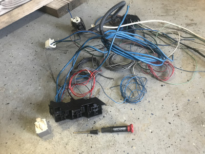

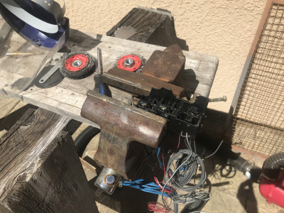

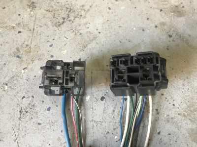

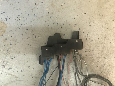

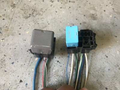

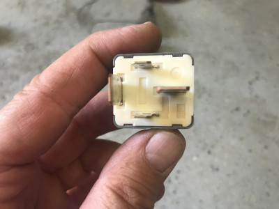

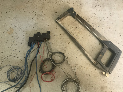

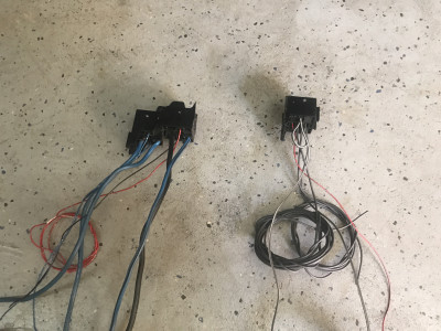

I don't know how you all do your wiring, but I don't do anything without my trusty hack saw
on a bit more serious note, repurposing the stock TOYOTA / Lexus OEM relay sockets is a bit of a PIA as there are 4 pin relays, 5 pin relays and umpteenth pin relays, plus some relays served multiple purposes, think rear window wiper and radiator fan type of deal
so as much as I wanted to have them consolidated and nicely mounted together, I only want to use 4 pin relays that are all the same style (not rating) for the oil pump, water pump, steering motor, and eventually iBooster
Why not use aftermarket sockets? Well I ordered some ( R95-160A ) but I am pretty sure they won't come with these really nice heavy duty 8 AWG wires like the stock ones do and the super wide 10mm blades
so here I just lopped off the non compliant 5 pin relay or whatever pin it was
Gregski
Posts: 3164

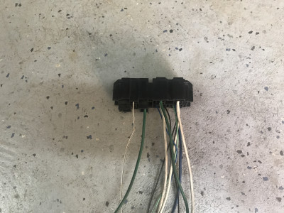

Post by Gregski »
the same fate will come to this one, see how on the right those are actually two separate baby relay sockets and one is a 4 pin baby socket and the other a 5 pin baby socket, designed by the devil herself

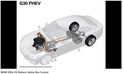

Post by Gregski »

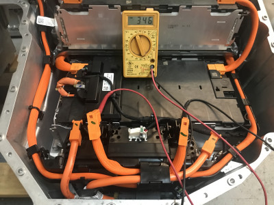

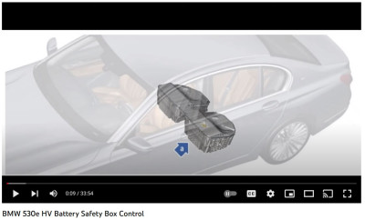

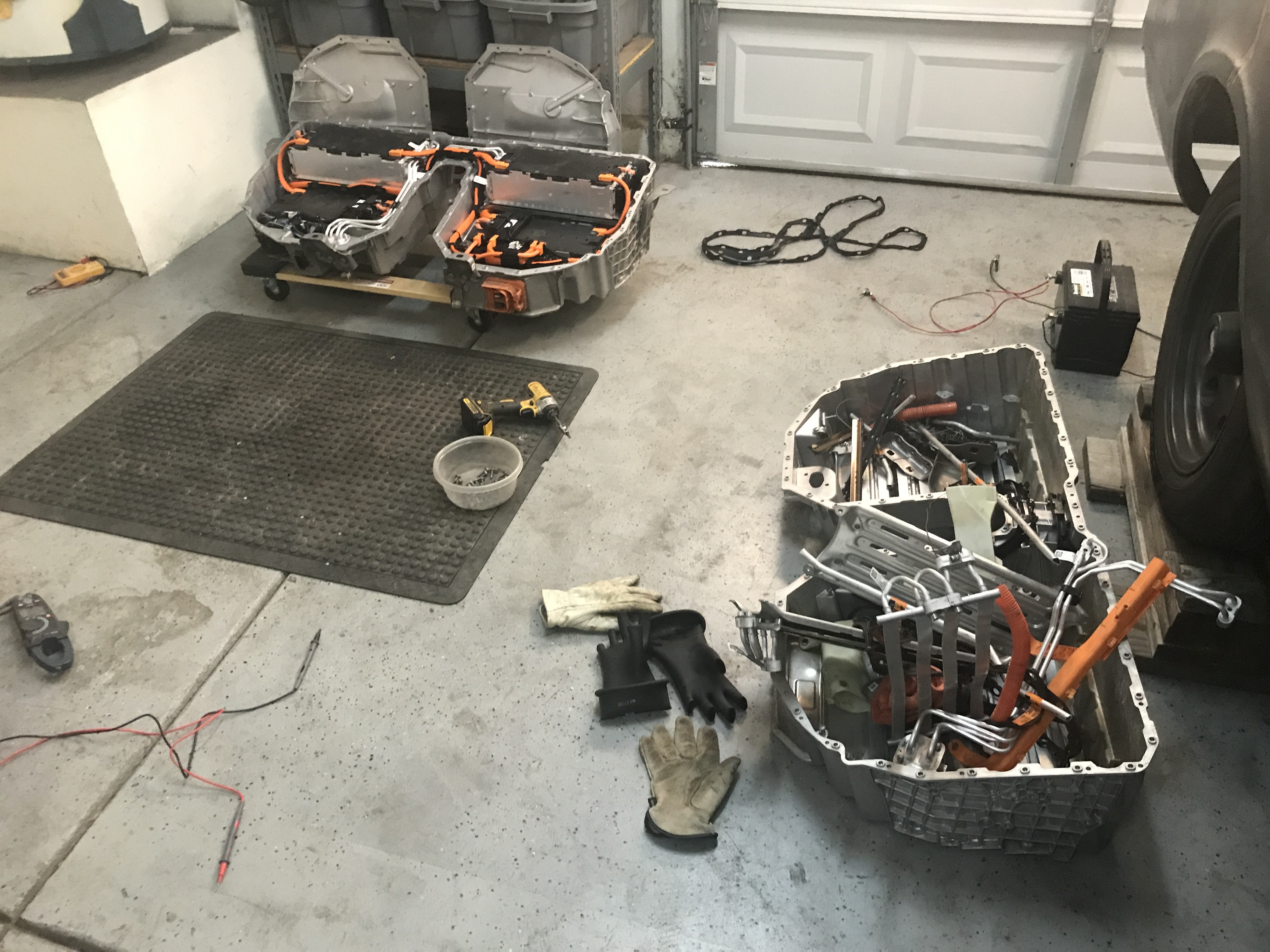

if you are in the mood for knowing a bit more about the batteries that will power this beast, I just uploaded this new video and it is pretty down to earth
think of each battery like a 9 gallon fuel tank, and I have two of them, the MPG for EVs is guestimated using 3.5 mpg so about 30 mile range per pack, and my original plan was to run three packs for a range close to 100 miles
however I have recently heard it's more like 4.5 mpg so closer to 40 miles per pack, we can only build, test, and see for ourselves
