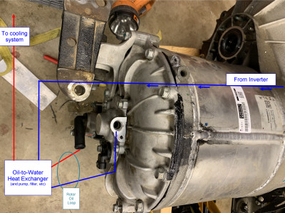

I think the M3 front induction motor uses an oil-to-water heat exchanger (see exchanger on left side of the pic below). It's cooled by oil internally, and the oil is pumped to the exchanger that's bolted to the exterior of the DU. Additionally, the coolant loop cools the inverter electronics first (see the coolant fitting on the right of the pic below) before routing to the heat exchanger, so the more temperature-sensitive electronics get the cooler coolant.
My suggestion idea No. 7 above was to use a non-water-containing coolant (basically: glycol) instead of a 50/50 water mix, so any leakage would cause no corrosion nor electrical harm. I bought a gallon of a typical gycol coolant, and a spare Tesla coolant pump and PWM module, but it's all sitting on one of my workbenches right now, waiting for some testing time.
I don't know if it's practical to convert the LDU to oil cooling for the rotor, and an external heat exchanger, but it's possible. The external aluminum coolant tube that the LDU uses to move coolant from the inverter side to the rotor side, could be interrupted, and a small closed-loop oil circuit established for the rotor side, plus a heat exchanger.
This might be practical for recycled LDUs in EV conversions, but possibly not practical for Model S installations, which is what Howard is aiming to achieve.
My drawing tools are limited, but here's a mockup of a oil-to-water heat exchanger, plumbed in to an LDU:

As for adding a oil cooling loop. Besides the fitting and oil flow pump power requirements. Also need to consider if want to use oil in the much smaller flowing passages within inverter phase plates. It seems desirable to just cool the rotor with oil and leave the rest to remain with coolant. This would require a custom manifold with proper channel divisions which gets into yet another sourcing + manufacturing item.

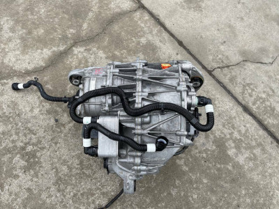

We opened a drive unit for the first time.
This one is making the (in)famous milling noise when driving.
no leakage in the motor found.
Which bearings are the usual suspects. Is there a way to check the bearings
IMHO the bearings of the rotor shafts are noisy
Any suggestions are welcome.
https://youtube.com/shorts/LgdjdP0V-ok?feature=share

From memory (ie this is not Gospel):
The coolant seal replacement is the primary focus of this thread, so reading it top to bottom will give you the current thoughts on replacement/modification. If you have no coolant leakage past the far end rotor seal, yet have milling noise, I'd guess you have an early production (2012-2013?) LDU with a failed Aegis ring and steel balls in the rotor bearings. Replacing the bearings (for noise) and the seal (because you don't really have a choice, once it's been disturbed) will likely get you back in service; the pinion bearing may or may not "need" replacement; if it was my budget, I'd replace it anyway, but my budget isn't yours, so it's in your lap on that one.
- The far end rotor bearing (the one that gets the most coolant ingress from the leaky seal at the far end coolant manifold, by the rotor speed encoder)
- The near end rotor bearing (due to early production units not having enough rotor grounding (via Aegis ring brush) for stray AC induced rotor currents)
- And the pinion bearing at the rotor near end (due to the later use of "ceramic" ball bearings on the the previous bearings, moving the rotor ground path into the gearbox).
