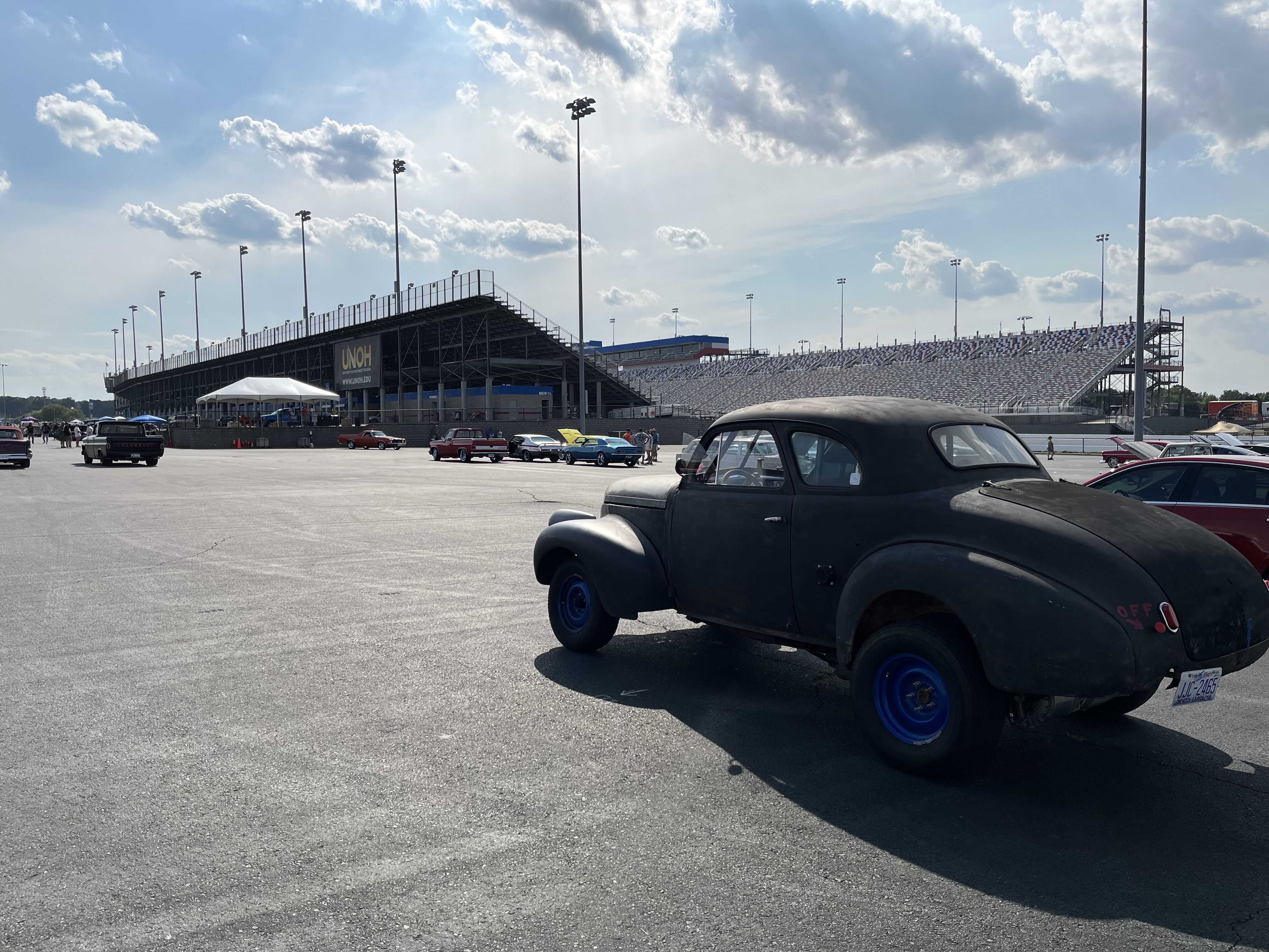

I arrived around 5pm, 30 minutes after on-track time had ended, but 30 minutes before the event ended. After being sent on 3 wild goose chases, I finally found the check in, and then spent about 30-45 minutes wandering the vendors as they packed up. I got to see Chevrolet Performance's new EV conversion kit, and hear from their rep that while it's now on sale, you have to have their certified shop install it.

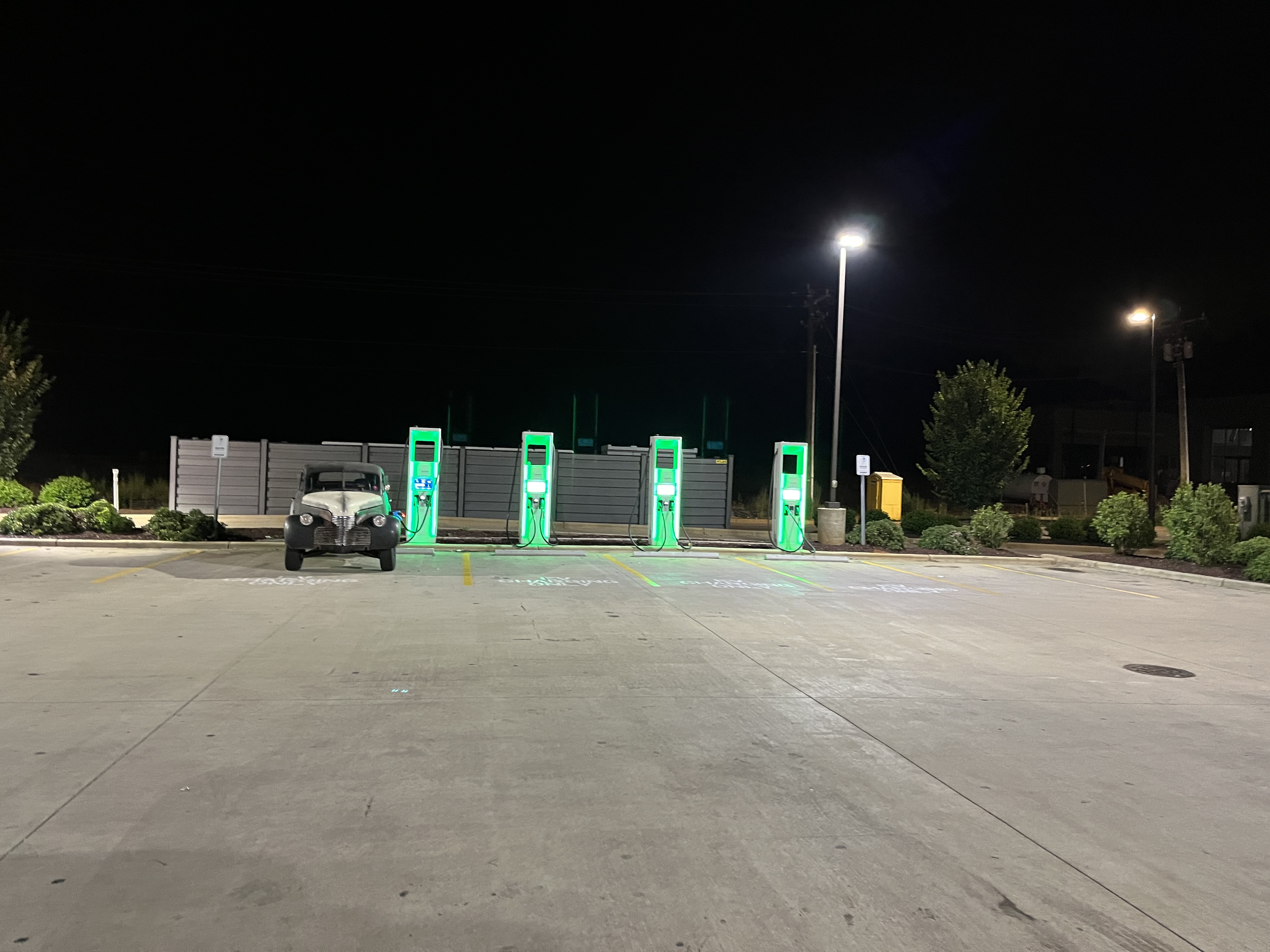

It was at this charging station that I learned some important information that made the math make so much more sense. From stone cold dead to fully charged took only 22.5kWh. It's supposed to be a 32kWh pack. That's some serious degradation I wasn't accounting for.
From hear, things got easier, but not easy. By the time I left the Lexington charging station, it was around 9pm. I headed 22 miles up the road to High Point, to a station at a Hyundai dealership, because the ones closer to I-85/40 were marked as down on PlugShare. Well, that station was ICEd. Fortunately, there was another station around 10 miles away that, while PlugShare showed as down, EVGo's own app said had been used 6 hrs prior. I headed there, and the station worked flawlessly.
From here, things got easy. I tried to keep driving legs to 25-30 miles, just to be careful. I hit a charger in Burlington, then one in Hillsboro, which was the same charger I had used for previous range tests. From there I topped off once more in Briar Creek, and then headed home. I arrived home just before 2am.

One shot from the track, and one from the second to last charging stop on the way home:
