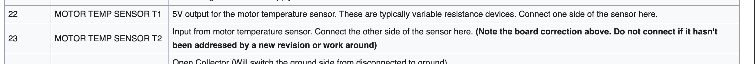

23 on the IDC should be the 5v to one side of the sensor and then 24 the other side of it, and it needs the 1k resistor to ground, either internally or externally.
These are the ampseal pins

Re: Reading phev motor temps
thank you - for some reason i had assumed there were two inputs. i think in my documentation i summarised the labelling and mis-lead myself.
this makes perfect sense thank you
