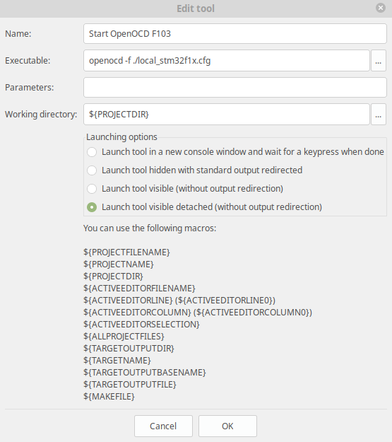

Edit2 - The only way I can find to start openocd from CodeBlocks is to add it to Tools. Click Tools, Configure tools. Click Add, give it a name of 'Start OpenOCD' set the Executable to 'openocd -f board/st_nucleo_f103rb.cfg' (or whatever .cfg suits tour board), set the Working directory to '${PROJECTDIR}' and select the 'Launch tool visible detached' radio button. Then click OK. If you want to be able to stop openocd add another with the executable set to 'pkill openocd' (not really needed but the flashing light on the ST-Link while openocd is running gets on my nerves).

Just found a bug with the above while trying to use it with a Bluepill board. These don't have a hardware reset connection to the debug probe so need a modified board config file. Not found a standard one that quite fits so the easiest way seems to be to add a new one and point the openocd command to it, the contents need to be:
I've dropped it in the project directory which makes it easy to have a single tools command but still allows the project to define what the target processor is so the CodeBlocks tool setup looks like this:
Edit Jul23 -
When setting up openocd in newer versions of CodeBlocks PROJECTDIR has changed to PROJECT_DIR.
Also name used above for config file is not very sensible (it implies a stm32f1 processor while I'm using this for an f4 processor too), now use the name openocd.cfg so it's appropriate to any processor.
