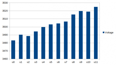

Re: Switched ADC BMS

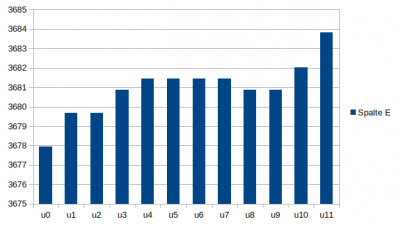

And just discovered another issue:
I think this is caused by the resistive dividers of the mux being on there 24/7. The lower the cell, the more often will it see the little drain. Would be less pronounced in a car with less uptime but still, a BMS should never contribute to disbalance. Amazing what many 10k of resistance can draw over time.
Argh
EDIT: makes we wonder, could the mux control also be floating... gotta think about this.
This is the voltages of my 40Ah ESS pack. When I installed the BMS 7 weeks ago, the delta was 5 mV. Now it is more like 50 mV.I think this is caused by the resistive dividers of the mux being on there 24/7. The lower the cell, the more often will it see the little drain. Would be less pronounced in a car with less uptime but still, a BMS should never contribute to disbalance. Amazing what many 10k of resistance can draw over time.
Argh

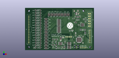

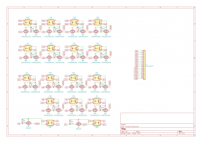

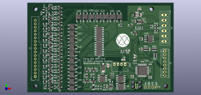

I'm redoing the topology now. Each P-FET pair will have its own opto coupler controlled from the LV side. The STM32 is directly connected to the 3-to-8 decoders. Adds the optos (5 cts each) but makes 3 74HC chips and 18 N-Fets redundant. I'm keeping the decoders to have a degree of hardware protection against SW bugs.
- Posts: 5843
- Has thanked: 164 times
- Been thanked: 1063 times
This would be the new mux design:
And the according layout
The two lower channels are NFETs and when turned on are connected to the cell 2 above it to always have sufficient gate voltage. The upper channels keep the PFETs that are pulled to the cell 2 below again fur sufficient gate voltage. This will draw an equal amount of current from all cells when doing a mux sweep, except the lower 3 cells. They deliver twice as much. I think I will compensate for that with lower pull down resistors on the upper channels.And the according layout

Bipolar optos, with 10k load, can be quite slowly turn off, this needs to be considered for the blanking time. And maybe series resistors on the outp/outn would avoid smoke. And is it possible to place parts on the bottom side, to reduce the PCB size?

Yes, I already use it in that application (see my ESS thread under renewables)Jacobsmess wrote: ↑Tue May 09, 2023 5:14 pm Apologies for my ignorance on BMS type things, but will this be a flexible option to manage any homebrew battery packs up to certain cell amounts? Thanks
Yes, will make sure to insert like 50-100us of blanking time, not a lot compared to the 25ms sampling time per channel.
JLCPCB only allow one sided population, double sided should indeed make the board a lot smaller.
I'm SO sure that I will no longer have glitches now that I omitted the resistors - will regret later
I have also now gone over all mux states and calculated the total current draw through the pull-up resistors. The very first and very last channel see the least draw, also the 2nd one sees a bit less and the middle ones all have the same. I have changed the resistors to compensate for that, the upper-most channel needed an extra 2k4 resistor switched in to be on par. Now I'm at 54mAh/year between the cell that sees the least and the most draw (assuming 24/7 ontime)

Took 5 days to put the cells back in balance:

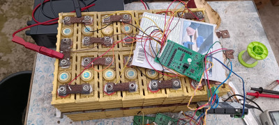

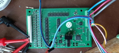

I have received the new boards and hooked one up. Worked out of the box this time.
Next I will assemble a test battery to test two modules in cooperation. The thing that didn't work back in London.
STM32 had a little surprise for me: PB4 is tied to JRST (jtag reset). So you need to turn jtag off. But in order to do that you need to enable the AFIO clock. Took me a few moments to figure out...

I don't see how this could be the problem unless your control mosfet is not off fully?johu wrote: ↑Sun May 07, 2023 7:22 am And just discovered another issue:
Argh

The gates of the P-FETs are pulled to the voltage they are switching with a 10k pull-up resistor. E.g. gate of FET for V7 is pulled to V7. To turn on the gate is pulled to V0 by its N-FET companion via another resistor, say another 10k. So now current is circulating through two resistors pulling like 1mA from cells 0-7. It means cell 0 sees all turn-on currents, cell 1 sees 15 out of 16 and cell 15 sees just 1. You could say cell 0 sees a constant draw of 1 mA and cell 15 of just 1/16 mA. That's how they get disbalanced.mackoffgrid wrote: ↑Sat May 27, 2023 2:28 am I don't see how this could be the problem unless your control mosfet is not off fully?
With the new topology that is mitigated.
Apart from that I just checked the displayed cell voltages against my multimeter and found cell 1 always reads 10 mV low. The others are correct.

Thanks, I misunderstood. The imbalance is not happening while the circuit is shutdown.johu wrote: ↑Tue May 30, 2023 10:38 am The gates of the P-FETs are pulled to the voltage they are switching with a 10k pull-up resistor. E.g. gate of FET for V7 is pulled to V7. To turn on the gate is pulled to V0 by its N-FET companion via another resistor, say another 10k. So now current is circulating through two resistors pulling like 1mA from cells 0-7. It means cell 0 sees all turn-on currents, cell 1 sees 15 out of 16 and cell 15 sees just 1. You could say cell 0 sees a constant draw of 1 mA and cell 15 of just 1/16 mA. That's how they get disbalanced.
