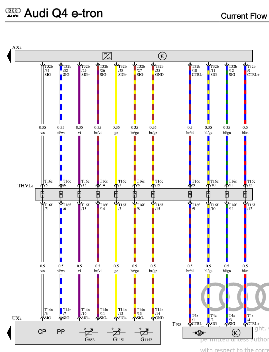

Someone knows the schematic / wiring colours meanings of this part?
Anyone an idea how to obtain the schematic?

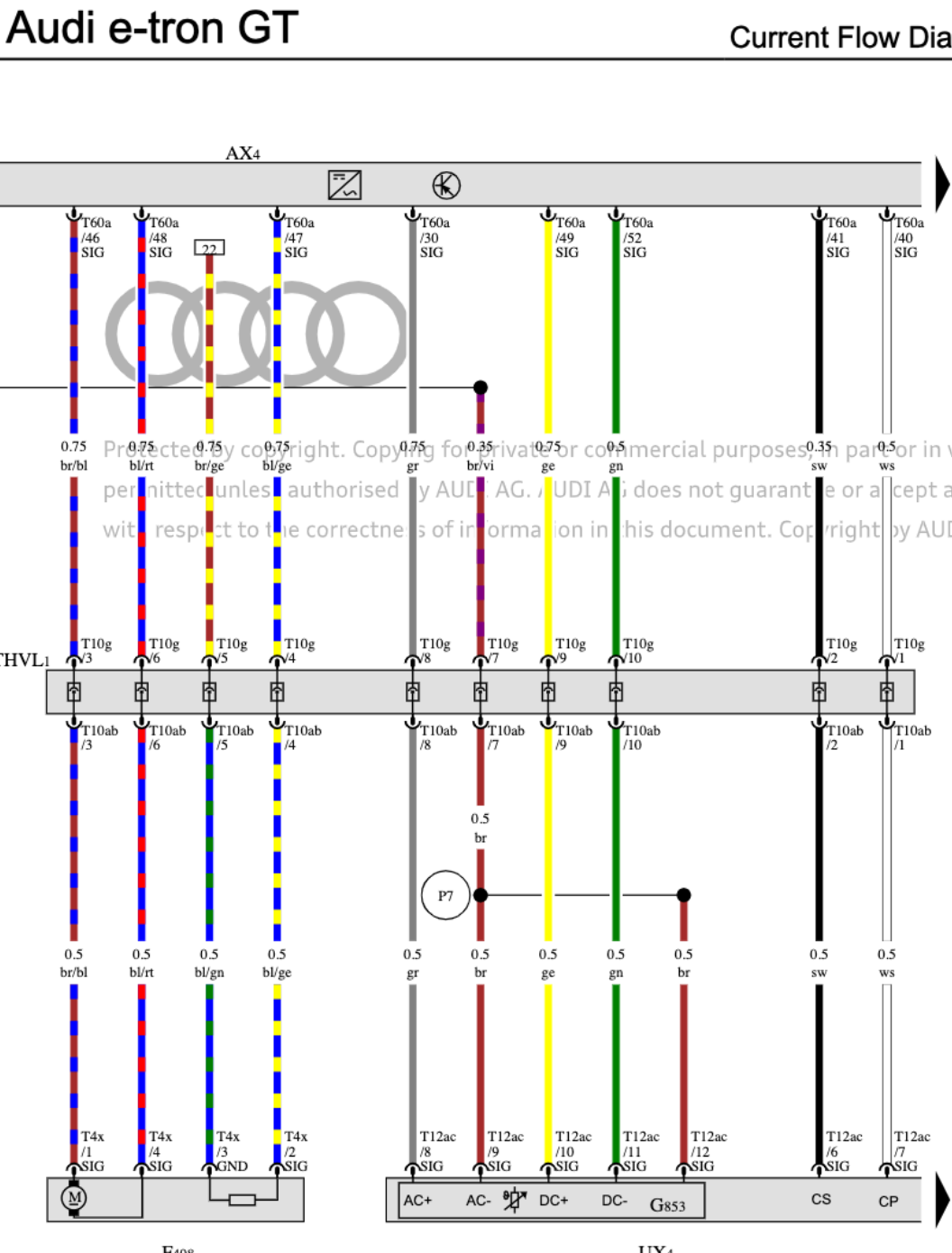

Re: CCS2 Chargeport from ID3/ID4
If it’s like the taycan or etron chargers. The DC line plugs are made by rosenberger
https://products.rosenberger.com/power/ ... ngle-jack#
You can also get the STL file of the port from Phoenix Contact
Phoenix Contact use the same base wire colors out of all their ports
White - CP
Black - CS
Gray - AC plug temp +
Brown - analog ground (two wires, one for the AC temp sensor, the other for the DC temp sensors)
Yellow- DC+ temp
Green - DC- temp
Plug lock:
Brown/Blue - Lock motor -
Blue/Red - Lock motor +
Blue/Yellow - Lock Sense
Blue/Green - Lock Sense (Gnd) If it's like the newer ID4/Q4 E-Tron, the wire colors are slightly different:
White - CP
Black - CS
Yellow- DC+ temp
Green - DC- temp
Plug lock:
