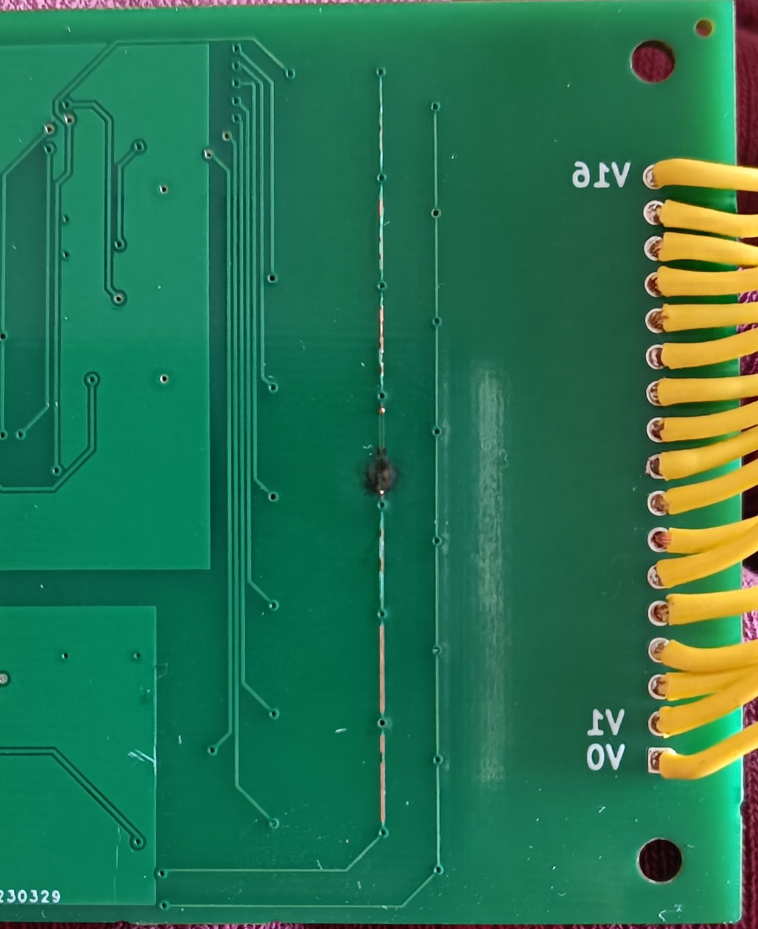

I found it's always the OUTN trace that burns, never UOUTP. Will add a picture later.

UPDATE: picture It's always that trace that burns plus the low side mosfets are often killed but never the trace to them (the horizontal part of the burned track). Could either point to something meaningful or just means the weaker 2N7002 burn before the trace does.

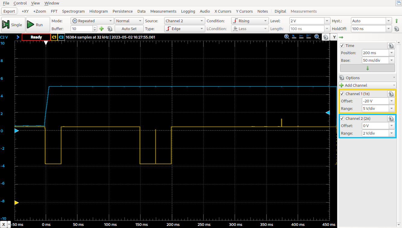

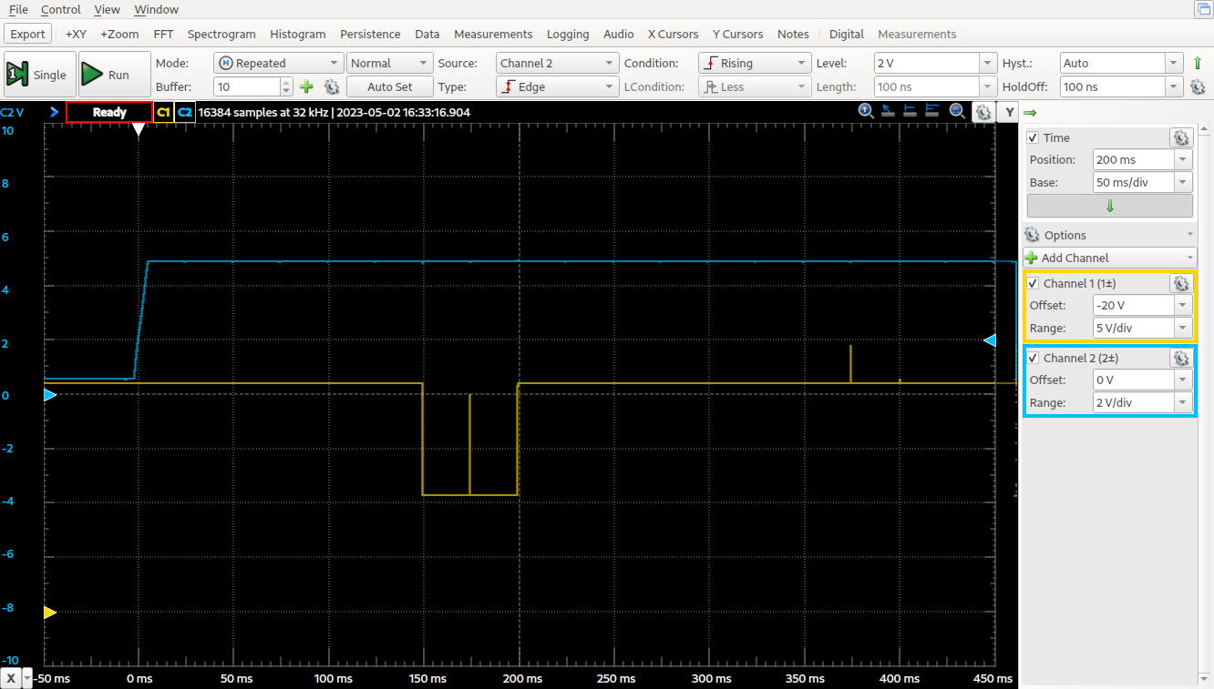

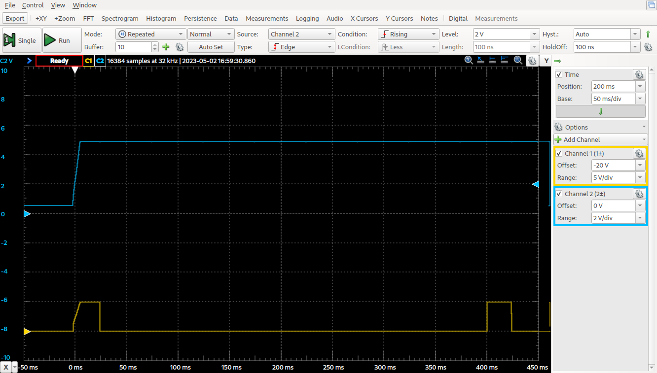

Alright, some new findings
I have scoped the mux 5V supply (blue) which is switched on by the processor about 1s after power up. The other trace is the gate of Q18/Q26 (channel 6). We'd expect first the power-up and 150ms later turn on of channel 7, like so: After doing many power cycles I got a picture like this: I repeated it on channel 8 and found the same glitch at the same time.
I don't see the other channels but somehow I suspect they glitch as well.
And likewise on channel 0 I suspect they all glitch at the same time or at least there is a possibility they will. In any case the early turn-on is not supposed to happen. Will keep digging.

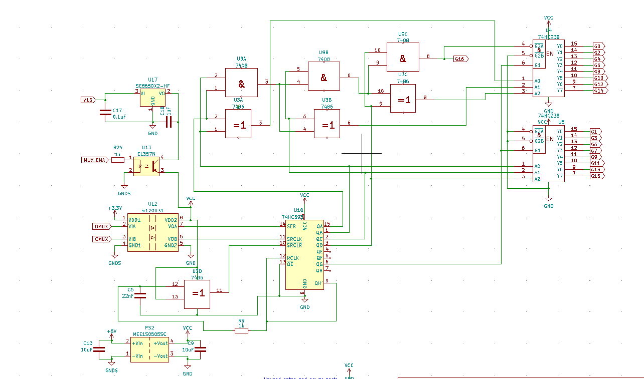

Re: Switched ADC BMS

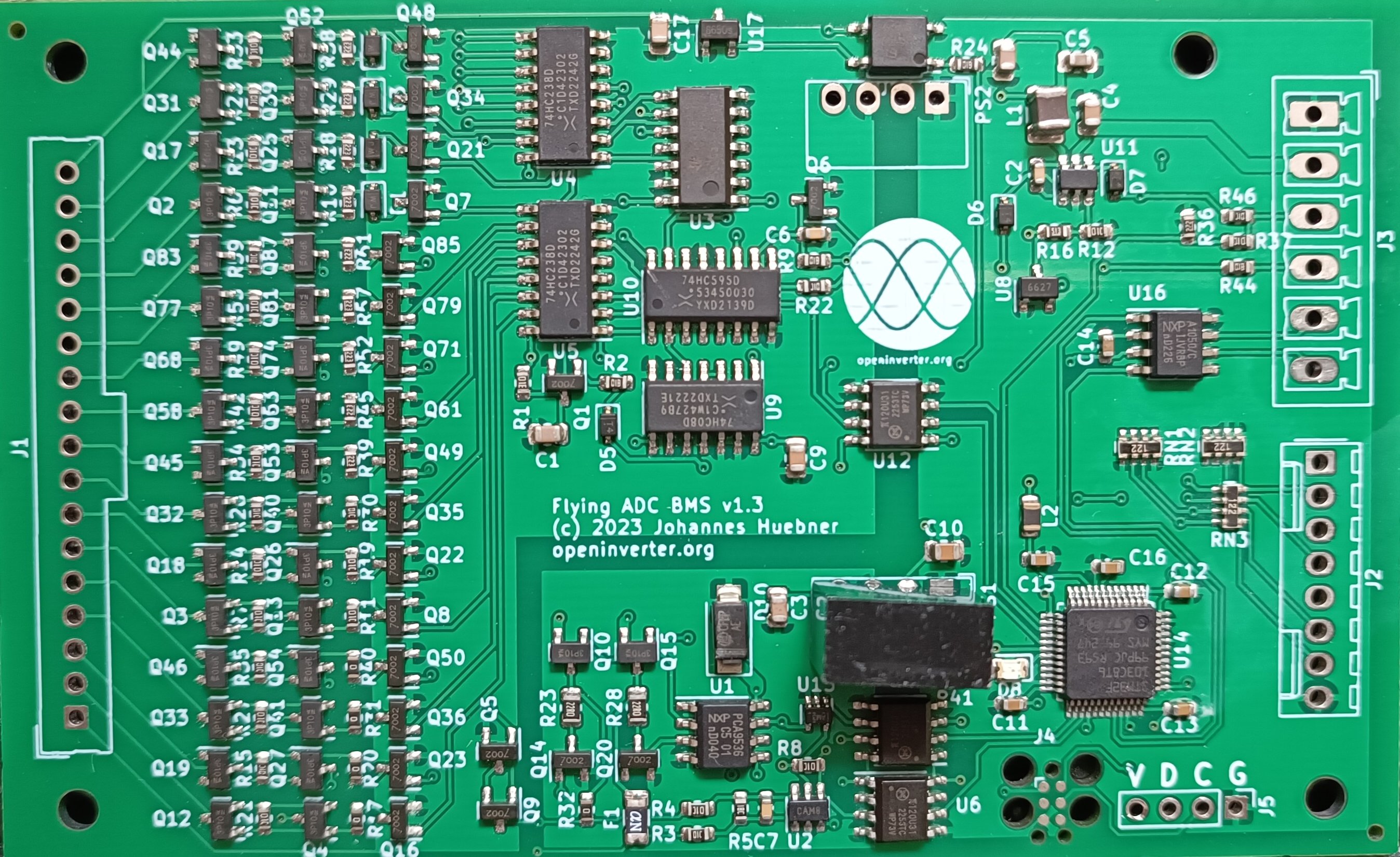

Sorry, here is a more recent version (PS2 is not populated in case you wonder)
Meanwhile I found random output bits of the HC595 start out as one. Unfortunately there is no reset signal for them, only for the internal shift register. Like you say, that in itself doesn't present a problem, as the first control word that is sent after power-up disables all channels.
EDIT: G16 is a special case where the "even" decoder is disabled and the fet is switched by the AND gate instead
Just thinking, our power cycles were always rather short. What if the last control word gets preserved in the shift register and the power up reset (gone in above circuit) fails to clear it because too much charge is left in the cap. Then we would have the glitchy register behaviour once at startup where random bits are shifted through and latched. Still doesn't cause turn-on of two FETs logically but with the slow switching time could cause overlapping.
Maybe the decoder-disable bits should be held high with some circuit that doesn't fail to do so on a short power cycle.
I could also imagine an out-of-sync issue between the 8 bits sent by the software, and the 8 bits in the shift register. E.g. by one extra clock cycle or one missing clock cycle (EMI, whatever) at the beginning, there is the risk that the shift register will not reset, because for resetting we need the Q7' at high for ~50µs. If the intended trigger bit is just shifted through, because there was one clock pulse to much, the next bit (lets assume it is zero) is on the Q7' when the transmission makes a pause, and no reset is done. I guess the single clock cycles are much faster than the reset filter time, so a 1 on the Q7' during the shifting will not reset. When the software sends the next 8 bits, still the same 0 at the same position comes to the Q7'. The 1s which are in the data stream will update the latch outputs, but not with the intended content, but just "random" patterns. This situation does not heal by itself, if we assume that the neighbor of the "trigger bit" is always zero.
In the end this effect would lead to switching between channels without blanking time, and the rest is known. If you still have some working boards, you could make a software which just makes switching between 2 and 16 or so, without blankout, and just make a nice macro video of burning PCB traces
Maybe someone wants to donate a thermal imaging camera, this gives nice pictures, too
- Been thanked: 1913 times
The SPI clock runs at 93 kHz so agreed at that rate a shifted "1" wouldn't cause a reset. On the other hand the traces are short and the isolator has a push/pull output.
A control word looks like this: 0x80Cx (x: channel number) shifted MSB first. I'd think when the 0x80 is shifted through fine, the blanking time is guaranteed.
Already thinking about putting a Padauk uC on there (10 cents) instead of all the logic chips. Would be cheaper, less troublesome, require less space. But is a single-source part and needs programming.

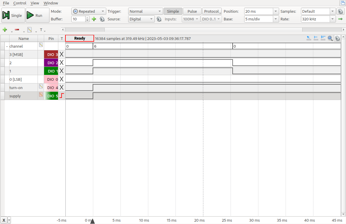

Attached the logic analyzer, here's the issue:
Switching from channel 6 (that happens to be in there) straight to channel 0 without blanking time.
UPDATE:
It seems indeed to be a function of the cycling time. So if you power down and 2s later power up again it seems the output latches of the SR are still in the state where they were turned off. If you wait like 10s the start up is normal. One solution would be to delay mux power-up by 10s in software. Bit of a workaround, a hardware delay might be nicer
UPDATE:
Alright, this might fix it:
When booting up the mux supply is off. Next the mux supply is turned on with the possibility of random data being in there. 25ms later (the power supply is stable by then) we shift 0x0080 through the register. The first 8 zeros clear whatever is in there, the 0x80 latches 0 to all output. 25ms later we actually start sampling.

Right, the F030 is even a basic part.
Will, see, if the latest finding isn't the root cause I might as well do that.
I do assume it will consume more than 1 mA though.
Yes, the F0-series isn't the greatest in terms of energy consumption, the L0-series would be a better choice. Some parts only use "88µA/MHz", which is obviously not a value to go by directly, but certainly a good ballpark value. Unfortunately all STM32L0 are extended parts at JLC, the cheapest one with enough GPIOs would be this: https://jlcpcb.com/partdetail/Stmicroel ... T6/C110878
I think the ones I linked before don't have enough GPIOs to replace the shift registers.
Maybe some less consumption can be achieved with sleep modes. It's woken up by SPI clock (if possible), receives the data, sets pins and back to sleep.
I thought about above glitching a bit more. It is just an issue if after power-up a channel is selected without inserting a turn-off command.
But then we also tested with modules that have permanent 5V supply via DC/DC converter. They receive many mux-off commands during bootup. These blew up just as well. So I'm afraid the above isn't the solution either. Even more so as it wouldn't explain why one module works but stacking 2+ modules clearly triggers the blowup.
Could it be some capacitive current over the isolator or DC/DC converter?
