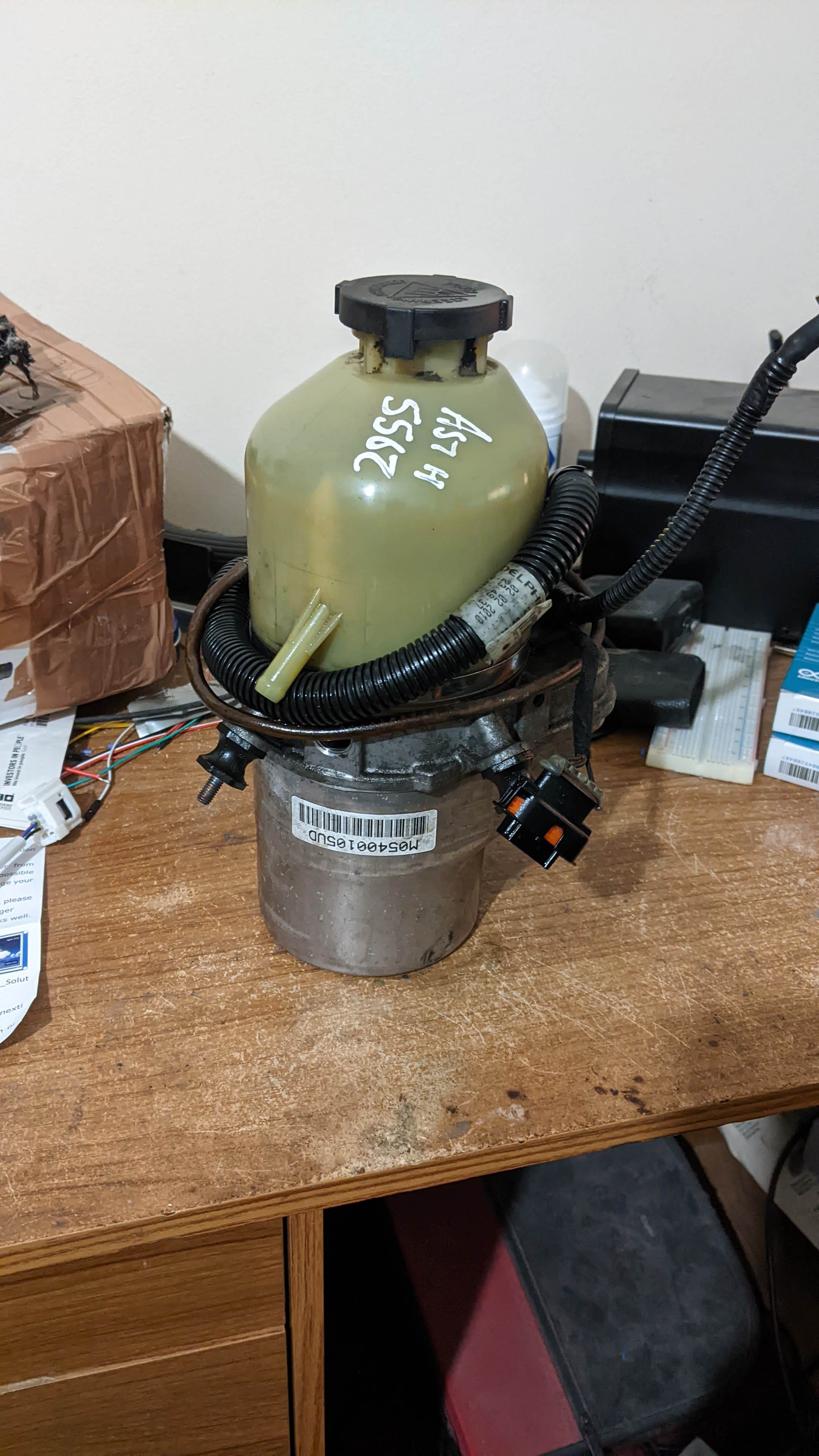

Well the MG is off the farm now so that's officially a home project now. Which frees up a slot for the next farm project, a real farm project this time.
Made a small start on stripping down the Leyland over the weekend. I'm also planning to move my main workshop into this shed eventually so have started to paint up the walls and clean out the clutter. I also need to wire in some lights and sockets.
I have been researching the drive train and hydraulics a little more over summer and come to the conclusion that I will most probably keep the flywheel and dual clutch. The main reason for this is to keep the independent PTO, it also makes hydraulics simpler and the user interface of the tractor very similar to how it was originally.
I have also been looking into replacement power steering, which is definitely needed for this thing. Ordered one of these, a Corsa power steering pump the model after what is documented on the wiki here. Looks similar in appearance and I hope operation, will update the wiki with findings.
I don't know if it will be powerful enough for the tractor power steering, but there is only one way to find out.

Steady progress on this. Mostly wire brushing and painting, with a good bit of welding recently.
Hydrostatic steering upgrade is in on the steering wheel side now,
On the electric side I have mounted the inverter and Leaf DC-DC box, which I chopped in half away from the rest of the junction box.
Next big task is mounting up the steering ram and sorting that out. Apart from that I'll keep putting parts back on while I keep my eyes open for a battery. At the moment the lack of a battery isn't holding me up since there is still a bit to do in terms of restoration.
I did get the motor spinning for a good few minutes with an Ebike controller and my Quad bike battery. Until the Ebike controller self combusted. With that I know that 1) My hydraulic pump works, 2) I didn't put all the pipes back on my hydraulic system and 3) the flywheel doesn't vibrate all that bad for now, which was my main concern.

LRBen wrote: Tue Jun 06, 2023 6:24 pm Steady progress on this. Mostly wire brushing and painting, with a good bit of welding recently.
Using an ebike controller to drive a Leaf motor is really stupid, whoever told you it was a good idea? :lol:
