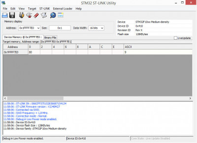

Had another thought related to the missing flash size in the programming software. It's possible that this is an issue with the st-link dongle (but seems a little unlikely as it gets the rest right) or it could be that the chip is returning an invalid chip size when asked. In the later case this could cause the firmware, and possibly the bootloader, a problem as it also reads this size from the chip to figure out where to load/save parameter/pin data. If the value returned is wrong it could cause the firmware to try and access a non-valid memory region when trying to read parameters from flash which would then cause a hard fault and program crash.

When I read the flash size register for both chips with your instructions, it did come back as 0xFF!
Considering this evidence, do you know of any ways forward to get functional programing on these chips? At least MG1's LED was flashing when I got the board, but I never used it to spin a motor so I can't say for sure of it worked.

Edit - just googled this and it seems that some early ST silicon did return an erroneous ff value in the flash size. If this is one of those chips then a firmware mod might be needed to both the bootloader and main code to fix.

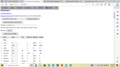

I tried accessing the web interface again with he the fixed flash size code on the board, and I must have made a mistake last time because now it is working! There are bunch of (I believe default) parameters, and the spot values, showing version "5.24.R-foc"

Sorry, forgot to check, did it return 0xff or 0xffff (when reading in 16-bit mode)?

Now you have the web page working it would also be worth checking that the parameters are correctly being saved to flash. Just change one, save parameters to flash, power cycle everything and then check when you power it back up the new value is still there.

Now both LEDs are blinking, and in the wed interface for each chip I can see all of the default parameters and available spot values, along with the version 5.24 firmware. I plan on test spinning the motos in a Toyota Prius transaxle soon, and I will update here with results.
