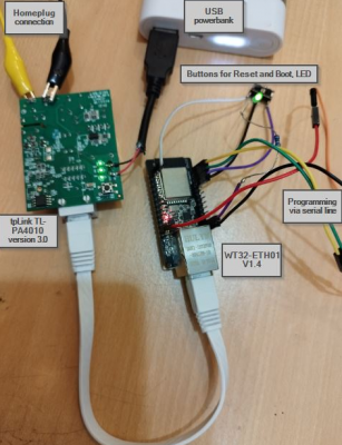

Open source CCS using AR7420
- uhi22
- Posts: 654
- Has thanked: 94 times
- Been thanked: 431 times
Besides the Python variant for Raspberry and Notebook, I was searching for a more compact variant. I found the ESP32-based WT32-ETH01, which is perfectly supported by Arduino IDE, starts up very fast and draws much less current than a Raspberry. I gave a try and was able to do some basic HomePlug communication, reading out the software versions of the connected tpLink modems. This looks quite promising. Of course, the porting of the existing python solution to C is some effort, but I think it's well invested time if we think into the direction that finally it may run on any controller which has a C compiler...
https://github.com/uhi22/ccs32
Stored the first experimental sources here: Github: http://github.com/uhi22 --- Patreon: https://www.patreon.com/uhi22

Well, the preconditions for this activity are quite good:
- For the homeplug ethernet stuff and the SLAC state machine, the python code was written in a way that it was easy portable from python to C. This is finished, SLAC is working (at least with simulated EVSE on the other end).
- For the SDP.UDP.IPv6: also here the python is a good basis. Porting is nearly finished.
- For the TCP.IPv6: That's the harder part, need to find either an existing TCP or, as an exercise, re-invent the wheel and create a (minimal) TCP. Does not look too complicated.
- For the EXI decoder/encoder: The code from https://github.com/Martin-P/OpenV2G is normal C code, it compiles in the Arduino IDE. No need anymore for the complicated command line interface which I created in https://github.com/uhi22/OpenV2Gx to make it usable from Python.
- The PEV charging state machine can be easyly ported from python to C.
- The hardware-interface does not need to use serial communication and a second controller to switch the StateC and the relay, it can just use two digital output pins of the WT32-ETH01. Easy doing.
Summarized: Yes, some effort, but no real hurdles.

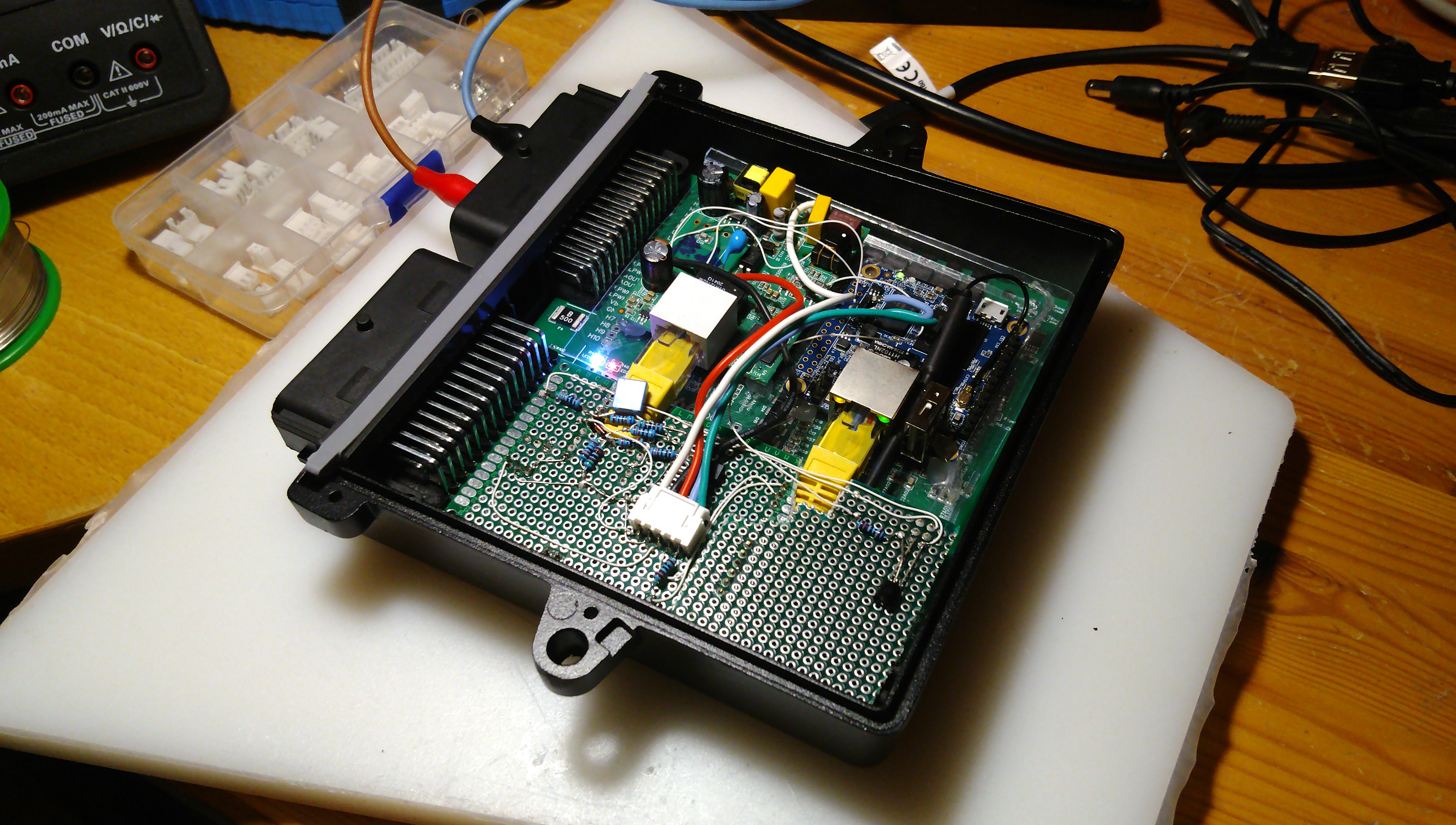

I'm going to attempt installing a version of the Python implementation on my car. Wish me luck. I've so far crammed all the logic boards I need inside this enclosure.
I still need to port all the stuff onto this. The Python code and OpenV2Gx should run easily, but I'll have to redo the hardware integration. Then I'll have to somehow cram the CCS connector, CCS contactors and high voltage connections into the car which doesn't really have room for them.

Really great What controller board is this? And where did you find this housing/connector/PCB assembly?
- celeron55
- Posts: 776
- Has thanked: 29 times
- Been thanked: 110 times
The base board is my https://github.com/celeron55/ipdm56 (I do have a pile of them for sale if someone wants one, but haven't had time to post about that yet)
This is a helpful but not a plug and play board for this purpose. I have done quite some customization by hand for this, mainly removing resistors to reroute the PP and CP lines onto the breadboard and to get the UART to connect to the Orange Pi instead of external USB. Also added a more powerful 5V regulator. With these customizations, the AVR is acting as a host processor for the Linux board, being able to power it up and down based on PP/CP/CAN status, but the Linux board can still flash the AVR on the fly.
It uses the same chinese enclosure as Damien's ZombieVerter.
The Linux board is Orange Pi Zero

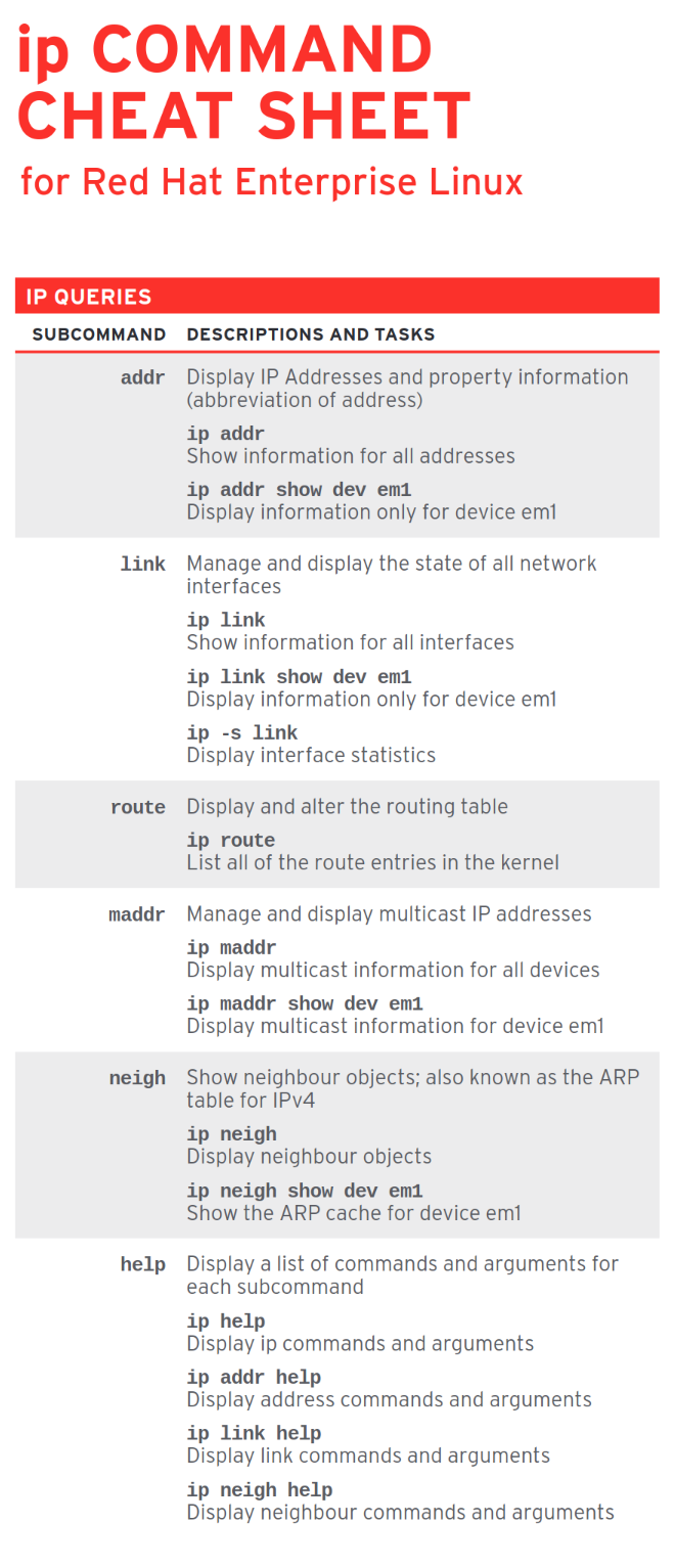

ifconfig is very deprecated and often fails to show IPs. If at all possible, use the "ip addr" command from iproute2.

This is very much not my wheelhouse, but from the light reading I did, prompted by Charlie's post above, I think I learned that one of the reasons that ipconfig (circa 1999) is out of favour is specifically because it does not deal reliably with IPv6. iproute2's 'ip' command replaces ifconfig. Handy cheat sheet (one of many available) is at https://access.redhat.com/sites/default/files/attachments/rh_ip_command_cheatsheet_1214_jcs_print.pdf
This is linux-specific (ie Windoze, Unix, etc. still largely seem to prefer ipconfig). I'm sure someone more knowledgeable will come by and correct my misapprehension any minute. Cunninham's Law and all . . .
