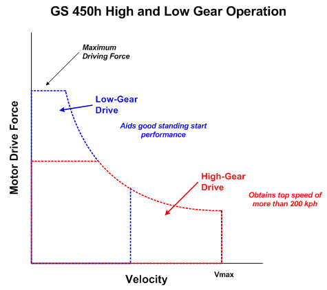

This is an interesting graph of the GS450h gearbox of how the gear ratios relate to torque and speed.

yeah
So my numbers suggested 12.9:1 reduction on the ID4, with the 310nm figure and a max speed of 99. Those came from a VW technical PDF.
Giving a bit over 4000nm from standstill to about 30mph or so, at which point you'd hit the 200hp power limit and transition into power limited mode with declining torque. I dont know if it can maintain 200hp all the way to the maximum speed, but one imagines it manages to maintain most of that 200hp in the main accelleration zone from 30-70ish.
The Dyno plot can be converted to wheel torque easily enough if we have a tyre size and speed. Using the standard E39 tyre size of 235/45r17 and the speed from the dyno run, we get circa 1800nm wheel torque in the torque limited section from the start of the run at ~60kph to peak power at 120ish. So one can surmise it was making 1800nm from 0 all the way to 120kph. Which is why i felt it was somewhat lacking.
A shorter diff ratio would help no end to get that up to a nicer figure, and get the motor moved more into its "ideal" window. Currently its geared for extremely high speeds and its losing usable performance as a result.
Low gear would ofcourse be the alternative, however from what i understand, managing shifting for that doesnt yet exist? The gearing in Damiens car is tall enough that he could almost run it in low all the time!

My immediate thought looking at the plot, was that it spends too long in the torque limited zone (the result of which being far less "area under the curve"). So i wanted to explore why that was, and after a bit of discussion its become evident that its geared extremely tall.
If damiens happy with the car then thats great. My take away from the dyno and subsequent discussion is that gearing is important, and that someone building with this trans should be trying to get their gearing into a nice area. Ideally hitting maximum gearbox RPM at say 100mph. My proposed project has ~4.2:1 reduction and slightly taller tires, so actually quite close to the ideal zone.

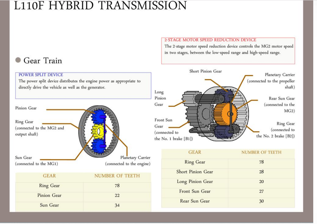

Posts: 2392
Location: Bristol
Has thanked: 206 times
Been thanked: 563 times
Re: Damien takes Zombie GS450h on dyno
all the info you guys could wish for is just a google away...
https://slideplayer.com/slide/14432904/
So the MG1 Planetary set Output rotational speed before being fed into the output shaft is 1:-0.436 (note reversing)
MG2 can do 1.9:1 or 3.90:1 ratio to the output shaft.
This means the following:
Gear selected has no impact on MG1 speed, MG1 is fixed ratio to the output shaft. This will limit the max vehicle speed.
Relative to output shaft
MG1 speed is -2.29:1
MG2 speed can be 1.9:1 or 3.9:1
A very good doc with info
https://www.osti.gov/servlets/purl/947393
MG2 is rated at 300Nm and max 10,230 rpm
MG1 info is sparse as it is not meant to drive the vehicle and only used to do E-CVT things and start the vehicle. Thus it would be smart to use the same speed limit as MG2.
this means that Mg1 should be viewed as the motor limiting top speed, with a max allowed output rotation of the gearbox being 4460rpm

Posts: 2392
Location: Bristol
Aragorn wrote: Thu Mar 09, 2023 12:32 pm we just dont know exactly where that limit lies.
Correct.
In the end all you can do is make estimations based on information gathered. My "suggestion" is from gearbox information derived out of a presentation not a suggestion. If there are no clear published facts you can deduce things from various sources, so information might vary.
No body here will warrant what you decide to do with your setup so it is up to you to decide on safety margins and the reliability of the data.
Yes your math checks out. Then this does not really matter as it is MG2 which has a speed ratio of 0.83 to MG1.
This does mean that MG1 will limit top speed and even if you assume 12.5K or 14K rpm working the maths backs it yields 5458 or 6113 rpm on gearbox output.
