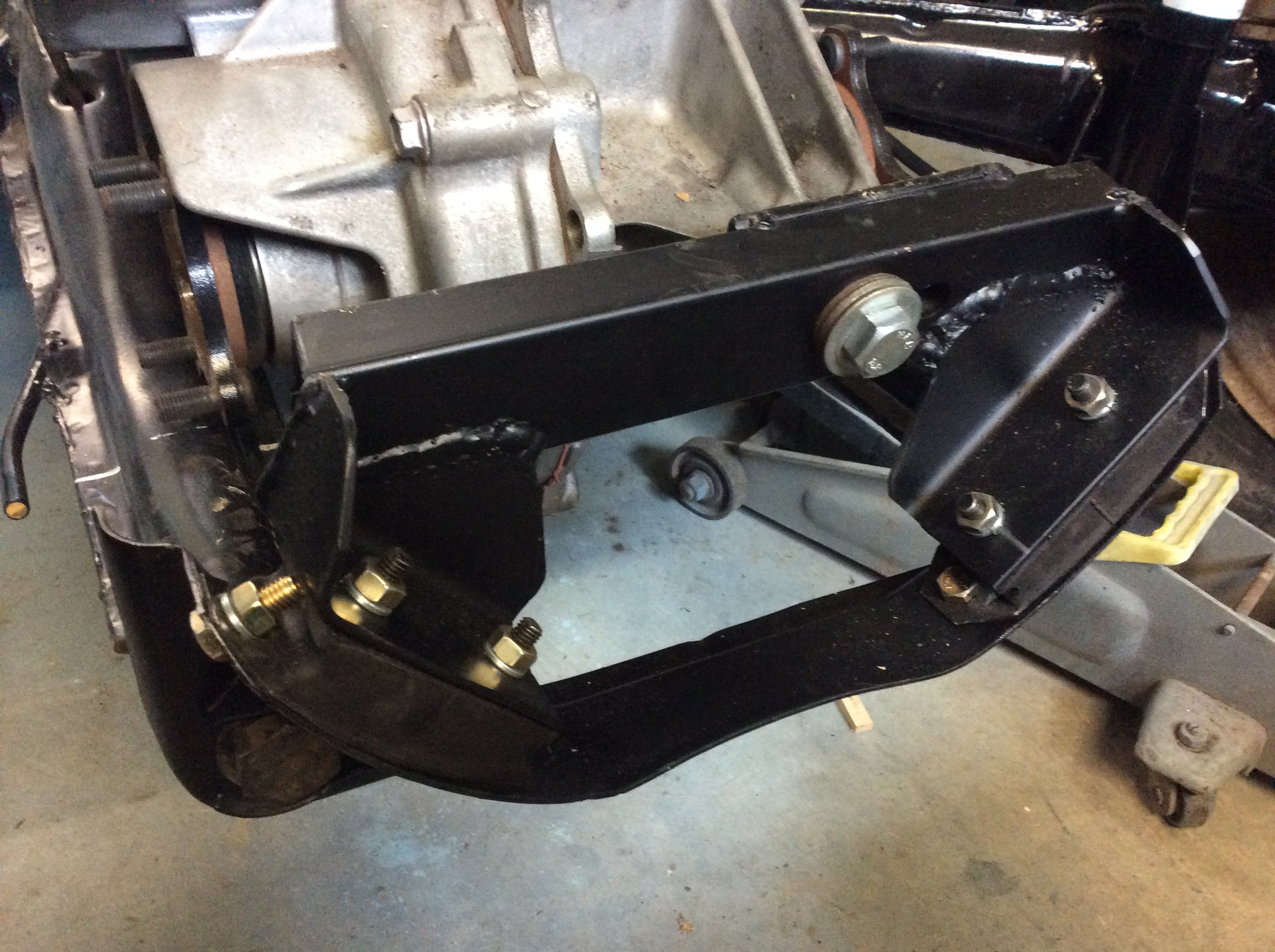

Where do the weeks go? As this is also a complete bare metal, nut and bolt restoration it was never going to be quick. The advantage being that I have more time research the EV side of the project.
MECHANICALS
The floor pan is now sitting on its own wheels again with the MGR installed on its new mounts. There were no structural modifications to the Beetle ‘horns’ and the motor has just a slightly raised front and about a 10mm offset to the left. I was expecting to have to source some shorter ‘racing’ half shafts but with the rear suspension now rebuilt it has been possible to do some accurate measurements and the current plan is to shorten the right hand MGR stub axle by some 10mm (they can be prised out with little effort) weld on a 10mm plate which will then have a recess machined into it and 6 @ M6 holes tapped to match the original VW CV joints. The left hand will need to lose 20mm with a similar 10mm plate. i Original engine mounts have been used so, as with the original Beetle motor, replacement couldn’t be simpler. Remove the electrical connections, disconnect the CV joints and there are just 4 bolts securing the motor to the body!

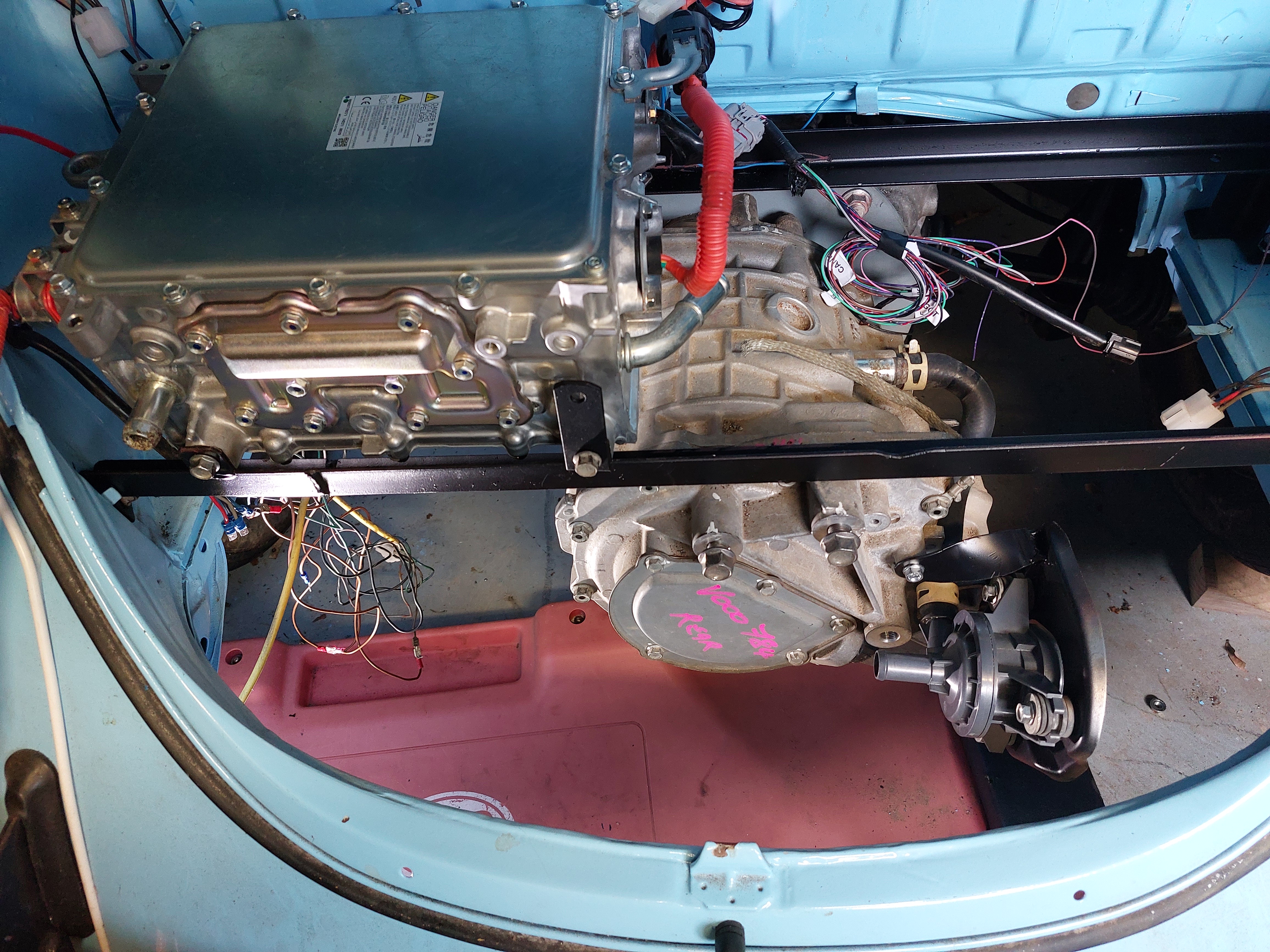

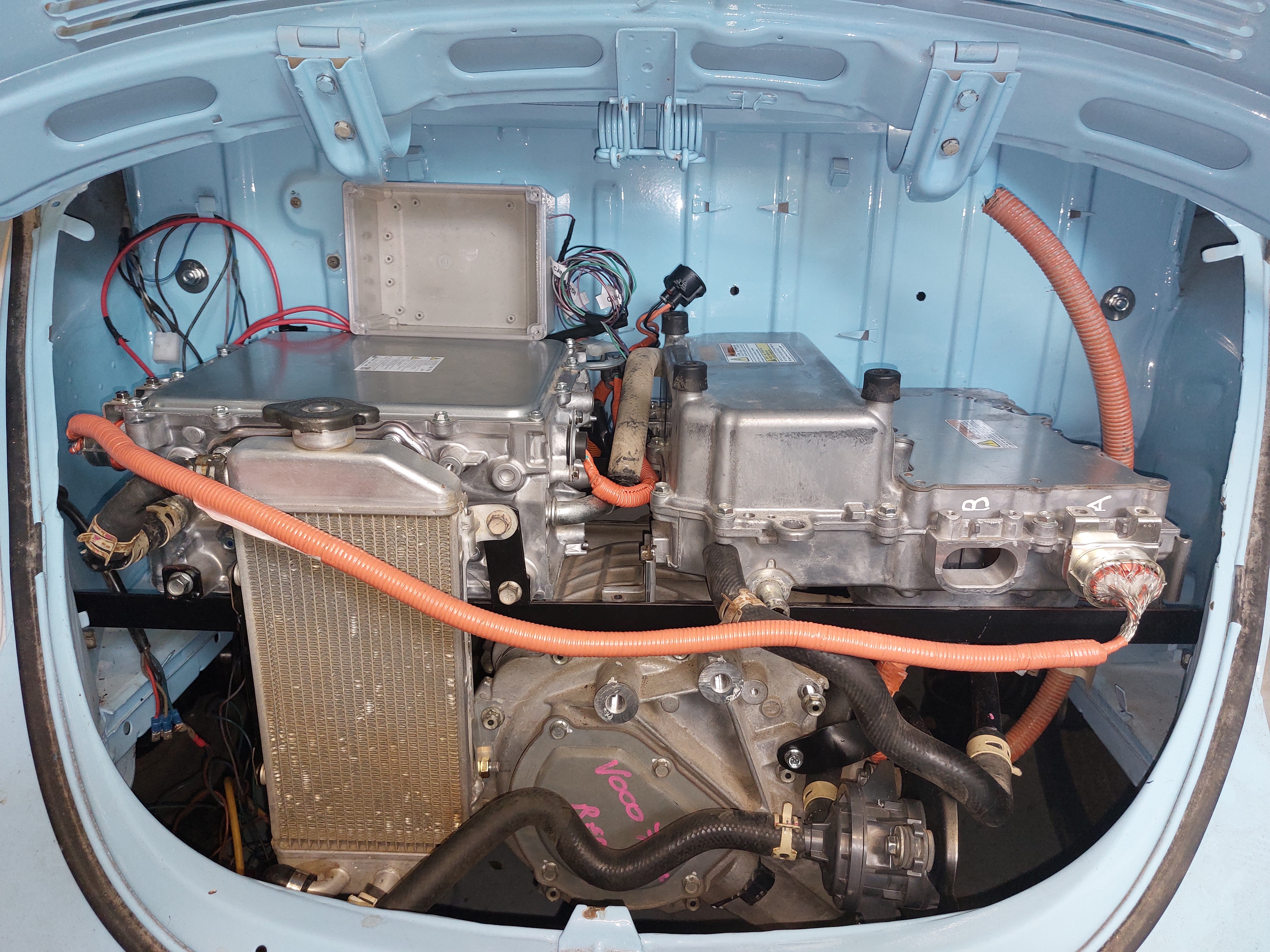

Progress has been made! I have ‘harvested’ quite a list of bits from the written off Outlander. If you have the space it seems like a great way to go so here is a list of goodies in no specific order: Battery pack inc CMU’s, contactors, main fuse and service disconnect and lots of bus bar copper. Rear motor, inverter and DC/DC with connectors. Charge port and interior cable (I’ve had to extend this to reach the Beetle’s fuel filler). A/C compressor (don’t know if I can fit this in the Beetle). I was about to order an OBD socket when I realised there would be one somewhere in the carcase. I might still harvest the front motor and inverter but I have no particular use for it. There is even a good chance that I will be able to recoup a few $ on the wheels, headlights, seats etc before the rest goes to the wreckers.
Motor attached to home made adaptor plate with support frame DC/DC on frame By putting DC/DC and inverter in same orientation as in donor I can reuse most connectors. Small plastic box will hold main fuse and service disconnect. I’m not expecting a lot from an 8 year old battery pack but it is fitting quite neatly behind the back seat. Preview is scrambled so I hope this looks OK.
