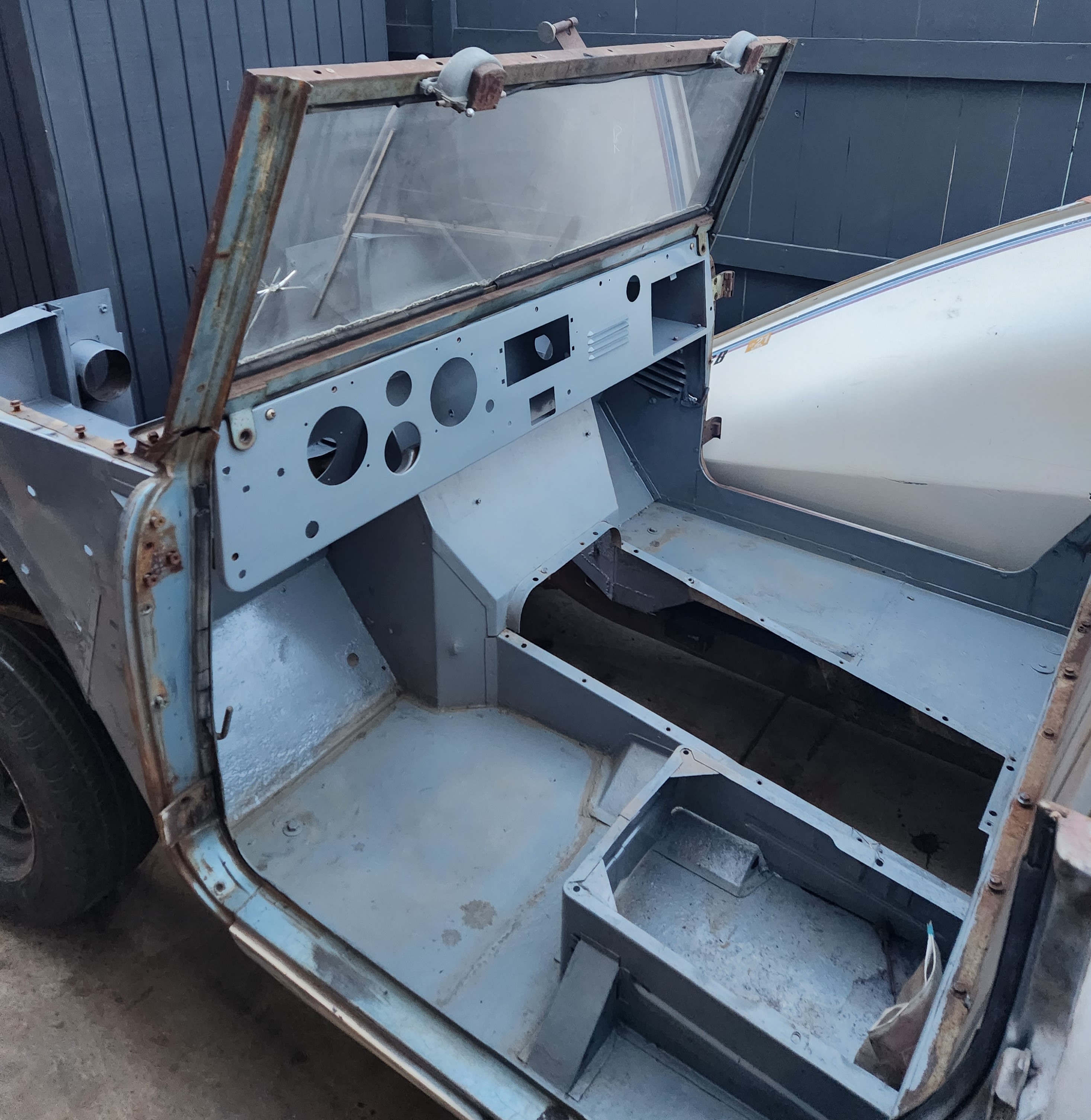

Re: 1964 Scout LS600H conversion
Here it is in her initial sorry state:
Now with new floor pans and rocker panel repairs. Half cab is removeable and windshield folds down. Large transmission tunnel with plenty of access from up top.
Cleaned up engine bay:
