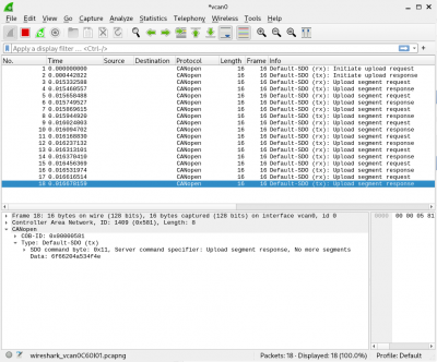

Great. Looks prettier in Wireshark :)
johu wrote: Wed Feb 08, 2023 1:46 pm By that you mean SDO upload or including the output of genparamdb with every build?
Automatically uploading from the running firmware to oic as needed and not cached on disk.

debian@beaglebone:~$ python3 candownload.py
   "canspeed": {"unit":"0=125k, 1=250k, 2=500k, 3=800k, 4=1M","value":2.00,"isparam":true,"minimum":0.00,"maximum":4.00,"default":2.00,"category":"Communication","i":0},
   "canperiod": {"unit":"0=100ms, 1=10ms","value":0.00,"isparam":true,"minimum":0.00,"maximum":1.00,"default":0.00,"category":"Communication","i":1},
   "testparam": {"unit":"Hz","value":0.00,"isparam":true,"minimum":-100.00,"maximum":1000.00,"default":0.00,"category":"Testing","i":2},
   "opmode": {"unit":"0=Off, 1=Run","value":0.00,"isparam":false},
   "version": {"unit":"4=1.00.R-name","value":4.00,"isparam":false},
   "lasterr": {"unit":"0=NONE, 1=TESTERROR,","value":0.00,"isparam":false},
   "testain": {"unit":"dig","value":121.00,"isparam":false},
   "cpuload": {"unit":"%","value":0.00,"isparam":false},
   "serial": {"unit":"","value":"87215032","isparam":false}
On the first reply I always specify a size of 64k as I don't know in advance how long the JSON string will be. Seems to work anyway.

Cool. It looks like it's entirely allowed to not specify the data size if you don't know it. Looking at the code, the python canopen libraryseems to be happy with that response.
Are you sticking with the official CANopen dictionary Index of 0x1021? Spec says that should be in EDS format (a fancy INI file). Probably best to give it a custom Index number.

Mapped it to 0x5001, 0.
Timed the JSON download, it takes about 10s on the sine firmware
Checkout the port here: https://github.com/jsphuebner/stm32-sin ... can_module
