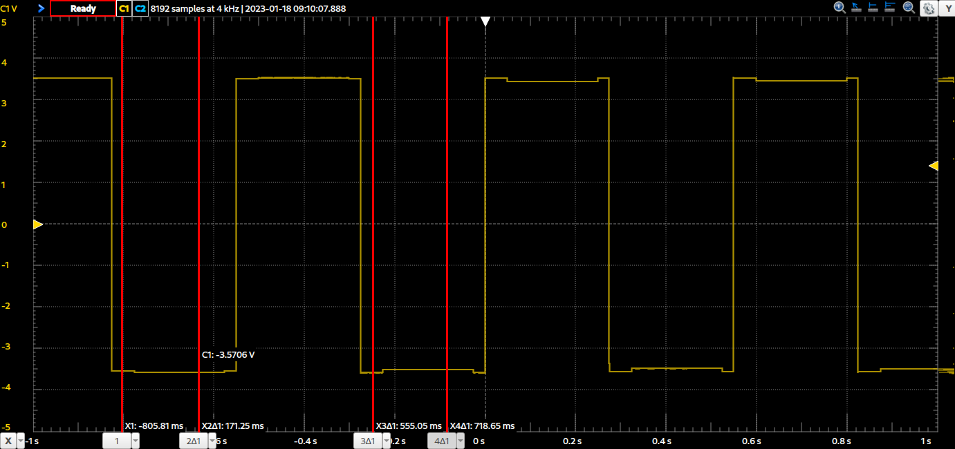

Starting tests with real cells now, courtesy of pm_dawn in Östersund. He borrowed a scooter battery to me which, conveniently is unbalanced and one module is even below 2V. So now I can do some testing of the balancing :)
Accuracy looks very good. Calibrated one channel to the multimeter reading and all others match that as well. You can see a small 0.5mV jitter when voltage is between two digits. Otherwise it is rock stable.
The sinusoidal form comes from the power supply during charging.

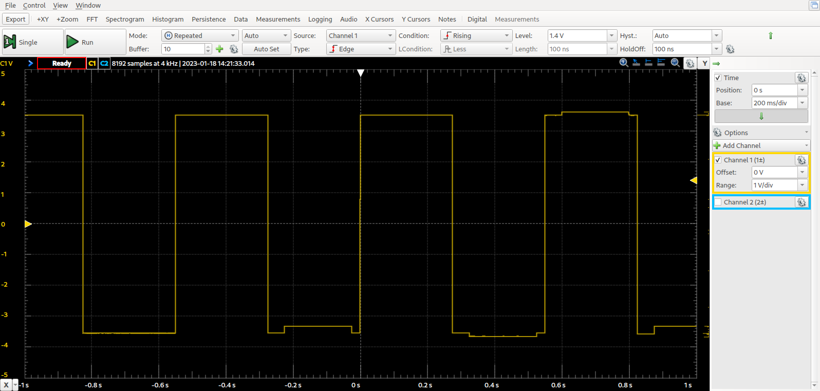

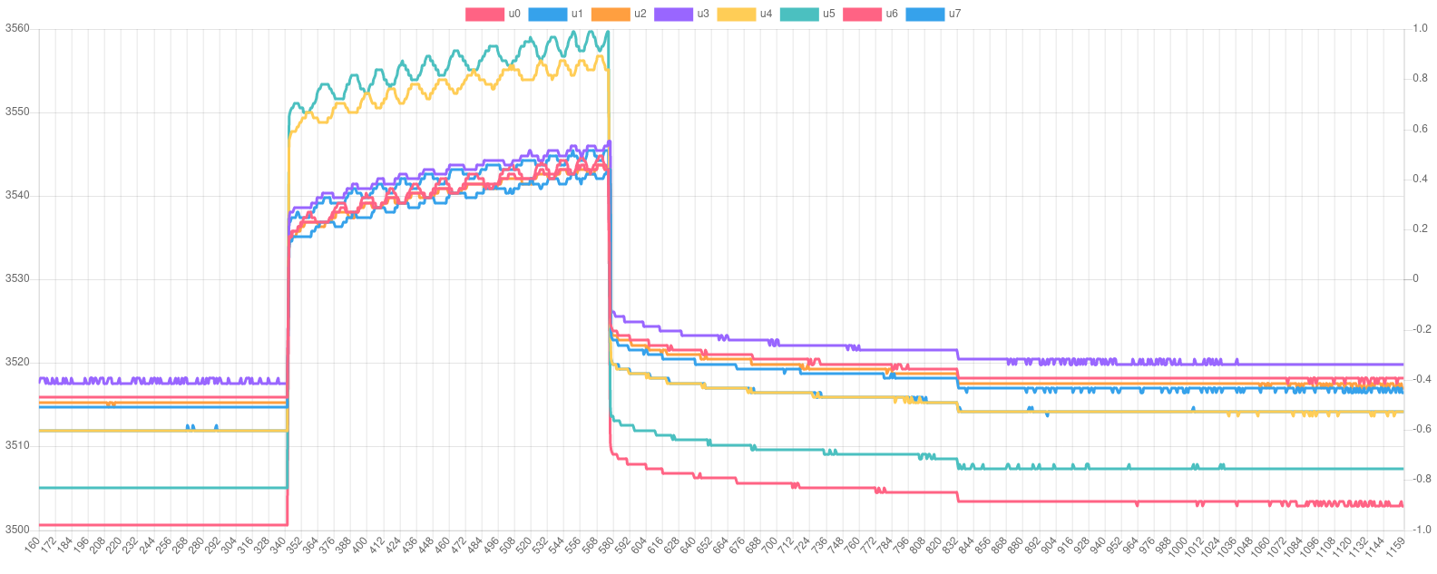

Re: Switched ADC BMS
Left it running all night in balancing mode. So it measures cell voltage in one cycle, then if it's below average it diverts current from the DC/DC converter otherwise it bleeds current.
As you can see it has brought down the delta from 16.5 mV to 13 mV but bumping up low cells didn't really happen.
It does make the effort as you can see on cursor 1 and 2 where it brings the voltage up from 3548 to 3570 mV (22 mV delta). In contrast dissipative balancing bring the voltage down from 3585 to 3.515 mV (70 mV delta). Keep in mind this is behind the multiplexer so a lot of that will be mosfet turn on resistance.
Right now balancing resistors are 2x47R, I will bring them down to 2x22 on the next rev for bleeding and 1x22 for bumping up. I could also try shorting one or both, what could possibly go wrong ;)

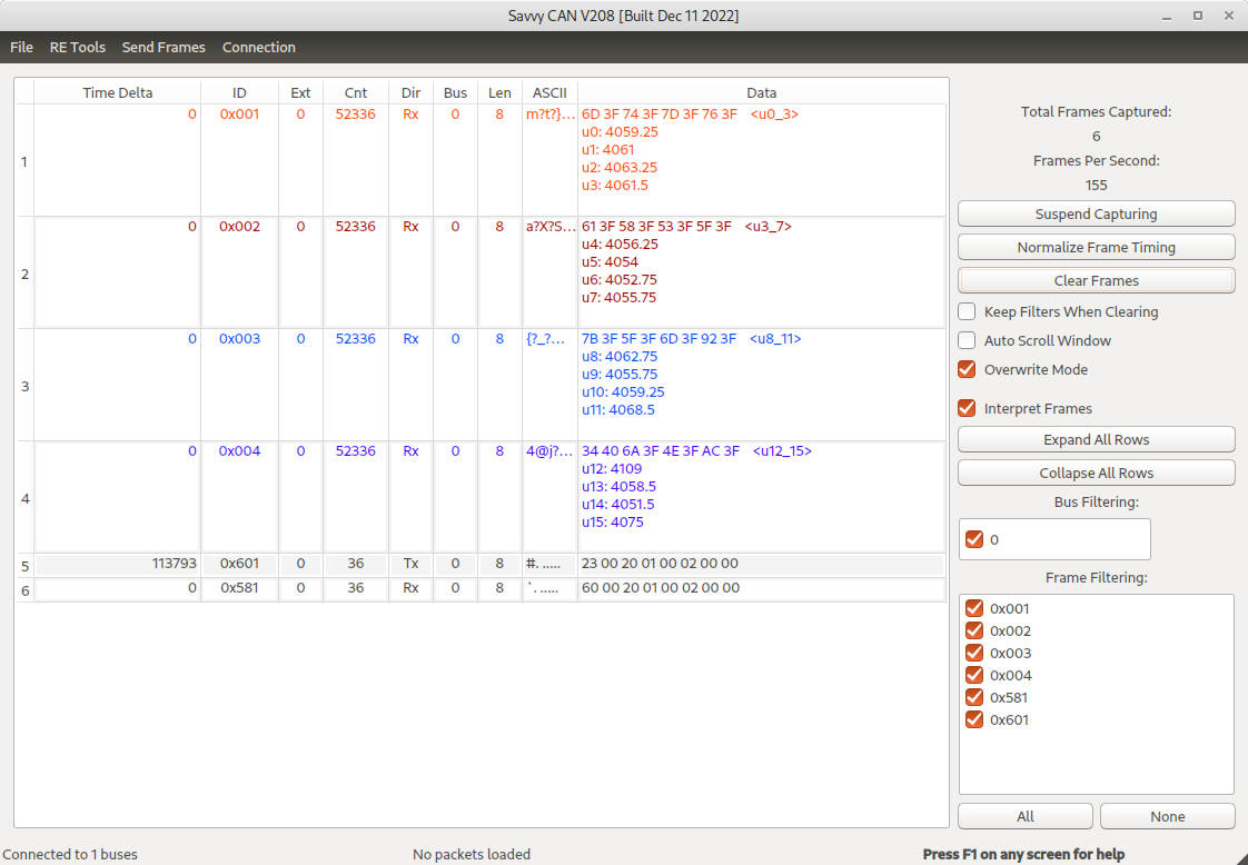

Hooked up Dave tool:
uavg                :       4052 [mV]
umin                :    4041.16 [mV]
umax                :    4097.31 [mV]

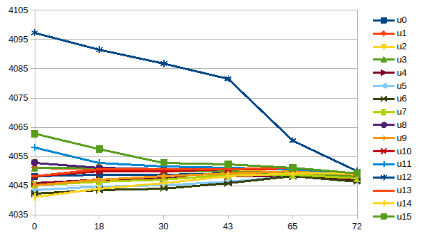

Result after about 18 hours of balancing:
uavg                :    4051.69 [mV]
umin                :     4043.5 [mV]
umax                :    4091.47 [mV]
udelta              :    47.9688 [mV]
utotal              :    64827.3 [mV]
u0                  :    4048.78 [mV]
u1                  :    4050.53 [mV]
u2                  :    4051.09 [mV]
u3                  :    4051.09 [mV]
u4                  :       4047 [mV]
u5                  :    4044.69 [mV]
u6                  :     4043.5 [mV]
u7                  :    4046.44 [mV]
u8                  :    4051.09 [mV]
u9                  :       4047 [mV]
u10                 :    4049.94 [mV]
u11                 :    4052.88 [mV]
u12                 :    4091.47 [mV]
u13                 :    4050.53 [mV]
u14                 :    4044.09 [mV]
u15                 :    4057.53 [mV]
Delta dropped from 56 to 48 mV, lowest cell taken from 4041 to 4043 mV and highest cell taken from 4097 to 4091 mV
Been thanked: 1913 times
And after 30 hours
uavg                :    4051.19 [mV]
umin                :    4044.69 [mV]
umax                :    4086.78 [mV]
udelta              :    42.0938 [mV]
utotal              :    64819.2 [mV]
u0                  :    4048.78 [mV]
u1                  :    4049.94 [mV]
u2                  :    4049.94 [mV]
u3                  :    4049.94 [mV]
u4                  :    4047.59 [mV]
u5                  :    4045.25 [mV]
u6                  :    4044.09 [mV]
u7                  :       4047 [mV]
u8                  :    4050.53 [mV]
u9                  :    4048.19 [mV]
u10                 :    4049.94 [mV]
u11                 :    4051.69 [mV]
u12                 :    4086.78 [mV]
u13                 :    4050.53 [mV]
u14                 :    4045.84 [mV]
u15                 :    4052.88 [mV]
Down to 42 mV delta from 56. So 24 mV 14 mV in 30 h makes it 0.5 mV/h on my test battery of 26 Ah. My clamp meter isn't quite the best equipment for this kind of current, it measures 30 mA of charging and 50 mA of discharging. My bench supply shows a power delta of 300 mW during charging which would point to 75 mA, maybe 50 mA counting 30% losses.
So yes that's slow and would be even slower on a larger pack. But it is facing a quite unbalanced pack and I think the balancing capability should be sufficient for a pack under continuous treatment.
43 hours into the experiment:
uavg                :    4051.47 [mV]
umin                :    4045.84 [mV]
umax                :    4081.53 [mV]
udelta              :    35.6562 [mV]
utotal              :    64823.8 [mV]
u0                  :    4049.34 [mV]
u1                  :    4049.94 [mV]
u2                  :    4050.53 [mV]
u3                  :    4049.94 [mV]
u4                  :    4048.19 [mV]
u5                  :    4046.44 [mV]
u6                  :    4045.84 [mV]
u7                  :    4048.78 [mV]
u8                  :    4050.53 [mV]
u9                  :    4049.34 [mV]
u10                 :    4050.53 [mV]
u11                 :    4051.09 [mV]
u12                 :    4081.53 [mV]
u13                 :    4050.53 [mV]
u14                 :    4048.19 [mV]
u15                 :    4052.28 [mV]
Down to about 35 mV, still 0.5 mV/h (corrected in post above)

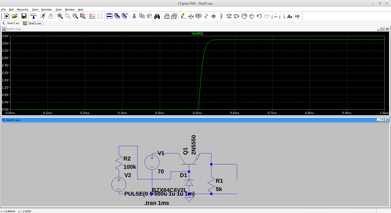

johu wrote: Mon Feb 13, 2023 12:51 pm Also thinking about supplying the mux control with a high voltage linear reg, would result in a continuous draw of about 1 mA from the cells. Maybe not the greatest idea but deploying a 200 mA DC/DC converter for delivering 1 mA seems wasteful as well.
What are you trying to achive? A isolated DC supply of 1mA to the MUX? Maybe a swiched capacitor topology or similar could work?
Pete9008
Posts: 1801
Has thanked: 102 times
Been thanked: 351 times
Post by Pete9008 »
johu wrote: Mon Feb 13, 2023 12:51 pm Anyone savvy enough to calculate heat dissipation?
Sorry no, too many variables/unknowns for any calculation to be of much value here. Best option is to see if the FET's and resistors (or equivalents) give any pulse ratings for current or power.

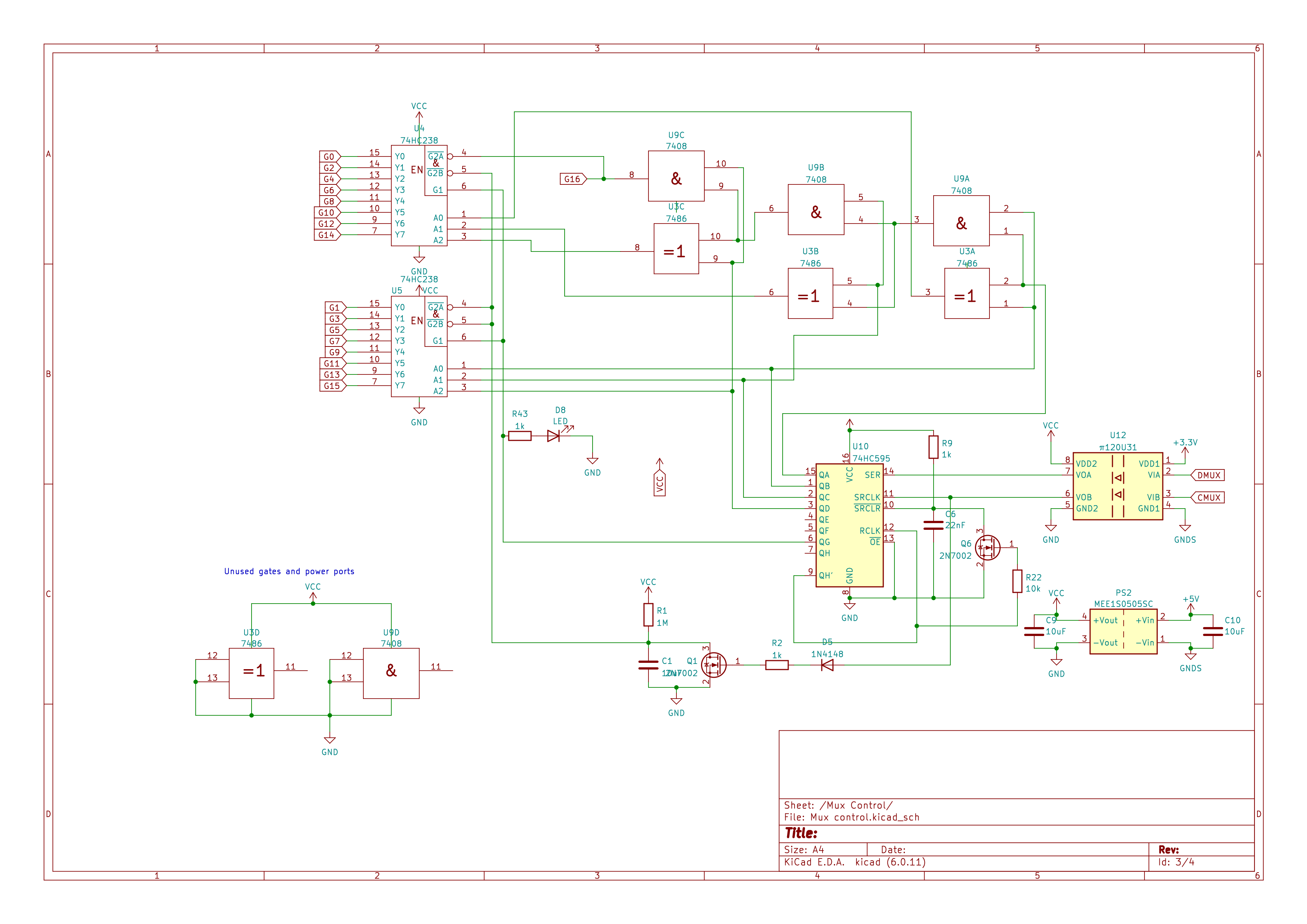

bexander wrote: Mon Feb 13, 2023 2:34 pm What are you trying to achive? A isolated DC supply of 1mA to the MUX? Maybe a swiched capacitor topology or similar could work?
Yes, this part of the circuit:
Some 74 series gates and an isolator. Haven't measured current draw when it's switching, only quiescent.
There are 3 potential groups: LV, HV_mux, HV_adc. HV_adc is the one that's floating to the channel currently switched in and whos DC/DC is also used for bumping up low cells. HV_mux is at a fixed HV potential and HV_adc can be within 0-70V of it. Are you thinking it is possible to supply the mux from HV_adc?
Pete9008 wrote: Mon Feb 13, 2023 3:15 pm Sorry no, too many variables/unknowns for any calculation to be of much value here. Best option is to see if the FET's and resistors (or equivalents) give any pulse ratings for current or power.
Either that or I test with some older revision boards :twisted:
Post by bexander »
Maybe, something in that way. Supply power from somewhere that is not battery powered.
I relized that switched capacitor won't work, they don't provide isolation.
Switch mode isolated DC/DC other then beeing expensive is that they tend to burn a lot of quiescient current, like 20mA or so. So not a good option in this case.
Would it be possible to let the TL431 directly turn of the power, via a p-fet or pnp transistor, to speed up turn-off
Almost done after 65 h :)
uavg                :    4050.22 [mV]
umin                :    4048.19 [mV]
umax                :    4060.47 [mV]
udelta              :    12.2812 [mV]
utotal              :    64803.9 [mV]
u0                  :    4048.78 [mV]
u1                  :    4049.34 [mV]
u2                  :    4049.34 [mV]
u3                  :    4049.34 [mV]
u4                  :    4048.19 [mV]
u5                  :    4048.19 [mV]
u6                  :    4048.19 [mV]
u7                  :    4048.78 [mV]
u8                  :    4050.53 [mV]
u9                  :    4049.94 [mV]
u10                 :    4050.53 [mV]
u11                 :    4050.53 [mV]
u12                 :    4060.47 [mV]
u13                 :    4051.09 [mV]
u14                 :    4049.34 [mV]
u15                 :    4051.09 [mV]
I changed the code to stop charging cells that are within 3 mV of the average. That sped up the balancing process significantly because more time could be spent on u12. So we have lowered delta from 56 to 12 mV in 65 hours, 0.7 mV/h.
bexander wrote: Mon Feb 13, 2023 5:16 pm Maybe, something in that way. Supply power from somewhere that is not battery powered.
Yes considering the fact that it will be running for many hours with the car off, standby losses should be decreased as much as possible. Right now it draws 20 mA from 12V while not active balancing. 6 modules would thus draw 120 mA.
The problem can be split into two parts: 1st: how do we initially power up the mux? 2nd: how do we keep it powered once in operation?
bexander wrote: Mon Feb 13, 2023 5:16 pm Would it be possible to let the TL431 directly turn of the power, via a p-fet or pnp transistor, to speed up turn-off
Many things can be done if necessary. Will see how much I can go up with mux clock speed first.
EDIT: also the signal needs to latch, otherwise after turning off and will turn right on again because the fault condition is gone.
And after 72h we're done, down to 3mV delta.
uavg                :    4048.41 [mV]
umin                :    4046.44 [mV]
umax                :    4049.94 [mV]
udelta              :        3.5 [mV]
utotal              :    64774.7 [mV]
u0                  :       4047 [mV]
u1                  :    4048.19 [mV]
u2                  :    4048.19 [mV]
u3                  :    4048.19 [mV]
u4                  :       4047 [mV]
u5                  :    4046.44 [mV]
u6                  :    4046.44 [mV]
u7                  :    4047.59 [mV]
u8                  :    4049.34 [mV]
u9                  :    4048.78 [mV]
u10                 :    4049.34 [mV]
u11                 :    4049.34 [mV]
u12                 :    4049.94 [mV]
u13                 :    4049.34 [mV]
u14                 :    4049.34 [mV]
u15                 :    4049.34 [mV]
So over all 0.7 mV/h now. I think there is still some optimization possible with the resistors, e.g. 10 instead of 22 Ohm. Bleeding runs through two of them, 44 Ohm, charging runs through just one.
To round off the little science project, here's some diagrams.
Individual cell voltages:
Obviously one was way out, the others already close
The essence of that:
Lowest cell started out at 4041 mV, highest at 4097 mV. Final average cell voltage is 4049 mV. So instead of dissipating 15 cells down to 4041 mV we just needed to dissipate 7 cells down to 4049 mV while the others were taken up to 4049 mV. Also we see the balance target drop from 4051 mV to 4049 mV because we took the highest cell down quite far. That why towards the end the min voltage drops again. The strategy of first taking high cells down to the average, then bumping low cells up would prevent that.
Discussed with bexander that the robustness against 70V is quite tough. He further suggests placing the TVS before the transistor bridge but even then the SMD resistors will briefly need to dissipate 95W each or 190W with the TVS across VDDA. We don't think they'll survive that for any amount of time.
Another possibility would be to have a bidirectional TVS right across the mux output and adding a fuse.
Had an idea to immensely shorten the time they are exposed to the fault current: the mux is clocked with 100 kHz, so it takes 40 us to turn it from off to on. So with a 16 bit control word it is possible to select a channel and then 40us later turn the mux is off again. Afterwards the ADC can measure the voltage that has built up in the smoothing capacitor C7 and from it decide whether the channel is connected to a voltage in range.
Did a simulation. With 4.2V, the highest valid reading, we get an average value of 89 mV. I think Sigma/Delta ADCs do average the input over sampling time (4 ms), right?
With an input voltage of 7V we get an average of 105 mV. And at 16V 84 mV. Oh! It seems as soon as the TVS steps into action the average is lower. So that's not good then.
celeron55
Posts: 805
Has thanked: 39 times
Been thanked: 136 times
Post by celeron55 »
I like simple but overkill solutions. If you need to protect something from overvoltage, a TVS and a PPTC fuse is very effective, as long as you're aware of and ok with the capacitance and leakage current of the TVS and the current vs. time behavior of the PPTC fuse.
