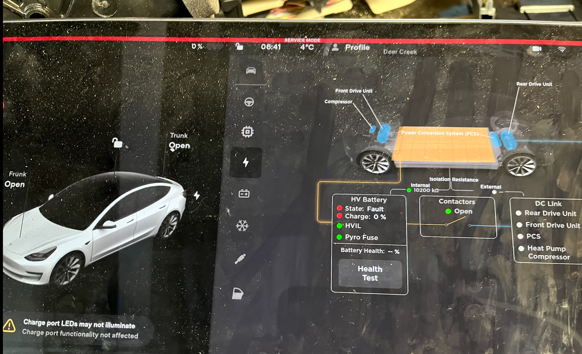

I am still unable to close the contactors; I shorted each of the HIL pins with a small wire. Do you know how I can check if there is damage to the PCS of the battery?bielec wrote: ↑Thu Jan 05, 2023 8:11 pm I have a dual motor version and I have linked the HVIL on both front and rear motor connectors and the small pins on the "Anciliary"/heater connector.
I have nothing connected to the charger socket.

Don't know about damage to PCS but have you checked.....
1. Capacitor across the H.V. pins
2. Resistor on X098 across HVIL pins
3. !2v on 2 pins of X098
3. 12v battery across DC/DC stud terminals, + on outside stud
4. If you are using my hacked code for the ESP32 then did you remove the line of code which caused error in transmission?
5. Links on the HVIL pins on both HV motor connectors and aux HV connector
6. CAN data connection on Vehicle bus on X098
7. The penthouse lid screws must be in place to complete the HVIL. I think just the two which hold connector X098
If you use SavvyCan to view data (by hanging an extra can transceiver across the vehicle can lines) then you can view and study the can data stream which will give you information such as HVIL state and will indicate if closure is being attempted and much more.

Yesterday we put the battery direct to the fronius inverter, but the contractor does not close. Not with load, not with Gen24 on the battery terminals conected.
We check all the points:
1. Fronius Gen24 10.0 Plus the H.V. pins (of one connector)
3. 12v on 2 pins of X098
4. Use our Python script on a raspberry, that do the same like the C++ for esp32 (i write it this weekend)
Then we make a caption for the 221 frame on a Model Y and check the folloring conditions:
1. in idle mode (human in car, but in neutral)
Here the 221 have 2 can messages that running hole the time and change each other:
decoded: (contractor closed)
In drive mode we have this messages in the same way:
decoded: (use see stuff like oilPump State on, contractor closed)
Car off: (contractor closed)
If you shout down the car and its looks completly off, we have the idel messages hole the time and the contractors will never open.
I test with this messages too, but no success.
Did anyone have a idea in this case?

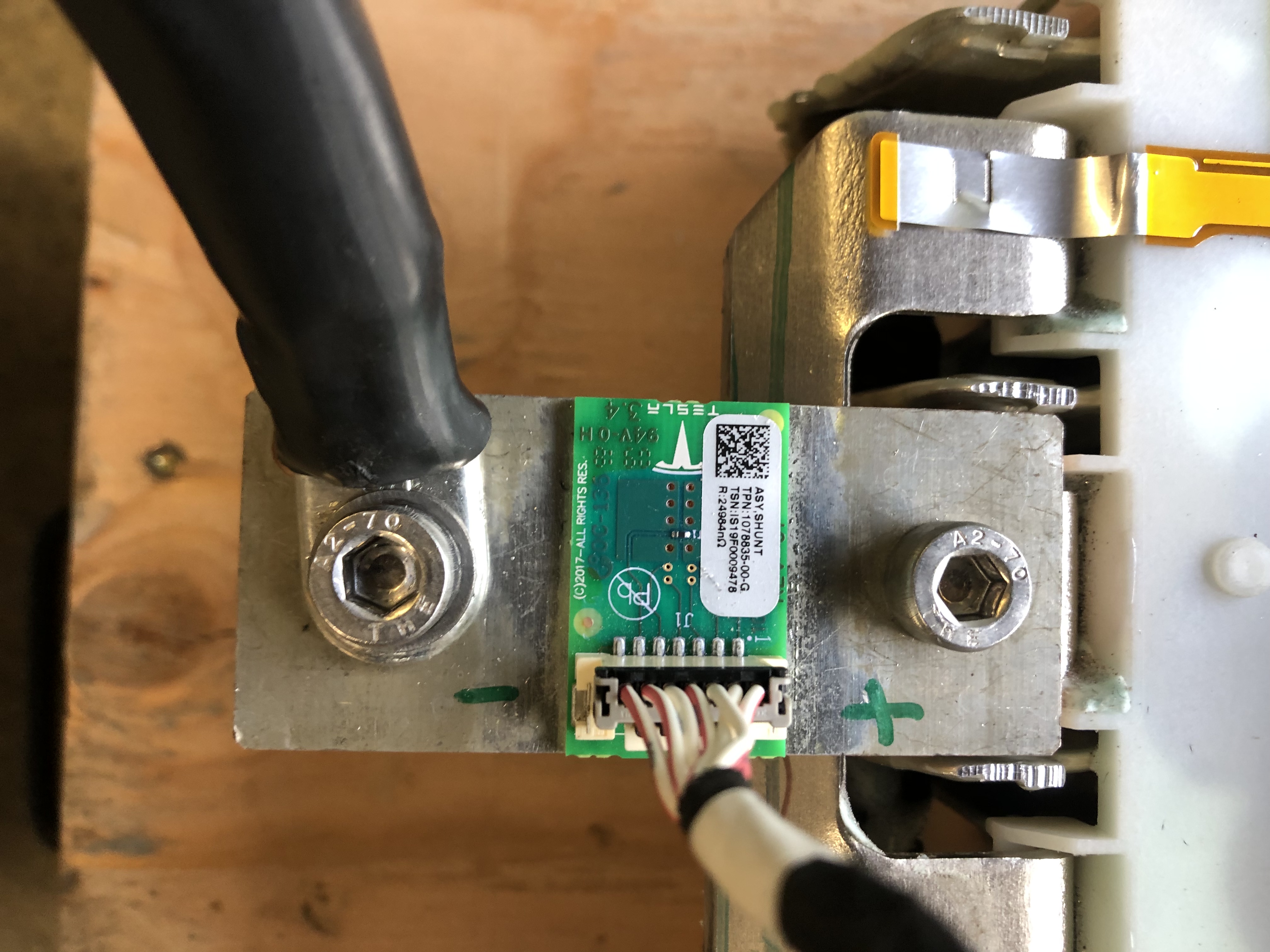

okay im started to take a crack at this for my battery setup.
for now im only using 3 out of the 4 short modules.
i have one of the middle modules "missing"
stripped down the HV controller harness to just the isospi and shunt connectors.
here's my log. looks like i can read all the cell voltages off id 0x401 (on charge port can) just fine with only 3 modules connected.
it seems to only read the first module the hv controller is connected to and report the max/min cell voltages on 0x332(vehicle can). Not the min/max of all 3 total.
so the actual min/max from 0x401 and 0x332 dont match. is this because of the spam thats occurring on vehicle can from all the errors?
i just want proper min/max and temps
*edit cvs files where mislabeled heres proper logs: also here's a modified version of the due code for just cell levels, soc, temps, min/max without the additional libraries:

Also can anyone confirm this is the orientation of the shunt?
- EV_Builder
- Posts: 1205
- Location: The Netherlands
- Been thanked: 37 times
Re: Model 3 High Voltage Controller
Not sure but the measurement would flip sign isn't it?
I'm not sure how to interpret your caption. On the M3, the shunt is between the middle batteries, in series with the fuse. Your terminal labeled "-" is connected to "-" terminal of a battery and the other to the the Fuse . The Fuse is connectet to "+" terminal of the next battery.
cheers, yes just want to confirm polarity. i have it between modules just like stock.muehlpower wrote: ↑Wed Feb 08, 2023 5:31 pm I'm not sure how to interpret your caption. On the M3, the shunt is between the middle batteries, in series with the fuse. Your terminal labeled "-" is connected to "-" terminal of a battery and the other to the the Fuse . The Fuse is connected to "+" terminal of the next battery.

Yes, I connect the battery to the display. Actually almost complete car except doors and some front sensor. However, all peaces are removed from a car and de-assembled in my garage so maybe I may miss out some connection. I manage to get the firmware updated to all ECU including BMS.
Health test will require the battery to be fully discharge but the contactors are open so I don´t think health test can be done.
