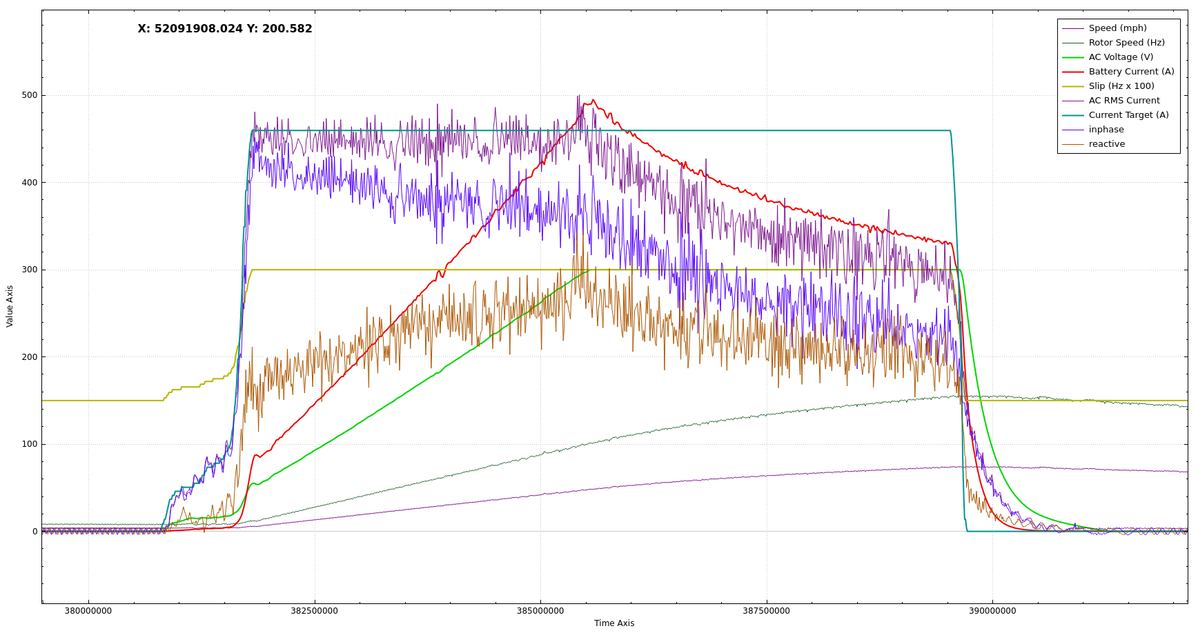

This is now working. By applying Park and Clarke to the measured current using the angle of the voltage as the reference angle, we can obtain some new data. I believe the id and iq values in this case represent inphase, and reactive current respectively. Here's a excerpt from a basic bench test showing forward acceleration, followed by two reversals of the torque direction (and as a result rotor direction).
The inphase current (brown) shows a positive value during acceleration and a short negative period (regen braking) during the direction change. The direction of the reactive current (neither positive or negative, since it's at a tangent to voltage) depends on the rotor direction.
I'm not sure if this is useful, and it's a slightly different direction from what I was planning, but it's interesting to have another view of the data.

catphish
Posts: 961
Location: Dorset, UK
Has thanked: 98 times
Been thanked: 195 times
Re: Direct current control of induction motors
Post by catphish »
I loaded the inphase and reactive current logging firmware into my car today and went for a drive. Here are some results.
Hard acceleration 0-60
Steady driving 50% current
Very low speed creeping
Regen (selected by changing slip direction with selector while rolling)
Some of this data makes a lot of sense to me. Some of it less so :)

Interesting results but I must admit I'm struggling to see where you are going with this (which is why I haven't commented previously).
As far as I can tell you have invented a new and novel way of measuring the real and imaginary power going into a 3-phase motor?? ;)
The transforms look like they are working well now.

Pete9008 wrote: Fri Feb 10, 2023 3:34 pm Interesting results but I must admit I'm struggling to see where you are going with this (which is why I haven't commented previously).
You are correct that I have no idea where I'm going with this, but I'll try to explain how I got here!
At the moment, we generate three phase voltages at a desired frequency, and I wanted to work out how I might get from that starting point, to instead directly controlling current.
The first question I had was how the phase currents differed from the phase voltages. It seemed that the best way to represent this was with two-dimensional plots. Then, rather than having to plot two-dimensional voltage, and two-dimensional current separately, and try to compare them, I decided to rotate the current measurement by the voltage angle to create a two dimensional plot that directly represents the two-dimensional difference between commanded voltage, and measured current.
On the topic of current control, when it's time to make my three sine waves into current targets rather than voltage outputs, I hoped this data might give me clues about how best to modify the voltage and frequency outputs to achieve a desired current. The obvious approach to current control is still to measure each current, then output a voltage correction on each phase accordingly, but I wondered if this might offer ways to make the same corrections but in a rotating reference frame with much less gain.
However, while this isn't really what this thread was supposed to be about, but I got super interested in this real/imaginary power plot, for a couple of reasons, most notably because if there is an optimal balance between real and imaginary power, I thought I might be able to adjust slip automatically to achieve it, giving optimal results at any speed without the need for manually configured slip limits.
Ultimately, I feel like the more ways I find to examine the data, the more I will understand the operation of the motor.

catphish wrote: Fri Feb 10, 2023 4:02 pm On the topic of current control, when it's time to make my three sine waves into current targets rather than voltage outputs, I hoped this data might give me clues about how best to modify the voltage and frequency outputs to achieve a desired current. The obvious approach to current control is still to measure each current, then output a voltage correction on each phase accordingly, but I wondered if this might offer ways to make the same corrections but in a rotating reference frame with much less gain.
I can't help but think that this is the way you will end up doing it. Which reference frame it is best/easiest to do it in is a very good question (and I haven't a clue)!
catphish wrote: Fri Feb 10, 2023 4:02 pm However, while this isn't really what this thread was supposed to be about, but I got super interested in this real/imaginary power plot, for a couple of reasons, most notably because if there is an optimal balance between real and imaginary power, I thought I might be able to adjust slip automatically to achieve it, giving optimal results at any speed without the need for manually configured slip limits.
Doing something just because it might help understand the system is an excellent reason in my book :)

With zero (unachievable) slip the Iq and Id you calculate are actually correct for the rotor field. As the slip increases the vector rotates and more current appears to be transferred from d to q. So, as you say, the ratio could be thought of as a way of measuring slip.
Very interested to see where this ends up going.
EDIT - just twigged what the ripple on the Iq and Id plots is, it's the 5th harmonic distortion isn't it! That would mean that if you use Iq and Id in the control loops it should still eliminate the harmonic content (and avoid the three individual phase current controllers from fighting each other which is something that's been bothering me). I think you may be on the right track here :)
