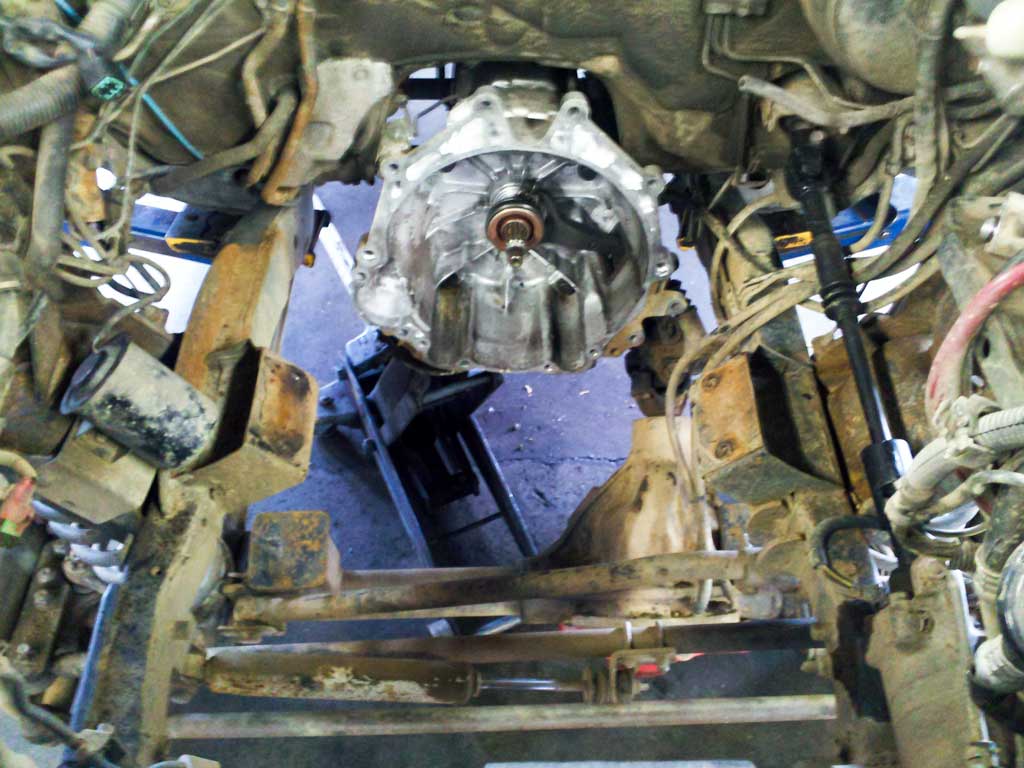

I am considering converting my Mitsubishi Pajero Sport to an EV as well. It is based on a similar model, such as the Mitsubishi L200 or Triton, similar to yours.
My initial plan is to attach the electric motor to the transmission, which seems like the simplest solution. However, upon examining the underbody of my truck, I noticed that the transmission is positioned very low. The lower rim of the bell housing is nearly level with the front differential axle. Given the length of the electric motor, if I were to attach it to the bell housing, it may not clear the differential and would be positioned too close to it.
I am not sure how the issue was resolved in Damien's Triton conversion. Another possibility might be to attach the electric motor to the transmission without the bell housing.
Has anyone had experience with converting this type of truck or a similar model?
I would appreciate any insight or recommendations on this, thank you.

i dont think you'll have any issue with a leaf motor mounted inplace of the engine. the leaf motor will take up much less space laterally compared to the original 3.xxl.slackerEV wrote: ↑Wed Feb 08, 2023 10:51 am My initial plan is to attach the electric motor to the transmission, which seems like the simplest solution. However, upon examining the underbody of my truck, I noticed that the transmission is positioned very low. The lower rim of the bell housing is nearly level with the front differential axle. Given the length of the electric motor, if I were to attach it to the bell housing, it may not clear the differential and would be positioned too close to it.
looks like full power tower may even fit.

Thank you for comments, Bratitude. That's good to hear.
I will make the mock-up of the leaf motor and try to fit it in.
I am contemplating between Em61 and Em57.
Bratitude, I will PM you at some point RE the coupler and the adapter plate.
