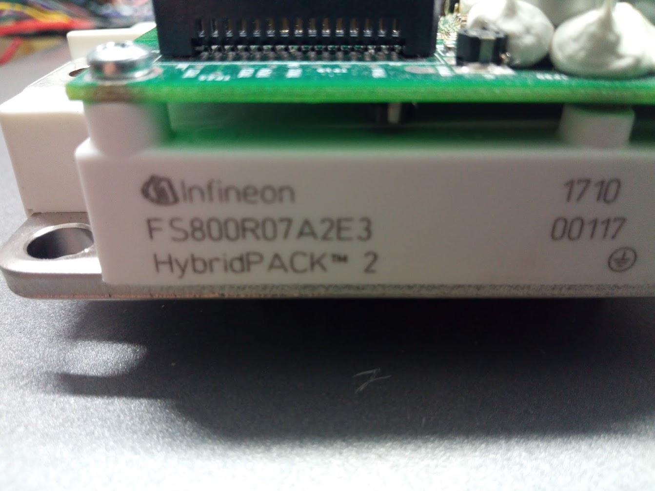

Re: i3 controller hacking from diyelectriccar.com
Don't look at the capcitor, it's a non polarised type.
Look at the IGBT module!
There will be a part number on the IGBT, which means you can look up a datasheet.
At 60V, the inruch current may be too low and too brief to light the filament.
Measure the DC link voltage.

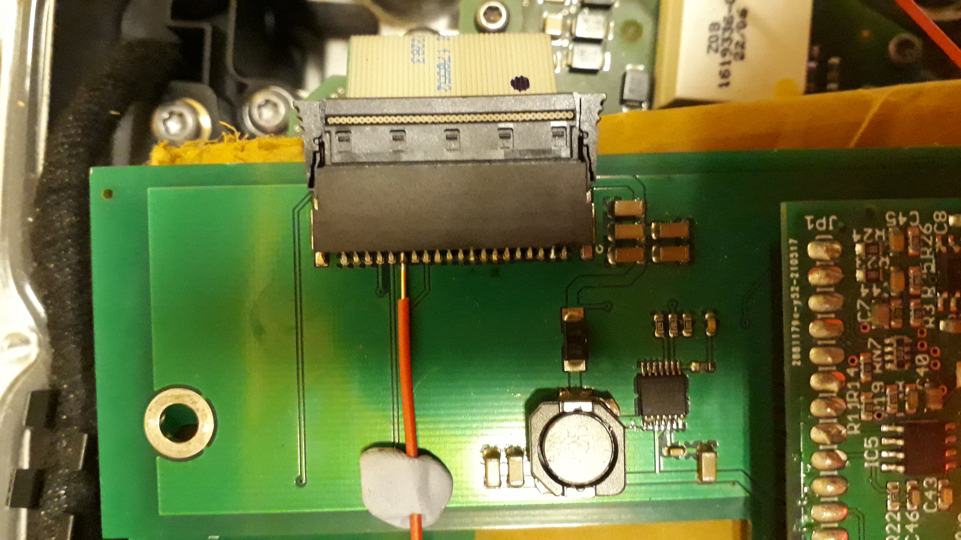

I didnt happen to see it, but on the 40 pin ribbon connector, are the unpopulated pins in the wiki also unpopulated on the OE board, or are they just unknown/unused for the OI purposes?

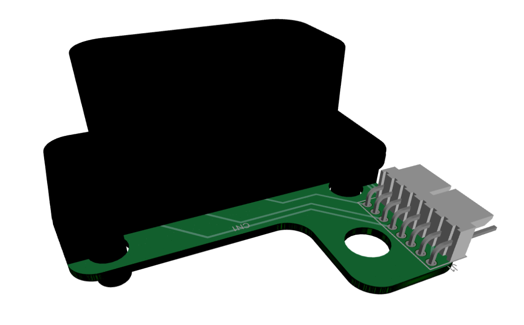

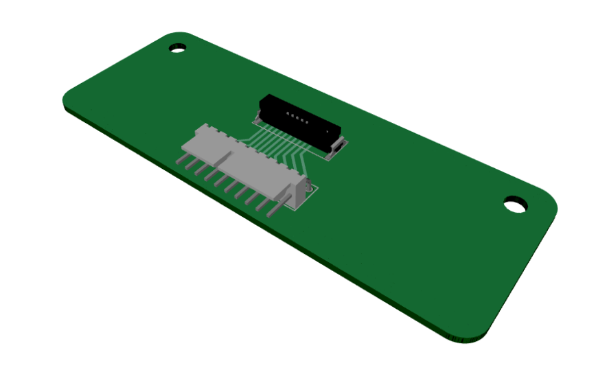

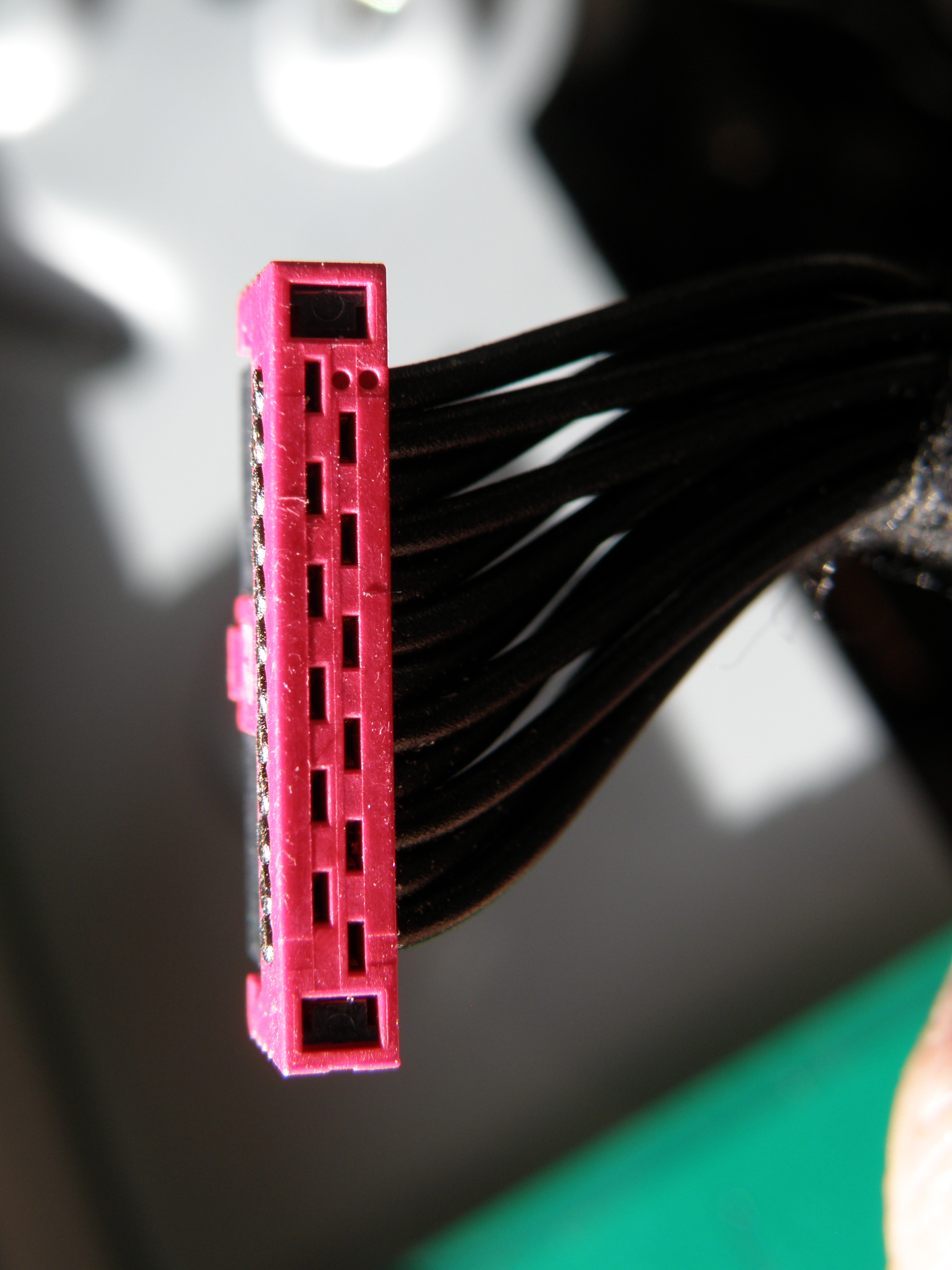

I've ordered some PCB pairs to simplify the motor resolver and temperature sensor connections.
One board will sit under the Ampseal connector and allow a PCB header or wires to be connected directly to the pins, the other board will have an ERNI Minibridge connector to mate to the wires coming from the motor (I've been unable to source the ERNI connectors that come pre-mounted to a PCB).
Have ordered some spares in case anyone else needs a set.

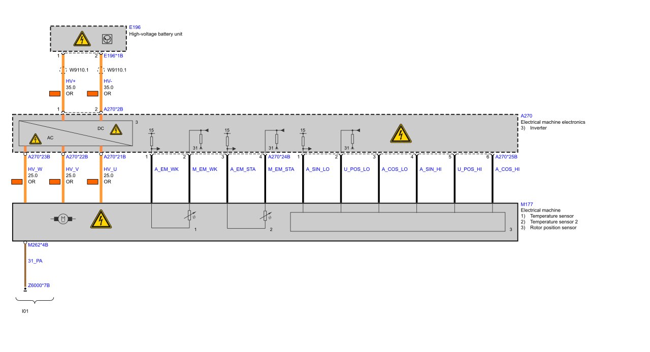

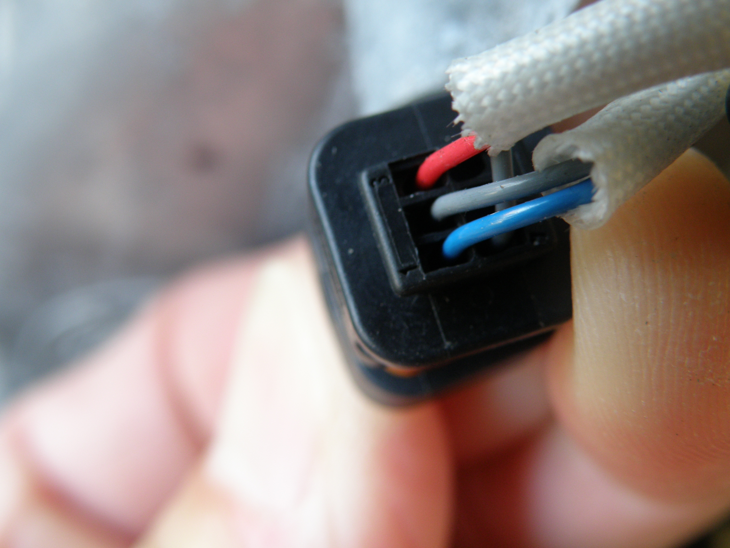

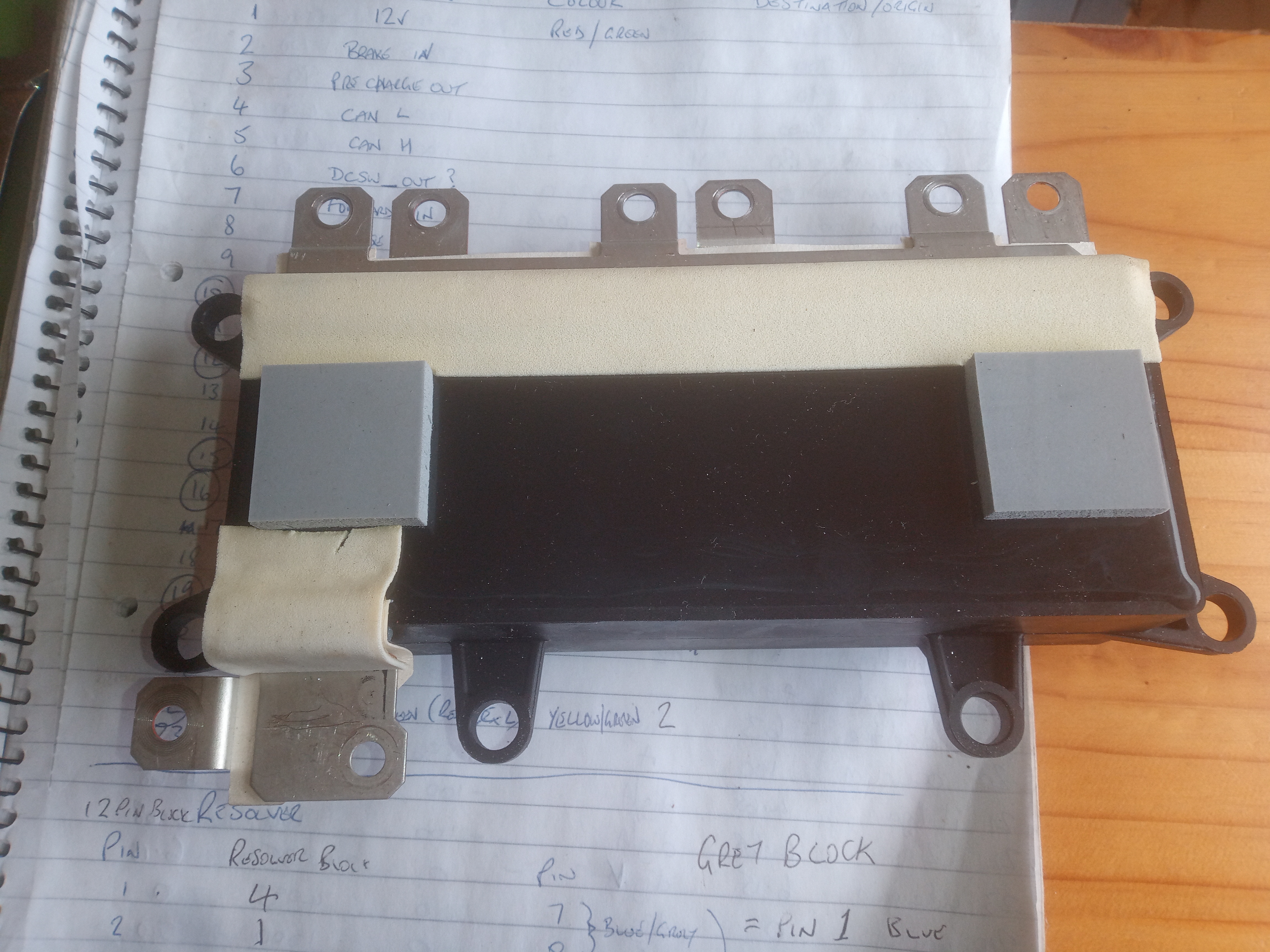

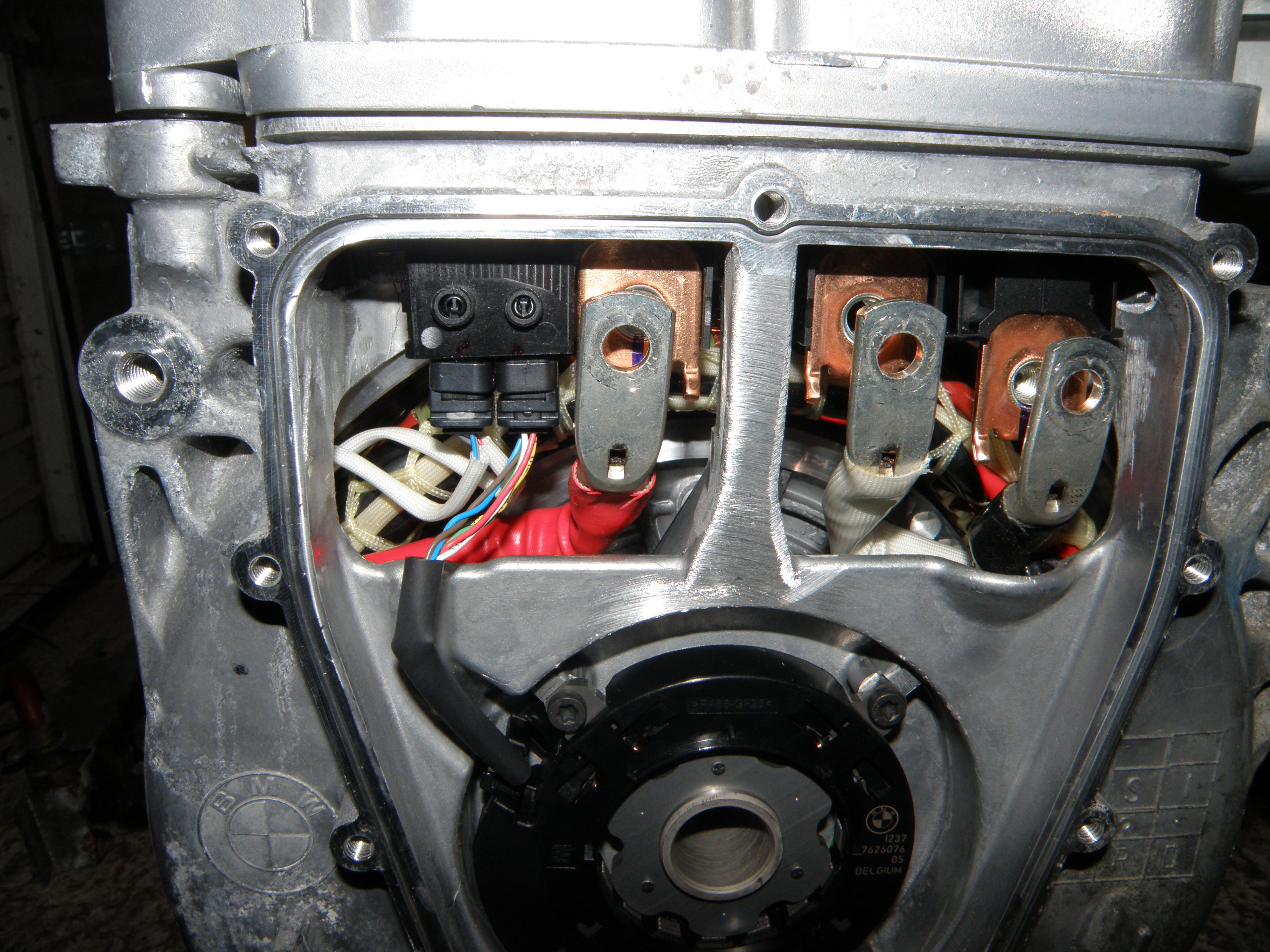

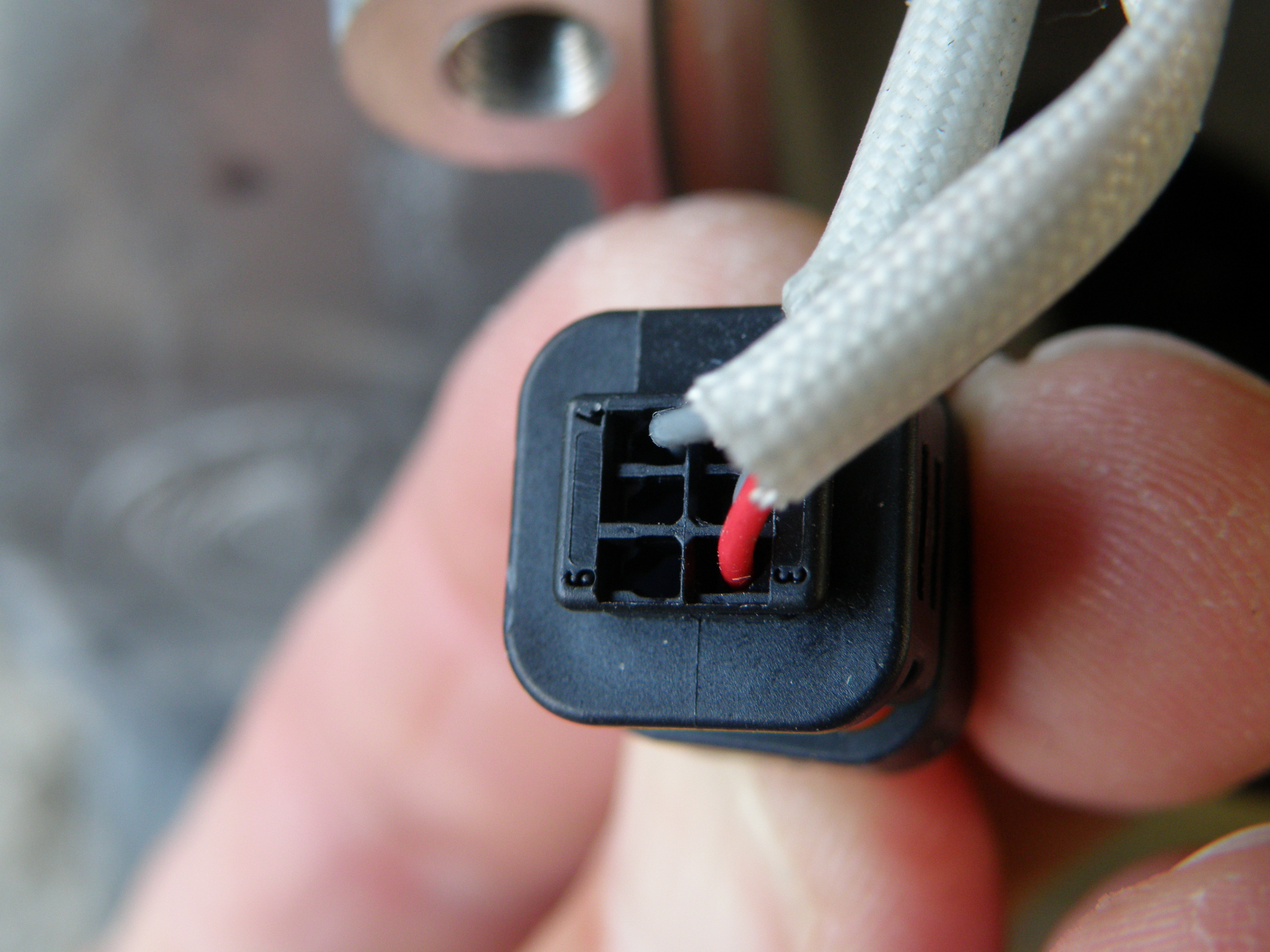

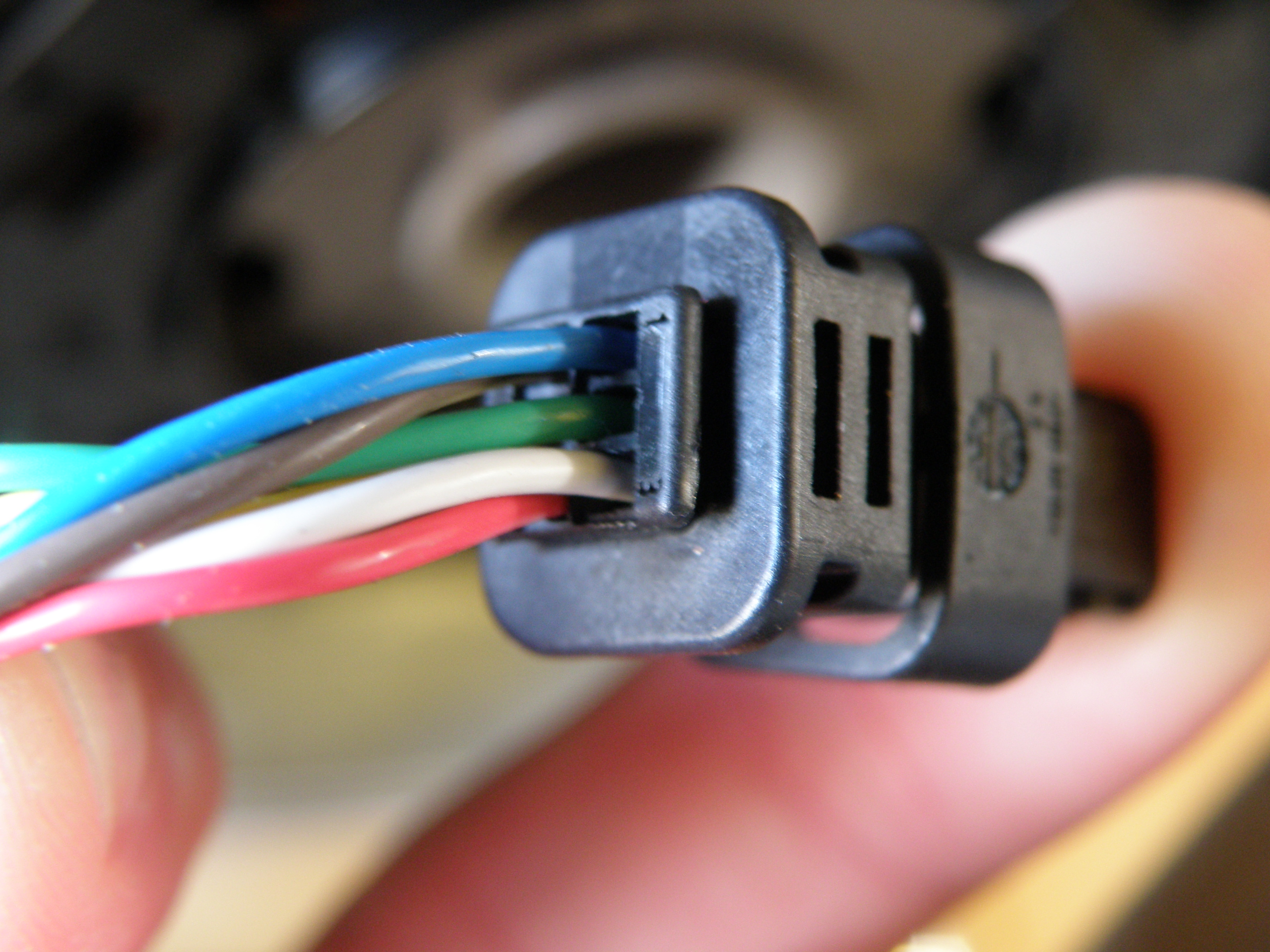

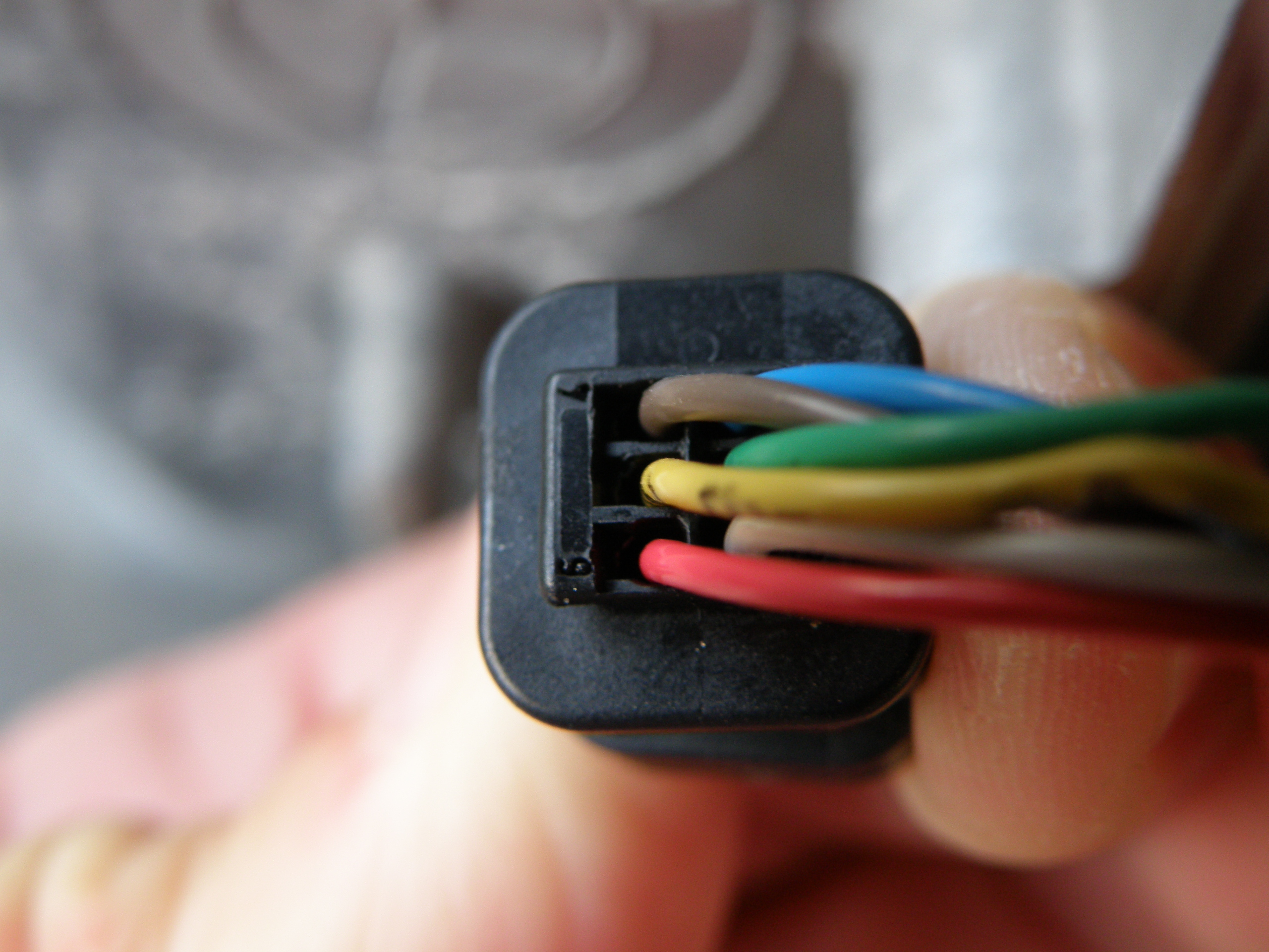

Traced the resolver and motor temp wires at the weekend from the 12 way ERNI connector that connects to the original inverter control board back into the motor housing, sharing some information below in case it's useful.
Have also updated the wiki with suspected pinout for the ERNI connector: https://openinverter.org/wiki/BMW_i3_Inverter

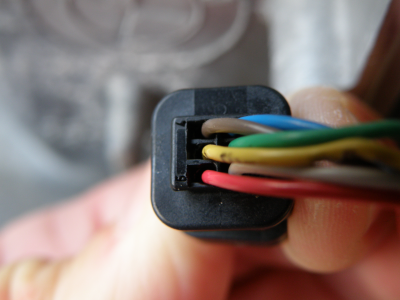

There are two six pin connectors in the motor housing, both appear to be from TE Connectivity. Three pairs of wires from the resolver terminate in one of them, while two pairs of wires from the motor stator temperature sensors terminate in the other: Resolver wires are numbered where they enter the connector: As are the temperature sensor wires: The connector pin numbers appear to relate to the numbers on this schematic: Leading to following pinouts:
Resolver connector
1 - Blue - A_SIN_LO
2 - Green - U_POS LO
3 - White - A_COS_LO
4 - Brown - A_SIN_HI
5 - Yellow - U_POS_HI
6 - Red - A_COS_HI
Temperature sensor connector
1 - Blue - A_EM_WK
2 - Grey - M_EM_WK
3 - Red - A_EM_ST
4 - Grey - M_EM_STA
5 - Unused
6 - Unused
Resistance readings suggest these are plausible:
Resolver connector - pins 1 and 4 for A_SIN read 26.5Ω, pins 3 and 6 for A_COS read 26.5Ω, pins 2 and 5 for U_POS read 16.4Ω.
Temperature sensor connector - pins 1 and 2 read 54kΩ as do pins 3 and 4.
Tracing the pins in the two six pin connectors in the motor housing back up to the ERNI minibridge connector for the inverter board with a multimeter, and then checking resistances between the pairs again, results in the following pinout for that connector, where pin 1 is at the end with the two dots:
1 - Brown - A_SIN_HI
2 - Blue - A_SIN_LO
3 - Yellow - U_POS_HI
4 - Green - U_POS LO
5 - Red - A_COS_HI
6 - White - A_COS_LO
7 - Blue - A_EM_WK
8 - Grey - M_EM_WK
9 - Red - A_EM_ST
10 - Grey - M_EM_STA
11 - Unused
12 - Unused
Thanks to Hans and golfdubcrazy for their earlier information on this.

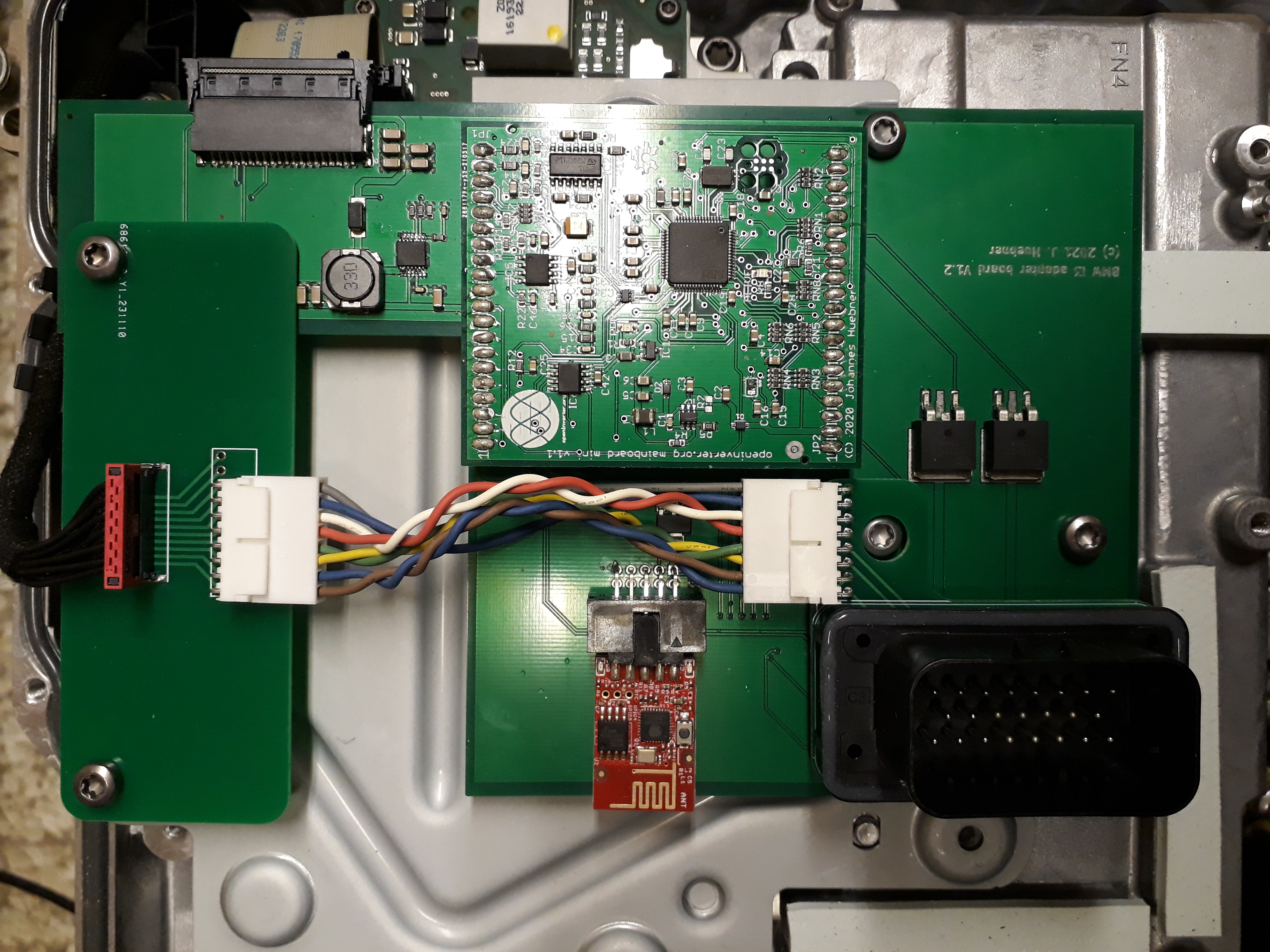

PCBs arrived and fit nicely. Ordered 10 so have spares if anyone needs a pair.
Need to double check the resolver connections on the main Ampseal header as it looked like the Sin Hi and Sin Lo might have been mixed up, based on reviewing the two Wiki pages for the mini mainboard and i3 inverter. Will update once everything checked.

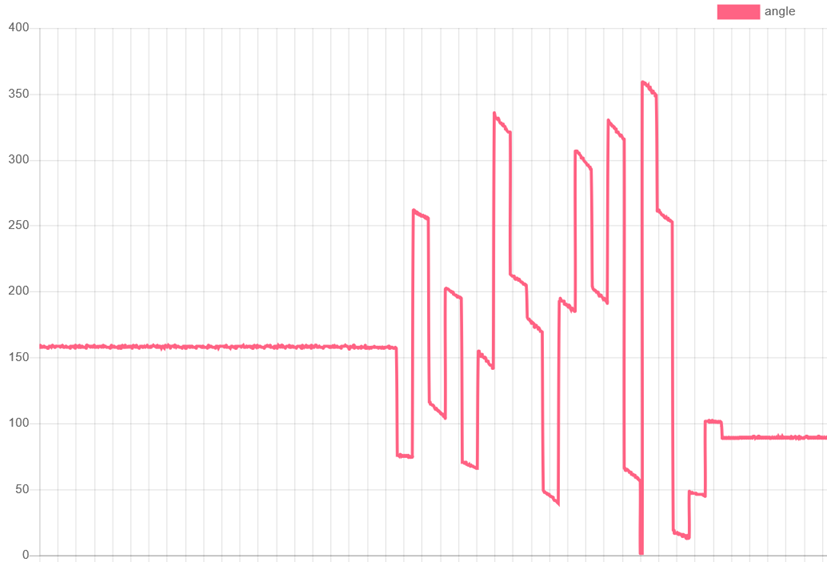

Made some progress testing the encoder using Damien/Johannes' useful FOC tuning guide below.
Rotor angle plot from the interface below, measured using the connections indicated in my previous post and the i3 wiki. Have not been able to get the motor spinning yet, seem to experiencing the same issue that Mr X had with the DC bus voltage. Will update once that is solved.

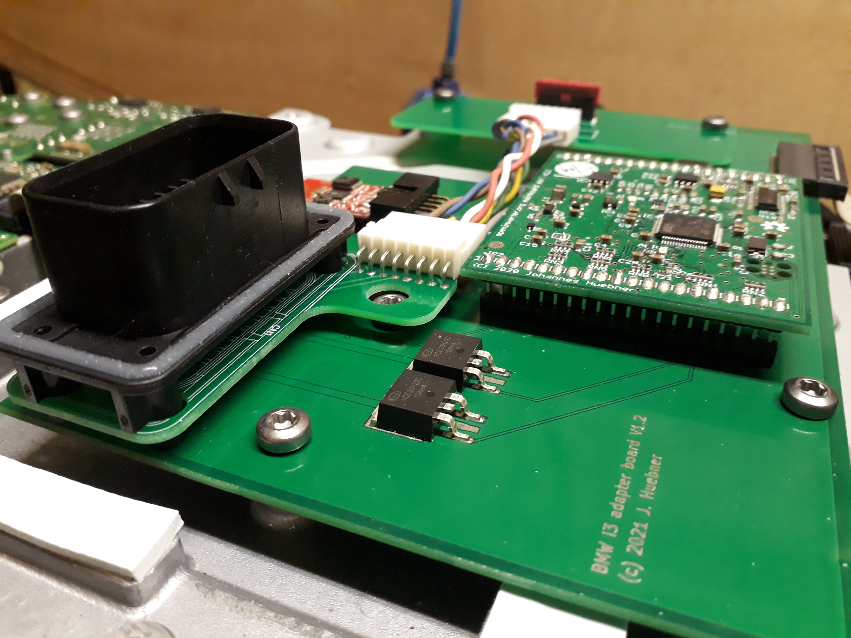

Got the resolver connector cards from CJW today and set out to mount them to the inverter.
First thing I noticed is that SPI comms doesn't work, as others have noticed.
I finally found the culprits
a) hadn't fully reflowed the solder paste of the Erni connector and had shorts to ground (probably not the culprit for most but worth checking)
b) err_out must be disabled/configured as input because otherwise it either pulls up or down the clock signal
So in vehiclecontrol.cpp below
I added
I suggest checking out safer_can2 branch and adding it to that because I haven't fully tested/understood the speed dependent throttle travel yet
With that sorted there is no longer any need to bridge series resistors.
//Brake pin is used as SPI_MISO
DigIo::brk_out.Configure(GPIOC, GPIO5, PinMode::INPUT_FLT);
//Disable err_out so it doesn't pull the clock signal up or down
DigIo::err_out.Configure(GPIOC, GPIO10, PinMode::INPUT_FLT);

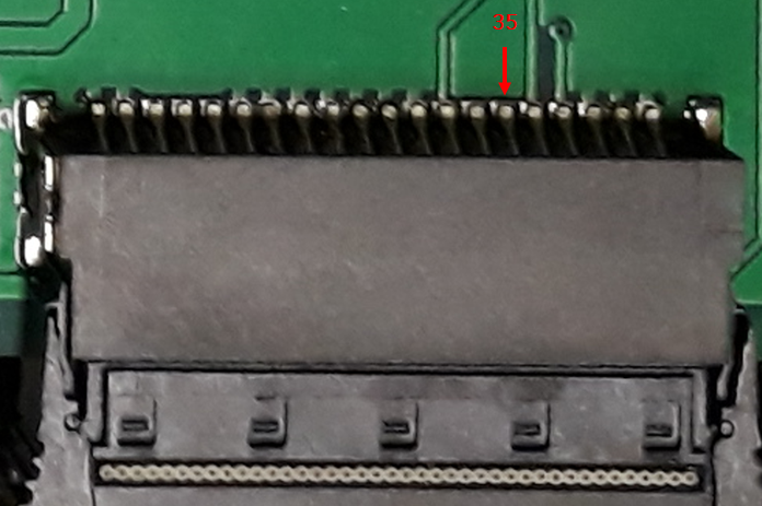

Have implemented the code fix provided by Johannes above (thanks for that, and also to Janosch for compiling), now reading bus voltage and heatsink temperature.MrX wrote: ↑Fri Jun 17, 2022 10:22 am A couple of interesting points on the cable running to the gate drive board:
Pin 35 (IGBT PSU 12V on) is low level 0V
Pin 17 (lower gate driver ready) is low level 0V. Notably, Pin 16 (upper gate driver ready) is 5V
Should pin 35 have 12V on it from the adapter PCBA? Mine does not appear to. Does that come from one of the ampseal inputs?
Edit* did not mention that I am aware of the DCDC off the DC bus caps. That appears to be okay. I see no increase in consumption from the 12V power when in manual run.
Checked the 40 pin Harwin connector and found pins 22, 27 and 29 (all ground connections) were not soldered to the pads, now fixed.
I now seem to have encountered the same issue as MrX, pin 35 on the Harwin connector (IGBT PSU 12V on), isn't reading any voltage even with inverter in run mode and no errors indicated. Does anyone know if this pin is usually powered up as soon as the drop-in board receives power, or if its state is controlled by the STM32? If anyone is able to check it would be appreciated, I'm hesitant to apply power to the pin without confirming. Pin indicated on photo below.
Finally got the motor spinning!!!
Hooked up 12v to pin 35 on the Harwin connector to the gate driver board and the motor sprung to life. It is now working on analogue throttle control in forward and reverse. Will post full set of parameters later and update notes on the Wiki.
