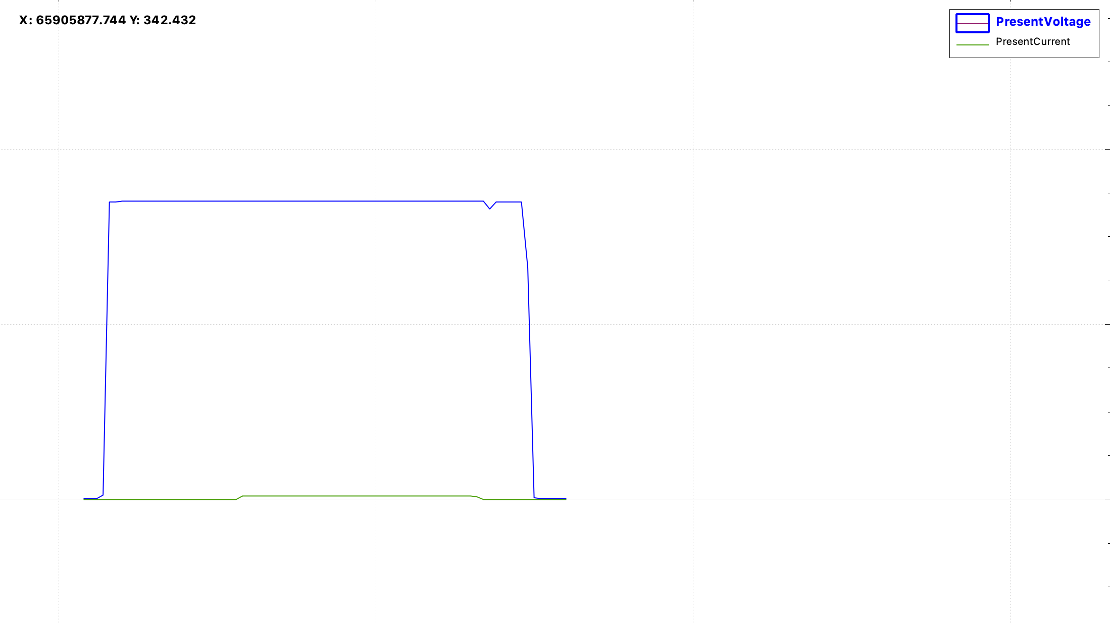

Still an issue today so grabbed a log
Looks like the voltage seen goes up to ~340v but doesn't drop back below 20v before staring the charge.

Looks like I've blown an input pin, IN2 is being constantly pulled to ground, the contactors are closing too early. Need to redesign to add input protection I guess.

How is that possible. Isnt it pulled low? A transient on the EVSE line?
Could be that a small 3V6 zener diode would save your problem. You connect upper side to your pin and the other to GND

Not entirely sure, transients or ESD? Zener going on and hoping
Might have to carry around a gas soldering iron to quickly change to another pin

Hm... In my new V6 version i have plenty of 10K pulled up inputs so i might just choose a new wire and reconnect
But that is how i was dealing with burned IGBTs in 2016! Each year a different set replaced until i used desat drivers which solved the issue for good.
Hope for the best aint a tactic! I strongly suggest you add a zener or TVS protection on each input so it cant be overloaded easily.

Ordered an updated pcb with zener diodes and some other fixes.
All working again on a new pin
. Only thought ive had is somehow the pin went to output?
