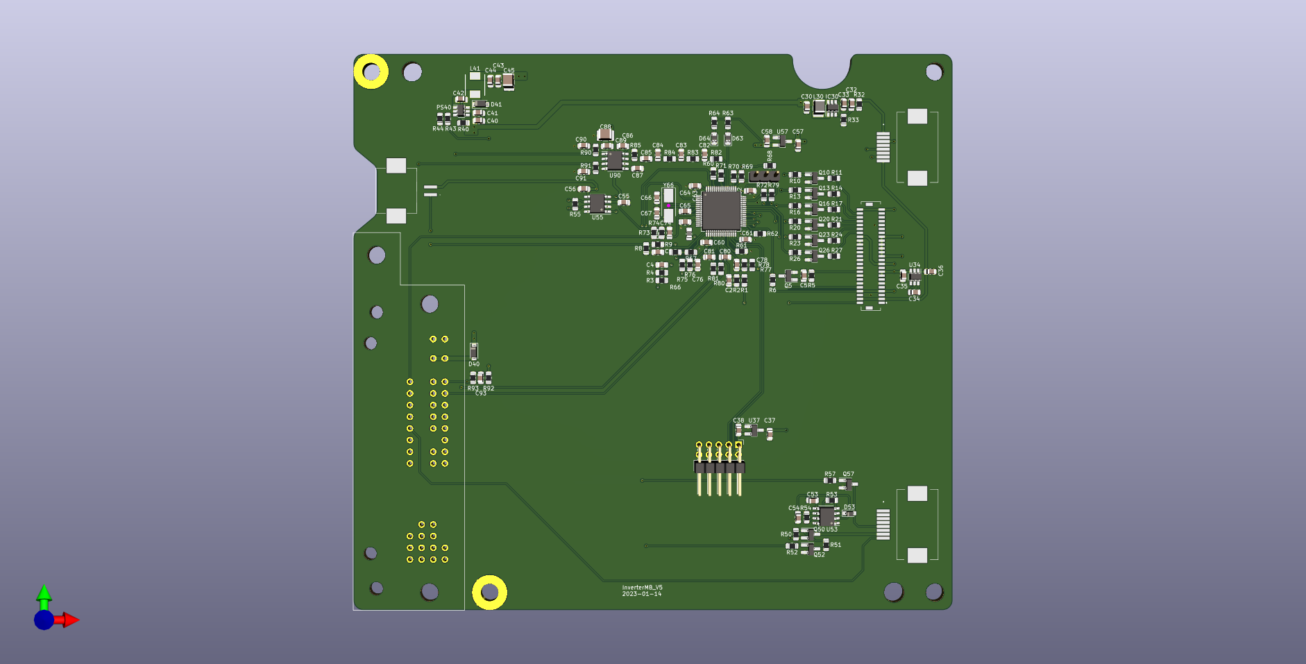

Progress (well hopefully - if it all works!):
Power supplies are coming up, resolver to digital converter IC is clocking and generating the resolver drive waveforms and I can talk to both processors with the debugger. I've tried putting the code on the STM32F407 processor and it programs OK and in the debugger it single steps through main and completes all the initialisation code but when allowed to free run it ends up in the blocking_handler interrupt so I'm guessing I've messed up an interrupt configuration somewhere. Hopefully spend some time on it in the evenings, get it all tested and if it's OK get the rest of the bits ordered and look at hooking it up to the inverter and HSG.
Forgot how much of a pain hand assembly is! I've left all the difficult to replace bits off for now (mainly the Toyota connectors) until I know whether it works. Couple of slight problems, one diode on backward which stopped the -5V rail from working and there are a few components that I managed to miss when ordering but it generally looks OK. Power supplies are coming up, resolver to digital converter IC is clocking and generating the resolver drive waveforms and I can talk to both processors with the debugger. I've tried putting the code on the STM32F407 processor and it programs OK and in the debugger it single steps through main and completes all the initialisation code but when allowed to free run it ends up in the blocking_handler interrupt so I'm guessing I've messed up an interrupt configuration somewhere. Hopefully spend some time on it in the evenings, get it all tested and if it's OK get the rest of the bits ordered and look at hooking it up to the inverter and HSG.

- Posts: 1801
- Has thanked: 102 times
- Been thanked: 348 times
Re: Smart Roadster (with Prius Gen3 Inverter and Outlander Rear Motor)
I thought this was fairly stripped out compared to the first design (viewtopic.php?p=39624#p39624)!
I've moved most the VCU related stuff out to a second unit. The contactor control bits are only there temporarily to allow the car to be used before the VCU is in.
What else are you cutting out of yours? Are you using Kicad for it?
Yes, using kicad. Removed everything I don't need. Using STM32 and stock design, so no fancy stuff like yours.
No input/outputs as it's done via CAN.
Removed MG1 current sensor.
Added DC/DC voltage control via NE555 timer.

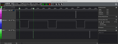

Have now got the resolver/ADC sampling, control loop execution and PWM reload working the way I wanted - an analyser screenshot:
The middle trace is showing the execution of PwmGeneration::Run (main control loop), it is running when this line is low. The start of this is triggered by the completion of the last ADC conversion of the Il1/Il2 burst.
The bottom trace shows one channel of the PWM output. The reload value is set to the extreme so that it is a low pulse the middle of which is the reload point. There is another reload at around 73us that isn't visible on the trace.
What can be seen is that this is giving a latency from motor position and motor current measurement to the new PWM value that is based on these being output of 25us, down from 180us on the F103 processor - happy with that
It will be a bit slower than that in reality (as the PWM frequency for that test is set a bit high), 30us is more realistic.
The top trace is showing the resolver sampling point which is coincident with the start of a burst of Il1 and Il2 ADC conversions (because of the way the interrupt I'm using to drive the IO line works the analyser is only seeing every other capture, there is another happening at around 44us). This is set to be exactly mid way between PWM reload events.The middle trace is showing the execution of PwmGeneration::Run (main control loop), it is running when this line is low. The start of this is triggered by the completion of the last ADC conversion of the Il1/Il2 burst.

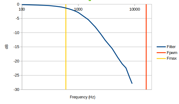

So the missing components arrived today and have now been fitted. One of these was the op-amps for the Il1 and Il2 motor current measurement filters.
These are there because I'm a little worried about the low inductance of the Outlander motor (0.15mH) causing excessive ripple. The idea of the filter is to allow the commutation frequency components through while blocking the PWM frequency components. It should also block switching frequency components pretty well.
First problem, I didn't put pull down resistors on the filter inputs (becoming a bit of a theme!) which meant that the op-amp bias currents pulled the outputs up to full scale when the CTs isn't connected; luckily I had included some schottky protection diodes in the circuit so the processor ADC inputs survived. Also luckily there was a suitable ground pad next to the filter input so 100k pull-downs are now bodged on.
The measured filter response looks like this: The yellow line is the max commutation frequency for the Outlander motor (running up to 10krpm) while the orange line is the PWM ripple frequency (assuming PWM running at 8kHz). While it doesn't look too bad I'm not sure it is quite right, the filter cut-off was chosen when I was planning on running 4.4kHz PWM so it's a bit low now. I have also just measured the phase delay and at 100-150us it is enough to lose all the latency gains made moving to the stm32F4.
I'm now wondering what the best compromise is. I had planned to sample the resolver/current at the mid PWM timer reload point which would minimise the measure to output latency (30us) but doing that means that the ADC is sampling at points of the PWM waveforms where IGBT switching is occurring. If the sample point and a switch event coincide there will be lots of noise on the signal. Also, depending on PWM duty cycle, the motor current could be rising or falling so adding PWM frequency noise. Hence the filters, but if the filters add another 125us latency I'm up to 155us which is not much better than the 180us starting point (but hopefully with lower noise current samples).
It's possible that a better compromise is to sample at the reload point. Now this means that it will be 60us till the measurement has an effect on the PWM duty cycles but because it is guaranteed that there will not be a switching event you can get away with a much worse, and lower phase delay filter. Say I could get the phase delay down to nearer 40us that would give a total latency of nearer 100us. It also means that you are always measuring on the same point on the PWM ripple so there should be no beating effect. So the latency isn't as low as I'd like but the current sampling should be very clean.
Not sure what the best compromise is? It's either change the cut-off from 2kHz to 4kHz and stick with mid-point sampling or change it from 2kHz to 8kHz and go with reload point sampling. Both will be pretty similar in terms of total latency at ~100us but the later should give cleaner current signals so currently erring in that direction. Comments welcome!
Edit - think I'm going to move to sampling at the PWM reload point. The filter cutoff frequency will be lifted to ~12kHz (chosen because I already have the cap values needed!) which should drop the phase delay to around 20us while still giving a bit of attenuation to PWM frequency (~9dB) and good attenuation to switching noise (which will still help with data logging via the non synchronised sampling on the other ADC). Total latency will be around 80us. Not as good as I'd like but still a worthwhile improvement.
Edit2 - Re-measured the phase delay of the filter concentrating on the area below cutoff (the actual operating region) and it is worse than I thought - 190us. Looks like the cutoff frequency will need to increase by a factor of 10 (to 20kHz) to have a low enough delay so will definitely have to move to reload point sampling. The question at that point is it worth keeping at all? Do I bypass it completely (can be done by fitting zero ohm links) and save the power consumption and reduce component count or leave it in but set to a higher freq to remove any other noise that may be present?

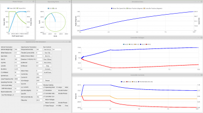

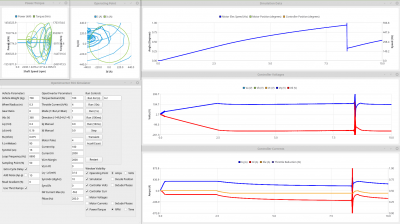

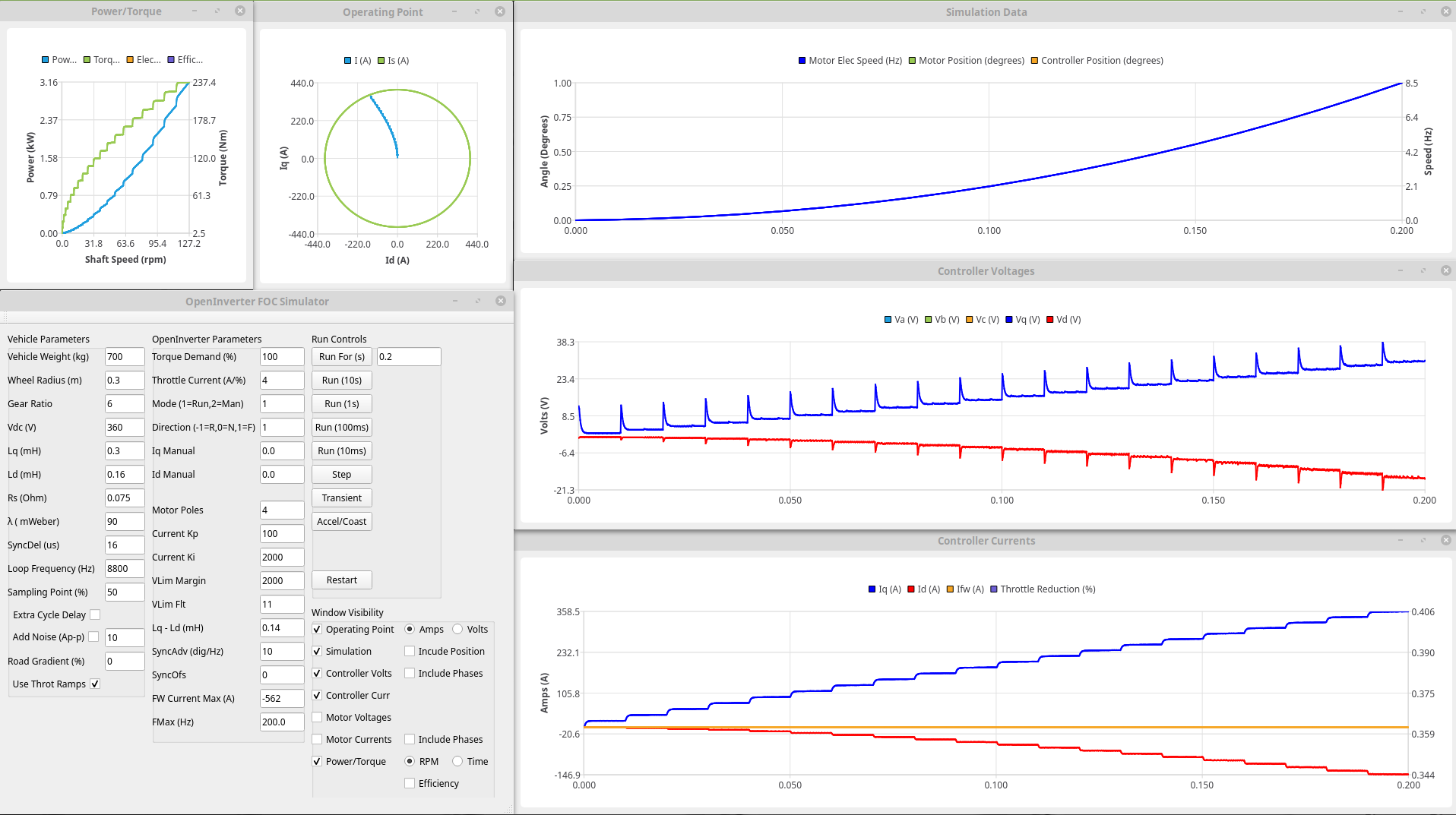

Good question and the answer is I don't know but I'll try and explain my reasoning for wanting to do it (partly as explaining something is the best way I know of finding the flaws in it, partly because it allows others to pick holes in it and partly because it may be interesting/useful to someone?)
The driving force for this is the low Outlander motor inductance, Lq=300uH, Ld=160uH. Now using the following simulation run which ends just at the point throttle ramping has finished and the current has just hit maximum: Now taking numbers from this gives a controller voltage of 30V, power of 3kW and a motor voltage drop (not shown) of 30V.
The controller voltage of 30V is equivalent to a PWM duty cycle of 16%, this is equal to a total on time of 36us at 4.4kHz split into two equal 18us pulses (centre aligned PWM).
During this 18us pulse there is 360-30V-330V across the motor inductance so the current rise will be (i =Vt/L) = 37A, so during each pulse the motor current will increase by 37A. This current stores energy in the inductance, the current will then ramp down over the rest of the PWM period as the energy converted to mechanical energy by the motor. At the power level of 3kW the energy stored will comfortably last the whole period. So depending where we measure current in the PWM period, and where the PWM on periods are, we could see up to a 37A error/ripple in the measured current. This seems a bit on the high side to me as the control loop will always be trying to correct it which could lead to odd beating effects or non-linearities as the PWM switching points move.
To minimise this there are a few things that can be done. The first is try to filter the ripple. Next you can move the sampling to a point on the PWM waveform where it will always give an average current result. Lastly you can increase the PWM frequency. My first approach was to do the filtering but my measurements on the loop filter I added show it isn't going to work without adding too much measurement delay. So now I'm going to move the sampling point to the PWM reload point (which should give average current - it's always midpoint between the two on pulses) and try and move to 8kHz which should reduce the ripple by a factor of 2 to around 20A.
The final point is that the firmware measurement to output latency is limited by the PWM reload time. At 4.4kHz there is a reload every 114us, at 8kHz this can drop to 63us. The effect of this can be seen in the below.: The first is a simulation showing the high latency case (180us) and it can be seen that the control loops lose it at around 8400rpm. The second is the same settings but with lower latency (60us) showing that the loops are happy to above 9000rpm (they still lose it at 10125rpm though). I'm much keener on the second one! Worth noting that controlling the current on a low inductance motor is, in some ways, harder on the control loops (things change faster) so this problem may not be as bad on higher inductance motors.
So that's the why, what about the effect on the inverter? Now I've tried finding the justification for the 4.4KHz operation on the Prius inverter and all I can find is comments that it seemed happy at that frequency (and I'm not clear whether that is the Gen2 or Gen3). Now without more information (in what way was it unhappy at other frequencies, what motor was it running, what battery voltage, etc) this is fairly meaningless so I've decided to ignore it for now. So what facts are know - the inverter needs higher deadtimes and it normally runs at 5kHz. Now dead-times are suggestive of slower IGBTs but that is not necessarily the case, the driver turn on and turn off times contribute too. So would Toyota have used slower IGBT to improve some other characteristic, possibly, but even if they have the effect can be worked out - see viewtopic.php?p=50363#p50363. I'm fairly sure that even if the IGBT are significantly slower I can live with the effects. Once I have a working setup I'll measure them to see.
