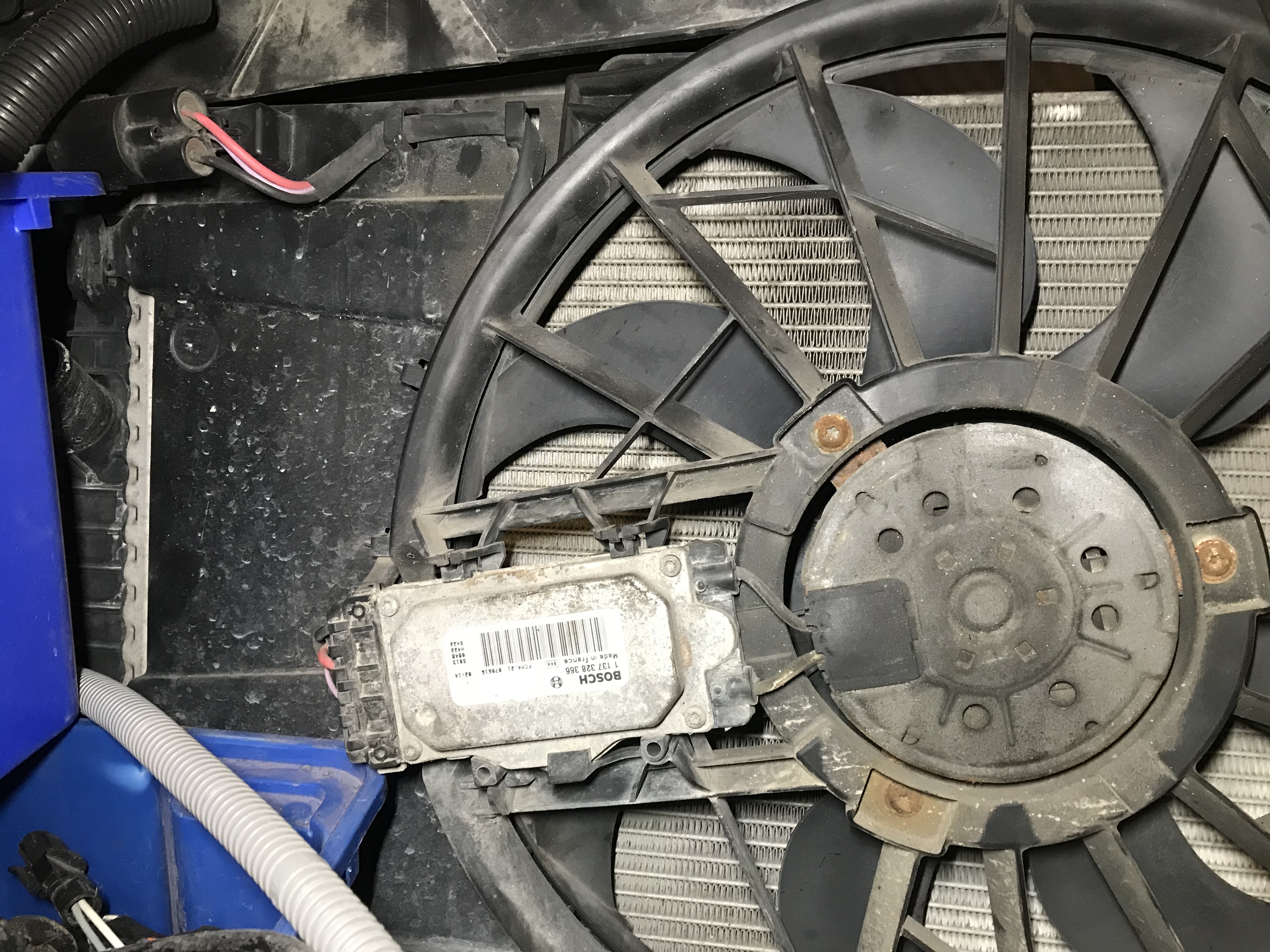

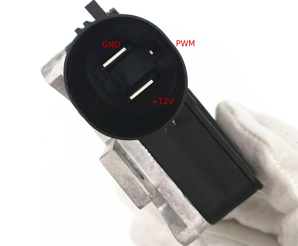

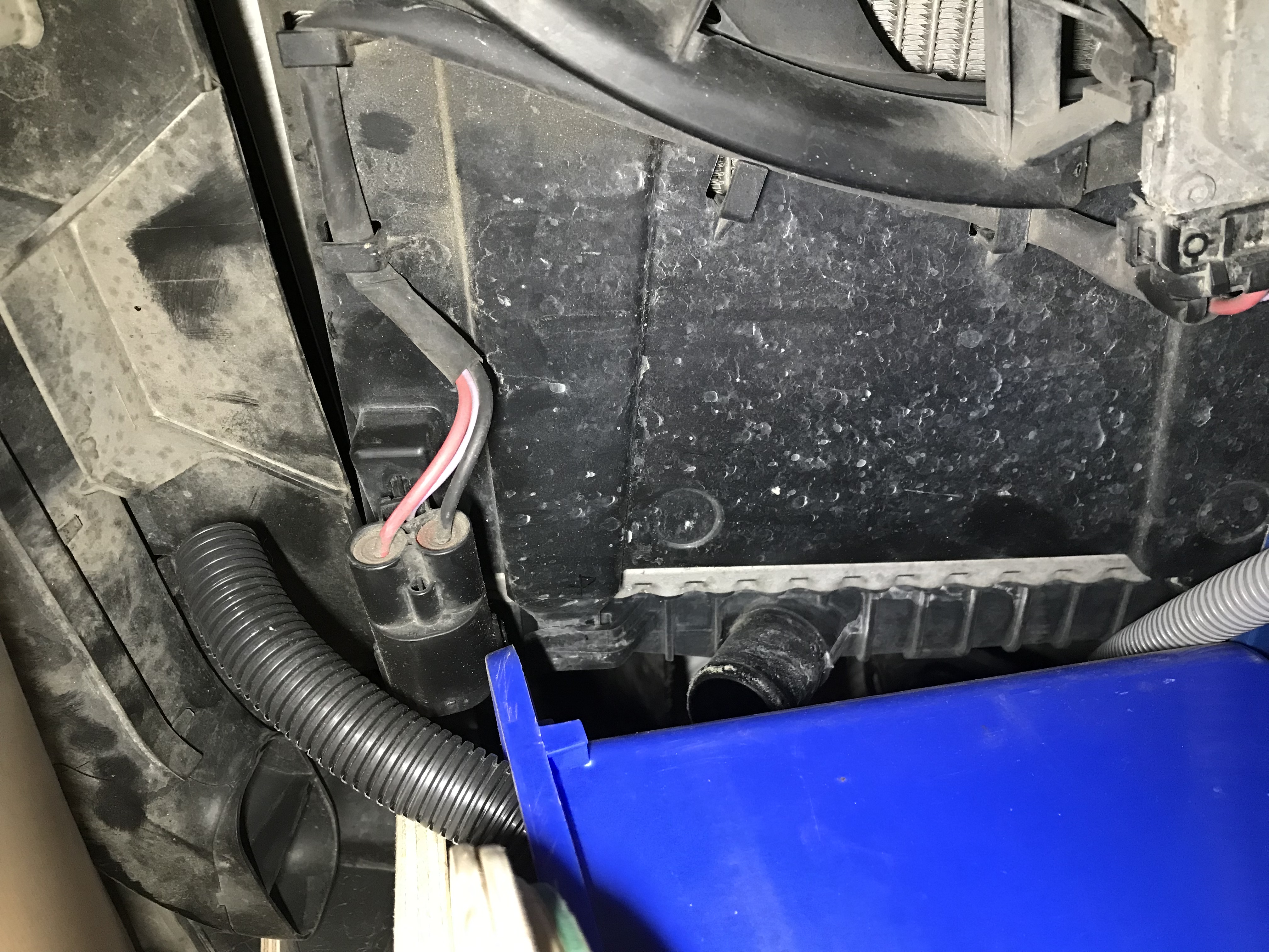

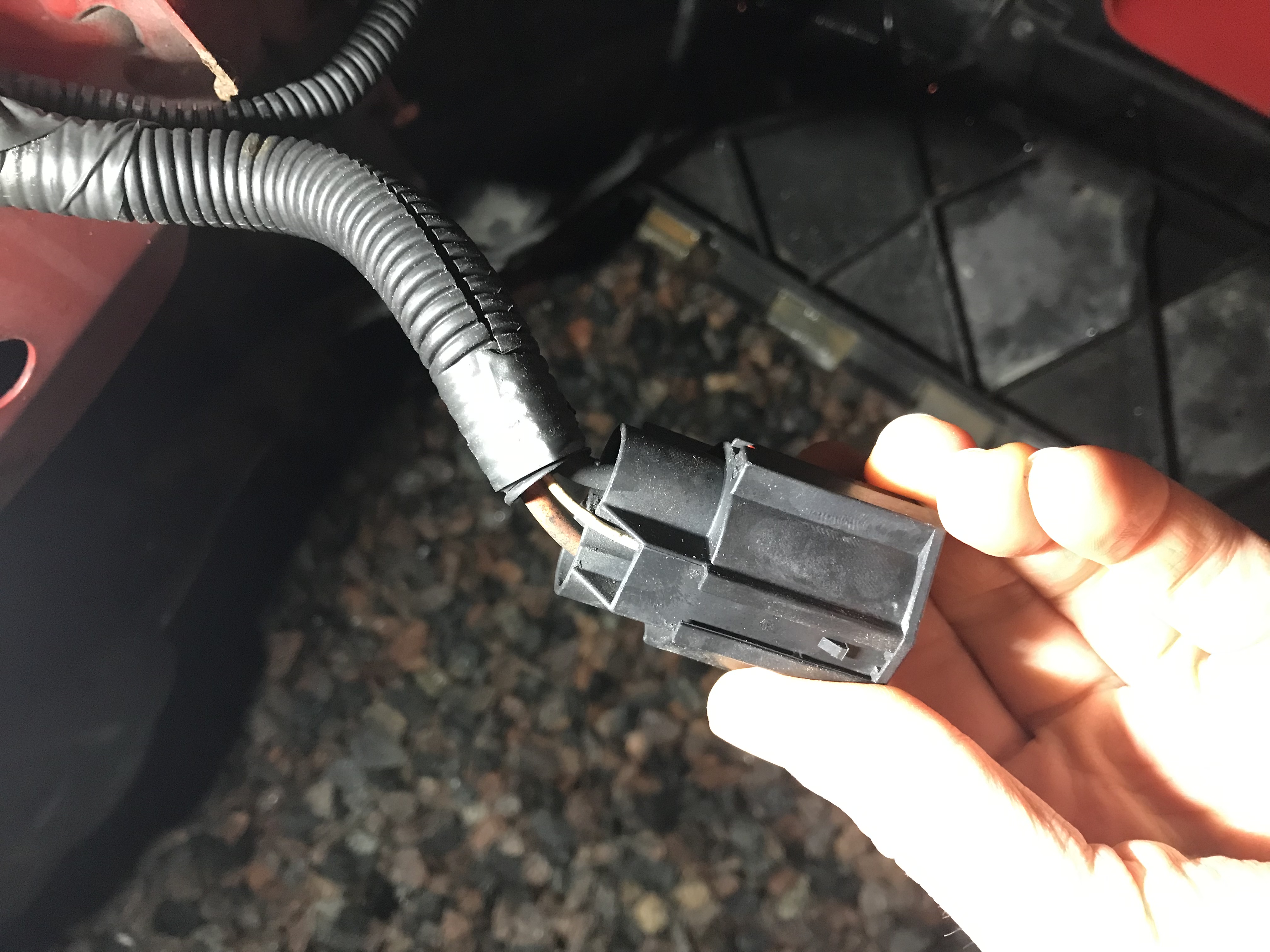

Had another look at the connector and I think it is OK to reuse. Also decided to leave all the connectors off during the initial build as they are difficult to remove without damage, difficult to replace and I don't know if the board actually works yet! Once the board is tested Ill hand solder them on. The soldering wont be quite as neat as reflowing them with the rest of the board but it seems a safer approach.

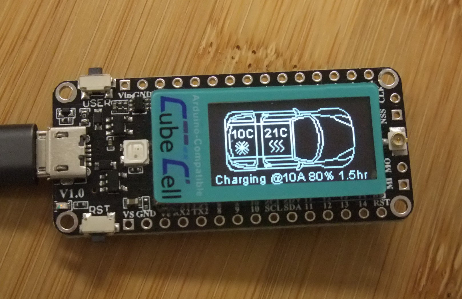

A little more progress on mine. All the bits are sorted out ready to hopefully assemble the board tomorrow. Have revised the terminal class in the firmware so that it will cope with the unidirectional RS485 comms (removed echo characters and added transceiver receive/transmit switching). Also ordered a USB/TTL to RS485 module so that I can talk to it from either the PC or ESP32.
Also the Heltec board that I'm hoping to make a keyfob remote out of turned up today. Only had a quick play with it but fairly impressed so far (not used the RF side just messing about with the display); the Arduino support and examples seem to be really good. This is where I'm up to with it (ignore the heat/cool icons and temperatures - I know they don't make sense!): Can't decide whether to keep the Roadster graphic or just use it as a text display. The graphic is nice to have but it does take up a lot of display real estate making the text a bit on the small side.
I also have the LoRa transceiver for the car end and a spare Nucleo-64 (STM32F103) to hook it up to for testing so hopefully have the RF side working soon too.

Quick progress update - not got the logic board board built, coordination is a bit shot at the moment so will have to wait a few more days.
I have got the LoRa board working. No pics though as it doesn't really look any different to the above but it is now correctly interrogating a remote 'car' node and then displaying car live data. A button press wakes it to request and display data, another short press updates the data and a long press triggers a preheat on the car and also updates the displayed data. Power consumption of the fob node is around 30mA when active and only 14uA when sleeping so even a 100mAh battery will give an 8month battery life and then it can be recharged by plugging into a USB port.
The 'car' node is currently based on a STM32F103 eval board and I've forked a driver repository for the LoRa transceiver and ported it over to the eval board (on my github if anyone is interested). This will eventually be developed into either a stand alone CAN bus node or be integrated into the VCU.
Still need to add security features to it (pre shared key to encode command data) but apart from that it's done.

The other thing I thought it could be used for, as well as the ability to pre heat or cool, is to be able to boost the batteries to 100%. My understanding is that charging to 100% is only harmful if the battery is then left in that state, if it is immediately discharged then the harm is minimal. Is that correct? If so then the ability to normally only charge to 80-90% to protect the cells but have the ability to boost half an hour or so before leaving could be quite handy on a car with a smaller battery pack?
The only other idea I'm toying with is whether to try and build the PCB from the standard car key fob into the back of the LoRa one so that a single fob can be used to both unlock the car and remotely access it?

Re the BMS it will do - once I've designed it! The plan is to integrate everything I need for the car into a custom VCU. So far my thoughts on it are:
Again this is very much phase 2 and is highly unlikely to be in the initial car. I've started on the schematic but it is another trickle it along in the background project. The list above is just to try to get it clear in my mind and if I've missed anything hopefully someone will point it out
Edit - changed fan control method above.
Still got a fair bit of reading to do to get up to speed on batteries but yes I was thinking that 100% would be 4.20Vish.

Just had a thought re the above, for cabin heater fan control I was planning to build a brushed DC motor controller into the VCU, the trouble it that means routing the high current fan wiring too the VCU and having the heat generating and potentially electrically noisy PWM stuff inside the enclosure and close to the LoRa module, neither of which are ideal.
It occurred to me that I could use a standard off the shelf radiator fan control module, something like this, https://www.ebay.co.uk/itm/255606958284. I think it just has a PWM control input that controls the fan speed and if so it would be ideal and a lot easier to do.
Has anyone used something like this and if so did it work and can you confirm how they are driven?
Now I know everyone is asking why bother with this at all? Well firstly I would like to eventually be able to preheat/cool the cabin which needs electronic rather than manually switched control. Secondly I'd like to convert to climate control rather than manual control an thirdly the Roadster has a notoriously bad heater fan control switch which has a habit of melting both itself and the attached wiring, and mine already has, so it needs replacing anyway!

Very interesting idea. In the C30 (my other project car) I think uses exactly the controller you linked to. (C30, S40, V50 and C70 uses the same platform, Volvo P1).
In the wiring diagram for my car it looks like this: And then reading the pinout explanation for the 2.0D ECM pin A:B2: It shure looks like the ECM is just sending a 12V PWM signal to the fan controller. The fan controller is mounted very close to the fan motor in the car.
I do not have the C30 in the garage at the moment but I still have all parts needed to hook it up and maybe possible to measure the PWM frequency even if I don't have the IC motor and all the other signals to the ECM. Let me know if I should look into this when the car is back in the garage?

Thank you, exactly what I was hoping to hear.
Don't worry about trying to measure it, without everything connected up, and possibly the engine running, I doubt it will do anything but thanks for the offer.
What would be very useful is which wire colours go to which connector pins?
I'll get a used one on order and give it a try.

I was thinking that the ECM might send out an PWM signal even if not commanding any fan, but I guess you are right that it will not if the engine is not running.
My module looks very different but the connector looks like it might fit the module you linked to from ebay. So my best guess is
